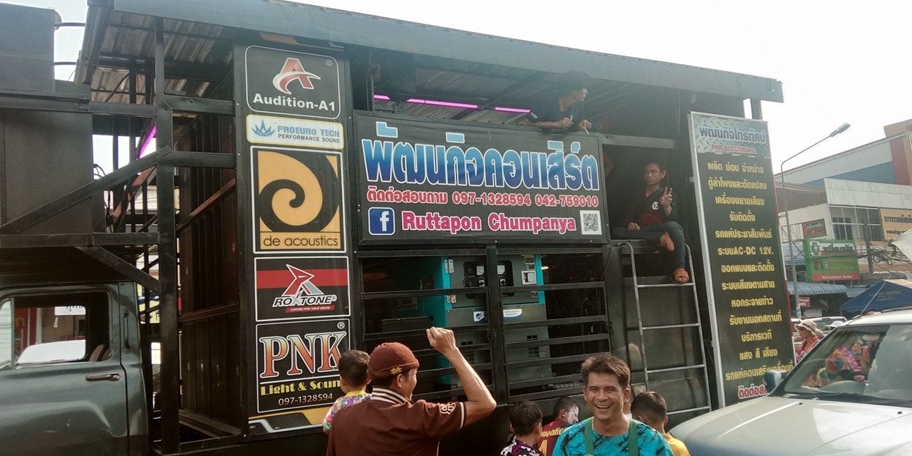

some pic from songkarn festival in my town. they played in front of central plaza.

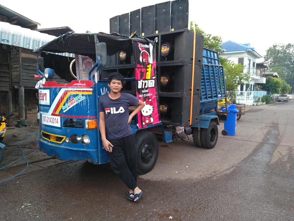

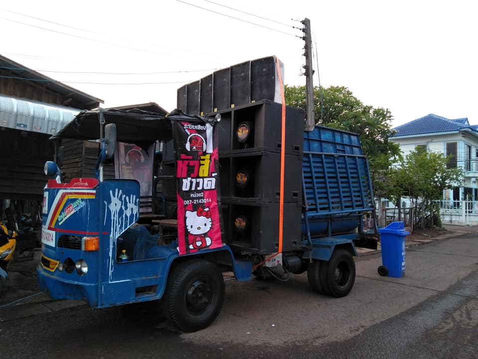

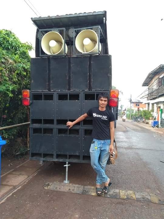

in songkarn day my friend also got the job.

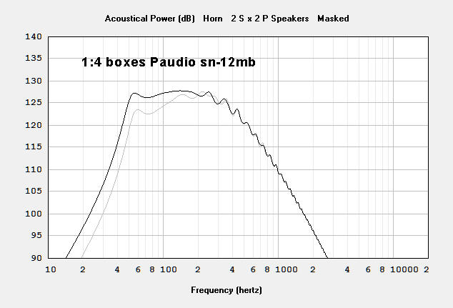

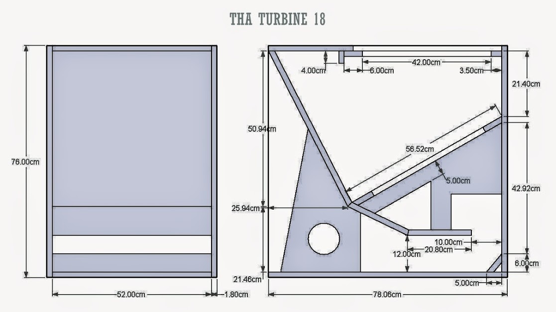

hi Brian i only have spl graph respond. its not perfect because they measured the box was near back wall(glass). when they tried to measure again in tomorrow but the customer wanted to bring the boxes to myanmar. about imp measurement. some friends cant measure it. i wanted to make some course for imp measurement for thai friends but i was sick before.
Post 849. Thawach, can you post a plan for this cabinet? The graph looks prefect! You posted so many enclosures that is hard to keep a track on them)))
