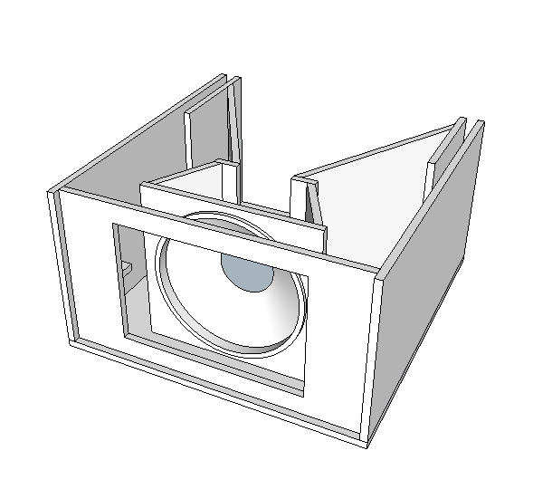

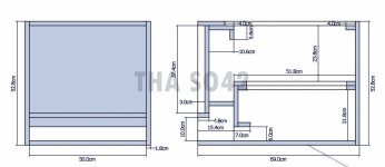

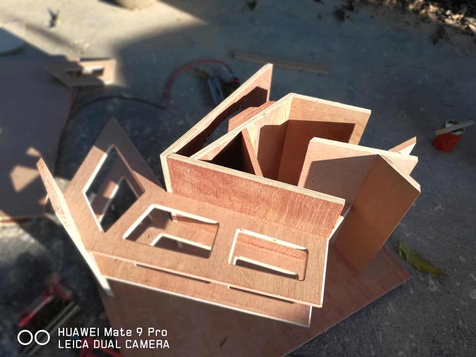

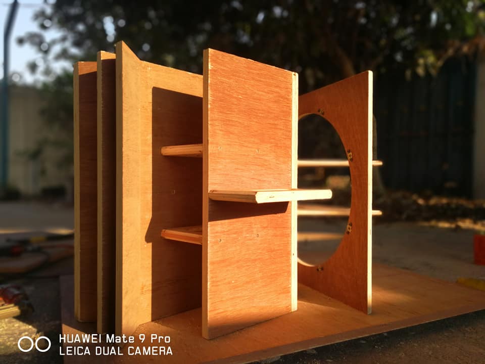

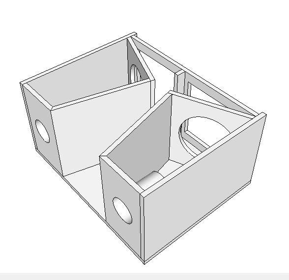

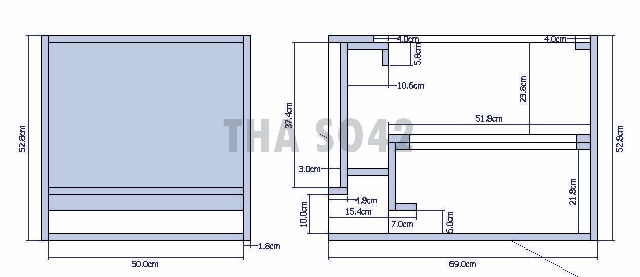

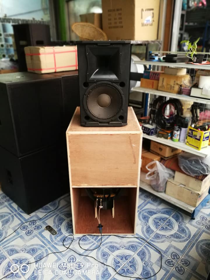

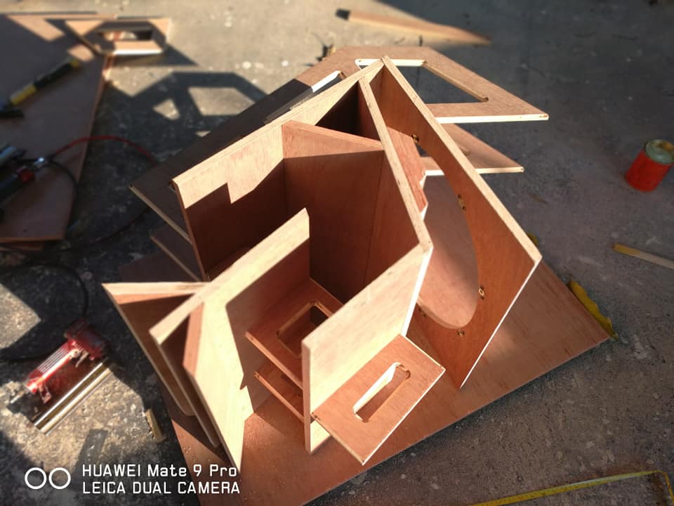

my guy has just finished ss1 box. see the pic compares the size. tha tapped horn is bigger than ss1 cab.
