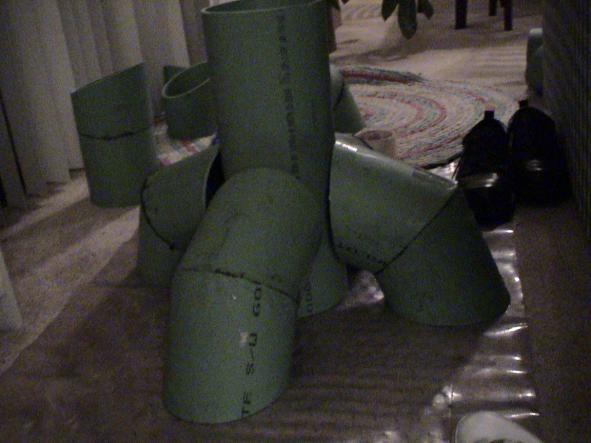

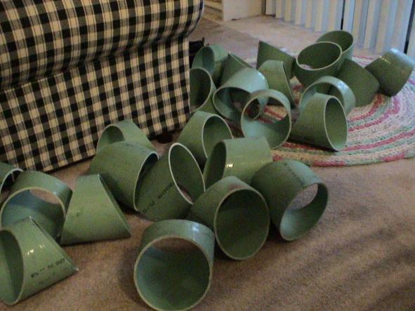

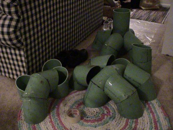

For the Record
I thought I should post some photos for the record. Things are going without a hitch so far. I'm finished with phase one, i.e., the first subassemblies are done.
For the record, I went with the epoxy-only route because the Canadian winter we are experiencing in St. Louis has made my workshop uninhabitable. The PC-7 stuff is quite non-toxic, and works very well, so far.
The main difficulty, you will see, is the torque that gravity causes on these non-symmetrical objects. I solved the problem the best my means would allow.
After these pictures will come 2 more pictures, then radio silence until I'm competely finished.
I think.
Dave
** Edit **
can you believe that these will become a speaker enclosure of some veritable quality?
