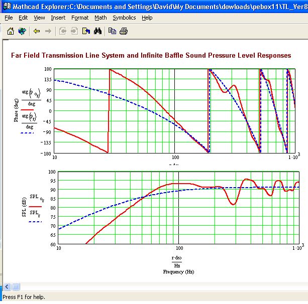

Just wanted to make it clear that I DO expect the response to change with regard to stuffing. At the moment, though, the unstuffed line sounds quite good by itself, and the stuffed line sounds good.
I need to glue these things together sometime soon. THEN we'll know.

Kneadle:
I take it, then, that the rust colored line is the predicted response of the Line when it is unstuffed, and the dotted blue line is the predicted response of the Line when it is stuffed with .25lb/cu. ft. ?
I think the blue line is some sort of reference line. The red line is the one I pay attention to. It's the one that changes. I did some doodling with the worksheets, and if I cram .55 lbs/cu.ft. of stuffing in the first 7 segments, then I have the flattest SPL readings between 60 and 200 Hz.
I have to tip my hand and admit that I have a loose understanding of the readouts. I'm sure that my design is not ideal, as I've said a few times, because the Sd is 1:1, and with the larger drivers, like mine, the pipe begins to choke a little.
Dave
PS--this has always been a sort of "prototype" project that sort of got out of control.

steve said:
I believe the blue line represents the ideal situation of an infinite baffle..
Oh. That makes sense.
I've searched King's site and I can't find a key to deciphering the readouts. He assumes a working knowledge of acoustics and electronics I don't have. I'd love to learn it, though. A website or book would be nice, if anyone is willing to offer a title or link.
Thanks,
Dave
The blue line is the driver in a sealed box (or maybe it is an infinite box -- the ref will be in one of the 1st papers) and is meant as a reference. The red line is the TL+terminus response.
