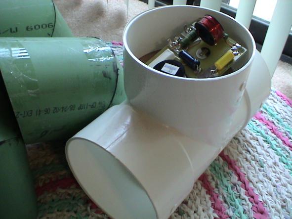

Here is a better picture of phase one. It's a wonder what natural lighting can do.

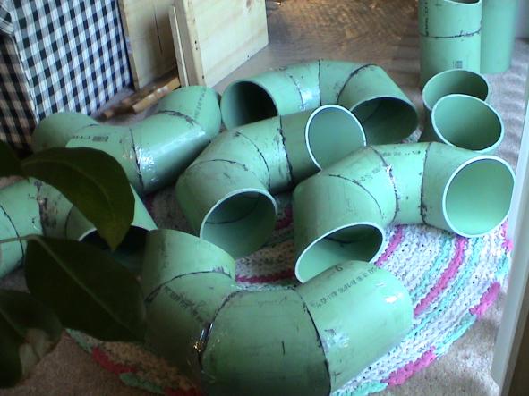

Here's phase 2 complete. No problems so far. The segment on the far left gave me just the slightest argument, and I think it may be a 16th of an inch off one way or the other. My marks mysteriously would not line up again...
1/16th is no biggie.
Dave
PS--oops, a leaf sneaked into the pic. covers the segment in question

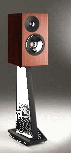

kelticwizard said:
Some well regarded speaker systems have the tweeter flush with the front of the woofer cone, but offset from the centerline, inward slightly-like an inch or so-toward the other speaker.
Below is an example of what I meant by that statement-the ScanSpeak Reference Monitor.
Of course, you can also line the tweeter slightly behind the plane of the front of the woofer cone-that is another variation.

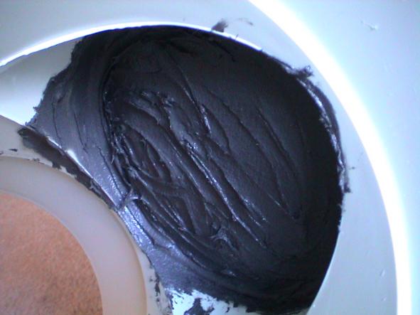

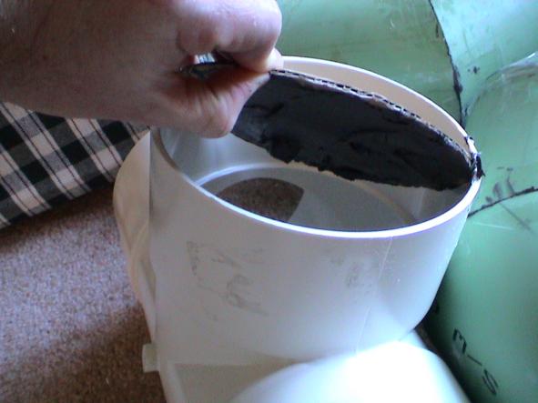

Phase3c
I spread the epoxy with my finger until it created a seal. I can add coats of epoxy until I'm satisfied.
This allowed me to use a thin piece of cardboard to seal the tee-top, a strategy which will give me room to store the crossover components.
I like the concept of storing the components in that compartment very much.
One thing-I would advise that the piece that seals the top from the outside to be somewhat stronger than a piece of cardboard, though I do believe the PC7 will stiffen that quite a bit.
It is one thing to describe something theoretically, it is another to do the steps to bring it to completion, to make the little decisions necessary to actually make something happen. Now that I see all those pieces on the floor, I must admit that you seem to be on schedule to completing a rather daunting task!!! :bigeyes: :bigeyes:
Hey, if you're going to build a giant caterpillar, you gotta expect him to eat something! 😀 😀

The tweeter is customarily placed above the woofer. However, some Transmission Lines find it necessary to have the woofer above the tweeter, and nobody has yelled Bloody Blue Murder about it yet. Some well regarded speaker systems have the tweeter flush with the front of the woofer cone, but offset from the centerline, inward slightly-like an inch or so-toward the other speaker. However, I have never heard of a tweeter directly on the side of the woofer
I always try to offset the tweeter from the midbass centerline... below casues a different tilt in the XO lobes. And the speaker pictured has a good rationale for side by side placement:
The epoxy/cardboard seal is actually much thicker than the PVC wall. And if I need more, I can always add more epoxy, or even cut a piece of wood to fit underneath the cardboard. The key was sealing it while preserving the space above.
It's a little surreal for me, too. They should be completely done by next weekend. Watch for a post called "Spiral shaped enclosures..."
Heh heh. I'm building caterpillars!

I don't understand why you don't just get a pvc cap to cover the crossover? I doubt that a cap will cost more than 4-5 dollars... and it sure will look better than a cardboard cover.. and it will be easy to remove if you need to modify the crossover.
