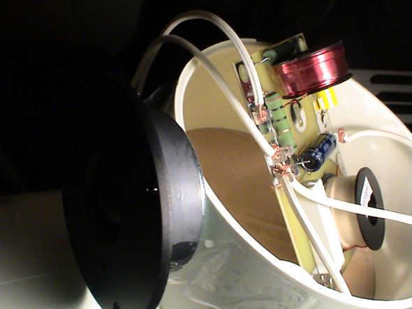

Just a construction note
Noodling around with these things...I can get stuffing in any part of the enclosure even though it's fully assembled. As you see pictured, it has a whole bag of polyester blanket stuffing in the very middle turn; I put it there after I propped it up.

here's a picture of the top of the tee. you can see the x-over on top of the cardboard that seals the enclosure (duh! why don't I have any bass response?!?), the and the tape that's holding the tweeter on.
Dave

I noticed that you put the Vifa 6.5" into a different end of the Tee than we envisioned. We were going to put it in the middle aperture. Doesn't really matter, though. This is one of those things that are definitely improvised to taste.
I am a little concerned about the bottom part laying on the ground like that. That wasn't the way Andrew's plan went. Are you sure all the pieces are fit together right?

I think the mounting method is according to plan. Isn't that what Andrew's plan assumed? I just double-checked; it is.
I'm glad you mentioned the port config. I think I have the port pieces swapped. They're mounted as labelled, but I think they're on the wrong pipes!
Shoot. It fell down. It's roughly 2 feet from top to bottom.
