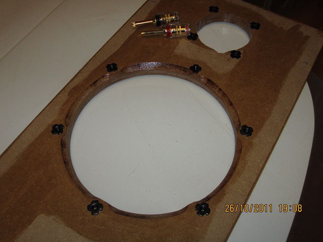

Yes that is one way, ty Zvuchniak. I am rather close to the edge, I was even considering turning the T-nuts upside down and use glue, but maybe that will be even worse?
Actually, that sounds like great idea to me. The only thing i would be afraid of is glue getting into the threads of a T-nut.
Besides that, i think you should be OK :)
Ok, but I have decided to use it as is but remove one of the tags closest to the edge. In that way I will not risk anything to crack. I will also put some glue under the t-nut before driving it in. I only have this problem on one of the tweeter ( I made the hole a little too big).
I tried driving them in without removing a tag but I got a slight cracking (delaminating) so when mounting the woofers I will remove one tag per T-nut closest to the edge of the hole for the woofer to make sure it doesn´t crack. I used a hammer taking it slow and easy but I think the delaminating could be avoided if not using a hammer, driving it in with a screw and washer. I will try this next time. Takes experience to mount these it seems.
Pictures of the baffle and I got some speaker terminals today, from Jantzen audio, about 9 Euro per terminal. Seem sturdy and quite heavy.

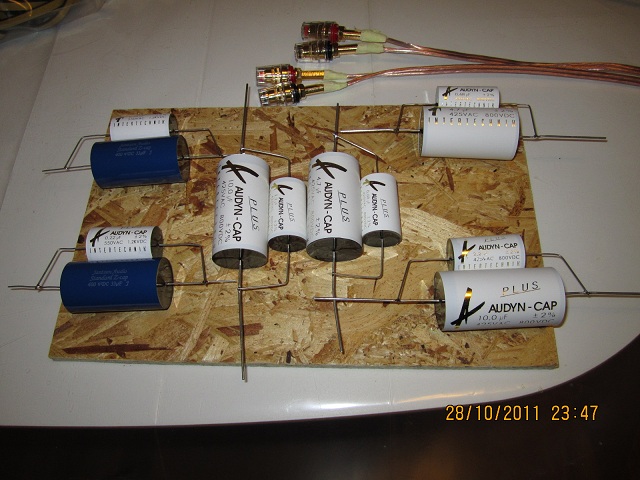

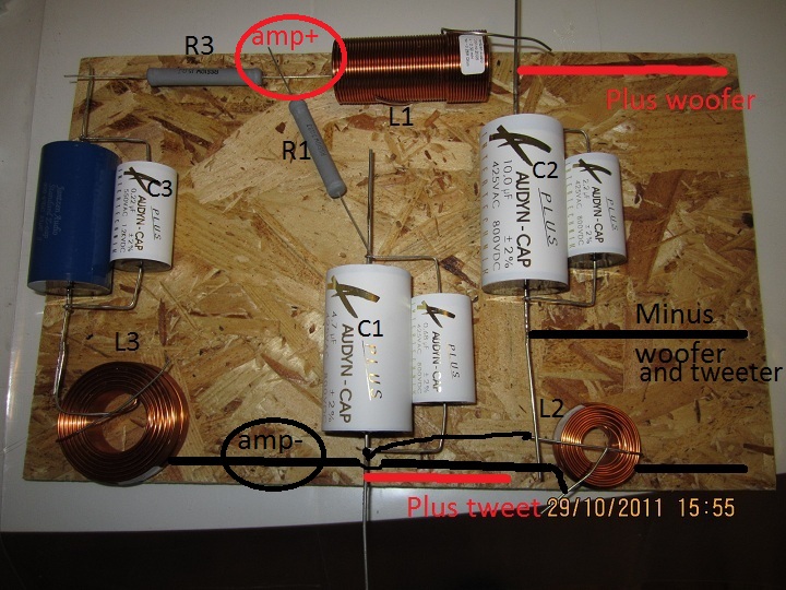

Hi Salas, I have started with the crossover, so far I have fixed the terminals and the capacitors soldered together (se picture). My thought is to keep all of the legs original lenght for now and later when I am happy with the layout and so on I will resolder it making it better looking (shortening the legs). I am making my first crossover so I am not familiar with how you do this the best way, but I am used to soldering things together. The capacitor "packets" will then be connected to other components using contact blocks with screws.
