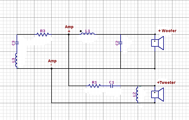

These are some really nice drivers
~40liters?
2.4K cross point?
35Hz port resonance?

Ty, they are 45 l, crosspoint I am not sure of but a little over 2kHz is probably suitable.
35Hz port yes. My name is not Sebastian but Staffan, where did you got that from?.
L1 = 2.5mH (2mm d. wire)
L2 = 0.25mH (1mm d. wire)
L3 = 1mH (1mm d. wire)
C1= 4u7//u68 PP high quality
C2 =10u//2u2 PP high quality
C3 =33u NP//0.22uF PP high quality
R1 = 3R9 10W Mills
R3 = 15R 10W Cement

I measured the driver myself to see how it behaved around the crossoverpoints i was interested in 🙂
(Mätte alltså från 1500-2500+Hz, 180 grader o plottade upp på en skiva)

Great design Starre 🙂 I've been looking 22RCY for quite some time and it seemed to me like decent driver for it's cost and performance.
What do you intend to do with box stands ? I dont think that box hight of 71cm is enough in regard to tweeter-earhight rule.
Ty but i have not designed it myself. I will of course use some kind of stands for it, but that is another project 🙂.
Salas had some measurements I looked at and it seemed fine.
