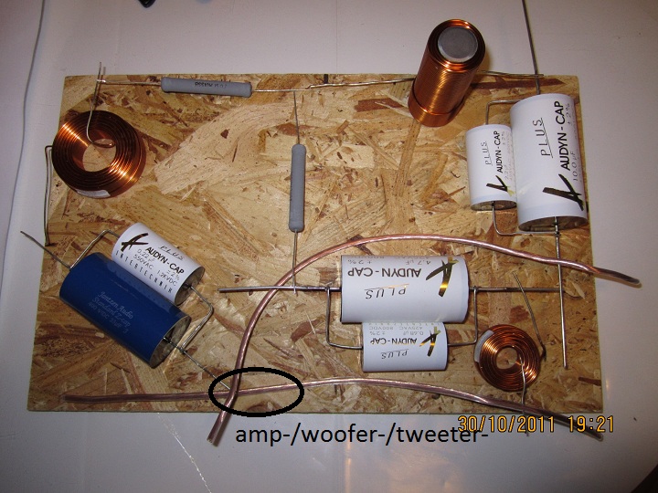

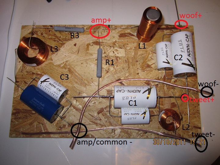

''Buss bar'' is the concept. Common in old tube building. Check out a Jadis amp guts photo on the web to picture it for instance. Could be a thick wire. The idea is you progressively tap along the ''bar'' from lighter to heavier current points and you ground at the end. Say in this case you stick the tweeter (-) then the woofer (-) then the conjugate (-) then the amp (-). So heavy currents don't mix with lighter ones.
Ok, but the main thing with star earthing is that all negative points from components is soldered in the same physical point with no wire inbetween them? They originate from the exact same physical point to aviod any hum?
There will be no hum in speaker level, that's in delicate signal electronics with PSUs around etc. But it will be cleaner for return currents. Either are good practices. Prefer the pure star if you can arrange.

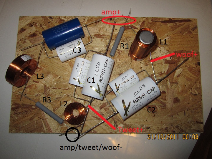

This may be a moot point as the board is fairly large, but ideally the axes of the coils should not be aligned. L3 should stand on its side with the axis at North-South and L2 should also be tipped sideways with its axis East-West... I think.
Yes I have seen the same but since it is a large board I thought it wouldn´t matter. Thanks anyway and I will maybe use that suggestion since it cannot hurt.
yes but I am trying to arrange it now to avoid the extra wires, I know it should be more compact and smarter arranged, working on it.
Ok I think I have it, I hope the coils are not disturbing eachother!
I should probably turn the left coli 90 degrees and lay the big one down.
See picture..
See picture..
On an East-southeast axis.I should probably turn the left coli 90 degrees and lay the big one down
