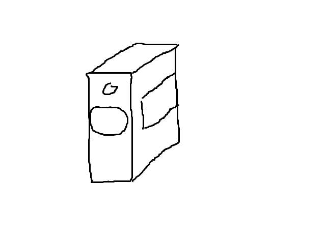

I am pondering using ceramic tiles with damping glue. But before that I must test with a bit of MDF if it can be a good choice. The tile is stiff and approx 6mm thick. Damping glue of approx 1mm. This way it is rather thin and does not alter the box dimensions very much. Also the surface does not need any work.

Ah ok, well that is no problem since I was thinking of using it on the outside of the cabinet, you believed I wanted it on the inside, right?
Yes inside I thought, outside no problem for volume, but will it not look weird since its a beautiful speaker now?

I will use only one big tile per side Salas so I do not think it will look like a bathroom lol.

It might work, seems more stable. But I listened some last night and all of the back panel is making noise more or less so I should cover it up entirely. The side panels are good so it needs nothing. It also did not look good with tiles on the sides so I skip that.
If it will do work for the back panel quieting it will be something, and outta sight non the less.
Yes Salas, that is my plan. But after trying out the ceramic tiles (clay really) it is obvious it is not good enough. So now I will do it the Swedish way 😀, go "all in" and go for Swedish granite. That is really heavy stuff! My plan is to get hold of floor tiles of granite and get it cut to fit. They can be found in 30x30cm so it needs some cutting. 2 of these at the back going from top down to terminals and then leave the little part below without stone to save some cost. What do you think of it, Salas?
