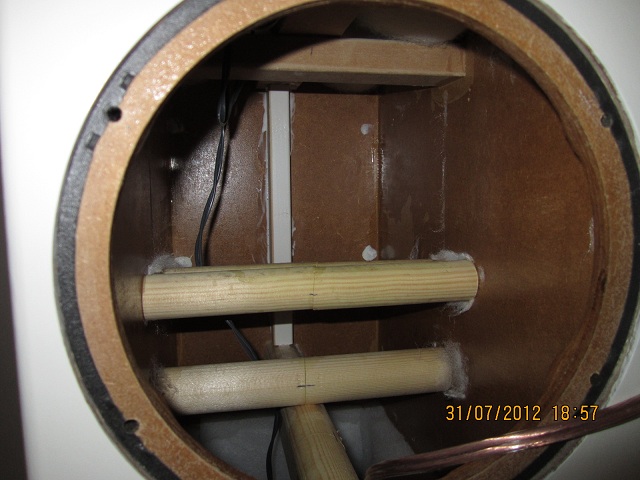

Salas, I calculated it again and it should be 0.685 liter. I also think I lost some bass output that I noticed yesterday. This happened after putting that front-to-back rod in, but its volume is only 0.275 liter. I wonder if that small volume could make it tip over so to speak or it is the stiffening itself that sounds like less bass. I will listen more today.

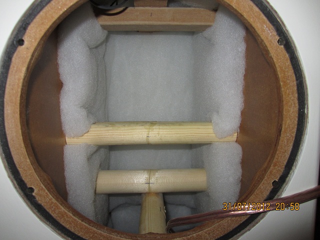

It seems like it is very hard to get rid of my problem. I tried a rod and since that didn´t help I considered a rib but after some testing I think it will not work. I have kind of lost hope at the moment, I wonder if it is possible to succeed. Maybe those rods from side to side just moved the problem to the back panel, side panels are very dead, especially compared to the back.

A slight dampening it is, better than nothing. In total the volume is 0,81 liter less now. Salas, what happens to bass when you decrease volume and keep the rest unchanged? Do you get a little hump the more you decrease it?

Ok, almost finished. After it is dry I put some new stuffing in place ( I ditched the fleece lining and removed all behind woofer while testing). I listened some more and also knocked on the back and it is clearly more stable, mission accomplished. Picture of inside, quite a construction site 🙂. The rib is 19x27mm with the smaller side against the back for max stability. With this placement it gives support on the whole panel behind woofer with just one rib, and gets support from the upper and lower bracing.
