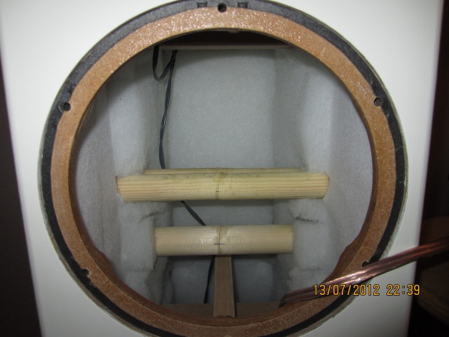

No henry, since I have stuffing at the back. I have to remove that first then. But since I have to do that anyway if I put in some ribs, I could try that instead. I do not know what is best. Perhaps I should do both.
Other wood material flexes too just has a different resonance, can be stiffer & lighter or not etc. MDF is not that bad neither excellent. Bracing, constrained layer damping, thin wall & loss via contact mass BBC, rigid school resin and/or metal based etc etc. are methods.
Yes, not the easiest thing to get controll over. I will try a few ribs at the back glued in place, not too big to destroy air flow but big enough to increase stability. Maybe it even might dissolve some of that backwave with its non-flat surface.

I will add an extra bracing from front to back just below the woofer, I could hear some resonance there with music, and even feel it vibrate with me fingers. So 2 mods to do, one extra bracing and a few ribs at the back. I hope this will be good since after that I have no ambition to go on, and I don´t want to get smaller volume than that, might affect bass.

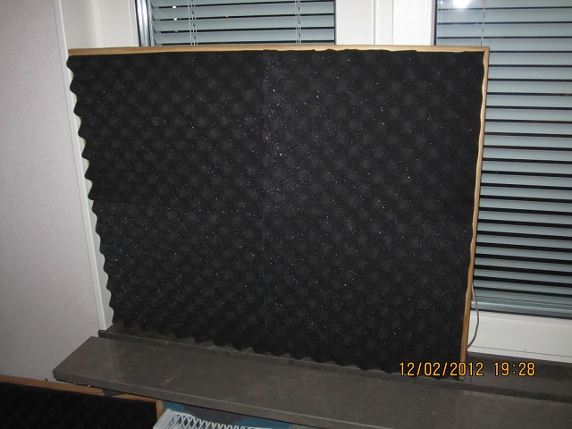

Salas, what do you think of using this foam I have on this panel? It is 2cm thick and I am considering using it at the back-panel between a few supporting ribs to dampen the back bounce, then use some of the usual white stuffing over it.
Same foam is on this panel:
Won't do anything, its a matter of structural mass or support against the direct high energy LF wave blows. Such absorption like foam is for the box modes echo control higher in frequency.
OK, but a few ribs that will strengthen the back-panel should make it less prone to make sound itself, even if slight?
Surely any reinforcement there works towards that goal by stiffening. How much of a difference, you can't say if not simulating flex in some special software.
So what do you think is the way to go? I am a little confused. Not much to do, you mean?
OK, just hard to get in place there. I will see what is possible. I could use one of the bracing side-to-side as support, I guess.
Telescopic something so it can go in easily and you can extend it and tension it after. A bit tensioned and not only connected is surely better.
What do you think of using the magnet of the woofer and connect a rod from it to the back? Takes some fine tuning to get in place, but if I do it might be good?
