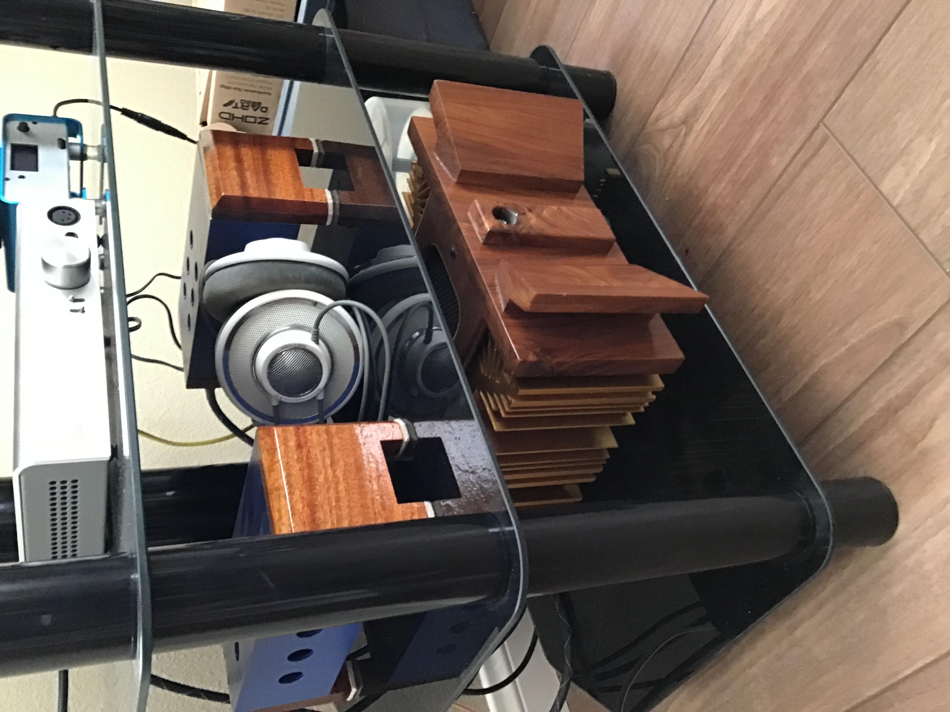

Just wondered if anybody had tried this stuff, I actually bought it by mistake thinking it to be solid metal. In fact it's a composite sandwich. I used it as a top plate for a valve amp and it's easy to drill and cut. I got thinking it might be useful for making cases. It's very easy to fold if cut on one side with an angle grinder, use standard width disc to gouge out metal and filling, then fold to 90 degree, then reinforce the angle with glue or right angle strip. Truth is I haven't used it to make an enclosure yet, I've just experimented with the folding, works out quite neat. Downside is the colour and it's difficult to paint and it might not be suitable for larger, heavier jobs.. Aluminium Solid Metal Sheet, 600mm L, 600mm W, 3mm Thickness | RS Components
A bit late for comments on this, but anyway…
I‘m pretty sure this is „alucobond“, mainly used for facade cladding and similar.
Has some neat features but is difficult to work with, at least without a good assorted workshop.
I did some experiments with but abandoned the stuff. Went over to alucore (Alucore(R) | ALLEGA) really advanced stuff [emoji851]

Pennsylvania Manufacturing makes a very nice press fit threaded insert for thin sheet metal.
McMaster sells the fasteners by the bagful -- 25 or 50.
Interesting -- the "insertion tool" is $533 at McMaster. I thought it may have been more. McMaster-Carr
It´s *expensive* for a hand tool which to boot is sllloooowwww (in any poduction environment) and will tire/cramp your hands into uselessness after a couple dozen insertions.
Price would be fine for a pneumatic or foot operated machine though, one which allows, say, 5v inserts or better per minute, during hours.
As shown, only valid for prototypes but too expensive for Hobbyists/DIYers.
That said, it seems to include a very complete set of dies.

Nice machines and certainly justified if you insert ten to hundred thousands per Month but for smaller scale use, I bet that a cheap (as in less than $200/300) male/female die set can be made (turned shapes are cheap easy) out of cheap tool steel (say 1070 with proper heat treatment and even cemented for durability) to be used with a small mechanical press, hand feeding nuts one by one (using tweezers or similar to keep fingers safe).
Back of a napkin calculations tell me that to punch a 4mm hole in 1.25mm thick cold rolled steel sheet takes all of 700 something kilograms (so not even 1 Ton), so insertion force can´t be higher, in fact should be less.
So a small press and a cheap die can insert some 50 nuts a minute, at a leisurely pace.

Yup, you should use a router to cut the alucobond’s inner sheet and sandwiched plastic, so that the fold gets precise and it then can be glued.
Probably same with alucore.
I tried cutting aluminum with a router, it speed is to high and router is not sealed and can get aluminum chips inside. I have been waiting for a reasonable CNC diy router to become available.
Bill
Bill
You can use a normal router, in fact many DIY CNC tables let you use your own, BUT you need a special router bit, with proper angles and sharpening for Aluminum.
Notice this one specifically mentions "composite aluminum panels".
If making straight cuts , no big deal using a hand held one, but use some kind of rail or at least a straight piece of wood as a guide, it´s easy to mess a cut just by unguided hands.

This brings up the question: what are the safety standards for DIY amplifier or other electronic equipment cases? It would be nice to have a standard to follow: fuses, grounding etc. Might as well consider these things now for future reference.
Quite certain they must follow the "official" safety standards as any commercial product does.
Mains voltage, fire hazard, etc. are as deadly no matter WHO built the device.
Only difference I see between Commercial and DIY is that they usually need to submit samples to some official certification bureau to show valid certificates when needed, specially when going through Customs or stuff simply gets retained there, while DIY does not leave your Home, but in any way respect them for your own safety.
