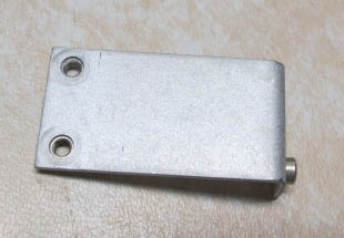

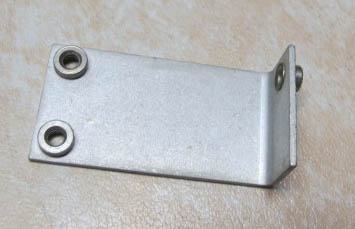

One of the neat fasteners -- and a type of these were used by Hewlett Packard (now Keysight) were PEM nuts. RivNuts seem even easier to use: How to Install Rivet Nuts, Nutserts, Rivnuts - Street Beast '66 427 Cobra Replica Hood Catch - YouTube
