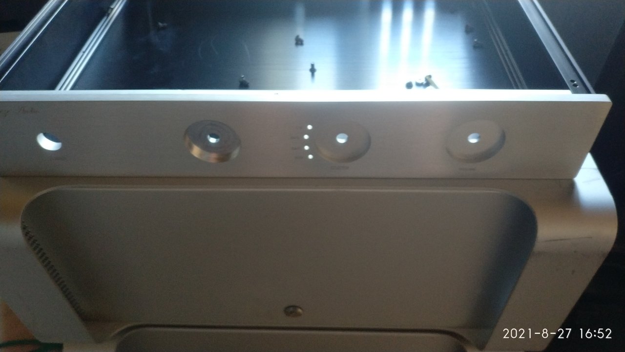

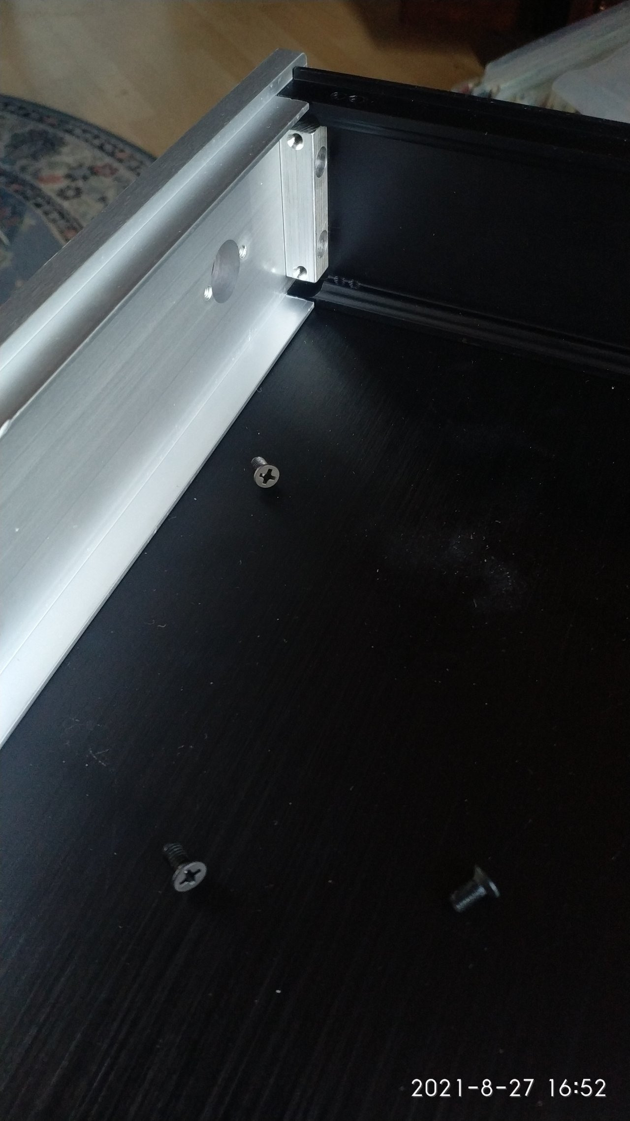

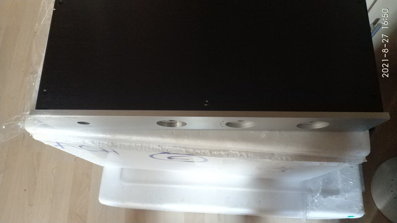

Recently I ordered a Case partly Custom made, partly they had already build some part of it.. and it cost me 50 Bucks.. If you count all the Folding table you made, the Aluminum Plate, your time and all other what comes with it, and last but not least the quality, then sorry your DIY is a no go..
There is no need to fold that cases, make angles but smaller ones as from others told or suggested.. just thick and wide enough to hold two or three or four screws.. Use Screws you can easy hide, and really soon it looks also beautiful.. and then it's really DIY, Be not satisfied with what you got.. go for more, go for all go for quality, it uses up the same time same effort, to make something neat and clean and good, as just making it "so la la." this is a expression (German Expression) and can hardly be translated..
Make that all angles are 90Degrees, and that you cut the aluminum straight, that it looks plain and you got the chance to go where you want to be.. but the way you show in the Video, that's a Waste of Time. waste of material and last but not least it is not something which blows anyone away, except may you..

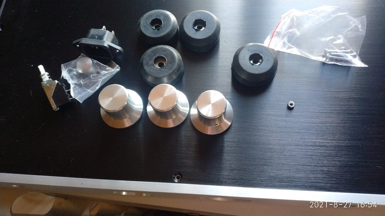

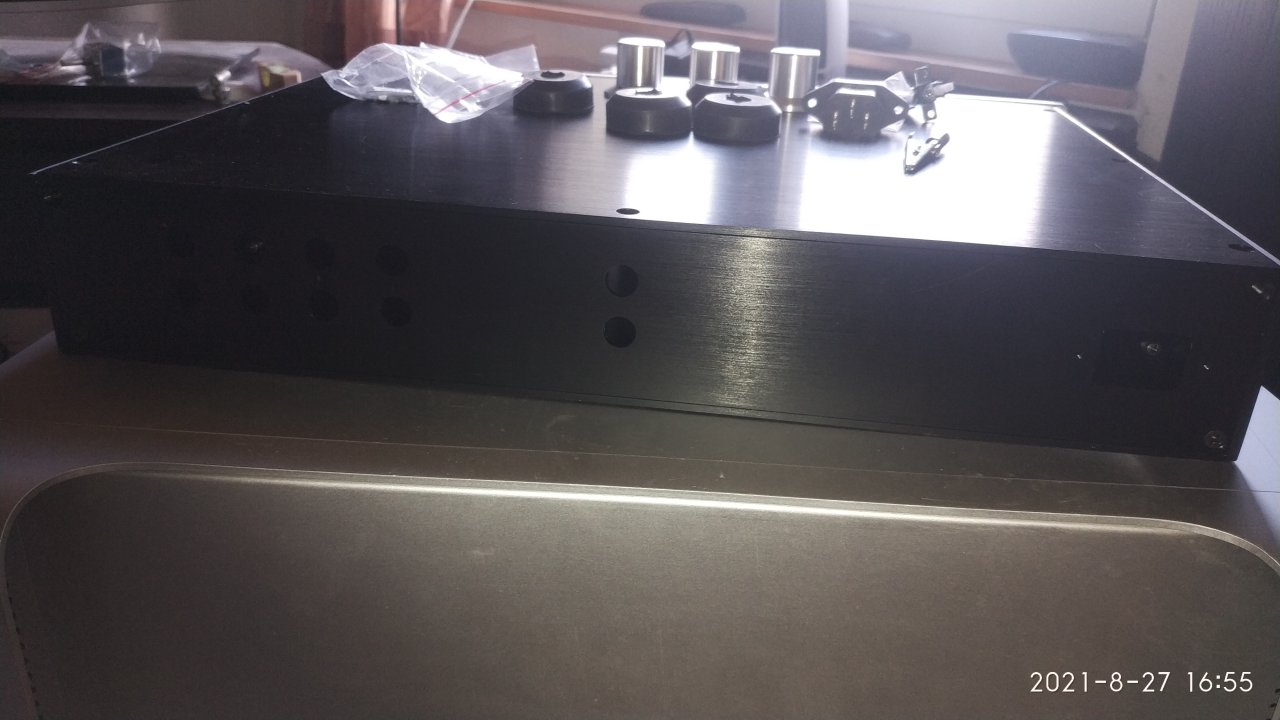

Check out the pics and then tell if you still think that you can make this cheaper..
This Case with all what you see inclusive screws, cost 52USD to make..
Also included Knobs, Switch, Back AC Connector, all Screws. Anodized and Silk Screened and this is STILL DIY because I gave them the Specs as I want to have it.. Design IT Yourself.
But I'm sure, you're enough eager to do that, and I'm also sure you can do that, all it takes you need to change your approach of the kind of cases you going to do..
Pressed ones, like you want to do, are not that user friendly. These where produced by Japanese in the Sixties. Long time ago, and then the repair guy found out that it is a hell of a PIA to repair Electronic devices in Pressed or molded cases.. Spend hours of getting the interior out and hours to get it back in, then when tested and not worked, all over again.

Here the link it's from Guangzhou China.
I have a Modified Version, not like the one you see. The one I have placed the pictures, is made by order from me, and there only for the front plate.. the rest is from the case you can see in the link., and the price is also not the same, because I buy there quite often.
There is also some shipping costs, but it is still cheaper and more professional than the Hand Made Cases I saw in this link here..
And, again, I have found that shop when I was in China in 2019, and I buy almost all aluminum Heat Sinks, and Cases there, because I can DIY them
Design It Yourself, and they will make it exactly as I send the paperwork with the design..
And because I respect anyone, who does DIY, I didn't placed a link in my first post. Work is perfect. We in the western world are not able to cope with these prices..

The aluminum they use on that case is 2.5 mm thick the front plate is 10mm thick here I would pay only for the Aluminum more then a 100US$, then also it would not be anodized, not Silk screened. If someone can live without that for a case, you see everyday when using it, then OK. Not for me, I like it nice. and I like it perfect, and if anyone here wants to do it perfect then the price will be 250 and up.. this was the meaning of my post.
