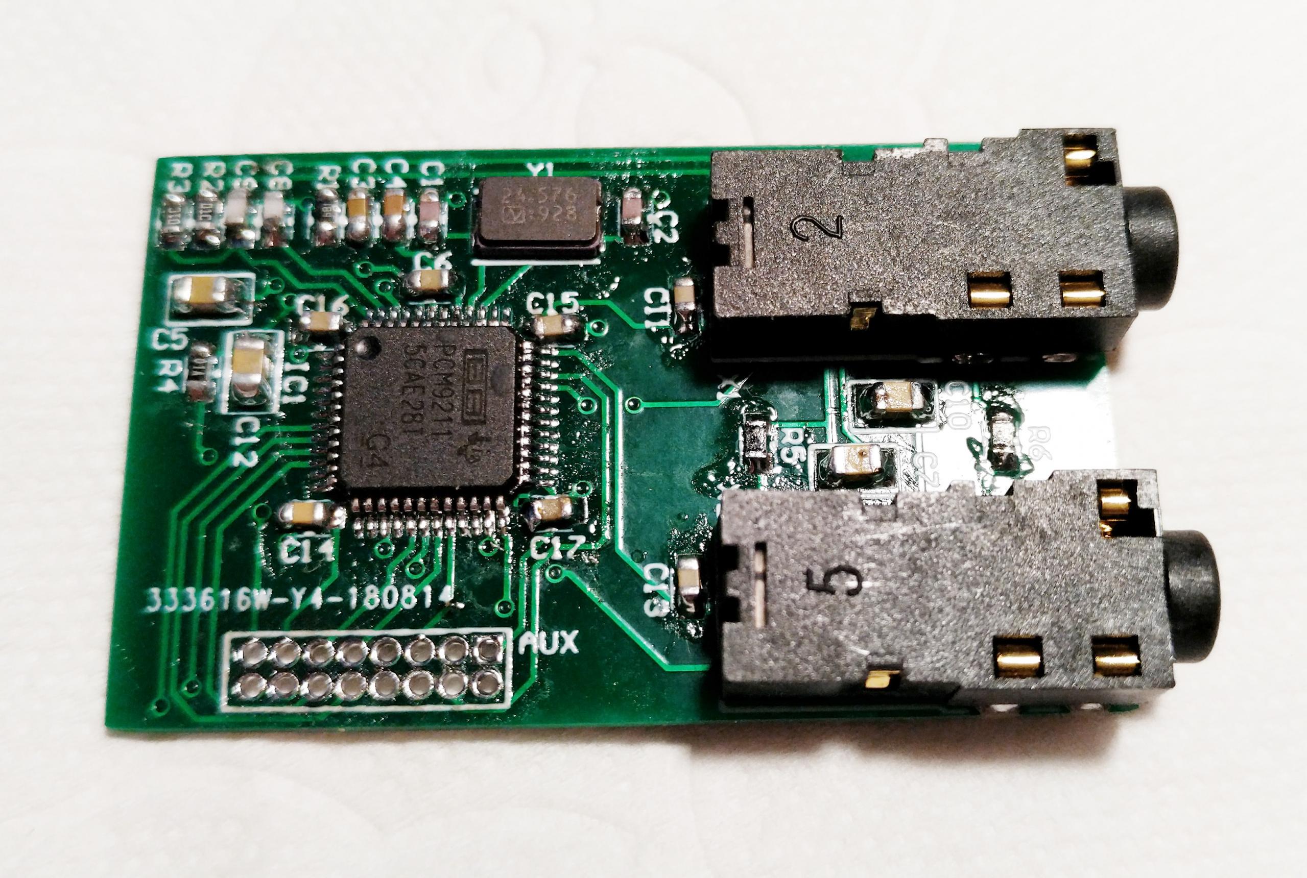

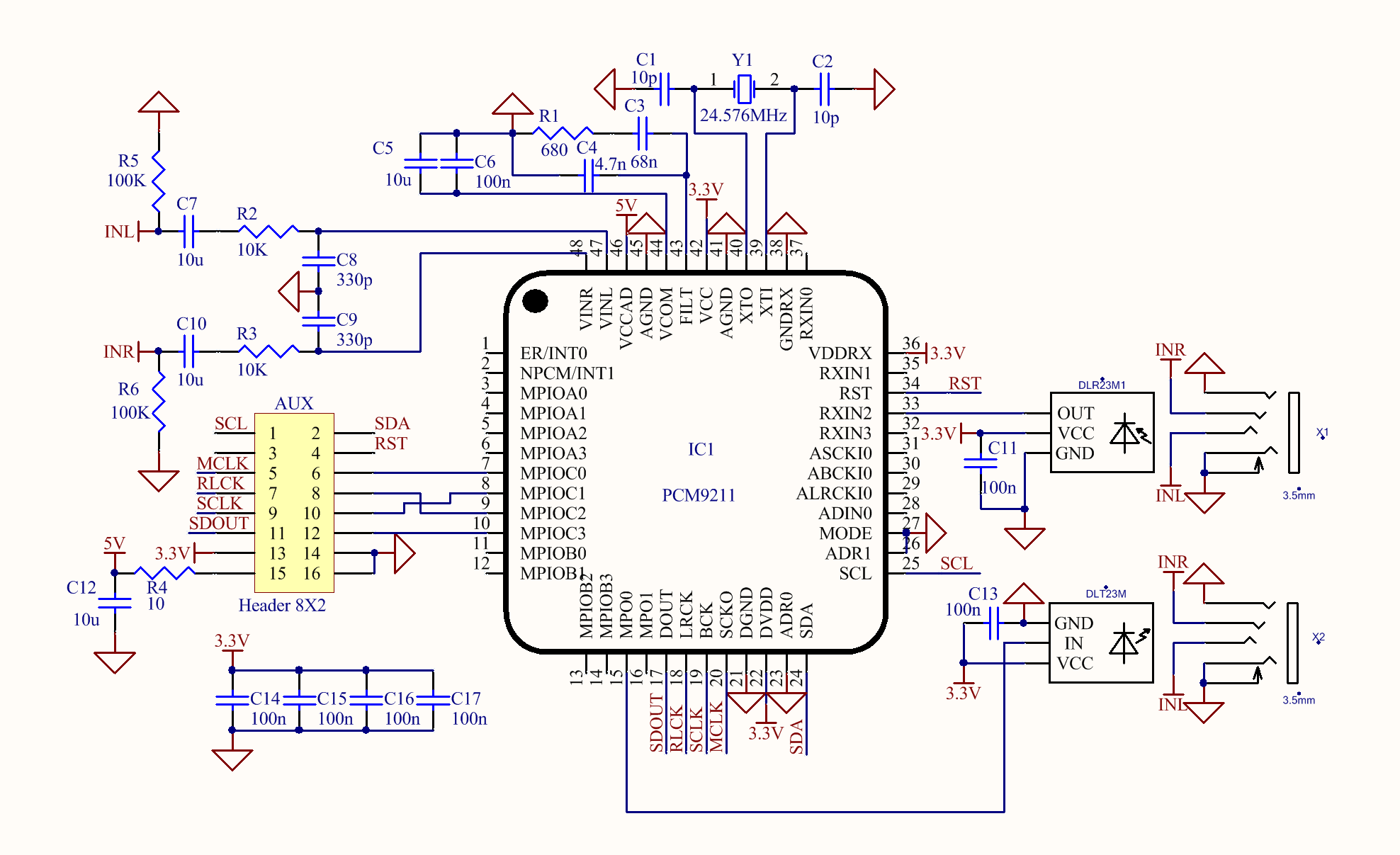

I just tested the SPDIF/Toslink board on PCM9211, works fine, and fully auto accepts 16-24bit 44.1-192kHz. SPDIF_TX always sending TAS5558 input data whatever SPDIF_RX/ADC or USB input selected. So it allows using more than one HiFi-TOYs together for bi/tri-amping, i.e. in-serial USB/RX1->AMP1->TX1->RX2->AMP2 etc. Due to PCM9211 has an ADC onboard, not so cool one S/N -101db 24/96, I decided to use it just in case(not sure if someone needs it if already has USB/SPDIF-Toslink). Anytime when SPDIF_RX isn't detected, HiFi-TOY automatically play from analog inputs(both 3.5mm Jacks could be an analog input either SPDIF_RX or SPDIF_TX). I think it is crazy compact design again(39x24mm the same as BT_stream board which could be optionally installed instead of SPDIF board), as the whole HiFi-TOY actually 😉

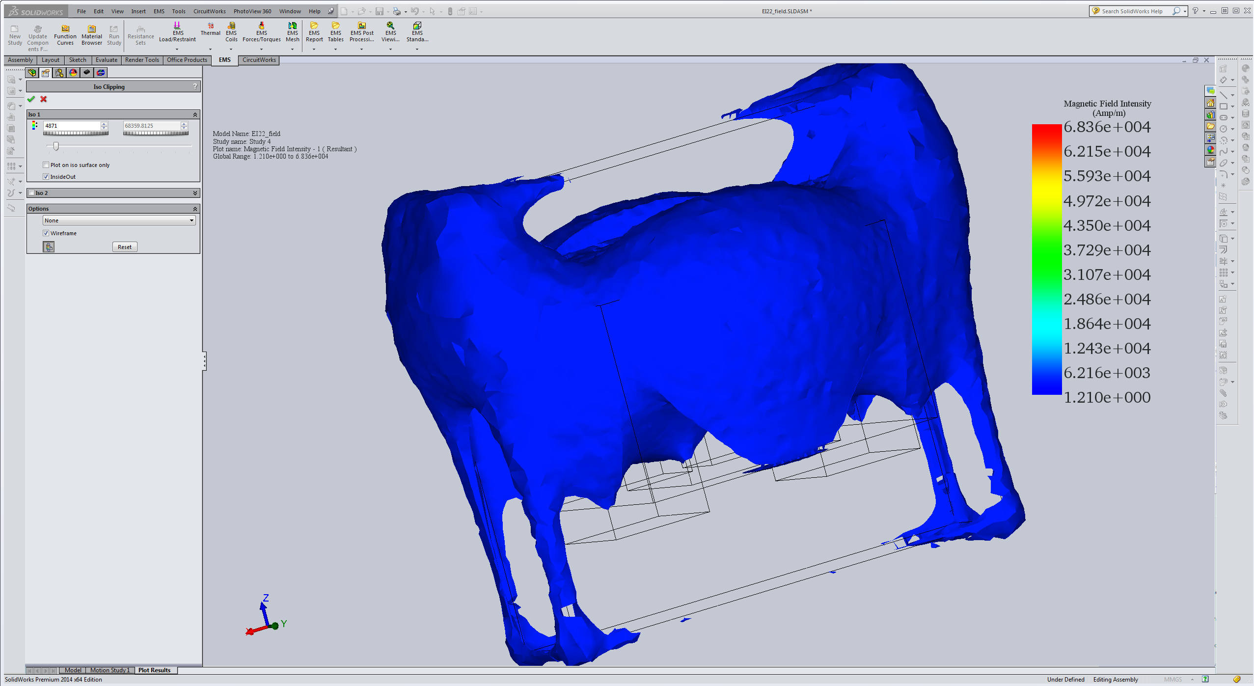

Nanoloop, what I call the HiFi-TOY MK1 has no one op amp, and actually, the S/N result with my SMPS + open loop amp -102db, that's damn good for such tiny size of true integrated amp with power supply onboard. And EMI will be fine as well, right now I do some tweak of LLC magnetics(see attached) 😉
PS: HiFi-TOY has 2 SMPS, one is 5W flyback for standby, and second one resonant LLC for the power amp.
