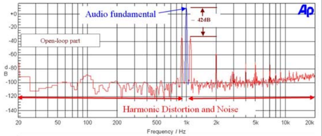

Hi there, I keep working on firmware so far, next step is IOS/Android apps. However, I can't stop thinking about the amp modification for tas5558+TAS5342LA(is there any other open-loop candidate?) with custom noise shaper. It looks quite easy in a simulation, at least for THD<.01% over audio band (equal for 100/1000/6000Hz). I don't know, maybe 15 years ago mr. J. Westlake spent a lot of efforts to get .00000% with ti/sony modulator + custom noise shaper + custom power stage but today get <.01% with tas5558+TAS5342LA looks easy, if not say trivial 😉 Let's try, only the size is an issue, I really wish to keep the same tiny format and 2x100W to get real Hi-Fi amp..

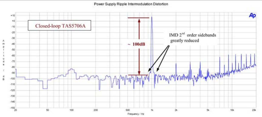

a noise shaper is the same thing as a loop-filter or an extra-integrator(as Bruno P. call it). BTW, further simulations confirm that the idea of partial feedback after LC filter is quite real too. It's doesn't help a lot regarding THD, but makes +/-.5db frequency response in the range of loads 4..8ohm.

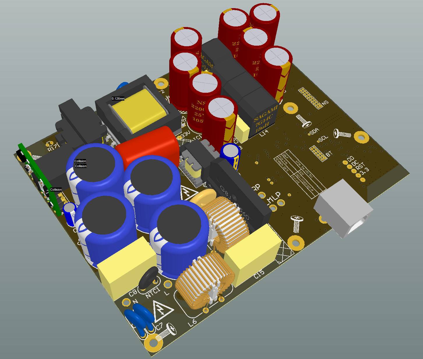

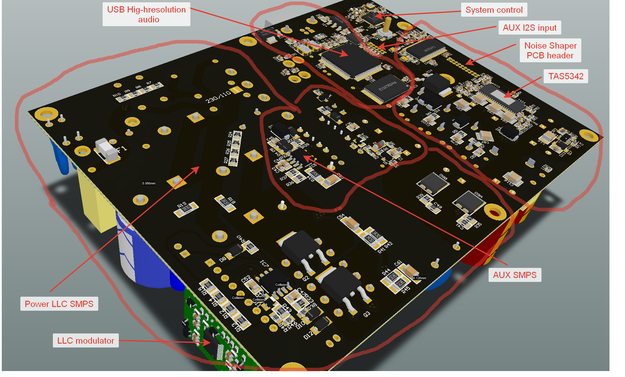

I'm impressed by the new design. Would you like to share some specs of the LLC operation points and transformer winding construction?
doctormord, the LLC uses 105..190kHz range, and trafo(sandwich type to reduce proximity effect) with external coil. A higher idle frequency may affect an S/N, so I stopped on 185-190kHz, I doing there some frequency shuffling to make bit tones(vs 384kHz) a noise like. That also good for EMI performance.

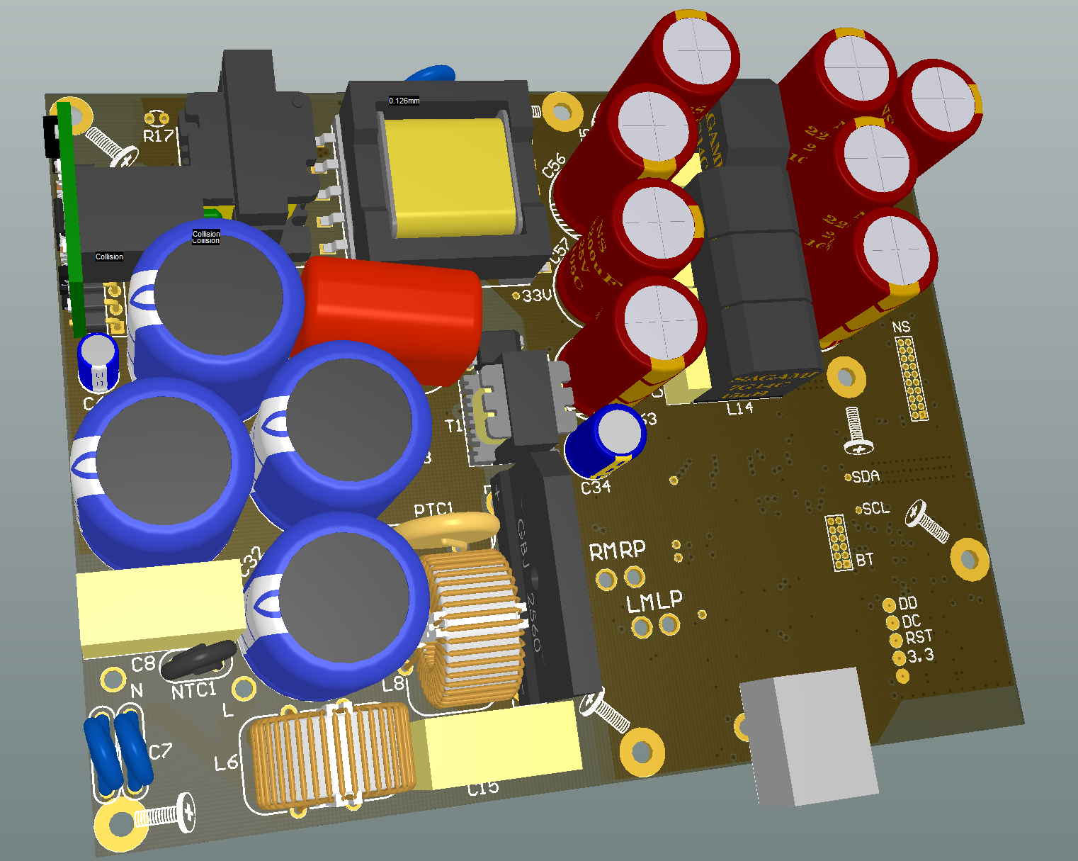

I've got 2 days extra because of the weekend, so I keep improving the PCB just can't stop ))
1) size is reduced again, now 127x100mm
2) two status LEDs are placed on the edge of the PCB to work with light-pipe
3) finalized silk
3) finalized silk

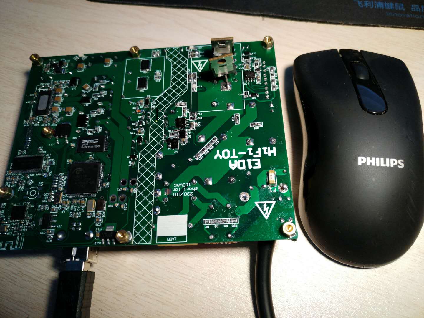

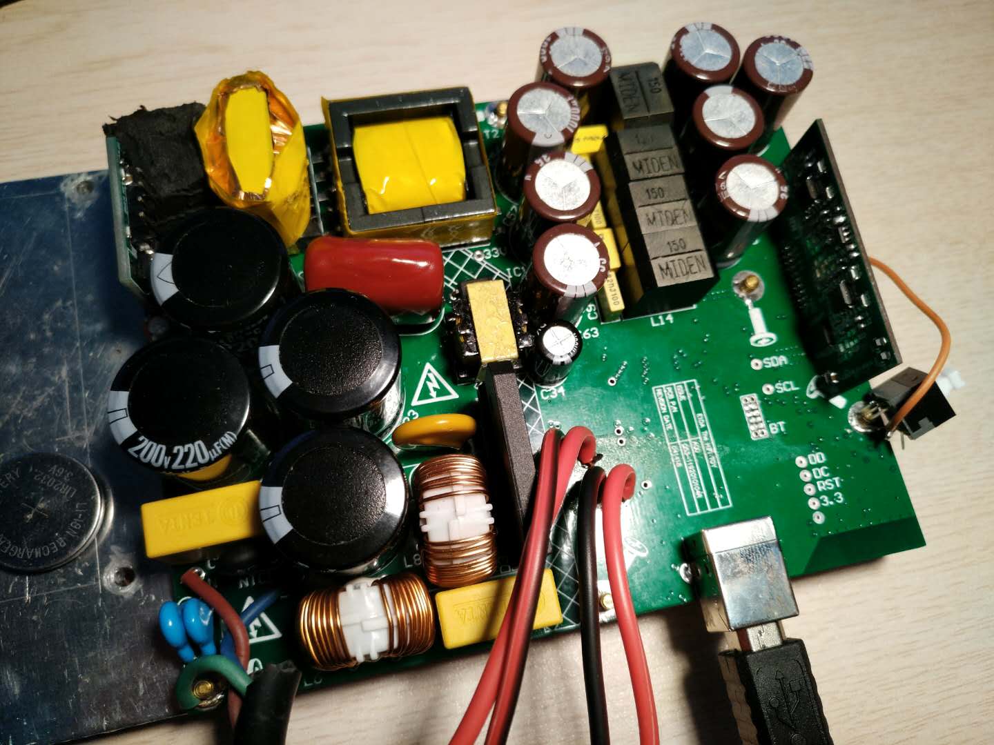

Just finished the new PCBA 127x100x30mm. Unfortunately, SMPS DPAK mosfets are only fake on Taobao, so I have to start with TO220 until getting std18n55m5. What I noticed right away with open loop Ti power stage(tas5342), it is crazy hot even if idle. For sure tas5342 has less dead time vs closed loop tas5624.

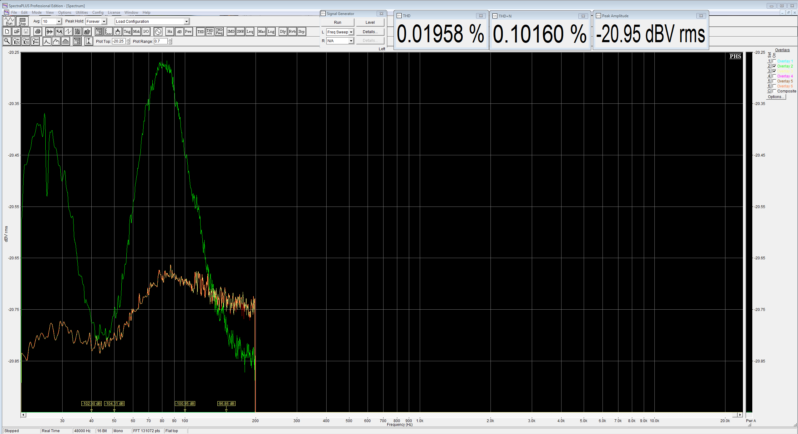

Hi there, I didn't finish the noise-shaper adjustment yet but can't resist and I've listened the amp in both modes(open loop/closed loop). The first impression was - hey, it sounds just the same open or closed loop whatever. However, my wife petty sure if open loop mode makes more bass. It was a bit strange because she said that just by the way, without deep involving to the listening process. I tried to hear the bass difference and played some fine bass tracks, and indeed the open loop sounds a bit more boomy and more punchy. I've tested frequency responses and found some really homeopathic difference(see attached). I guess the reason is output impedance difference for open and closed loop mode. Also, I think I hear the difference, not really about frequency responses but rather my SMPS dynamic response. In a highs both modes are pretty much equal, however, if listening level getting up(actually it should be quite loud), some sounds(sax, vocals) a bit losing transparency, becomes too smooth. I believe it is about THD+N which become huge in open loop mode(.2-.5% @ 1/2 max power). The amp is crazy hot(55C) on the 166x100x5mm aluminum lamina, even idle. No idea what to do with heatsink..
Guys(if anyone still reading my nonsense stream), I keep listening the amp, and yes, open loop mode sounds more pleasant, I'm sure. It is more relaxed and not so tight and not so refined as the closed loop. Open loop mode sounds less boring, less dry 😉 I asked my wife make for me A/B blind test, and I picked to the open loop sound with no doubt. Oh hell, 100 times less THD sounding worse ))
