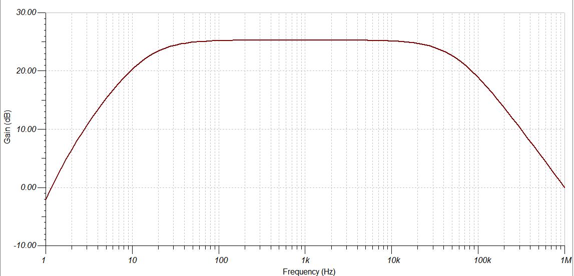

You'll have to try it, but that's certainly not a loud sound. The mic should be close.
There's something wrong with the gain scale in the graph.
Maybe cutting off the bass (say around 400Hz) will help to reduce noise.
The midband gain of your circuit is around +27dB.

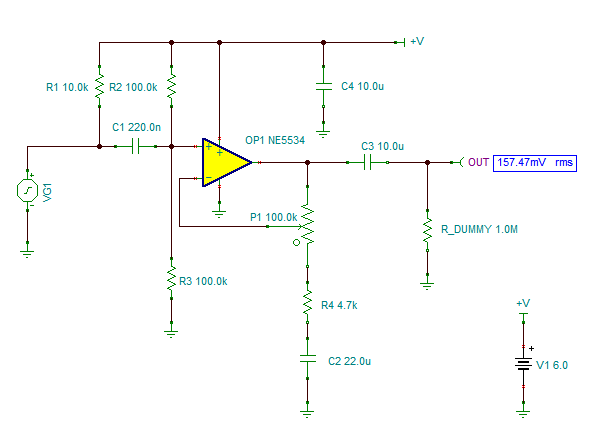

...Here's the circuit I'm using.
- Pin 1 of Voltage Pin Vout is floating
- Pin 2 of capacitor C3 is floating.
That's not the plan in your simulator. And I don't have TINA here to read your TINA file.
But I bet it objects to having one end of a capacitor "floating". SPICE *insists* on figuring the DC voltage on every node before it does any other analysis. But the "floating" end of a cap can float to ANY voltage.
Anyway in real life you would have a LOAD.
Put a reasonable load on that output after the capacitor. Now SPICE's tiny mind will figure the DC voltage here is 0.0000V and be happy.

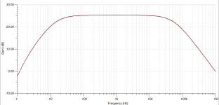

I looked at your diagram and noticed that you have the value of R2 set at 10k that the diagram shows should be 100k. I corrected that and set the trans-conductance of the controlled current source you used for the electret capsule model to a more reasonable value of 1mS, up from 100uS and got a gain sweep of around 24 dB. The trans-conductance value should be set to match the capsule you end up using.

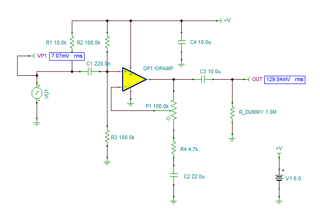

: still sround -35 dB
The gain should not be *negative* dB!! (That is loss.)
Something is wrong in how you are simulating. With VR1 at 100k and R4 at 1k the gain should be near +40dB.
I hope someone with TINA can read your sim file.
My version of Tina doesn't seem to have the part marked "Pa" (not sure what that is).
But a couple of things - it there power to the opamp? (it doesn't look connected to me, but ERC would test that).
Also - have you tried taking power to your electret module via the 10k resistor?
I'm not entirely sure how that works in simulation.

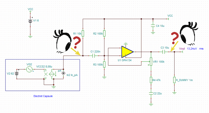

I don't get it... I have almost the same circuit and I get only 13,24uV! Why is that?..... And yes, the gain < 0...?!
Is it?
Your *assumed* input, divided by output, seems low. By inspection and by Tony's cross-check.
If you assume/hope the capsule works as specified, you do NOT have to simulate that part. What you really want is the AMPLIFIER response. Since lack of output "could be", lack of input, you usually want at least TWO meters on your workbench. Yes, this gets crowded and costly on a bench, but in simulation meters are free and small. LOOK at the input as well as the output. Maybe the VG VCCS pA assembly doesn't really do anything, or not the right thing. Check Everything. On bench I sometimes have 3 meters reading 5 points, and at least as many in sim.
