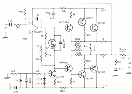

It probably doesn't matter what the exact effect is called. But there IS a very distinct effect with HF impedance on Class B amplifiers. You can hear it.
At HF, amplifiers run out of open loop gain and current very dramatically. It can fall from 500,000 to 50 or so. Hence the whole feedback game doesn't work very predictably.
Your circuit is not dissimilar to the sort of thing you fit at the output of a Class B amplifier for stability reasons. See below.
An amp is generally tested into an 8 ohm dummy load, and probably optimised for that too, since THD figures affect sales. But lighter loads, and remember a tweeter is nearer open circuit or inductive at HF has a different response. The 0.1uF/10R Zobel is fitted at the output of the amplifier here. You can see how no load tends towards resonance or instability, but the Zobel saves it from oscillation with no speaker attached.
Here's a couple of other ways of getting a lower supersonic impedance with a Zobel or a 22R. I use both. They sound better IMO.

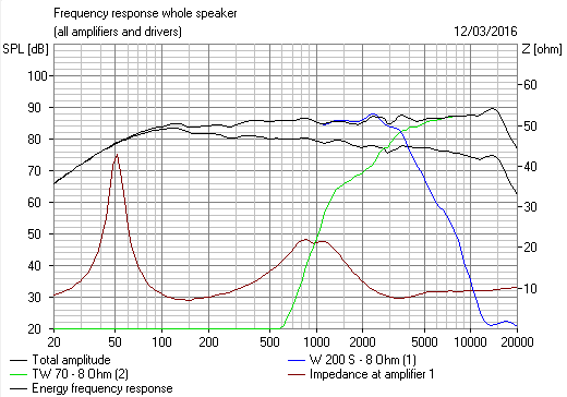

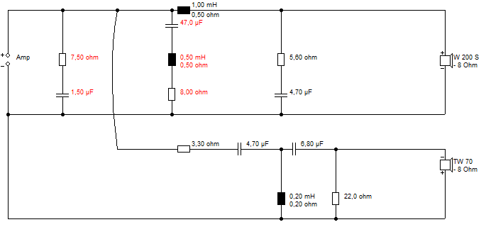

I found a kindred soul in Joe Rasmussen, who has tried equalising impedance to pure resistance totally. Hard to do with the bass peak, because of the values involved. But otherwise quite easy with some circuits.
Some ideas below. The red components are just impedance correction. The Sonus Faber Grand Piano Impedance looks VERY amplifier dependant. Sort of thing I avoid. But a moderate 1kHz impedance hump is not a terrible sounding thing. Most amps ought to cope with that.
