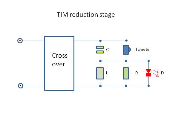

In the old days before T/S parameters - in this particular instance that means 1977, we had a loudspeaker guru here in Denmark with the name of Peter Holm. I don’t exactly know his background, but it was academic with a lot of practical experience. He was somehow connected with the distributor of Goodmans speakers out of the UK.
He designed a TIM reduction stage for treble drivers, because TIM distortion with frequencies above 20 KHz needs somewhere to go, not to distort the area below 20 KHz, and not to be converted into heat in the treble driver voice coil eventually killing it.
It all seems very plausible, and it is actually just another 6 dB ´way´ in a traditional filter, and can be used both in parallel and serial filters, and it only needs 3 components - 4 if you want a visual indicator.
Hopefully the picture is attached.
And here are the formulas:
f the attack frequency of the filter, down 3 dB
R the nominal impedance of the treble driver
C 160,000/(f x R) in uF
L (160 x R)/f in mH
D standard LED (optional)
Example, 8 ohm driver, and 20 KHz:
R = 8 ohm power resistor, probably 5 – 10w will do
C = 160,000/(20,000 x 8) = 1 uF, plastic crossover cap
L = (160 x8)/20,000 = 0.06 mH coil
If you can’t get the coil in the right value just buy the closest one larger, and hook it up to a inductance meter and unwind straighten out and measure until the value is right, then cut the excess wire.

Yes the diode will rectify the signal above 20KHz, but do you think it will affect the signal that comes out of the speakers?
Yes, it will because it interacts with the impedance and the amplifier. The C/L pulls the impedance quite low too btw. Not every amp works great with something like this, some will start to oscillate others will behave quite odd, i.e. class D amps don't like fluctuating impedances, esp. in the treble, it interacts with the output inductance/filter.

Sorry I didnt explain the circuit well enough.
The schematic shows a 2 way 6 db/oct. serial filter where the tweeter gets all the frequencies up to 20 KHz, and R (the super tweeter if you will) gets all the frequences above 20 KHz.
The reason is that the TIM has to be burned off somewhere (in R).
Why a diode - because you would maybe want a visual indication if some TIM actually is burned in R.
No, that's completely wrong. If it's not produced in the tweeter, fix your signal chain. If it is produced in the tweeter, it will be radiated from the tweeter because it's already in the mechanical system. You can't just shave off the TIM and put it somewhere else.
That's something you got completely wrong too. You can hear it way before the LED becomes lit. And the LED makes it worse, not better in any way.

This is just very poor theory masquerading as knowledge.
Organ amplifiers are a classic tweeter fryer due to simple
amplifier clipping on sustained notes, and the circuit will
not do a great deal to alleviate the basic problem.
The circuit is pretty harmless, and probably inaudible to
anyone over say 40. Its just a crude 1st order filter at
20KHz, a simple series inductor would do the same job.
(A parallel 50R resistor before the inductor is an idea.)
It is of course a nonsense the energy has to go somewhere.
For the series inductor it simply doesn't get out of the amplifier.
rgds, sreten.

This energy would be converted to heat in the treble driver - where else should it go?
In the case of a simple series inductor between tweeter crossover and tweeter it will simply not be generated from the beginning ! Simple as that.
I don't beleive in the TIM reduction thingie either. In the case of TIM damage is already done and it can't be undone by simply cutting off sound that is not perceivable. But you will introduce a further unnecessary response error with this cuircuit.
If there is one place where a lowpass can reduce TIM then it is at the input of a power amp. But as long as an amplifier's slew rate is high enough, TIM shouldn't be of concern.
