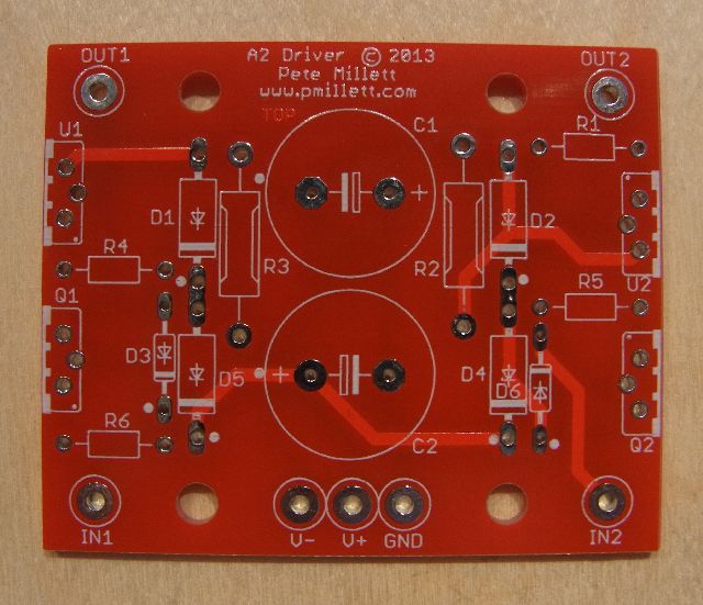

Isn't the recommended Pete Millet mosfet source follower pcb for push-pull?
Using it doesn't make sense.

Nobody's talking about pcb's. The OP found that the original design was inadequate, and folks are suggesting fixes to an existing, working OK but not optimal, amplifier. I think we could all agree that the original design was poorly thought out.

yes, but no reason not to be able to use that for this project...
Read Tony Tecson's posts 43 and 51--he does so.
Using a PP pcb for SE doesn't make a lot of sense but as he days it is doable

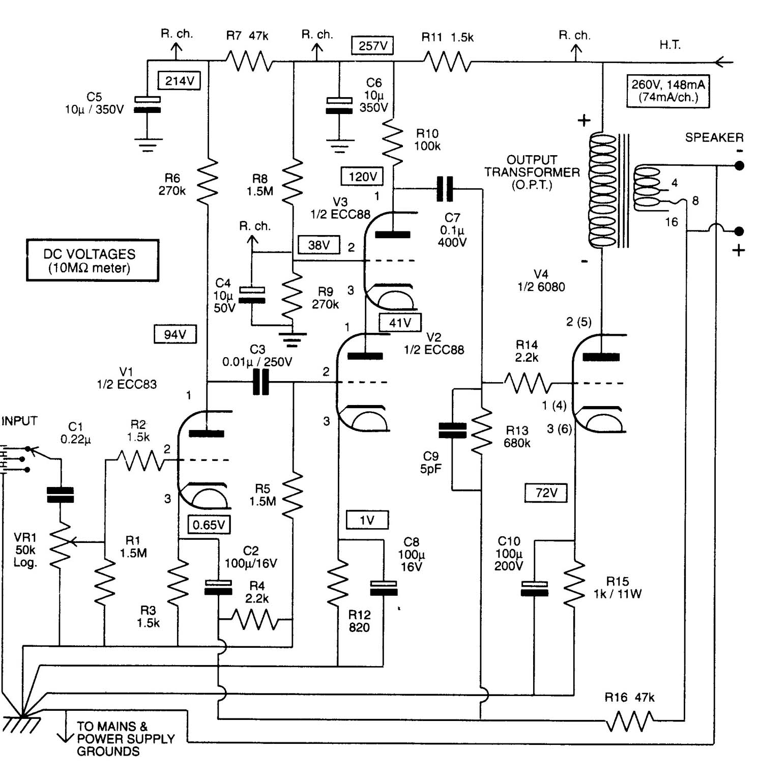

I'm not sure which design the OP built as the designs he presents in posts 4 and 8 are NOT the TdeP design.
It seems that the sims being presented are not of the correct design.
Yje correct/original design is in post 42.
The design in #42 has far too much gain, do the numbers, don't even need a 4-function calculator. The output impedance of a cascode is essentially same as a pentode, dominated by Rl. the load resistor. Parallel that with the following Rg & the very high R of the Cascode, you have the answer.🙂
TdeP suggested that the trick to use the 6080 in SE was for it to swing 200V peak to peak into it to get enough drive.
The amp has/had a sensitivity of around 200mV (for full output)---it is an integrated amp not a power amp.
Local feedback (R13) is used to get enough bandwidth from the driver stage and to keep it linear over its wide operating range.

Hi, I originally built a copy of the circuit in #42, and the static values were in the ball park of the values on the circuit. My HT was 10 volts higher. I found the amp struggled with asymmetrical slewing, and also would have needed carefully selected ECC88s for symmetry at the cascodes output, a feature shared with the 859's cascode incidentally, but in that case required to set the output tubes bias current, subsequently improved on the 869. So after a bit of playing around I ended up with the circuit in #8, and it now works very nicely, and is a good amp imo.

Mine still struggles with HF, but can now get to 20k sine with symmetrical slewing. I have a lot of respect for Tim, young me worked for him in the mid 90's. He did like to keep things close to his chest, but I learn a lot, and maybe worked out a few of the little tricks for myself.....

With 70V on the cathode 200V p-p is terrible grid clipping. Something a serious guitar picker might do to enhance the performance. 140V p-p gets full drive in Class A.
BW will be determined by the OPT more than any other factor. No point in a driver with response from DC to green light, doesn't matter.🙂
Good design does not need hand selected components every time.😱
I did sim the original TdeP cicuit from post #42.
The total open loop gain (w/o both FBs) is 63dB which drops to 30dB with FBs applied, so about 33dB GNFB. No surprise as both the ECC83 and the cascode have high gain.
And yes, sensitivity is around 0.2 Volts. THD at 2W into resistive load about 3%, 2nd harmonic 10x higher than all the rest. Output impedance about 1 ohm.
The interesting things happen when the local FB is removed, R13 connected to GND.
This does not change the overall gain too much, just a little, +3 dB maybe.
But both, THD and output impedance, drop to 1/10 their previous numbers, THD is now down to below 0.2% (from 3%), output impedance now down to about 0.1 ohm (from 1 ohm), at the same 2W output into resistive load. And the sonic signature has lost its predominant 2nd which is still bigger than 3rd but not by much.
It seems that the FB through R13 reverses some of the effects of the huge GNFB and makes the amp appear more "tubey" ...
By the way, in my sim the output of the cascode was also a little low and produced early clipping which could be corrected by lowering the 100k load R10. And the cascode is quite sensitive to tube parameters, using slightly different tube models moves its output up and down +/- 20 volts easily.
