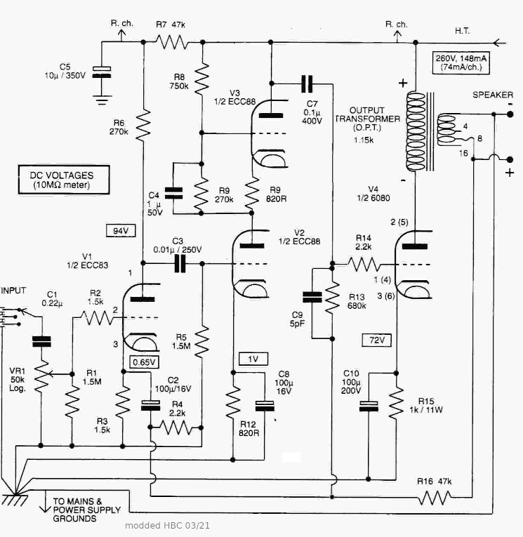

Dangerously large grid resistor for four valves run hot and heavy. Inadequate B+ voltage for driver section. Scary combination of long loop feedback and no deliberate HF dominant pole. Lots of similarities, but with added bonus of stacked LF RC poles, tiny output valve cathode bypass caps, output valves at 130% of dissipation rating, and a questionable claimed power output. What's not to like?

Perhaps Tim DeP knew what he was doing but the records of such are a mess. What was his background, can we find any other samples of his work?

agree on the plate dissipation ratings, a 6528 would be a better choice here..
a simple aikido front end would have been better without the need for global feddback...my take..
EAR Yoshino | Home
he designed a lot of tube amps for Luxman......
