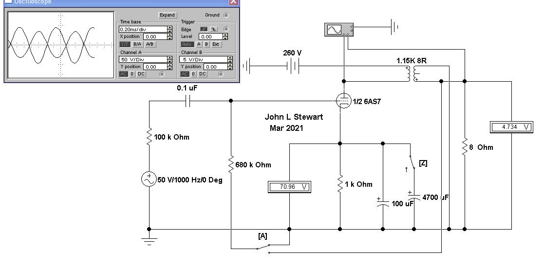

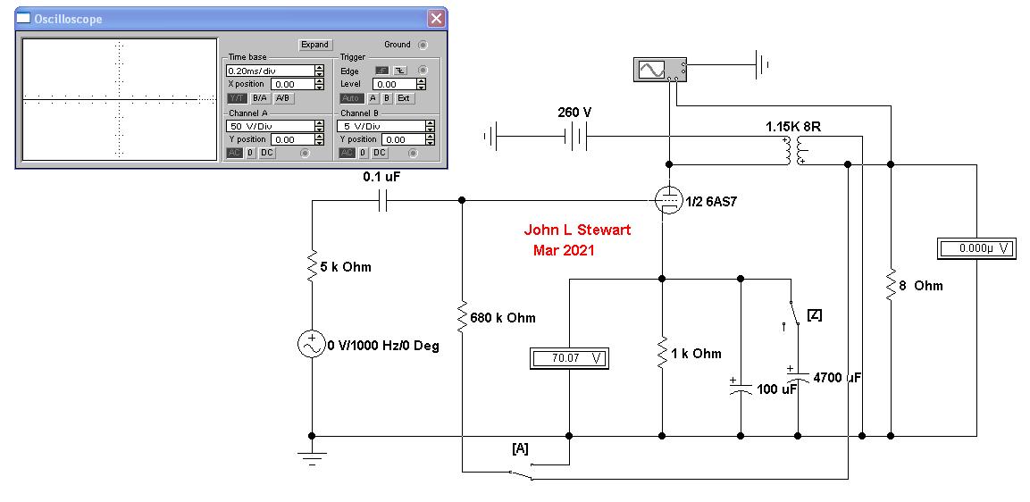

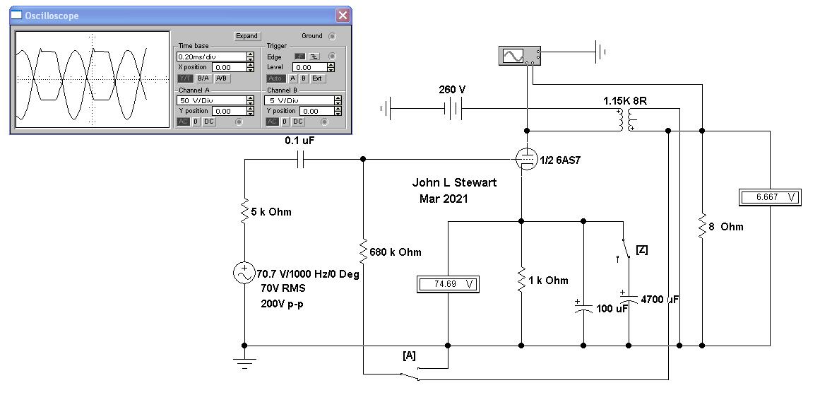

Who Said Drive The 6080 With 200V p-p
Pls step forward. How do you think this would 'sound'?
One sim shews steady state at no signal, the other bias shift & terrible waveform.
I get the sense that people are simply throwing darts at the problem. Not much thought, just hope it works. That is not how real development is done.🙄

Thanks for this, I find it comforting that the problems I encountered in real life are present in the sim. Unfortunately the sim also has
my version down 13dB at 20kHz, where as the original is only 10dBs down...... I can assure you much better in reality!
Also confession time, on my circuit in #8 the left hand R9 should be 27k, not 270k, well spotted, and sorry, seems I am getting a bit rusty with my colour codes, as my eyesight slowly deteriorates.

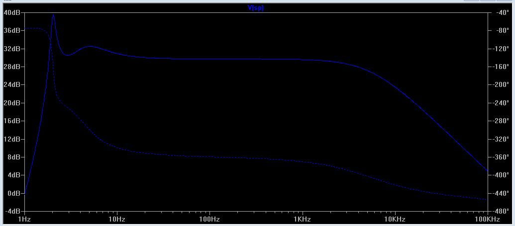

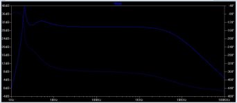

Simulation FR of the original.
Both feedbacks are negative. the 6080 grid is in phase with the output.
...the sim also has my version down 13dB at 20kHz, where as the original is only 10dBs down...... I can assure you much better in reality!
... the 6080 grid is in phase with the output.
true, 6080 grid is in phase with output ... and what happens if you *add* some of the output signal by means of R13 ? isn't negative FB when you *subtract* a fraction of the output signal ... ?
as for frequency response in sim the problem is that in spice the transformer model is an ideal with constant inductance over frequency range; whereas in reality inductance is high at LF and drops significantly with rising frequency; say 10H @ 50Hz / 1H @ 5kHz / 100mH @ 50kHz; so you can't sim both ends correctly at the same time with the simple model - put in 10H for the primary and get an idea of the LF response (and ignore the HF end) - or drop prim and sec inductance to 1/10 and look at the HF response (and ignore the LF end); the coupling factor (I used 0.995) also affects the HF as it represents leakage inductance; try 1 for a change ...

Since this issue of positive feedback seems to creep back into the discussion, let's define how much there actually is, in any of the proposed versions. Signal from the 8 Ohm output tap is attentuated by a factor of 52.8 at the "bottom" of R13 + 5pF. In the TdP version with cascode driver this is further attenuated by a factor of (minmum) 6.8 to the output valve's G1, for a total of 359. (In SRPP, that number is even higher.)
Supposing that the amplifier could make 5 Volts output into load, that's .014 Volts feedback at a grid with 50 Volts signal. So, there's no significant positive feedback. Effects seen are as the OP says, all from negative feedback to the first valve's cathode.

Output Stage FB
About 0.11 db +ve. I assumed the signal source to be 100K, the combination of the load Rl in parallel with the cascode driver plate resistance.
Thanks for the spice transformer info. I don't understand why it works, but it does. Bit of work for me to fathom that one.
This is interesting in this case, the #42 circuit is flat out to 24 kHz and dp's honor is upheld. The 5pf slows the drive down, and in the simulation the effect is the 6080's grid drive making it slower but symmetrical. Interesting.
