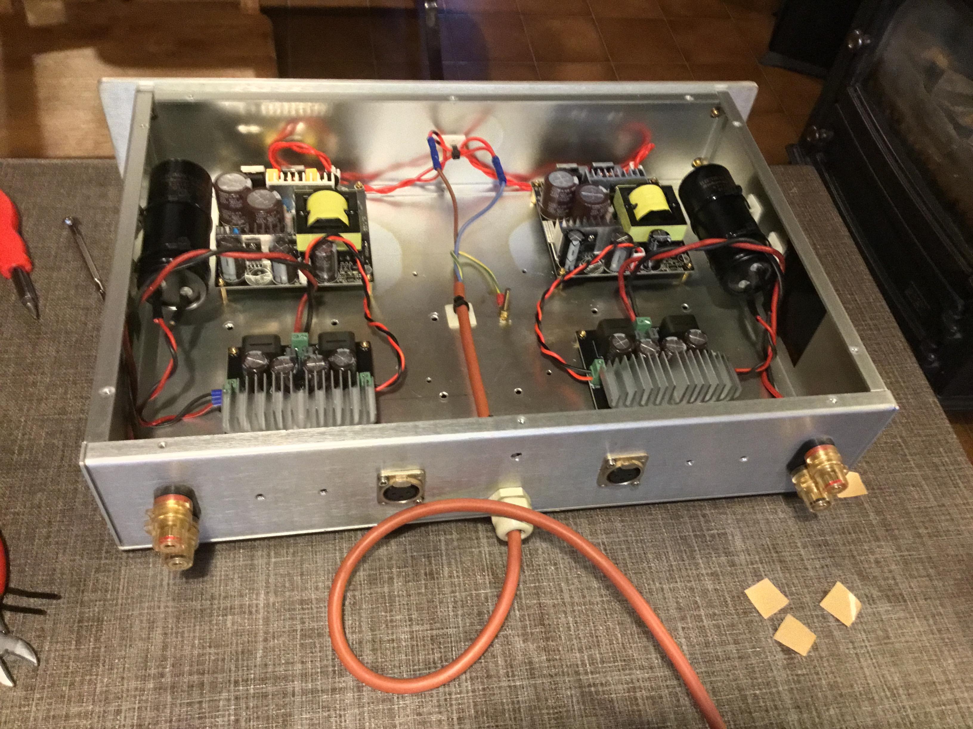

Hello,
Bypassing op-amps on my TPA3255EVM was a succes
Installed final wiring and put cover back on
Difficult to put in words
I like what i am hearing 🙂
I can easily say the best free tweak i ever did 😀
Enjoy...
what i did was to pull out the 3 pin molex connector and solder shielded balanced mogami cable directly into the board for XLR inputs. god i hate Molex. always loose, always coming off. always flimsy specially when i have to make it.

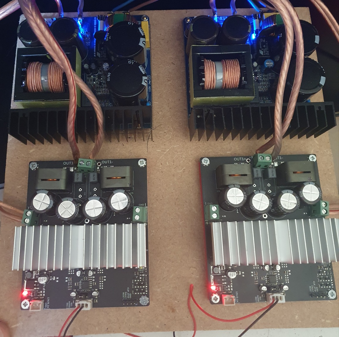

Hello,
I'm building a personal amp.
I have 2 3eaudio tpa3255 pbtl boards, supplied by 2 smps 48v 600w.
At the moment they are connected via RCA to a smsl A8 used as a pre amp. Maybe the problem is related to it?
The sound is quite nice but I feel there is not too much dynamic (very low bass) despite of the huge power I should get.
So I'm investigating what I could improve on those boards. Output filter ( they are 10uH a 1uF), or op amp bypass...
Hello,
My friend has a 3e audio dual mono TPA3255
No problem with bass
He uses a big 10000uf cap on dc power inlet
If your dac has a preamp stage you dont need the smsl
Enjoy...

Hellooo
I have the exact same configuration, boards and power supply.
I have no DAC at the moment that's why I use the smsl as a preamp. I think the problem is there.
I was about buying a topping D70 but I will probably buy the new audiophonics dual 9038q2m instead, with RPi option.
What are the big cells between supply/boards are for?
And about the op amp bypass?
