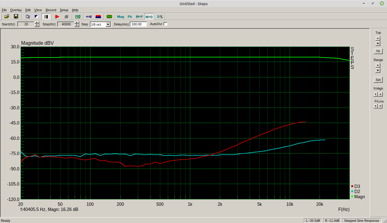

As size matters, these provide about half the saturation current than the bigger ones. They are fine for 4~8 Ohms, I would not recommend them for 2 ohms. I attach two recent test plots at 5Ohms load with these inductors. H1,2,3 vs frequency was measured at 10Vrms output (TPA3251 @30Vd supply)

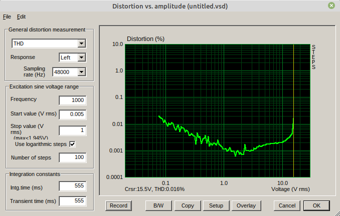

I have made more progress . This new FFT was made after optimizing zobel network . Instead of one cap and one R I used 3 caps in parallel with 3 R in parallel . THD is 0.00045
Note also the absence of H3 . Basically there is no change between 100Hz and 6.67Khz (rise is almost null )
Notice also the lack of H5 -H20
I think that at this point this is the best measured TPA3255 (at 5W , 1Khz , 8R)
