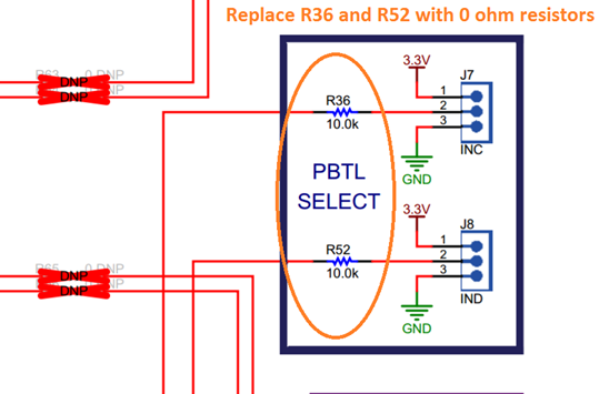

Good Link - Bugger
I didn't use the board in PBTL mode. I used 4 channels, so I didn't have your shut down problem.
It looks like your problem has been documented, but
... bugger...
It's kinda' good to know what the problem is but frustrating that you spent good money and received a "SE Asia" / ebay quality board with problems.:mad:

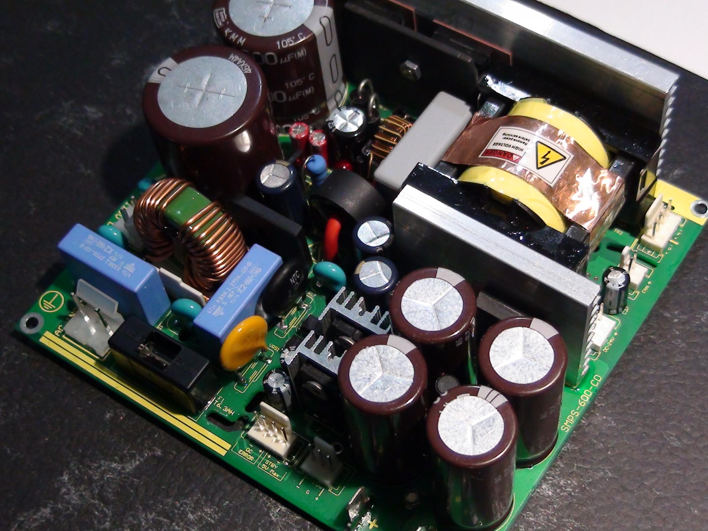

My TI TPA3255 EVM project is gong to make progress. I've bought this SMPS. It provides a DC OK signal at pin 7 of the DCN100 connector that goes high when the PSU works stable. Is there any use for it, for instance to avoid noise when turning the amplifier on or off? How could it be connected to the EVM module in this case?
Best regards!

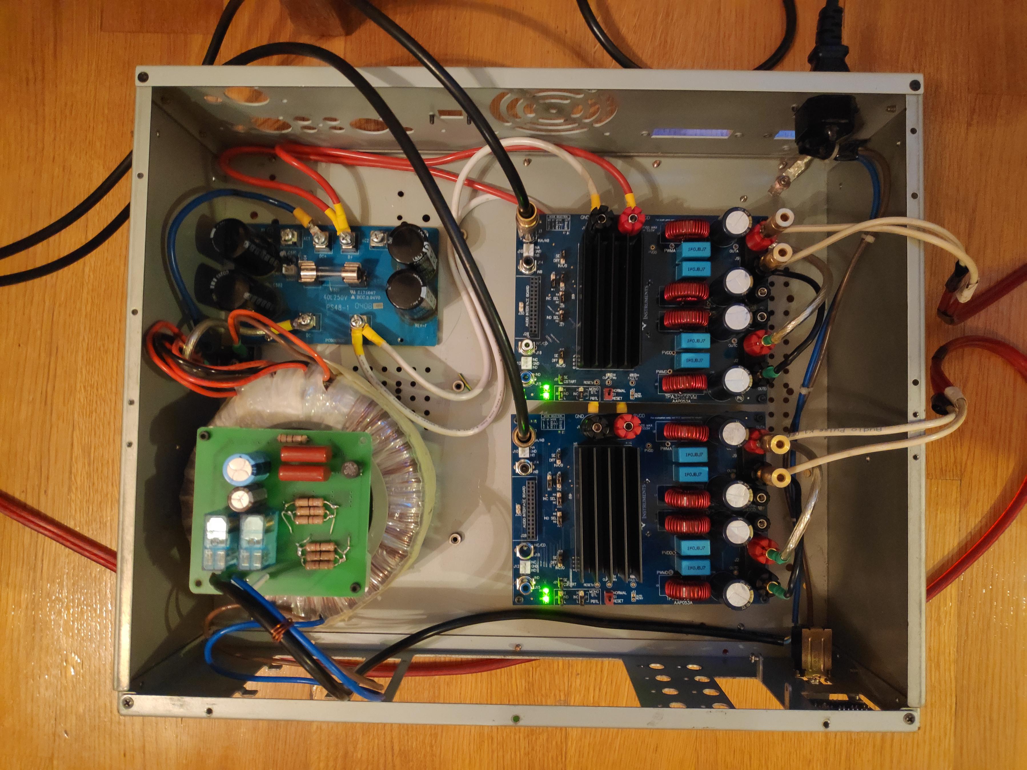

I first stumbled across this thread today and went quickly through it, but could not find the information I was looking for.

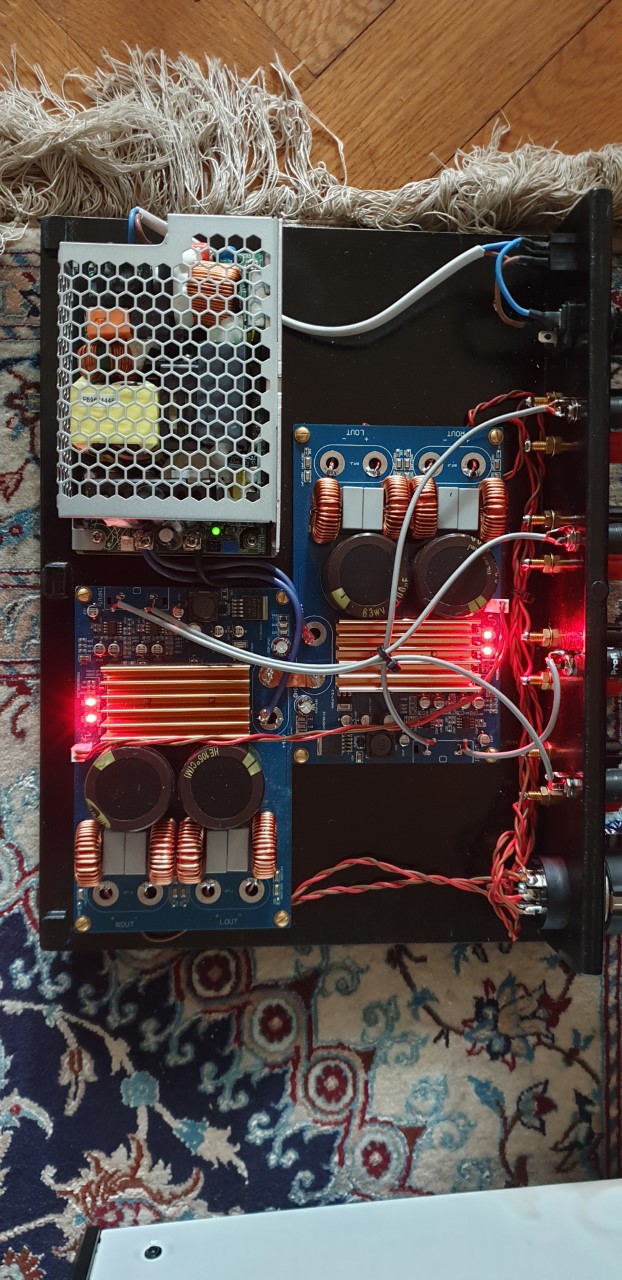

Can two of those blue 3255 boards be attached to one power supply? I have worked with class D amps where a beat tone could be heard when two amps were attached to one power supply.
Has anyone experience with this?
Thanks ahead,
vac
I believe a few users did go with 600w smps and two boards with no consequences, but, financially, the 300 watt smps are very reasonable so I, among most, chose that route. Also it allowed the flexibility to package these separately with short speaker cables in an active arrangement, but my stuff is in a mess, so I'm not doing that yet either, hah.

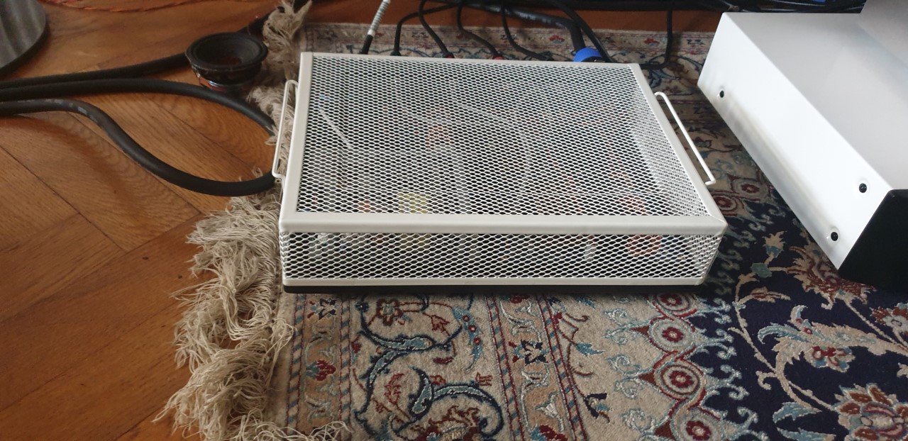

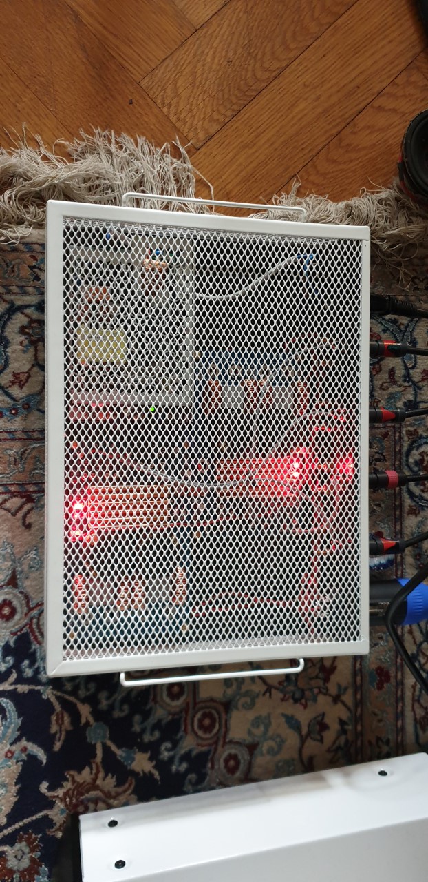

Under pressure to host an 8/10/19 Southeast Michigan gathering of Klipschheads, I finally put my TI TPA3255EVM into a case. Without the ability to split the balanced signal from a Pono player, hooking up my four DIY Anarchy Exodus TH subs was problematic. Now the signal can be passed through to the pair of iNuke 1000s; each one powers a pair of subs.
While the 3255 project languished, I happily listened to a Wiener TPA3118, visible in its case next to the 3255. While I could be happy using that amp as my latest “final” 2-channel amp, listening to the 3255 again reminds me of the difference, even without the subs.

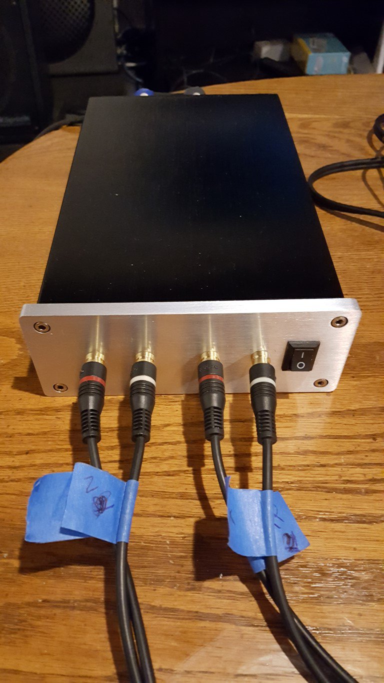

I agree using four RCA connections seems counterintuitive. Nonetheless, that’s how I connected it before putting it in a case (XLR connectors replaced RCA). It helped me to remember that each balanced output consists of a + signal and a - signal. There is no common ground. One RCA pin delivers the + signal and the other RCA pin delivers the - signal, thus two RCAs are needed for each channel. The RCA collars are connected to the shielding, which is connected to ground.
The attached photos show a TPA3118 Wiener amp using four RCAs to accomplish what my 3255 does with a single XLR connector per channel.
Thanks ahead,
vac
This is what the master and slave mode (plus freq mod interconnect cable) is for with respect to the switching frequency. If you experience the beat note, the two amps need to have the same synchronous modulation in order to prevent it.

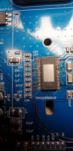

Thank you for your kind response. In the meanwhile I have gotten to understand this chip a little better; needed 2x4 channels amplification fast and decided to work with the Chinese boards for reasons of speed and economy.
Unsynchronized, they make a lot of noise when put on a single power supply. So some soldering is required to put one in slave mode, and to attach two wires to the synchronization pins, like so
To put a board in slave mode, the 30k resistor has to be removed and a connection has to be made to the chip's on board LDO. Not shown here.
