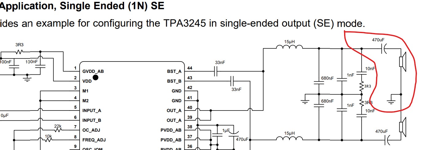

All I can say the TPA3255 needs symmetrical input drive in any BTL configuration.
To check the outputs, drive your input with some music,
take a loudspeaker
1 terminal connected to GND
Connect the other terminal through a series cap of 470uF/35 or more, to each single PBTL output.
Cap-/cap+ connected to speaker/PBTL - output respectively.
This test should show one working output and one silent output.

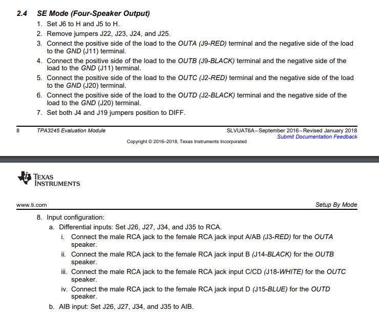

I'm going to test it with some music and attach a scope. If there is no anomaly I'll try the second part which IIRC is running it in SE mode?
So I would need to reconfigure the jumpers to SE mode first as seen in the datasheet text in the attachment right?
I've also attached an image and I've circled the connection with a red marker that you are suggesting, did I understand it correctly?
Do TPA324X and TPA325x need a load on each of the outputs while it's on like the TPA311X needed it if you didn't want to destroy your outputs?
You advised retracing, I did not mess with any of the jumpers, this problem happened right after cap change to a smaller value, the volume was balanced before that no matter which device I used to drive it (DAC, Android phone, both via RCA cable). I'll try to retrace If I find the silent output.
Is it possible that solely the wrong cap value (0.22uH paired with 7uH inductor) would cause this channel imbalance if it was soldered properly? This should only have an effect on gain/attenuation at the higher frequencies and even if it would cause volume change, it should be symetrical in all of the outputs, right?

I'm going to test it with some music and attach a scope. If there is no anomaly I'll try the second part which IIRC is running it in SE mode?So I would need to reconfigure the jumpers to SE mode first as seen in the datasheet text in the attachment right?
You can test in (P)BTL mode as well, both output legs should provide music, no need to set to SE.
With no load on the outputs there is no danger of destruction. In the worst case the chip protection triggers and shuts down immediately after turn on. But I did not experience this problem until now. Btw I am using my own designs, not that AliBaba stuff.

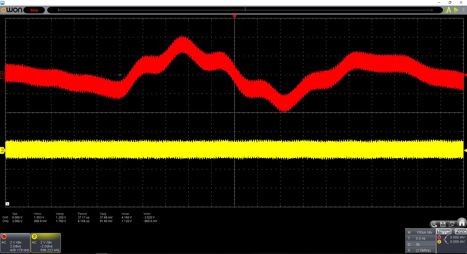

Hi voltwide,
I've now been able to test each of the output with some music and a scope probe attached.
I do (hopefully) believe I located the output, that is not making any sound. See the attached picture please.
3 of the outputs have similar waveform when playing music (same as the upper one in the attached picture) and 1 is static DC like you predicted, if I'm interpreting this correctly?
So my next move would now be to check the input for this channel and the rest of the analog front end, and compare it to the other 3 inputs, that are obviously working fine.
Is there any possibility, that the DC blocking caps don't have the same capacitance or rather there may be large variability between parts on different inputs (A,B,C and D). I will retest but I'm pretty sure I measured one of the 10uF electrolytic DC blocking caps having 13uF capacitance (DMM capacitance measurement).I've attached a part of schematic, where those parts are shown in circuit.
Could this have a significant effect in regard to input symmetry, that you mentioned in one of your previous posts?
If not, what would be the best way for me to start troubleshooting the inputs. Live circuit, power off...?

Yes, the yellow scope trace shows the silent output.
Both outputs traces show a bit of "smear" - which is caused by the clock ripple residue.
In other words: Both outputs are operating - but the yellow is not fed with audio signal at its input.
Great, we are on the right track.
Coupling caps with 13uF instead of 10uf are not suspect at all - 20~50% tolerance normally does not matter here.
So you should trace now the signal path leading to the input without signal.

Well good news, the silent output channel came alive after I probed all the input channels and found no differences between inputs.:confused:
The only theory I have is, that one of the headers could've become unseated while I was flipping the board over while changing caps.
Whatever was wrong, it now seems to be sorted. I appreciate the help!

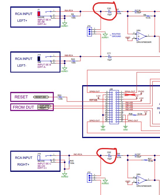

The schematic is page 17 not 18.
The thing that confused me is that I think J10 should be named
INA/B DIFF INPUT instead of INC/D DIFF INPUT, (just like J12)
And they should never be jumpered (tables correctly always show 'out') but are included in the tables so people don't as J4 and J19 are used for selecting between SE and DIFF.
You can use J10 and J12 or use the rca (2 per channel) connectors as differential inputs. On page 17 you can see that they are the same.
You could connect the balanced inputs to the audio interface board, pins 11, 13, 15, and 17. Connect ground to pin 21. I think a 20 awg solid wire can easily be pushed into each pin.
This would bypass the op amps, and leave only the 10uf coupling capacitor in the signal path.
The chip's input impedance is 20k.

ABSNimes, regarding differential input to the 3255EVM board, in stereo BTL mode, there are two slightly different approaches;
i) connect to the J10 and J12 headers (or all 4x RCA connectors, which I consider confusing) -
your audio signals will still be buffered by the NE5532 opamps, but remain fully differential.
ii) connect to pins 11,13,15,17 & 21-GND of the J28 header (as member mboxler suggested)
your audio signals will then bypass the opamps, and go to the TPA3255 simply via a DC blocking cap.
