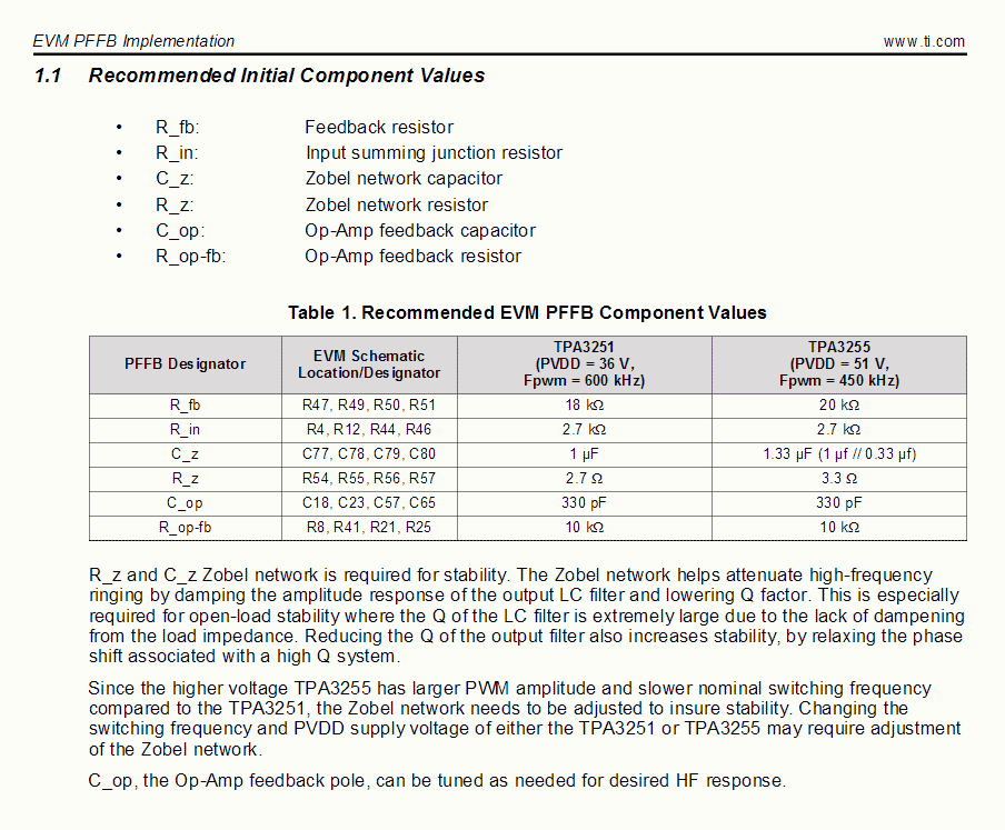

Thanks for the helpful suggestion - found the document in question, but I still have a question or two. I found those empty solder pads for most components needed to implemet PFFB but what about those parts which don't seem to have such a fixed spot (namely C_fb_in and _out and R_fb_gnd)? This is all pretty small below the board so I am a bit at a loss here. Any support will be greatly appreciated - thx in advance.

You'll patch it in at the pads for C73/C74/C75/C76 like a T-filter.
The EVMs PFFB is an older approach which (to my knowledge) wasn't stable with all loads. The newer implementation is stable at all time.
Voltwide implemented a minimal PFFB with only one capacitor per channel to tune for best square wave responce without overshoot even when unloaded.
The older SLAA702 isn't available from TI anymore, which was meant for the EVM, attached is a local copy.

No, the 3251 and 3255 EVM where made for a different implementation, not having the capacitive "T" arrangement. They just use a single cap.
