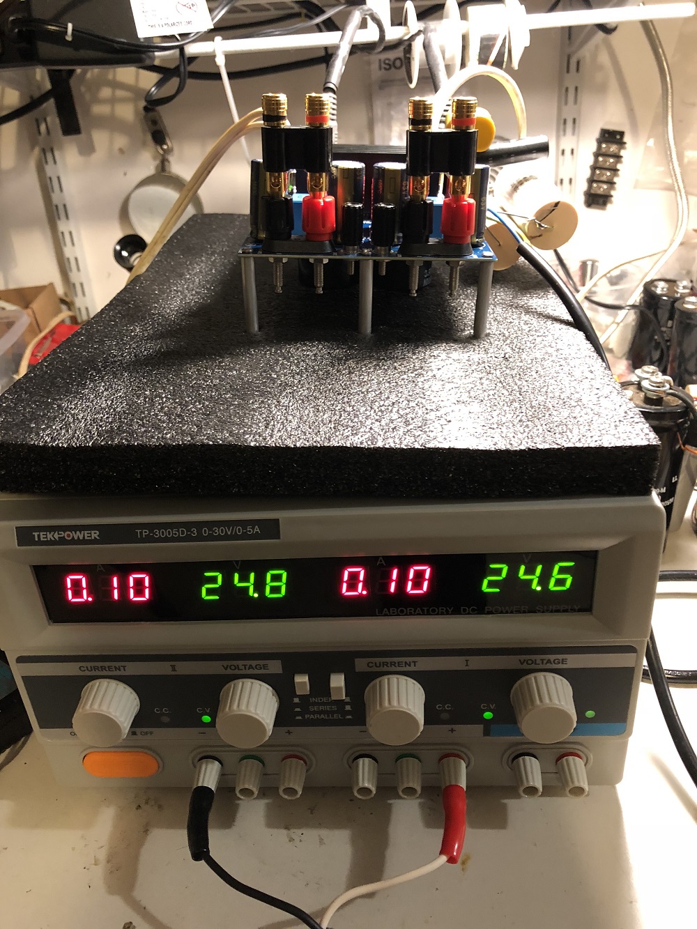

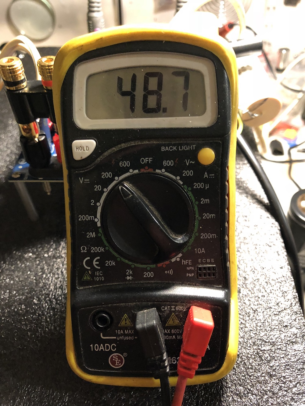

Finally wired up the TPA3255EVM today, using the lab supply (30v/5A x 2) in series mode. With the module in 2 channel mode quick measurements show that DC offset at speaker terminals tracks the power supply voltage. Lowest offset of 0mv +/- a few tenths of a milli-volt were at at 48.7 volts supply. Current draw at idle and low volume seems to be about .2 amps at 48.7 volts supply. Always check your offset at the speaker terminals but the module seems to be optimized for a 48 volt supply.
The lab power supply is linear (large toroid) and regulated and always sounds good on amplifiers dues to low specified noise and ripple. As a further step I'm passing the output through a 50uh choke with 10,000uf Sikorel pre choke and 100uf of film caps post choke, and there's STILL an audible improvement using another film cap right at the board where the power connects. This board is fairly responsive to how quickly it receives current, with a notably clearer sound, and deeper soundstage with film caps right at the power terminals.
