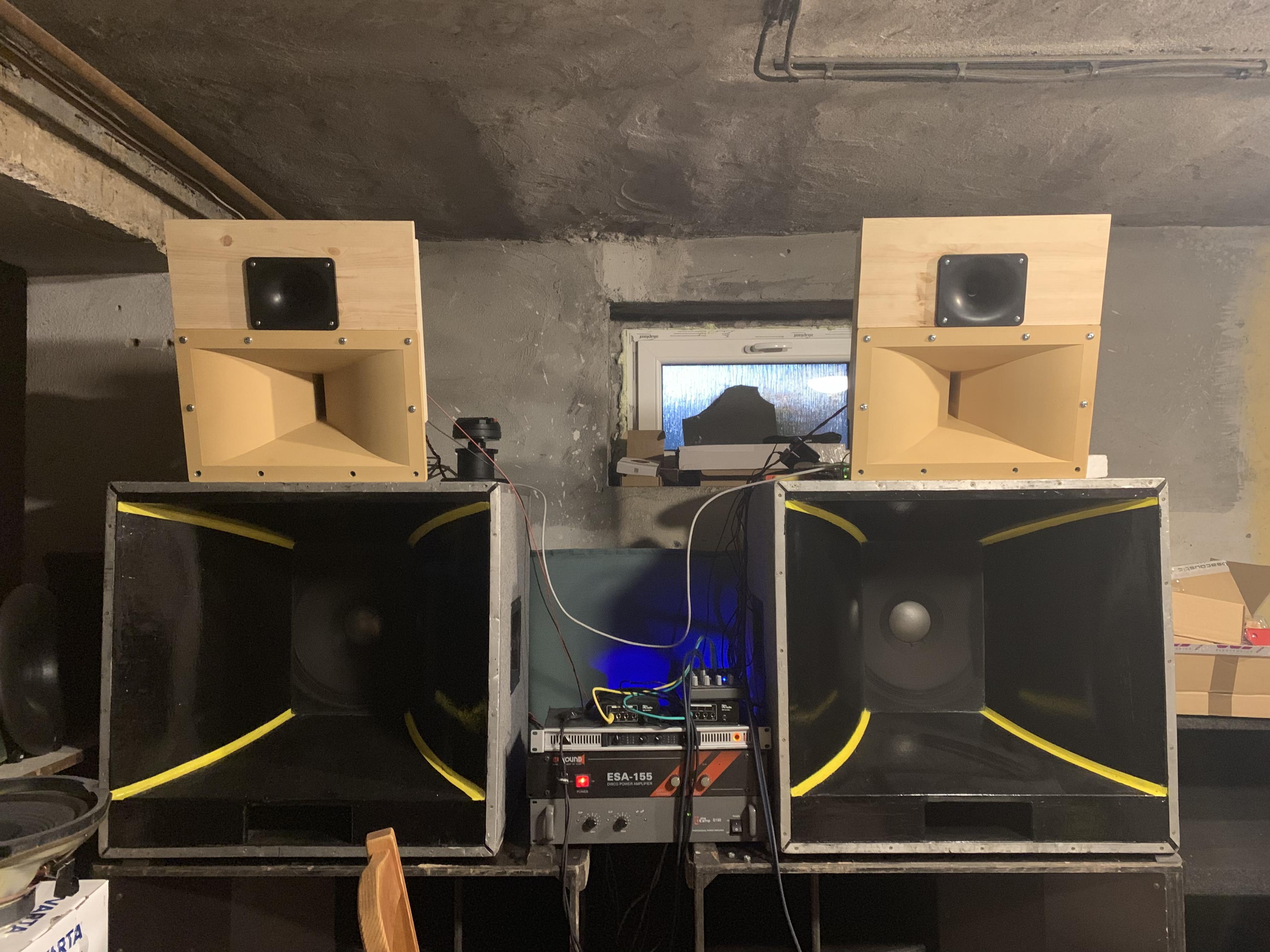

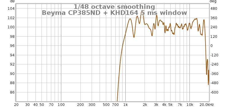

A small update - I finally have some proper horns for the Beyma drivers, the very cheap KHD164. They look really nice and fit well. It does not surprise me that they also measure well:

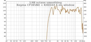

Definitely an improvement, also in sound, now the treble is just more natural and extended. I will need to do some polar measurements since the pattern in the description sounds too wide to me.

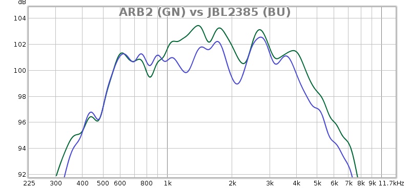

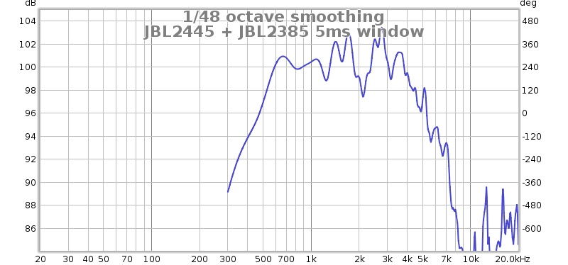

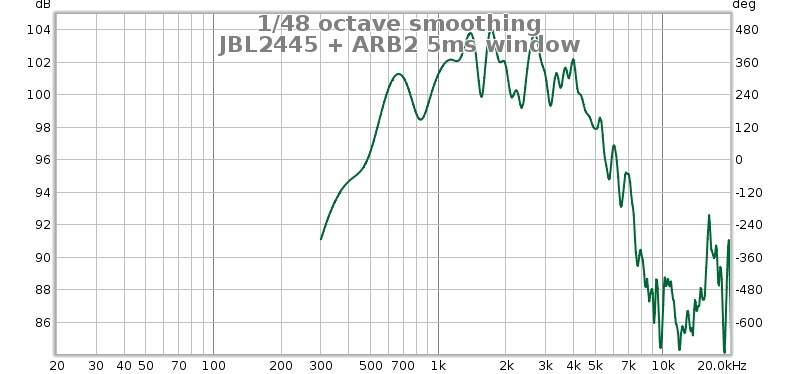

I also tried another ultra cheap horns with a wider pattern than the existing ones - ARB2. The JBL2445J I have are 3dB less sensitive, but the high end is a bit more extended. It is supposed to be a clone of JBL2380
For comparison, here is the original horn and both curves overlayed with some smoothing.

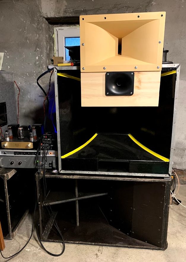

I tried a first order HP on the tweeter and no LP on the MF horn. I can definitely hear the difference in sound, but hard to say if there is a change in quality - there is definitely a "color" change. I plan to use a passive crossover for the tweeter, this was a test on how a single capacitor would work - I would say, it works OK.
By the way, I had the MF horn inverted in phase without knowing it and I had reversed phase on the tweeter by purpose to remove dip at the XO point. Now that was set up properly.
I plan to have a first order series crossover between HF/MF. The XO point is high enough and the 2445 rolls of in a nice manner. My only issue is that the MF is 16 ohms nominal and the tweeter is 8 ohms nominal, while the MF is a bit more sensitive. The next step is to get FR and Z curves and play around in some software before buying the parts.

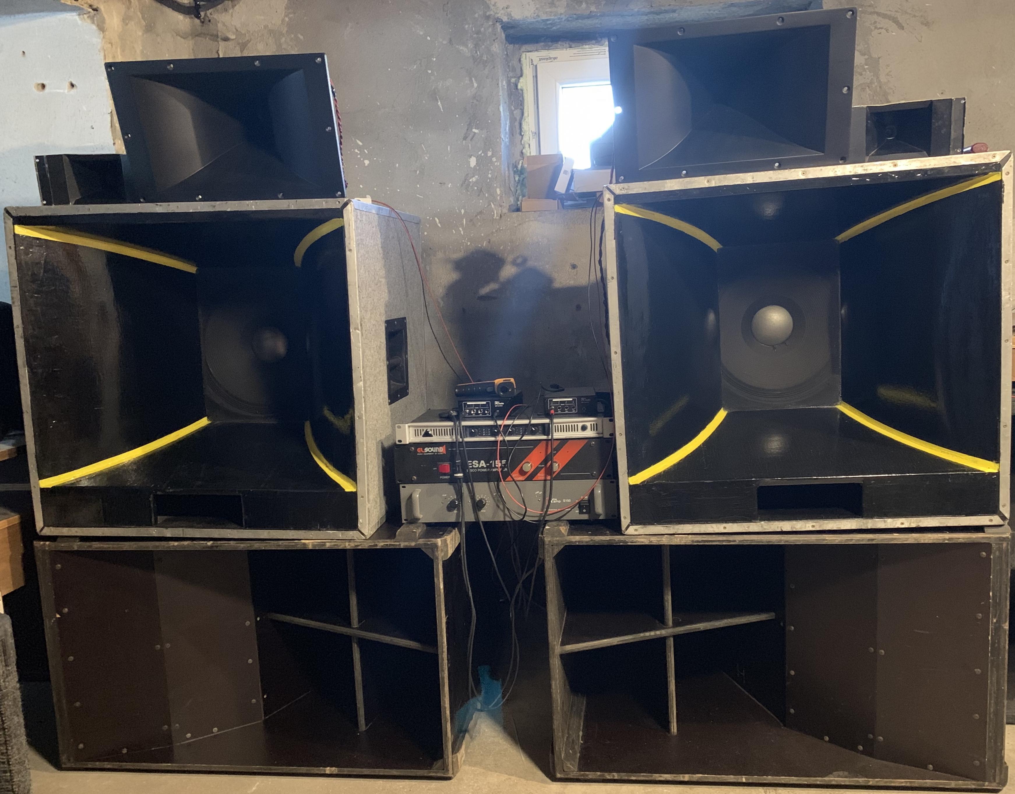

Still no time to do proper measurements. The Beymas are now in BC ME-20 horns placed above the midrange horns. I need to align the passively crossed over drivers.
A friend of mine will build a pair of Yuichi horns and 135 Hz horns by John Inlow. Two more bass horns are on the way, I just could not resist🙂
As a side note, the FH-1 clones with Fane 12-250TC in closed boxes make a nice little garden party PA. I only wish I could do something about the beaming, maybe try an acoustic lens made from corrugated cardboard.

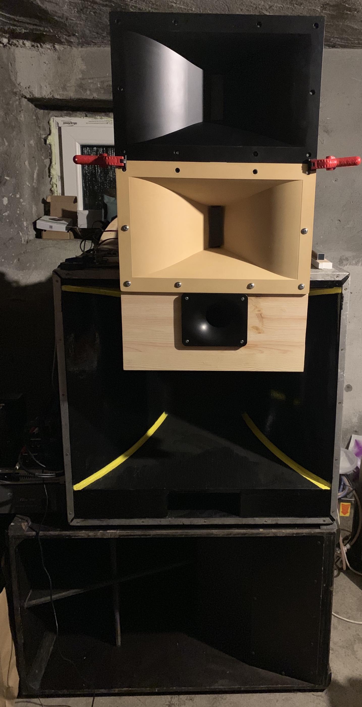

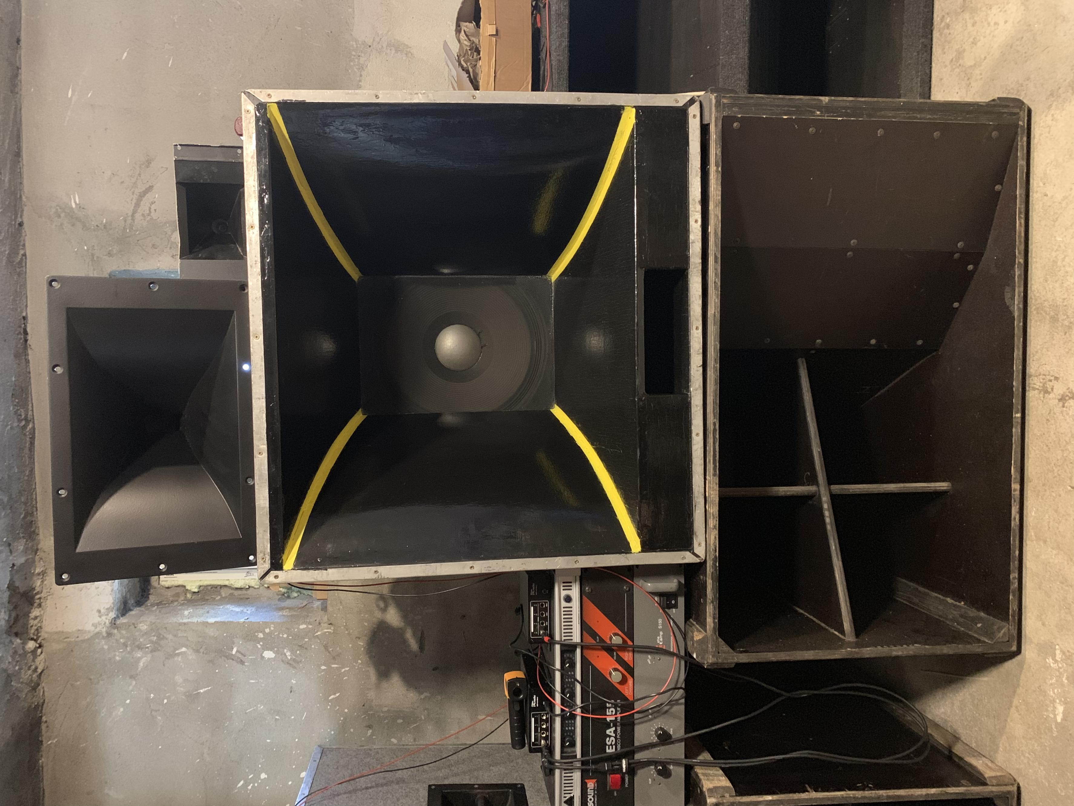

Thanks to GM and his suggestion of using two identical horns and 3D printing, it just sounded right from the first note played. Great, clean, balanced sound over a wider spot. Until I can find a horn/driver combo, that could do the same (not coaxial), I am really happy. As a bonus, it also looks better🙂
The large black horn is the HF - I will most probably soon make a new fixture allowing HF to be positioned on top or between midbass and MF.
Measurements will follow, but now the system is reasonably flat, maybe requiring just a touch of DSP EQ. HF+MF is easily within +- 3 dB window from 500 Hz up, no more notches caused by misalignment.
