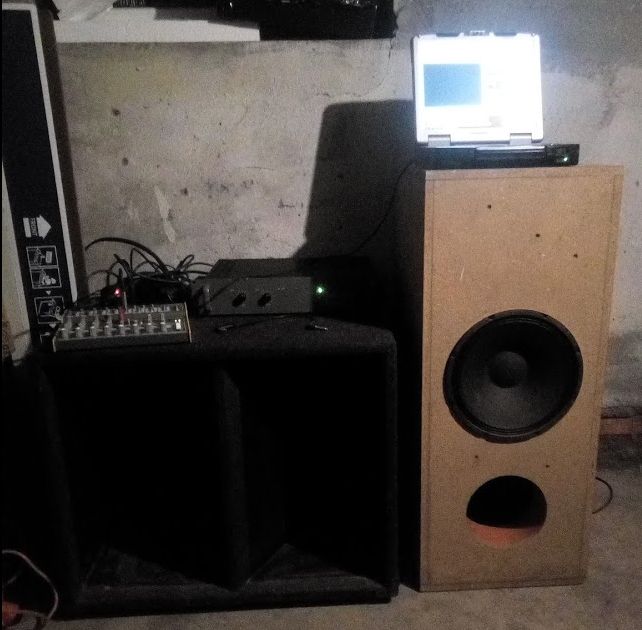

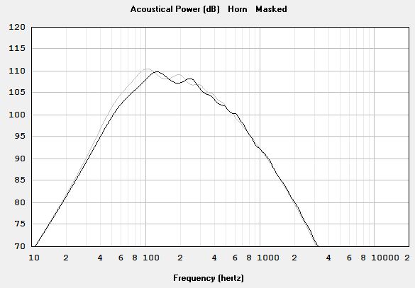

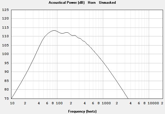

Thanks for the input, freddi. These were used as the only bass in a small PA system (the speaker is Kappa 15LFA). They will be placed in a corner. I tried some quick simulations for corner placement based on mouth area and estimated lenght and it looks like this:
attachment.php
I hope these will serve me the "kick" I am after, I may use a dedicated subwoofer at some later stage. This is more like a proof of concept stage, as I can get rid of them for the same money pretty fast. Since this is a dedicated room, I have a lot of space for crazy sized bass boxes:)

I suspect its largely the balance of clean upper bass vs midrange and perhaps even a bit of stored energy - but the old (1951) Karlson cabinet can subjectively have more kick than a lot of horn. Karlson boxes need low moving mass and fairly strong motors. If run with a midhorn, the crossover needs to be probably 600Hz or higher. They like power and I would think a flea watt 45 amp would disappoint compared to 200 watt run of the mill AB power.
that's a pretty deep playing horn in your graph and should cover a lot of kick and floor tom energy.

The simulations and estimations were a bit optimistic. This is actual simulation from physical measurements.
attachment.php
It is recalculated to wall position, the grey line was the optimistic version:)

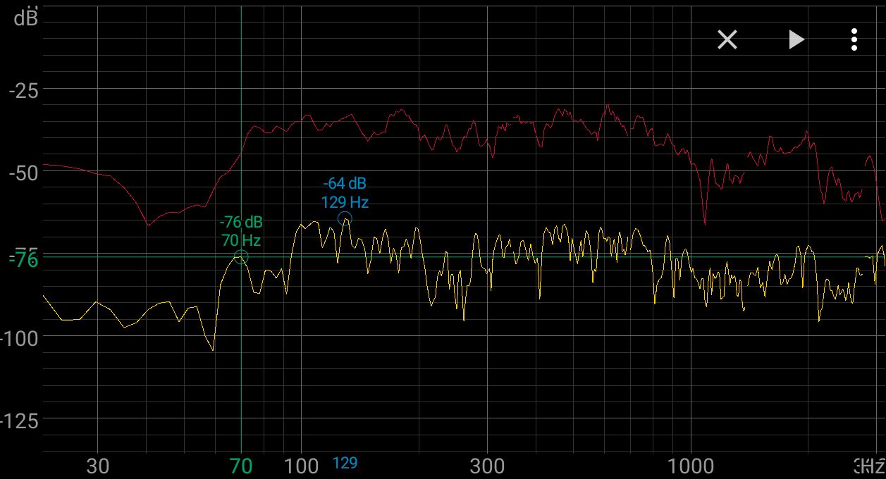

I tried just some really fast measurements with my phone and pink noise:
attachment.php
It does not look really impressive, but the sound is definitely close to what I want to achieve. One funny thing was, that I sent left channel to the horn and right channel to the coax and I got actually some nice image and timber out of the music. Definitely not correct, also asymetrical, but nice indeed. Once set up properly in stereo with crossovers and delays, it will be good enough for my workshop and I can have my listening room system built up nicely - these are not handsome enough and the material is also not the best (plank sandwich).

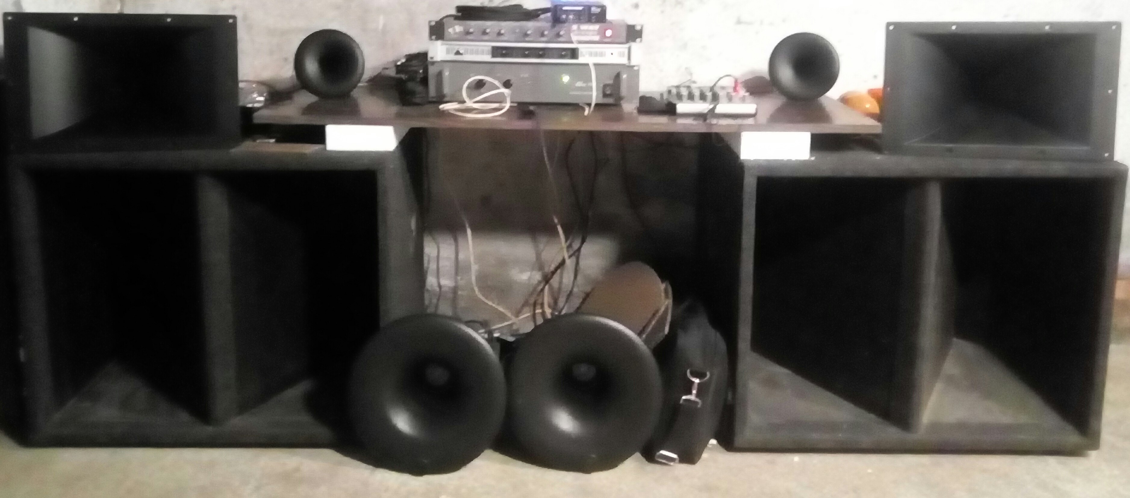

Slowly getting there. Here are the bass bins, JBL horns and D210Ti on small wooden horns. The system is triamped and slightly equalized by t.racks 4x4 DSP mini. The sound is really dynamic as I like it. I need to get different HF drivers, the Seleniums are not too nice. And hopefully, my large Cervin Vega bass horns will arrive this weekend.

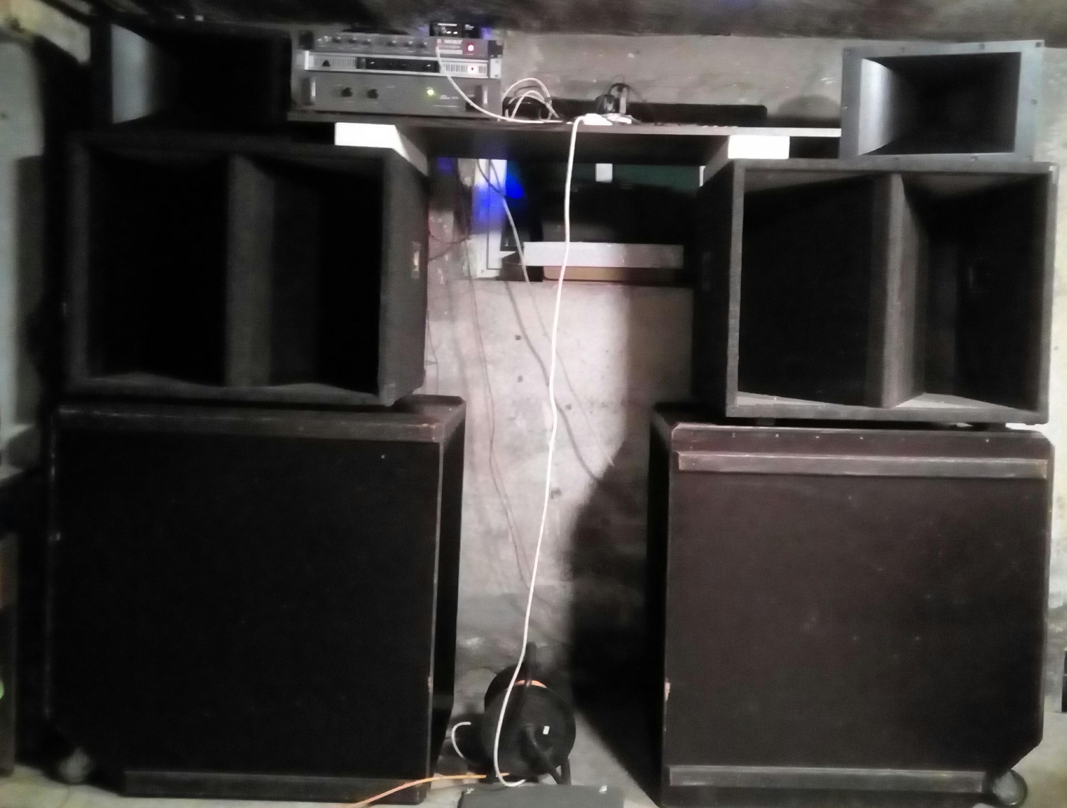

A pair of these are now installed below the rest. I could not test or measure, because I finished rebuilding around midnight. I will not use the HF horn, so I will keep it 3-way for now, using the DSP to EQ the large JBL horn - until I get the tweeters. They will be most probably BC DE35 as they look nice and flat.

So this is how it looks like now. The bass horns measure quite flat from 40 Hz above 100 Hz. The drivers needed 18 dB boost to compensate for CD and loss of HF. Now it is +- 3 dB from ca 38 Hz to 20 kHz at the listening position with some small exceptions.
This arrangement is far from ideal as the mid horns are too high. I need to rebuild it with the mid horns in the middle. It also needs a tweeter for sure. There is no need to torture the JBL horn above 8kHz. The previous setup with bass boost and tweeter sounded better, but this one plays bass without the boost.
I am very happy with the Cervin Vega-style bass bins. They are just awesome. One of the next steps will be to use Fane 12-250TC from 100 Hz up in a sealed box.
I am also very happy with the t.racks DSP. It is really a nice little unit and I will most probably get a second one to have the option of 4 way operation. The changes with the software are instant, the disadvantage is that it us Windows only.
But before that, which tweeter or HF horn would you recommend to match the polar pattern of the JBL2385 mid horn?
