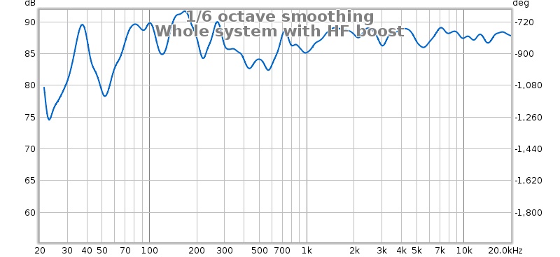

Just a small update. I bought a second t.racks DSP mini, did a quick and dirty time alignment and reduced the HF boost. It now sounds really good, but I am still missing some high end, the 2445s really do not sound that well in the upper octave. I have the DSPs set up for delayed ambient channel, so I am really curious how that will sound like.

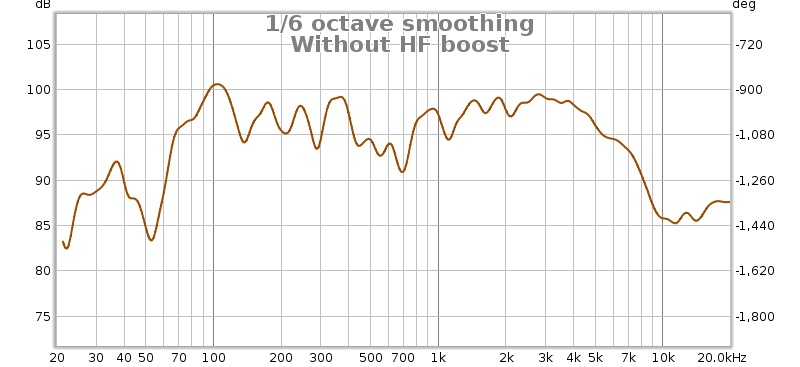

Hi Rob, could you please tell me more details about that? I am using the DSP as constant directivity boost and a little extra for the high end. If I equalize it to flat, it starts sounding harsh. That is why I plan to go 4 way.
As it is now, it is all active.

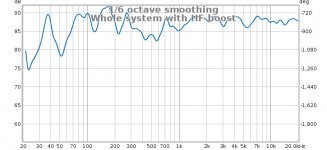

Here are two charts. The one without the HF boost is also time aligned by the DSP. As it is now, without the boost it sounds less harsh even without time alignment. I guess my hearing is not the best any more in the HF as I am not really missing much, but only a little in the high end.
Edit: This is measurement in room, distance ca 2,5 m and 30 deg off axis.

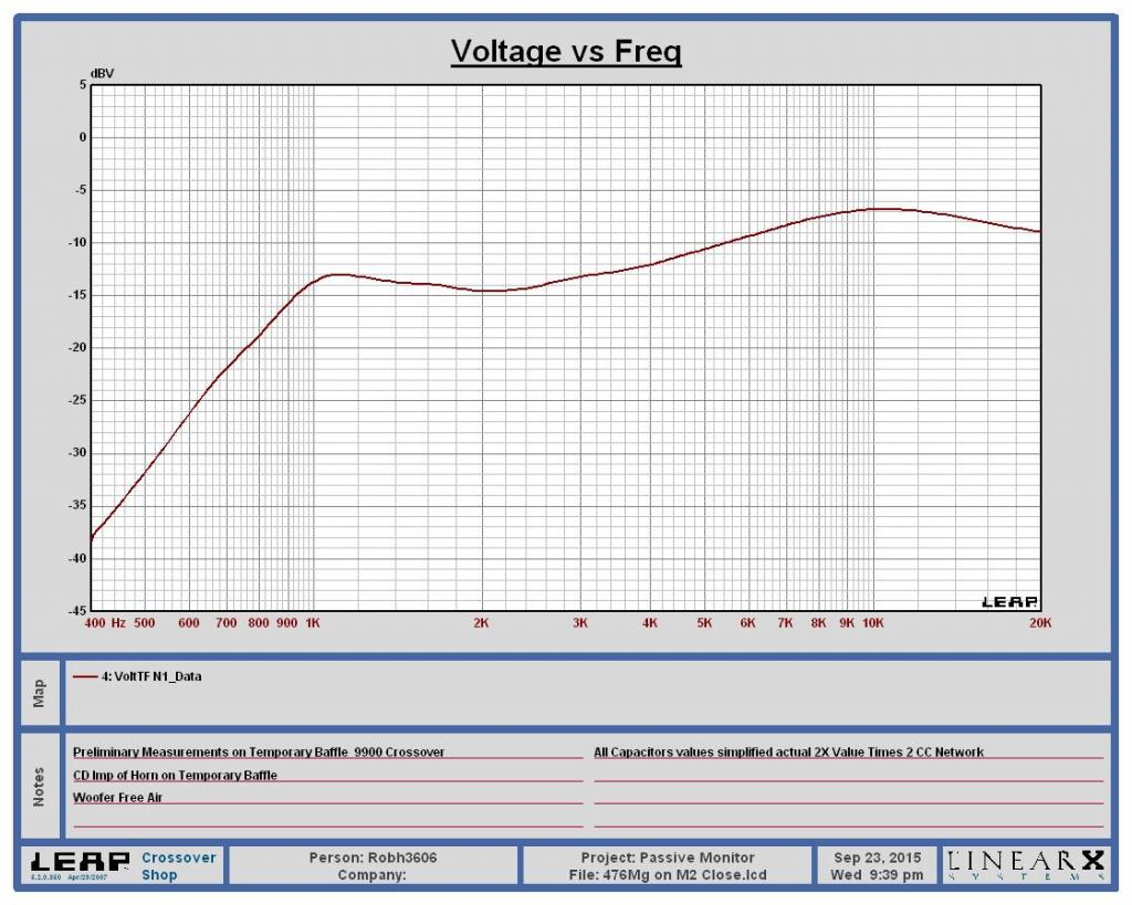

If you do a passive crossover for a CD horn its basically all attenuation. What I am saying is give up some sensitivity by attenuating the 1-5K and use that to flatten the response. I will post a voltage drive to explain it better. If you look at the Voltage driv. it is all attenuation below reference level.
When you boost the high end it's a worst case scenario because you are adding power where the distortion is already high to begin with. You want to use less power there if you can to keep the distortion levels at a reasonable level
Rob:)

I will try to replicate the curve by DSP. In theory, there is no difference between DSP EQ and passive EQ, exactly the same power goes to the driver as long as the amplifier/DSP is not clipping.

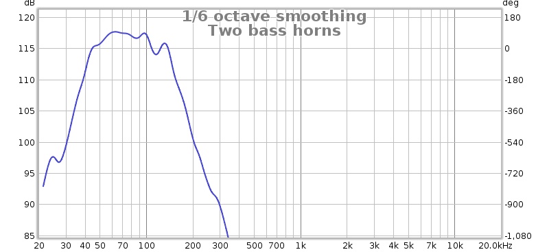

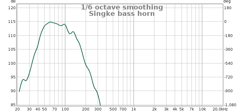

Freddi, I made these ground level measurements. Single horn and a pair, the microphone at the horn mouth in the middle. I would say, not too bad:) The horns are low-passed at 120 Hz.

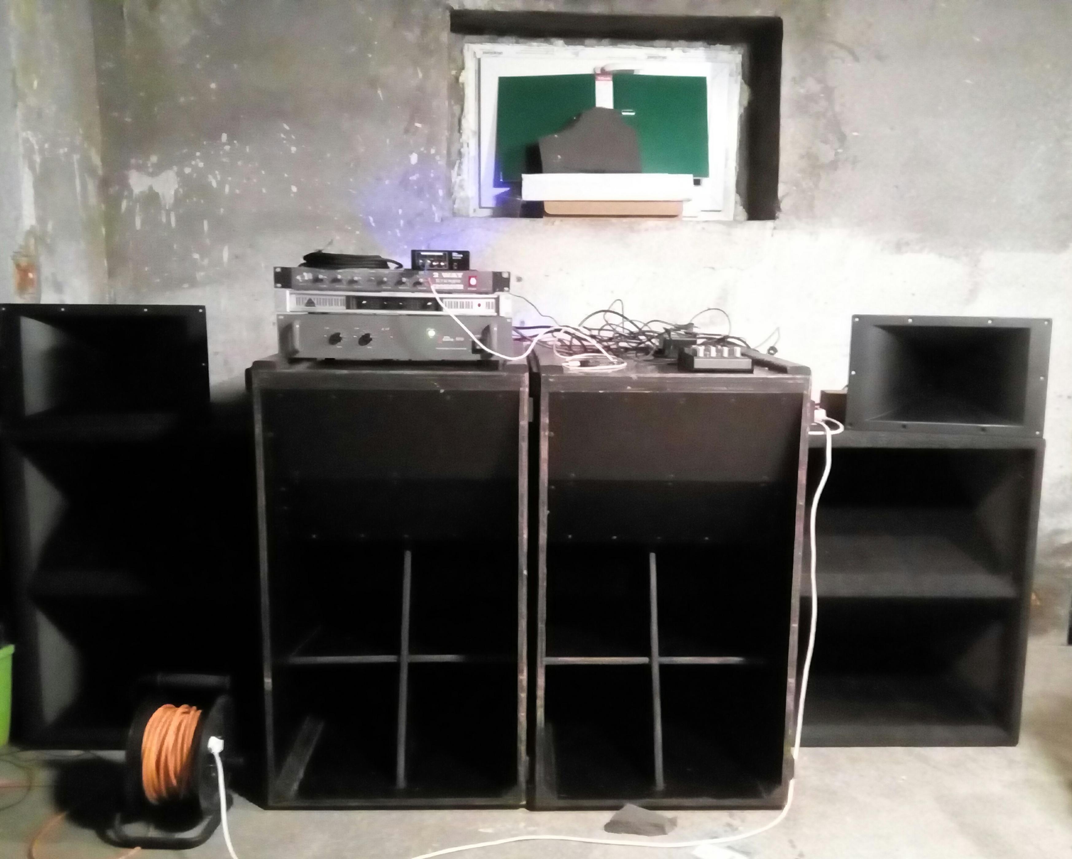

I got a good deal on Beyma CP385Nd with horns, so I will soon expand to 4 way. And I will also look at some JBL4560-like midbass horns with Peavey Black Widow 15 again, basically for the price of the woofers. These should replace the FH1 clones if they sound and measure better.
Joined 2008
Wow, 4 way is great. I just listened to the temporary setup. It needs optimization, but it sounds really great. I think the midbass horns made the largest difference, now it really kicks. Dynamic and low distortion sound even with PA cabinets and horns. The setup is by no means living room friendly, it is huge and ugly, zero WAF for sure. That is not a problem for me, since I have no place for these in my living room, I have it in my cellar workshop and party room.
