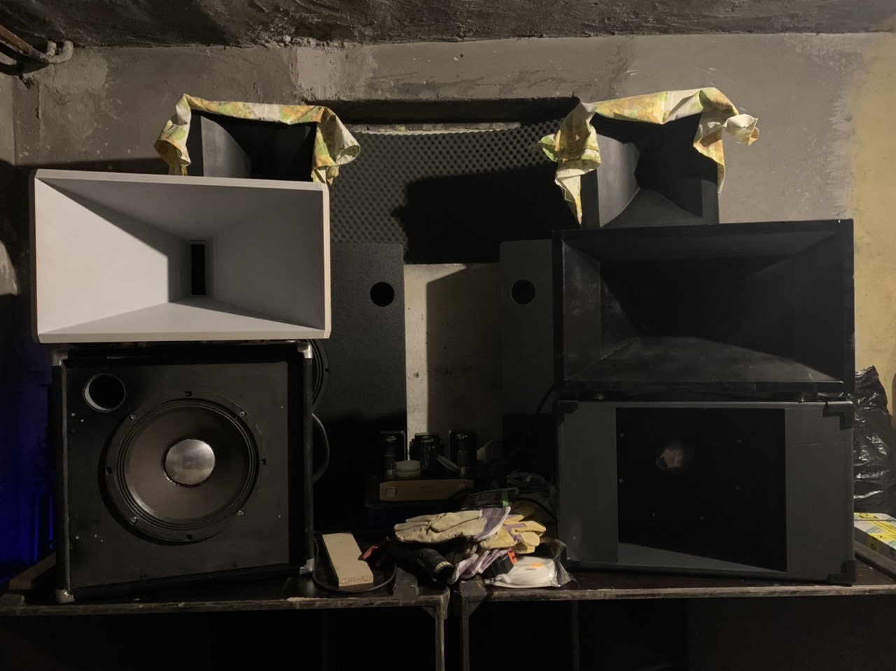

I found this old thread again. Just a snapshot of the progress - Synergy horns are the way to go🙂
Even in this non-optimized non-symmetrical form I like the sound. Best of all the combinations so far. I would say there are two main things. The sound is great almost everywhere and also behind door in other rooms. Also, it is great for background listening while doing something. The music just flows. If a normal consumer standard speaker was used for that purpose, it always attracted my attention while moving around.
I hope this is not only "self satisfaction" with my own work - the dual 3FE22 speaker I finished today is also very nice and listenable. I guess I am hooked onto coherent point source reproduction.
In the background, there are some EAW cinema speakers (bought cheaply to get the nice drivers) - not bad at all, nice coverage, but the MEHs are simply better. The AMT version on the left is the most detailed speaker I have ever heard so far, the DE500 in the other one is really far behind. I want to build up a second AMT synergy and also pull out my Peavey FH1 clones from the storage to use for midbass.
The funny thing is, I did not miss the bass much until I turned on the bass horns🙂
Most probably, large 3 way MEHs will be built based on Beyma CP755Nd, BC 4NDF34 and some 10" - 12" neo speaker - to get rid of the separate midbass horn. I would like to use the AMT for HF, but that brings some extra challenges.
There are also plans on refurbishing some 15" midbass horns meanwhile.
I am enjoying working on this almost as much as listening. I see that in a few years, I will have my ultimate system finished, but still want to explore the different options. It is a nice hobby🙂
