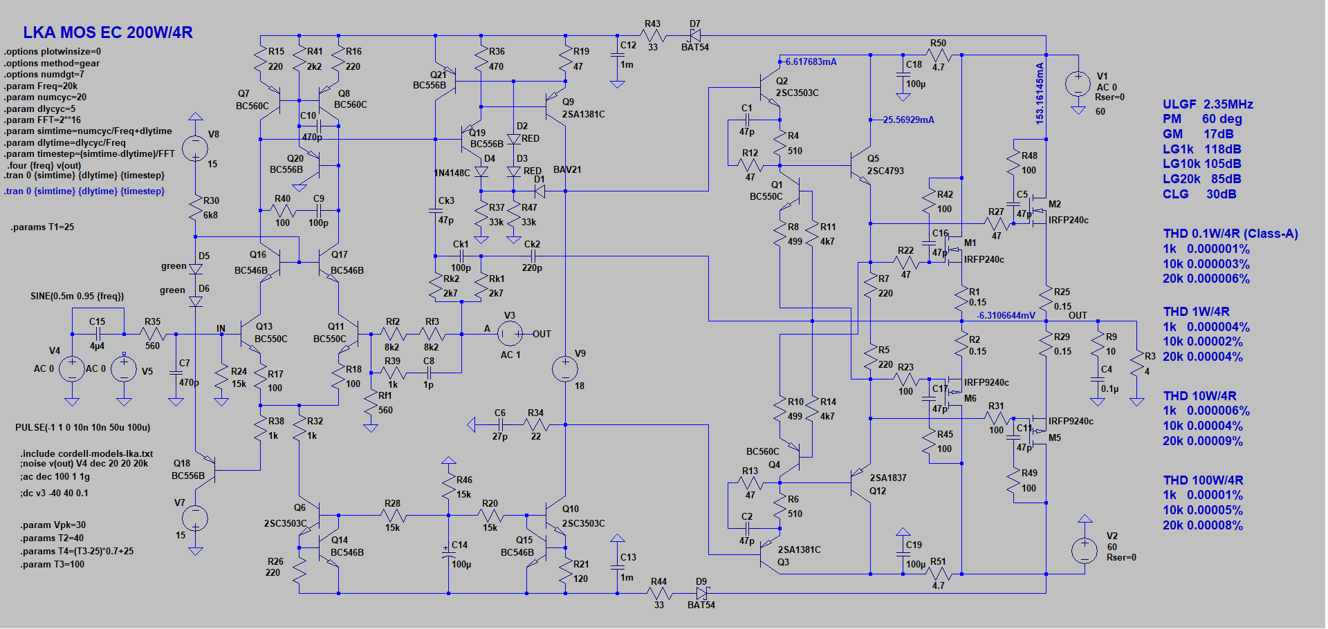

I've been playing with 3 pole in simulations after finding this thread. I didn't see much of a change at 20kHz... but then realized there is a pronounced change at 10kHz. The distortion between 1k and 10k stays much flatter. Good for me as my hearing is good till 10kHz, but not so much at 20kHz.

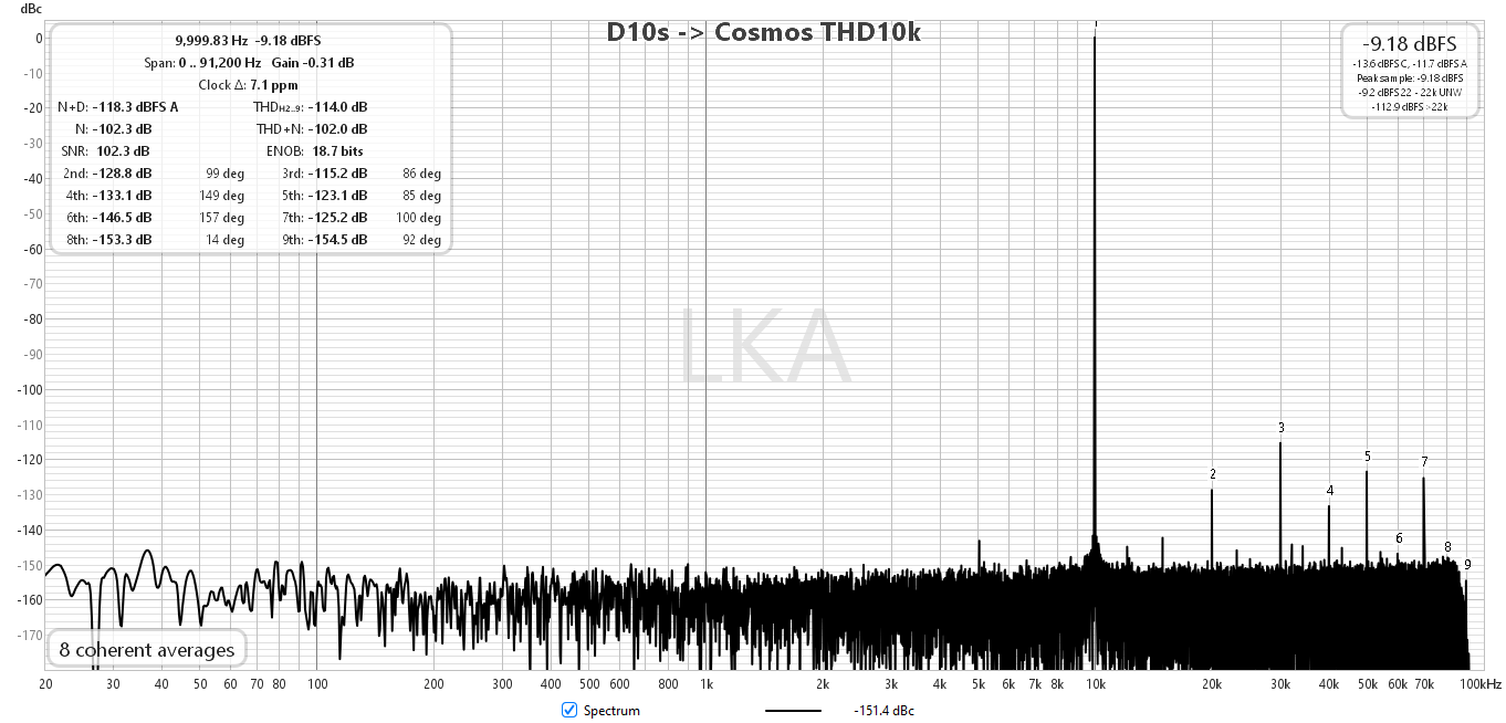

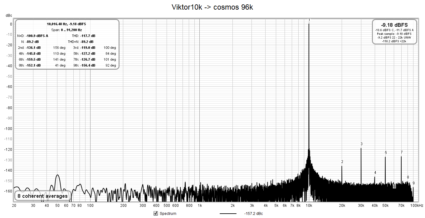

I have a problem with measuring low thd at 10kHz. Cosmos ADC is optimized for 1kHz, at 10k(20k) it has "weak" performance. In conjunction with the Topping D10s I can measure -128dB@1k, but only -114dB@10k (unbalanced, stereo mode, input range 1.7Vrms). It's a little better with the Viktor1k analog generator, -117dB@10k

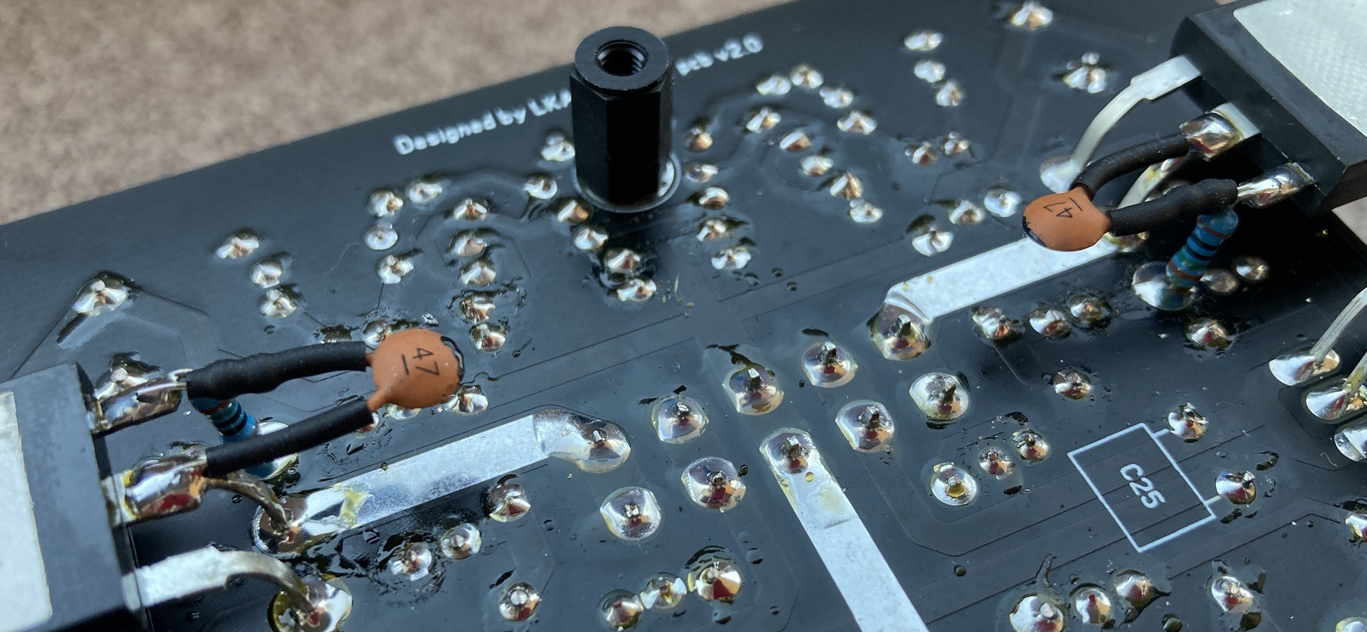

"Why are the gate dampers connected to the power rails and not to GND?"
a/ recommended by Bob Cordell
b/ easy to implement right on the mosfet case (short wiring); in series 47R/0.4W + 47p/250v + 47R/0.4W
Reactions: chermann and dadod
Yes, this is a small capacitance rating in the negative feedback circuit, commensurate with the capacitance of the amateur radio mounting of the board, which will be added to this capacitance.
In some cases (in general), an increase in capacitance in a given circuit can lead to instability of the amplifier.
You have a feedback resistor Rf2 + Rf3 divided precisely to reduce parasitic capacitance, but all its advantage is eliminated in parallel with this chain of R39C8.
Without this capacitor, is the circuit unstable?
2p2 I imagine is to tune transient behavior by adding a subtle low pass filter. Itll cost a little bit of gain margin. Is Rf not split to reduce resistor distortion? As R can vary with voltage and temp. Nice implementation of EC! I like how u biased it. In what software did u do pcb's? I never figured out howto do flooded tracks.

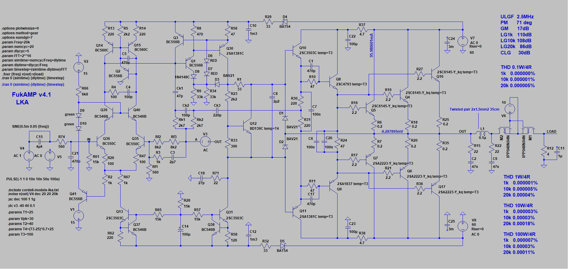

Hi, just a simulation for now. However, this EC mosfet output stage was already built into another amplifier.
#76 shows different mosfet amp
"Without this capacitor, is the circuit unstable?"
I haven't tried, it would probably be stable.
