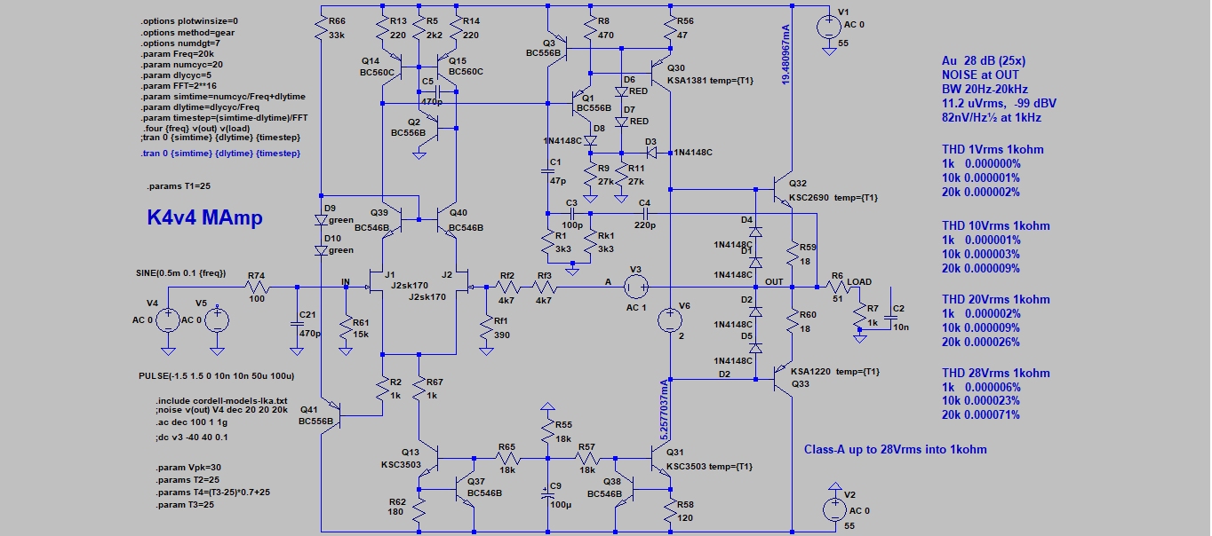

I made a measurement amplifier to extend the voltage drive capability of the Viktor oscillator. Yes, it uses triple pole compensation.

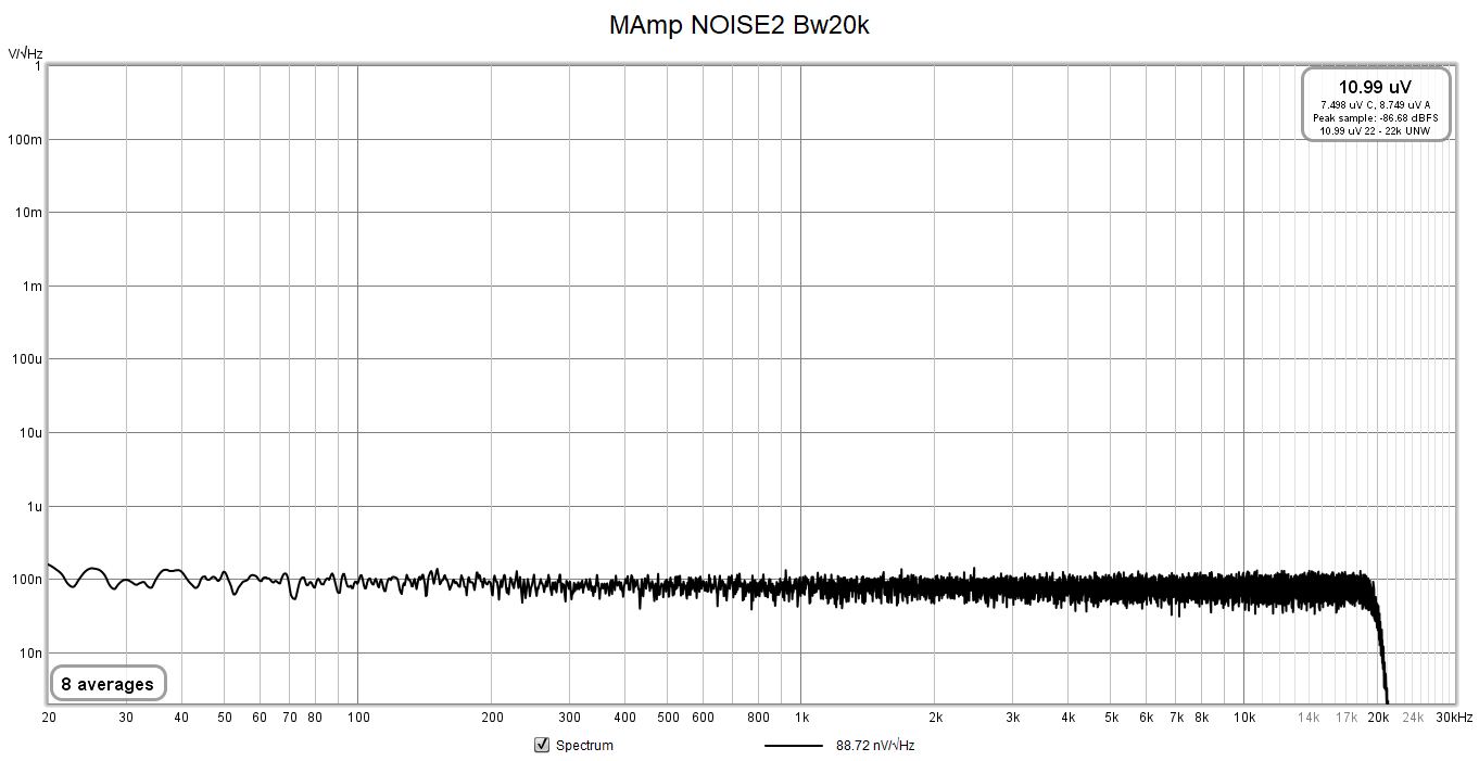

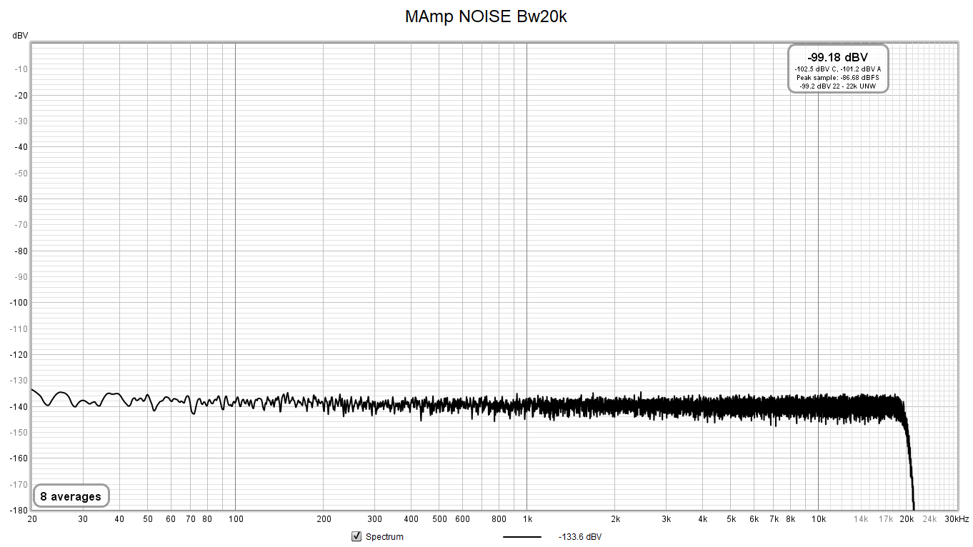

The noise measurement gives the exact number from the simulation. The input is shorted via 50R to the ground.
(measured by cosmos adc)

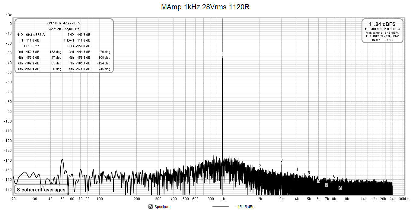

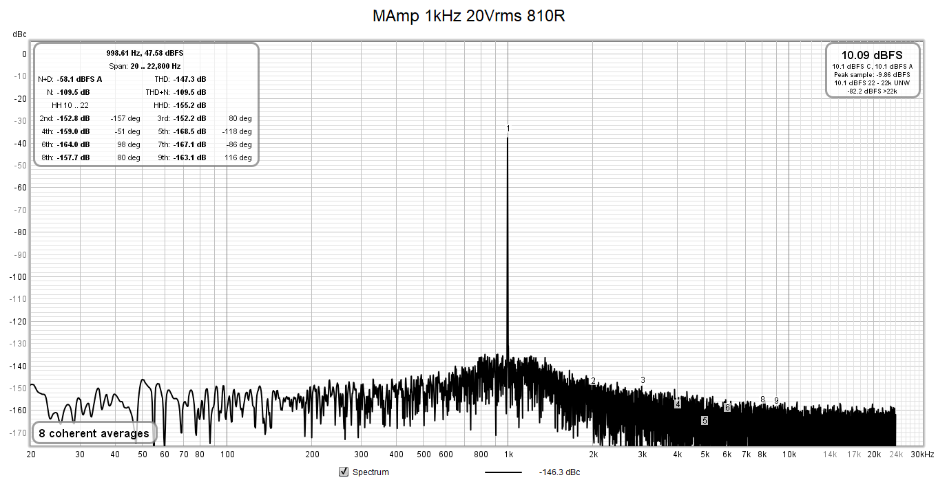

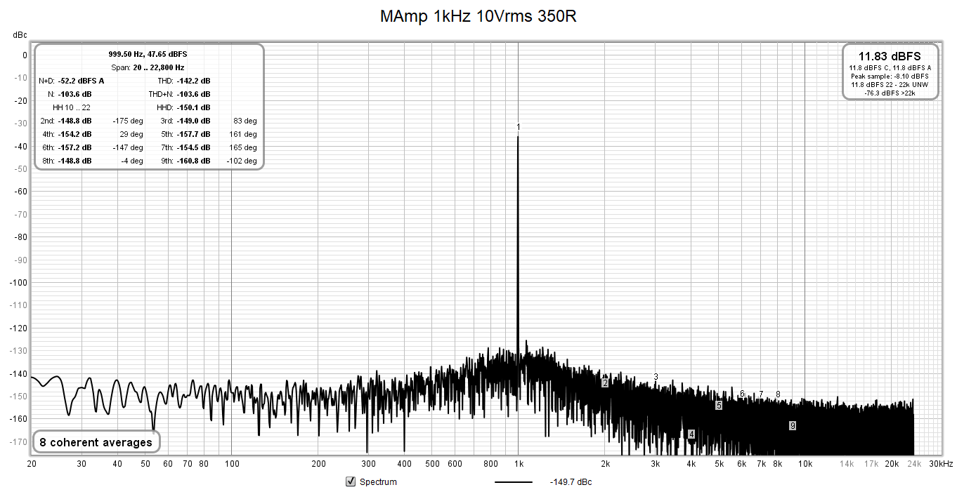

THD1k measurements.
The chain was : Viktor1k -> MAmp -> low impedance voltage divider -> passive notch filter -> post notch amp +40dB -> modded X-Fi USB HD

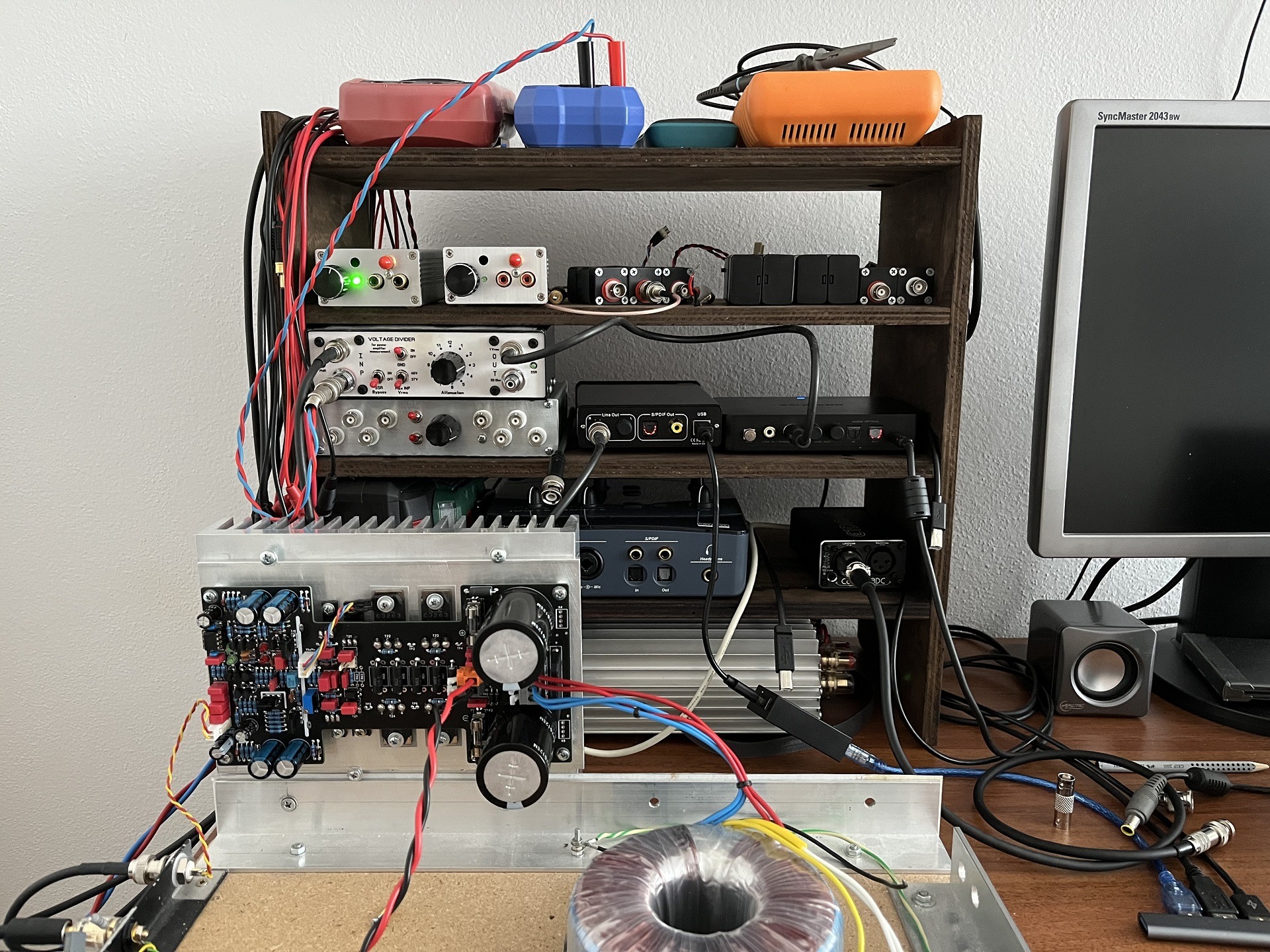

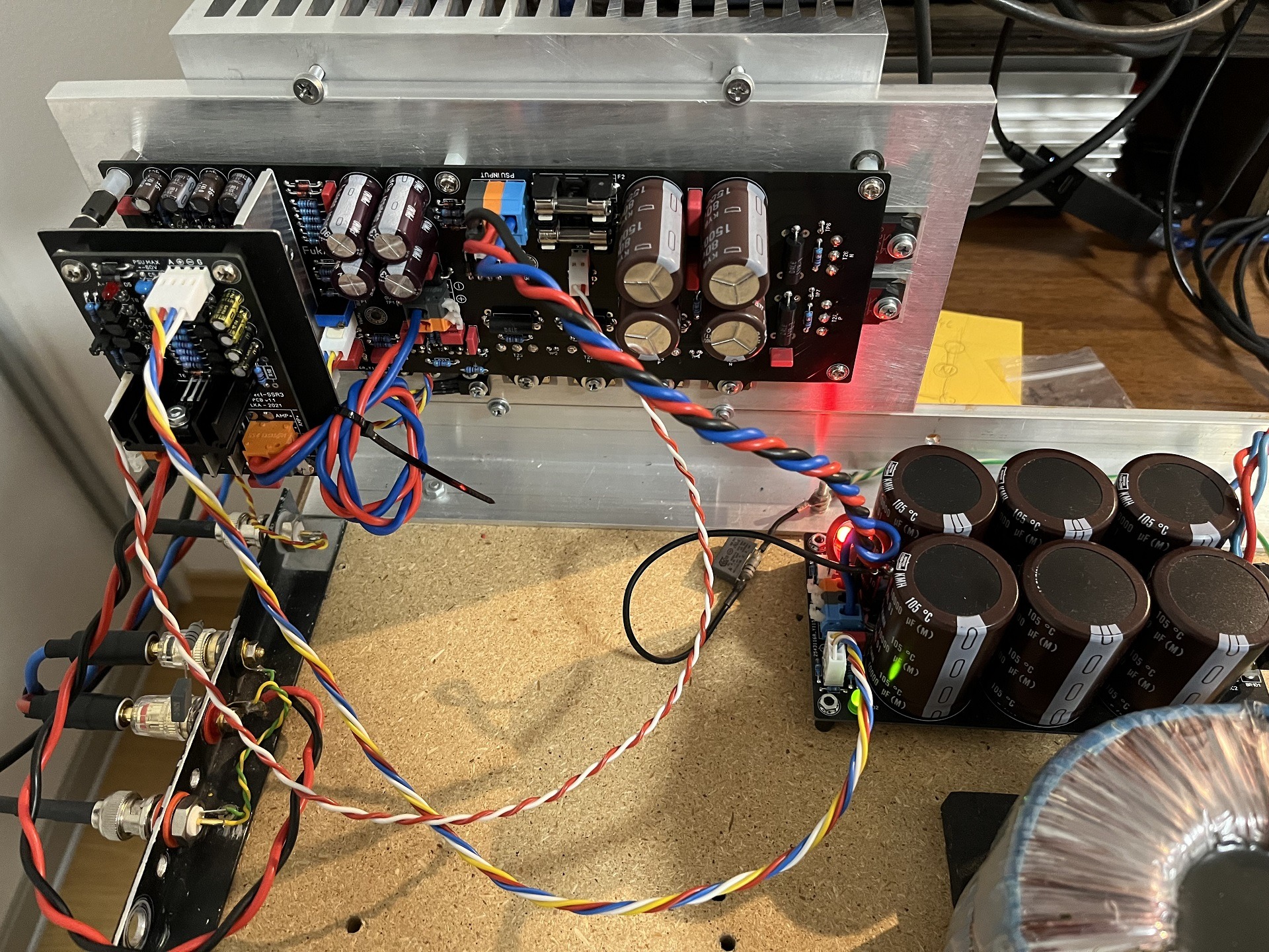

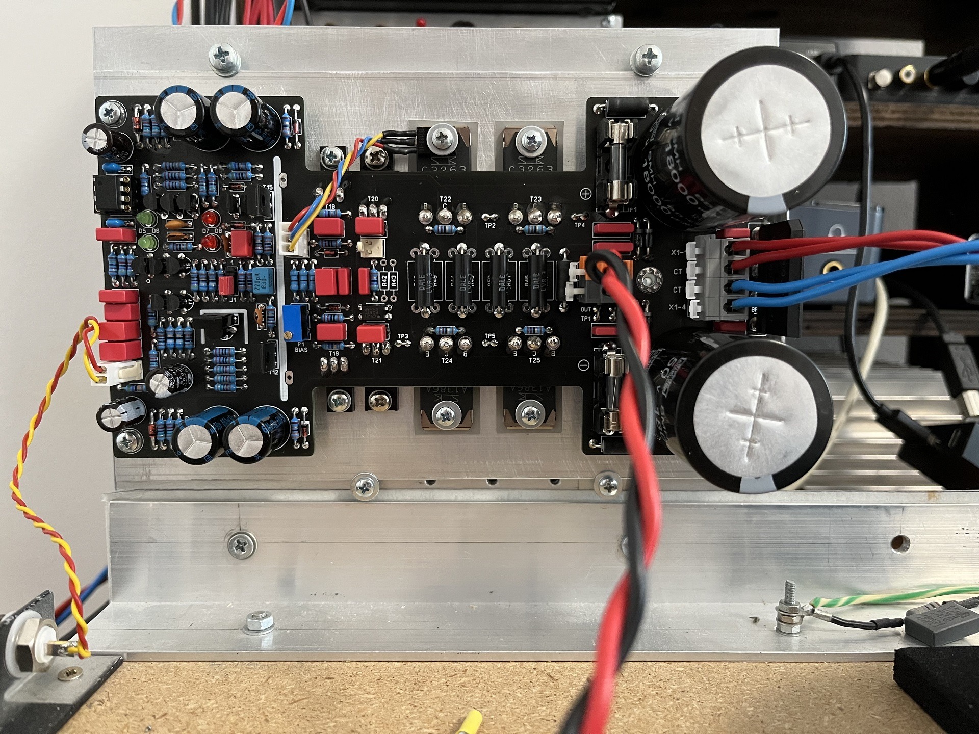

The amp itself is a front-end module which I use for my K200/K300 HEC power buffer.
The power supply components are leftovers from my past projects.

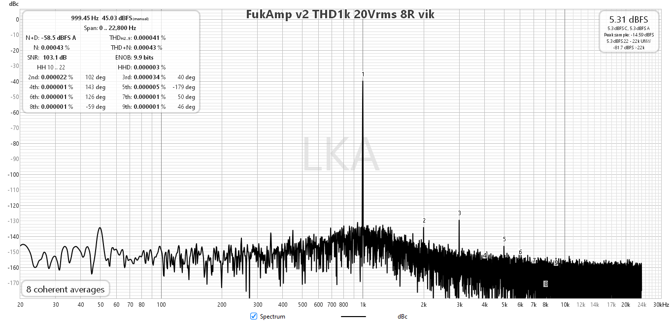

I'm still just at the beginning of tuning.
The first THD measurements give quite good numbers.
THD1k 10Vrms,20Vrms without load 0.00001%, into 4R 0.00006%

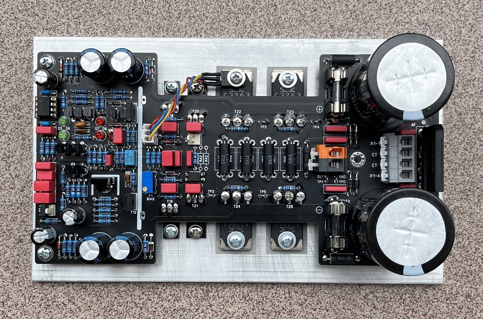

Three-pole compensation works, I tried TMC and TPC (jumper on pcb)

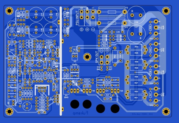

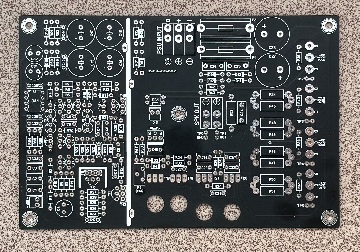

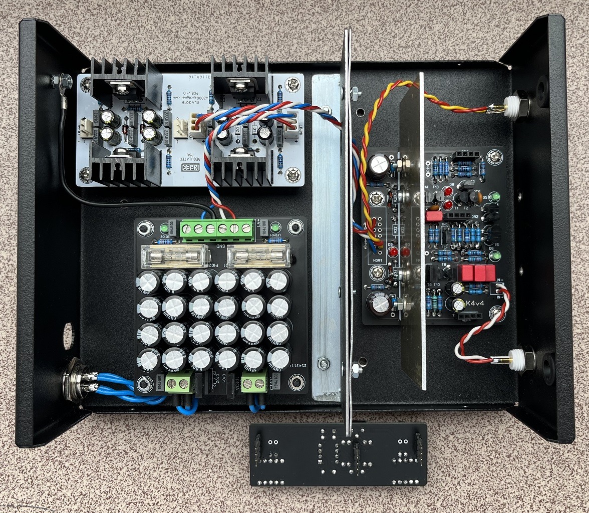

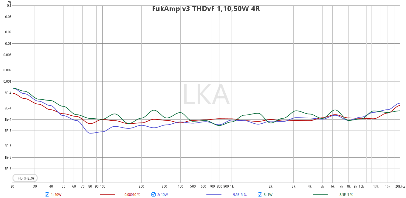

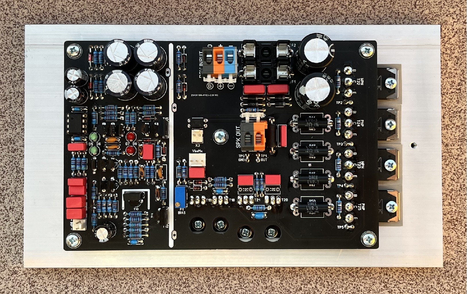

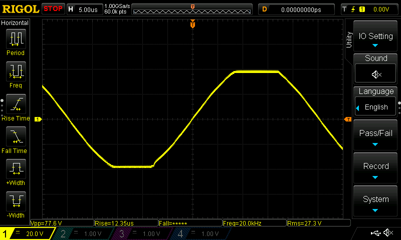

The fourth version of the PCB is ready. Version 4.1 is on the way (I've been waiting for customs clearance for 20 days now) and will be sold to local diyers.

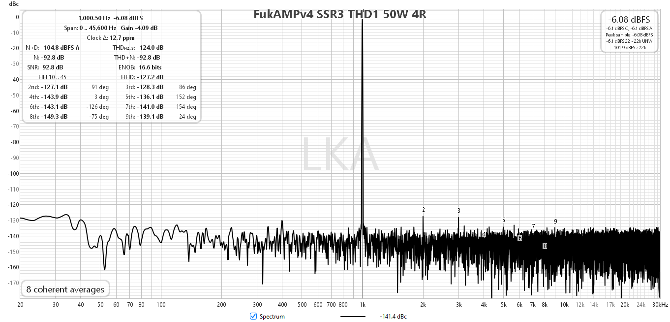

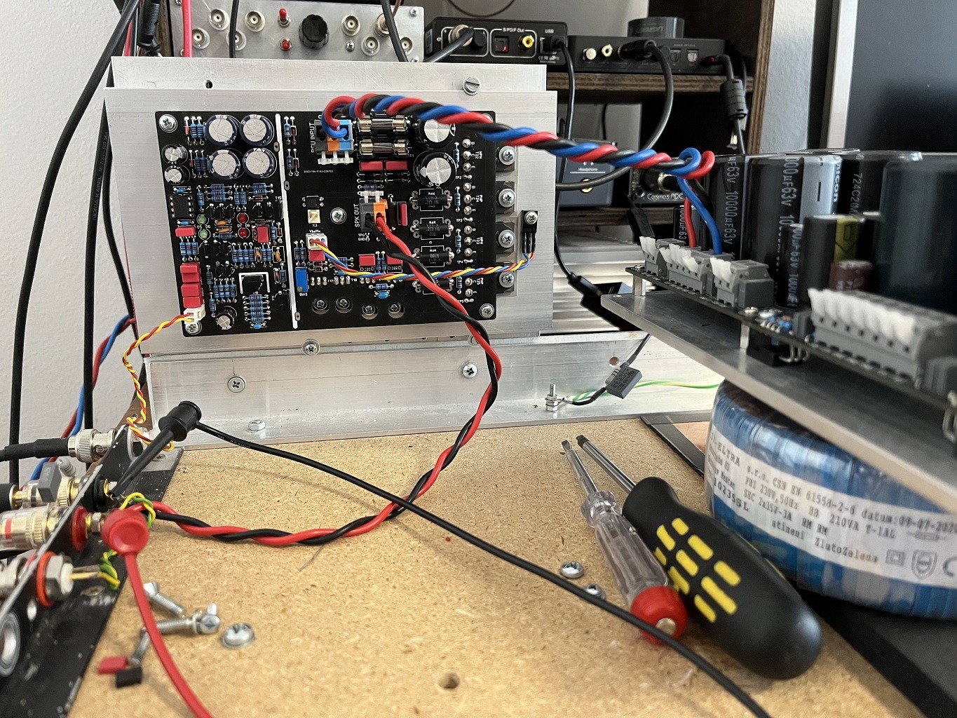

SSR3 is also part of the measurement - THD 1kHz 50W 4R . Classic output coil is not used, despite this, the amplifier is stable to capacitive load.
