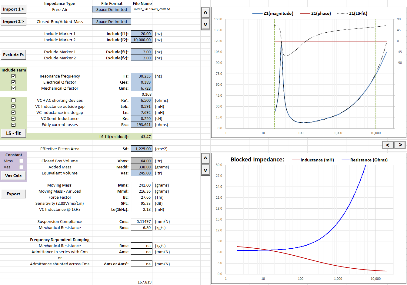

Semi-Le_calc calculates a value of 7538 for Rss; that seems pretty high to me. Unfortunately, the values read in for the impedance curve only start at 20Hz; could that be a cause?
The driver is LaVoce SAF184.03, btw.
Yes, that is most likely the cause. Without data < 20Hz i is difficult to determine Re' properly.
Here is my best estimate for the Semi-Le parameters, fixing Re' = 6.5, and using the datasheet value for Vas = 245 ltr.

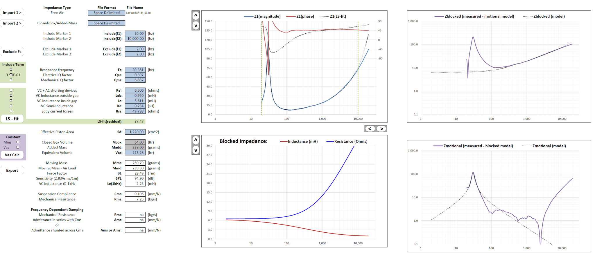

I tried this myself according to your advice:
My value for Mms is closer to the manufactures: https://lavocespeakers.com/single-product/?id=93
Both our values for Qes are a little bit off.
So which values to take? I'd keep the manufacturers values and just add the calculated semi-le-parameters to Hornresp? Which ones look better? 🙂

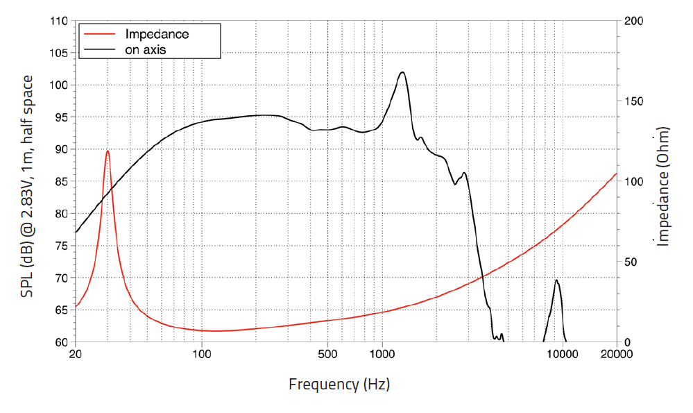

Your impedance curve fit appears to have some problems. The measured phase response looks quite odd to me, very much different from what a single resonance peak should produce. The impedance curve is also much steeper at 20Hz than I might have expected it to be. Just compare it to the results published by Lavoce, which are reproduced below, which is what I would expect.
I don't know where semi-le_calc takes the phase response from...
It produces the phase response as part of its impedance model. From an earlier post from bolserst, it appears that the curve fitting process doesn't use the phase response, as the supplied impedance data had a constant zero phase value. The fitted model, however, predicted the typical phase response of a woofer, so the results looked okay.
