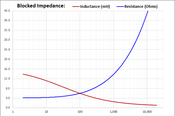

Has anyone tried verifying the model through blocked impedance subtraction? IE take a cheap speaker, remove the dustcap and do an impedance measurement, then drop hard epoxy into the gap and do another impedance sweep after it sets? It may help if there are Rms effects that mimic semi-inductance effects?

It is very mysterious that the semi-inductance blends so well with Re that you can get a near perfect fit by excluding Re above Fs. This suggests to me that our assumptions about suspension behavior above Fs may not hold. Or possibly change in excursion during the measurement is modifying the result depending on what source impedance and amplitude is used.
