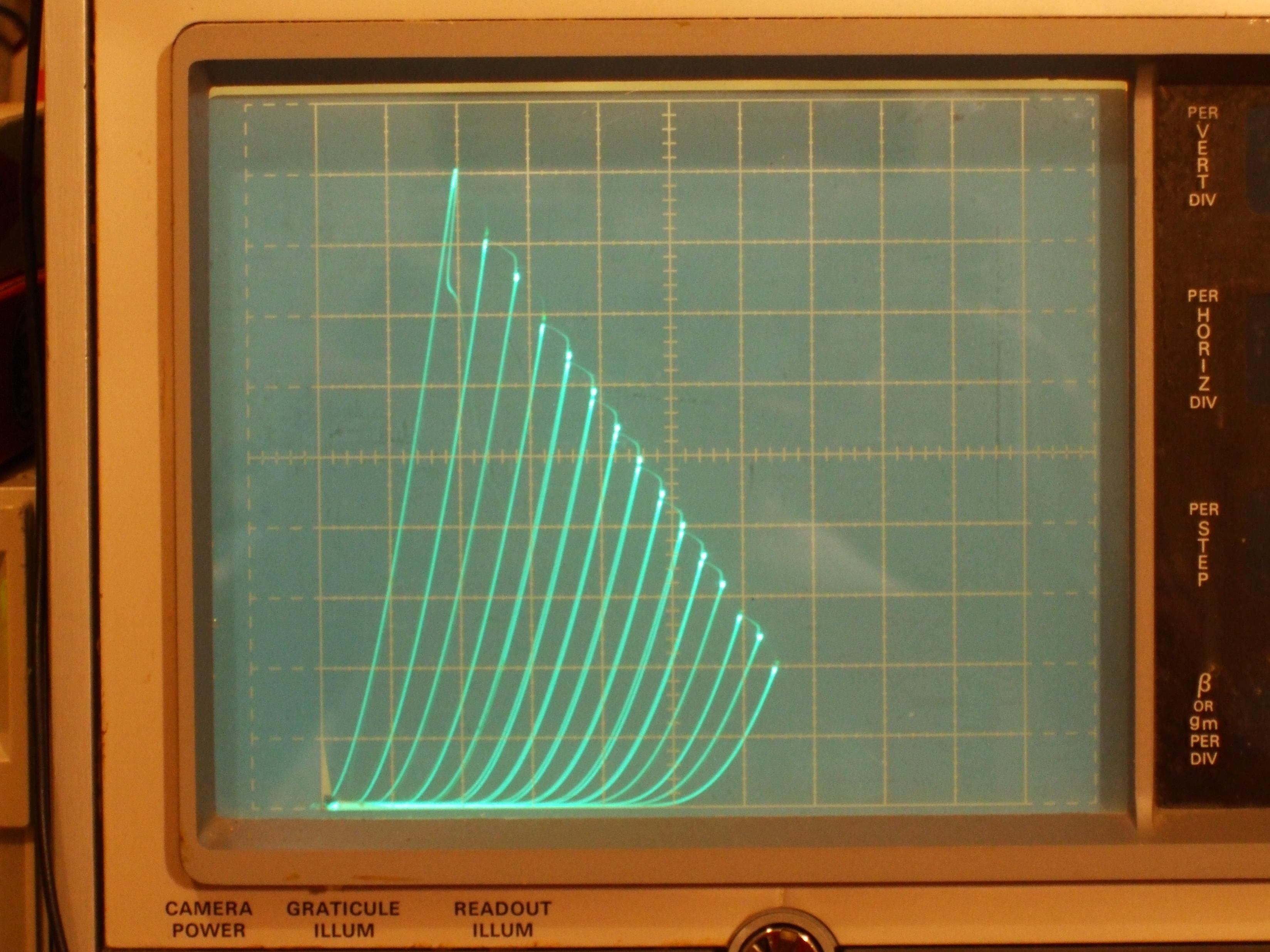

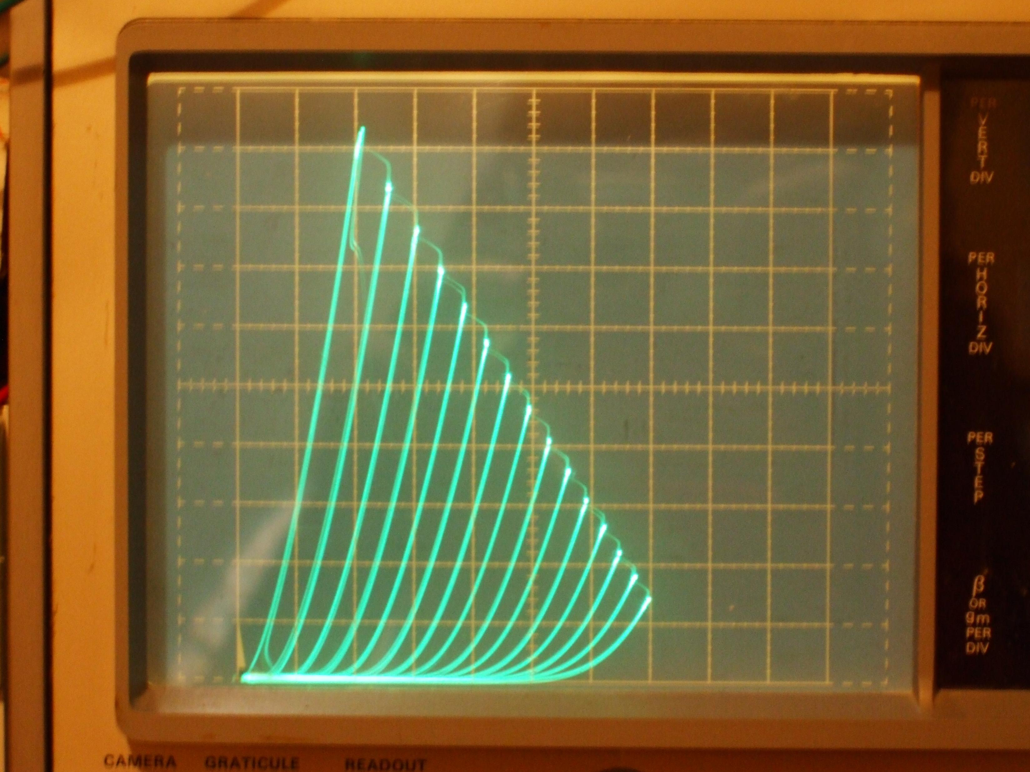

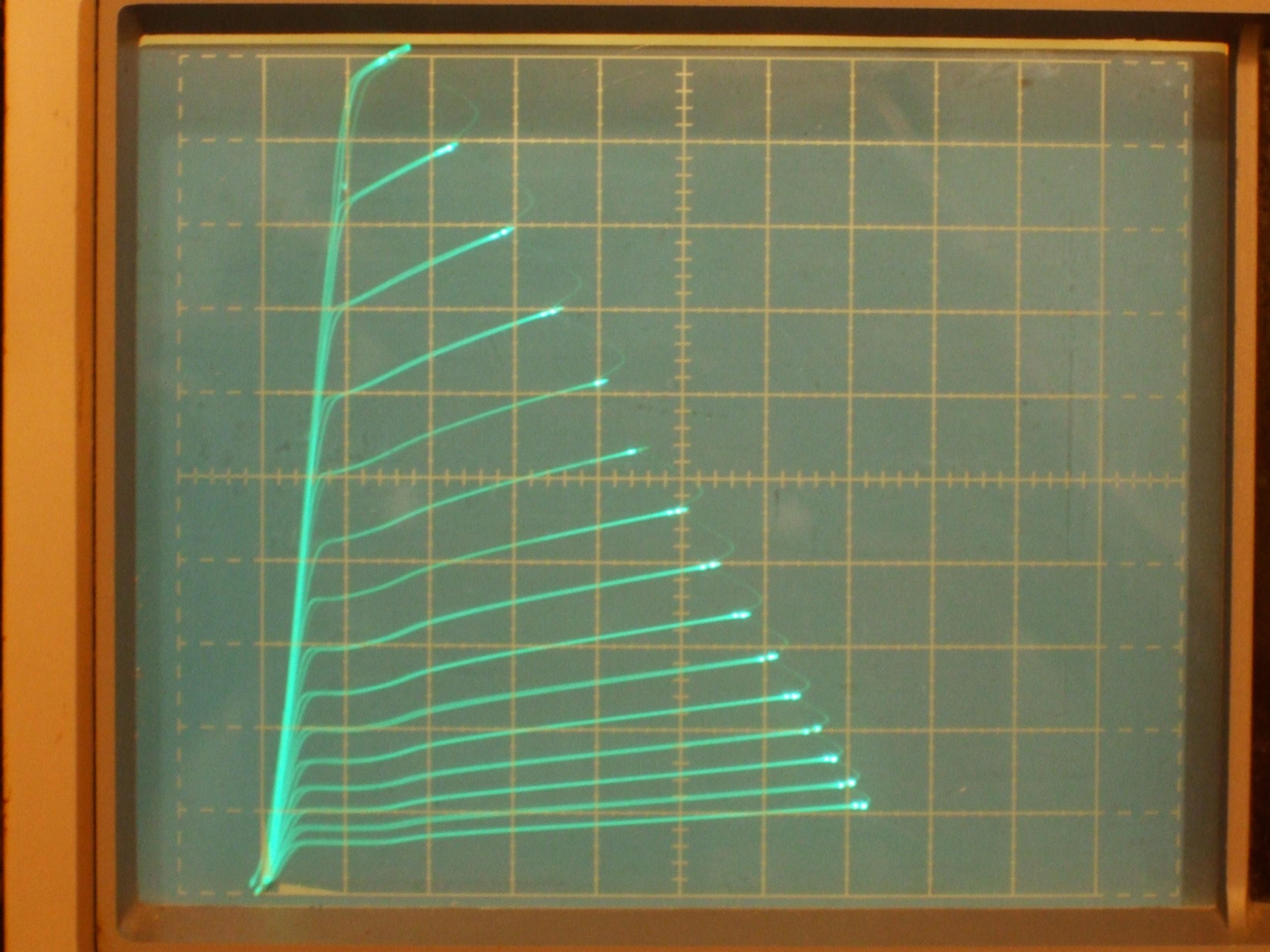

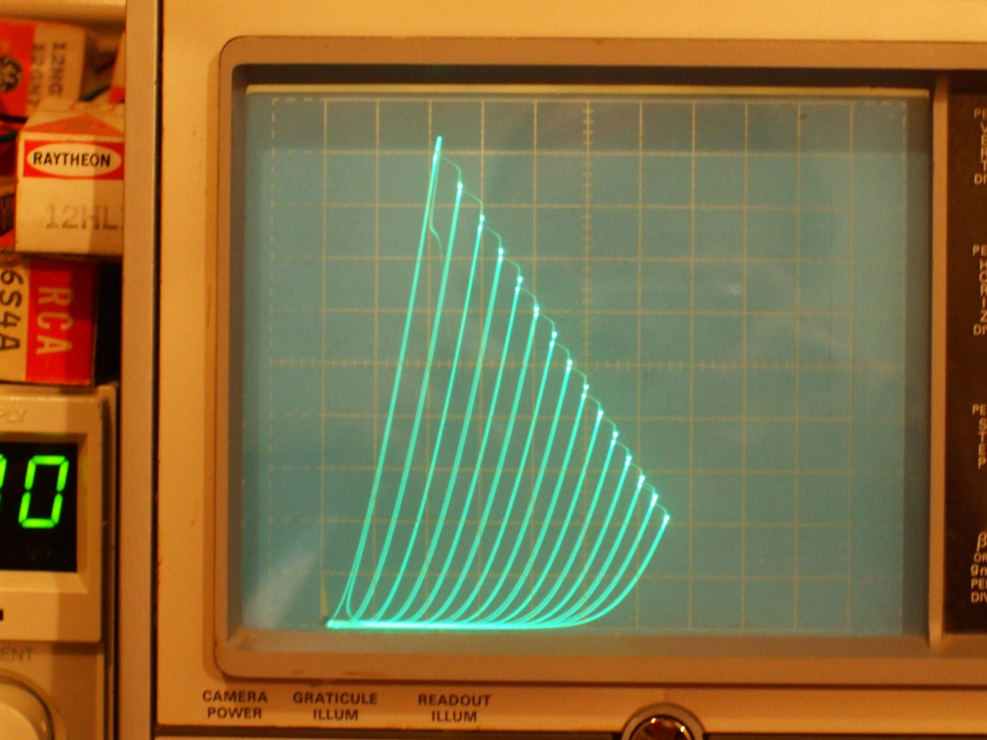

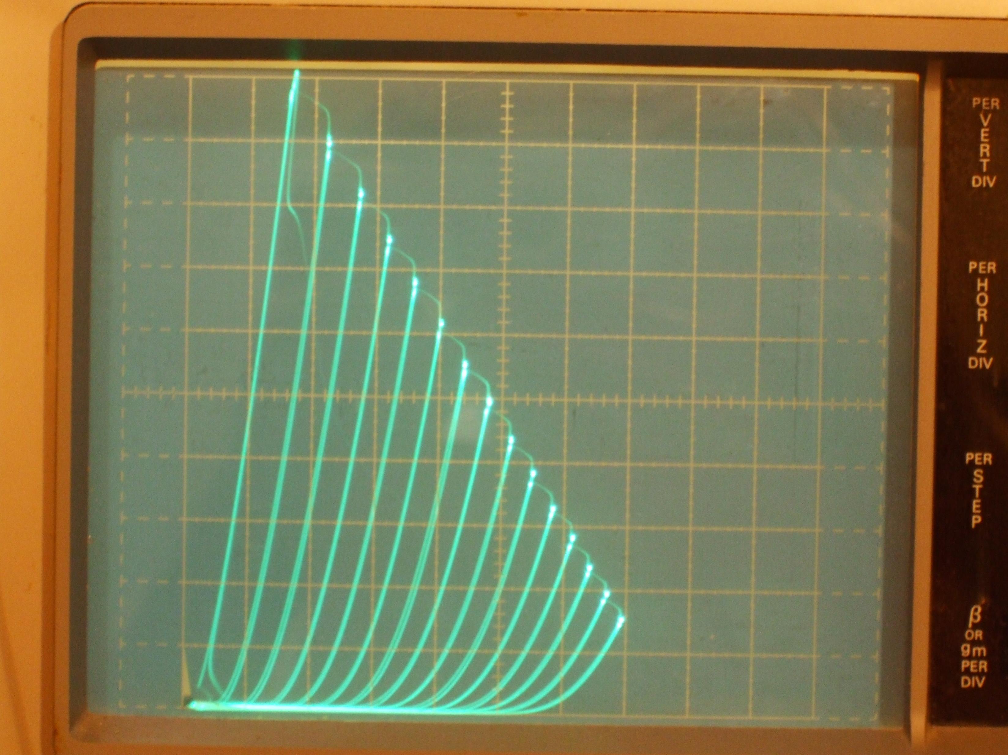

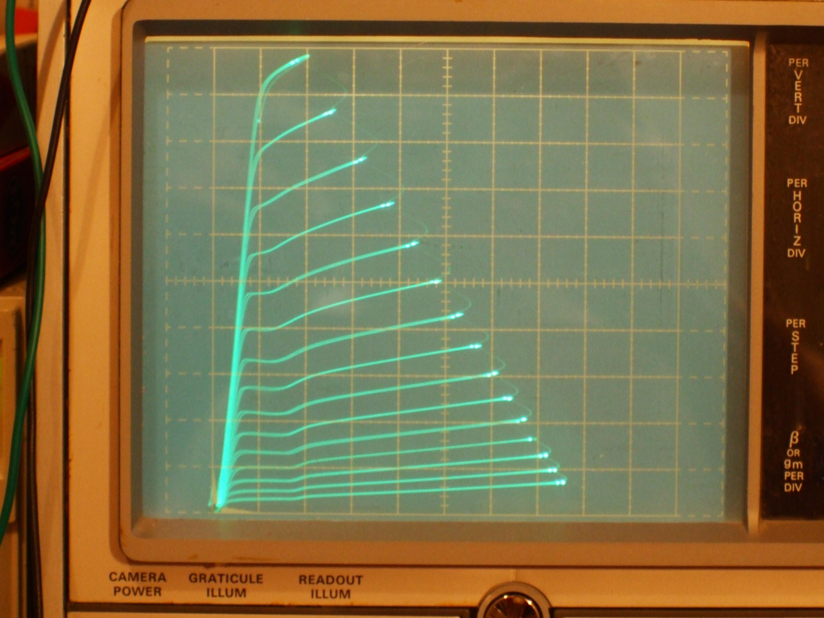

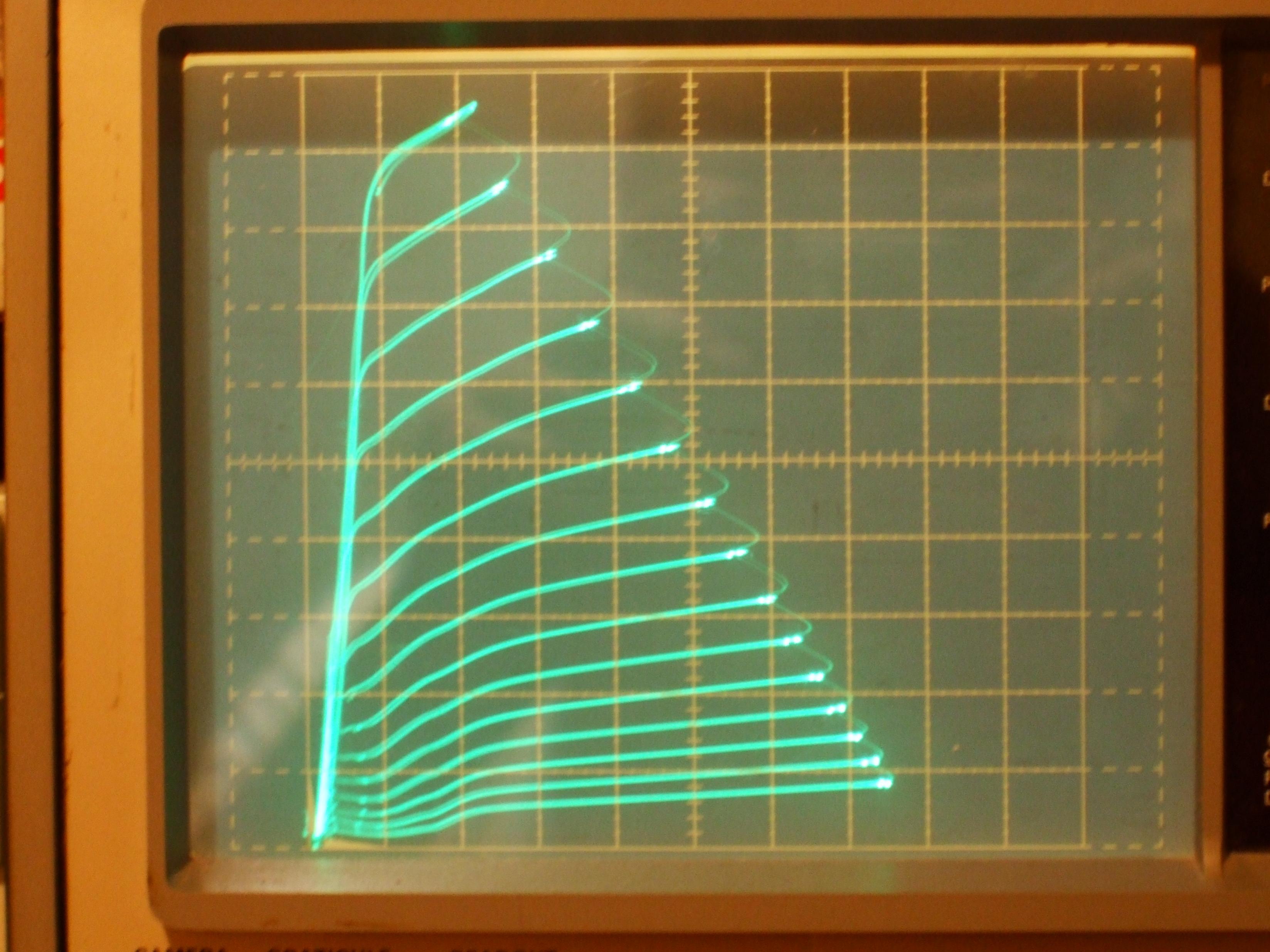

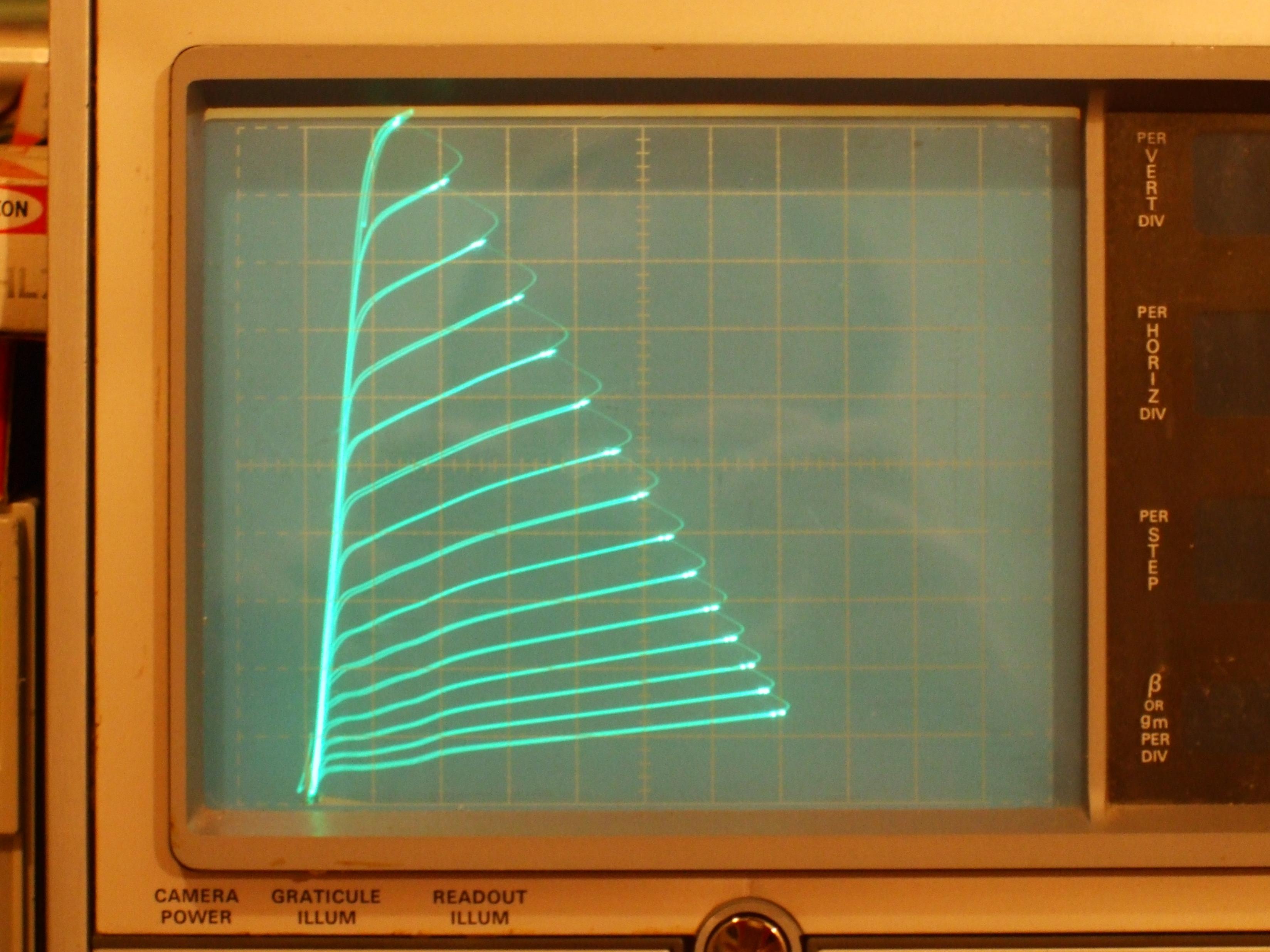

Today's mail brought the long awaited Davorin mysterious "winged" RCA 6DQ5s and a couple of 6P41S too. The tubes were labelled 102 and 145 mA, so I've kept those labels here. The emission for the two was different as you can tell.
Here are the "winged" 6DQ5s.
50V/div Horiz., 50 mA/div Vert.
a) 102 pentode -2V steps on grid 1, 100V on grid 2
b) 102 in triode -6V steps on grid 1
c) 102 in triode -8V steps on grid 1
d) 145 pentode -2V steps on grid 1, 97V on grid 2
e) 145 in triode -8V steps on grid 1
for comparison with the usual 6DQ5:
f) Rayheon (Japan) traditional 6DQ5 pentode -2v steps, 110V on grid 2
g) Raytheon (Japan) traditional 6DQ5 triode mode -6V steps
h) Sylvania (USA) traditional 6DQ5 pentode -2V steps, 110V on grid 2
Well, i would say they don't fit the traditional 6DQ5 curve sets as far as kinks go.
They have the minimised kinks of the later Sweeps with plate boxlets. These "winged" tubes do have the plate boxlets and winglets. The plates are gray, but the winglets are black. Hadn't seen that combo before. Could easily be a 6LG6 or 6JE6C or 6JS6/6HF5 or similar inside, or could just be a plain ol' 6DQ5 with all the "BLING" of the later tubes added on. You all can try to match them up. Fun, fun!!
Some tube "suspects" curves back on page 142
