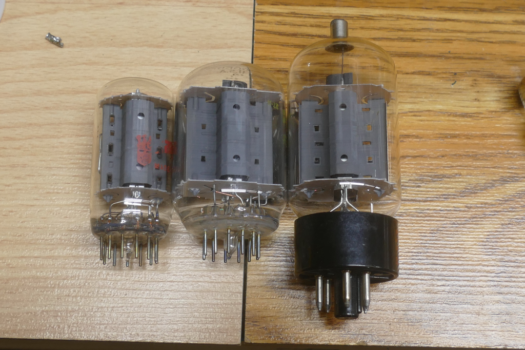

The 6GE5 is a 6DQ6 that lost it's plate cap. Some specs are a little different, probably due to more modern materials, or just differences in measurements.
The 6GF5 is a 6GE5 with it's plate "wings" clipped so it will fit in a skinny bottle.
The 6GF5 was on ESRC's $1 list forever, despite me buying "all that he had" more than once, often for less than $1. I had them running at 80 watts per pair for a couple hours of continuous sine waves with nothing glowing.

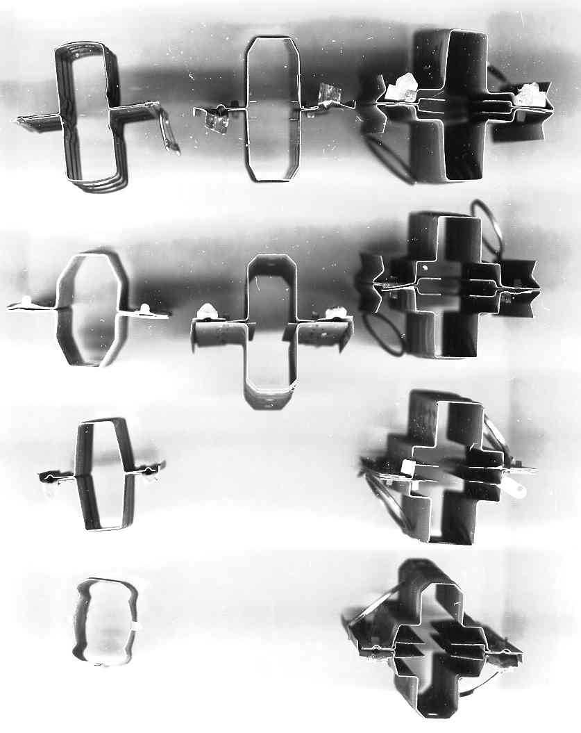

When I was quite young I had created a guitar amp design that was basically a Fender Champ with a 6BQ6GT TV sweep tube in place of the 6V6 and a bit more B+. It rocked and was quite loud. Note that the 6BQ6 and the 6DQ6 have the same pinout as the usual 6V6 and 6L6 types except that the plate is connected to a cap on the top of the tube. Note, these are NOT electrically equivalent to any of the common audio tubes, but that didn't stop a 12 year old kid from making (and blowing up) guitar amps. 6V6 and 6L6 types were rare, and cost money, but 6BQ6's and 6DQ6's were free, from inside a discarded TV set, which were quite common in the early 60's.
Of course I didn't understand little things like bias or impedance, bit I never understood why the amp was quieter and tended st smoke when I plugged in the bigger 6DQ6 tube. Years later I would figure all that stuff out.
Now much later I have revisited some of those tubes from my youth, the old TV tubes, and the then dirt common 807's, which I never knew at time WERE 6L6GB's in disguise. I also found out by cracking open a few, then looking them up, that these 3 tubes contain exactly the same guts. The little ones just have smaller wings on their plates. The little guys ROCK too.....that board makes 75WPC!!!!
The little guy is a 6GF5's, the middle tube is a 6GE5's and the tall guy is a 6DQ6.
I think I read where the 6GF5 was used in the TEK 555 scope power supply. Maybe -only- there too, not much demand I think. A Horiz. sweep for some tiny TV? My old Heathkit IO-14 scope had 6GE5 tubes in it for Volt. regulators.
They were also found in small TV sets for a few years. I have found them in three different heights with the Zenith branded GE's being the shortest and RCA's the tallest. The amp in the above picture has Zenith branded GE's in the left channel, and regular GE's in the right. The right channel tubes are about 1/4 inch taller.
I worked in the calibration lab in a Motorola plant for 10 years. The TEK 504 and another similar scope that used a 6DQ6 in a vacuum tube SMPS. I used to have some 6DQ6's in my "crash cart" when I ran factory floor support in the early 70's. Swapping that tube always fixed the "my scope is getting dim" issues. By the late 70's all of those scopes had been swapped out for solid state Hitachi V-151's.

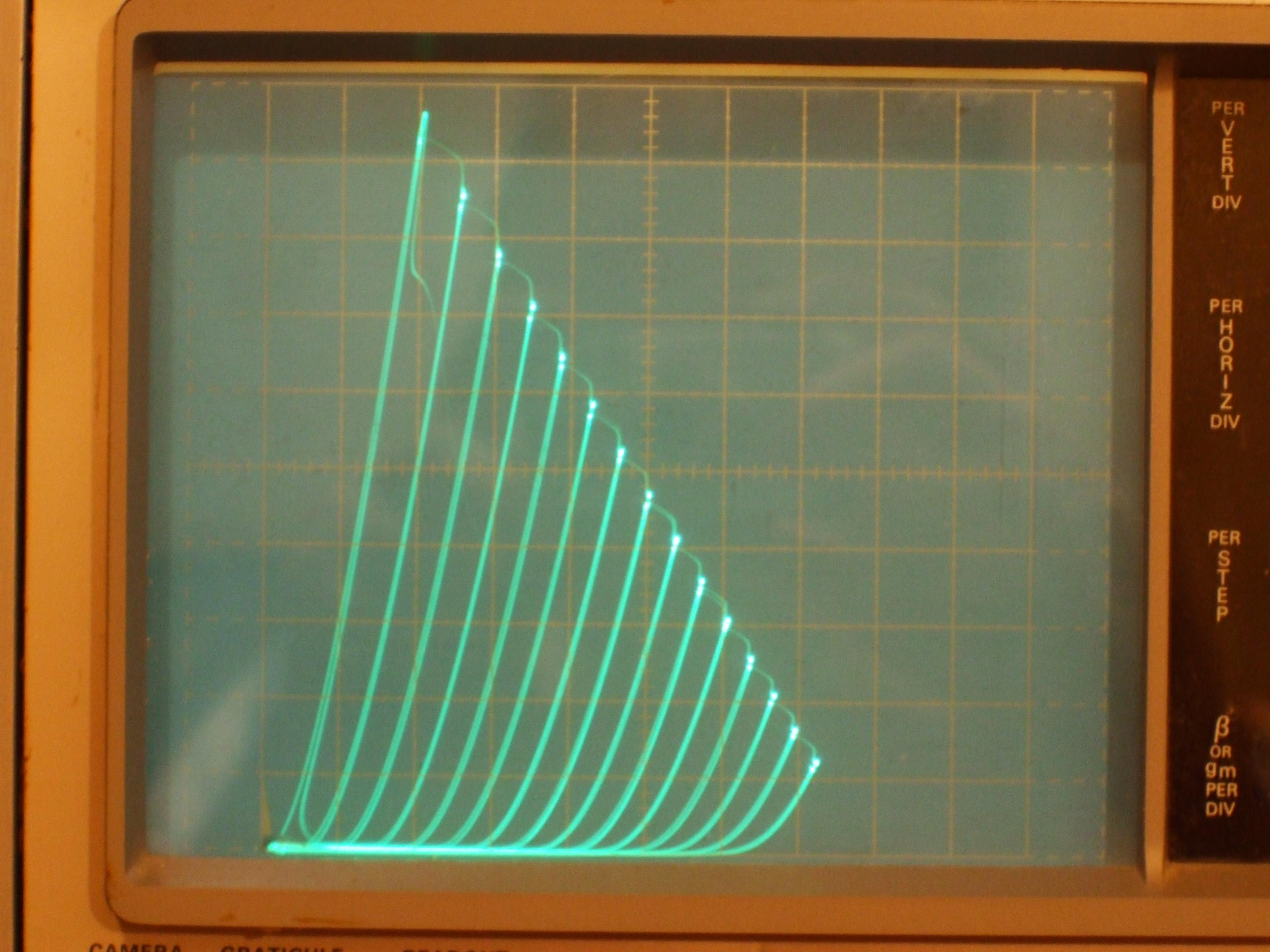

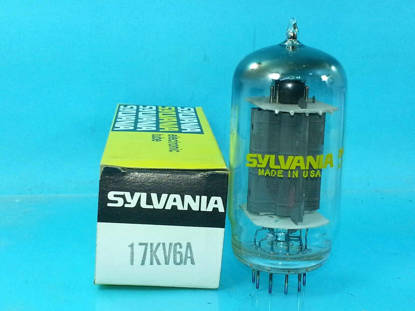

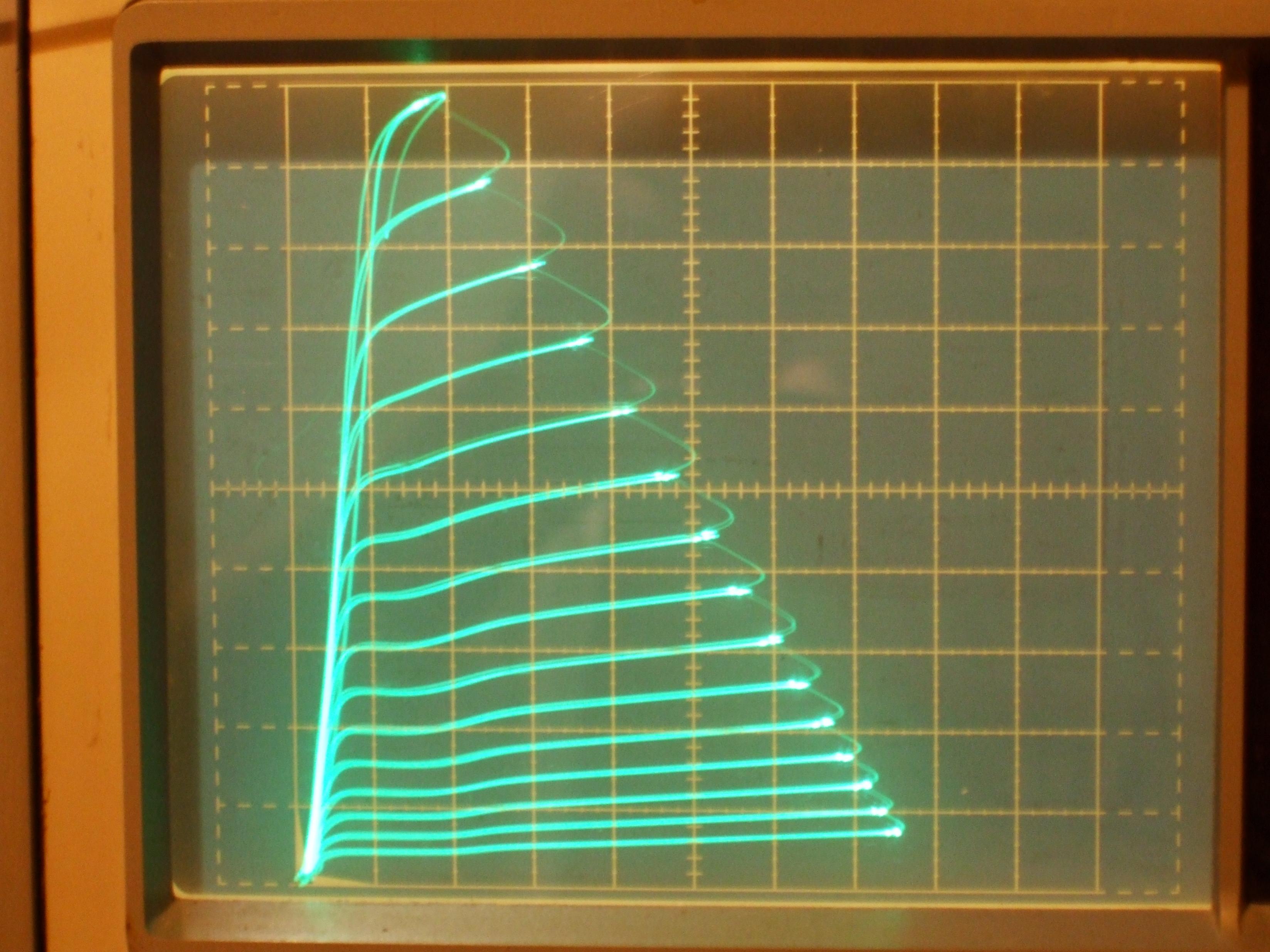

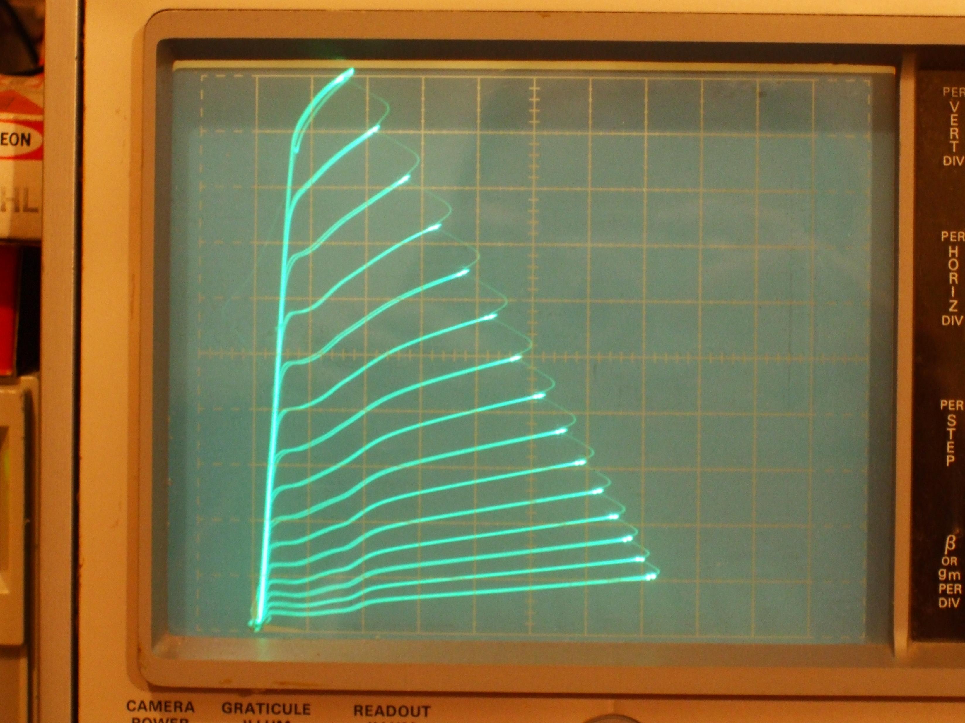

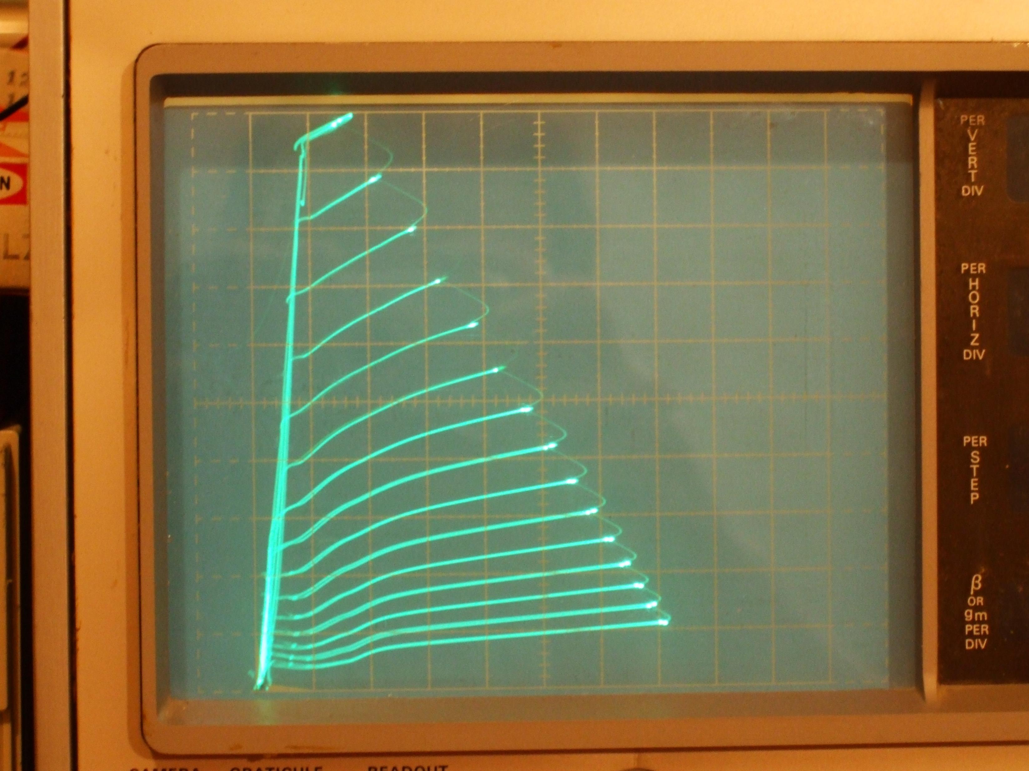

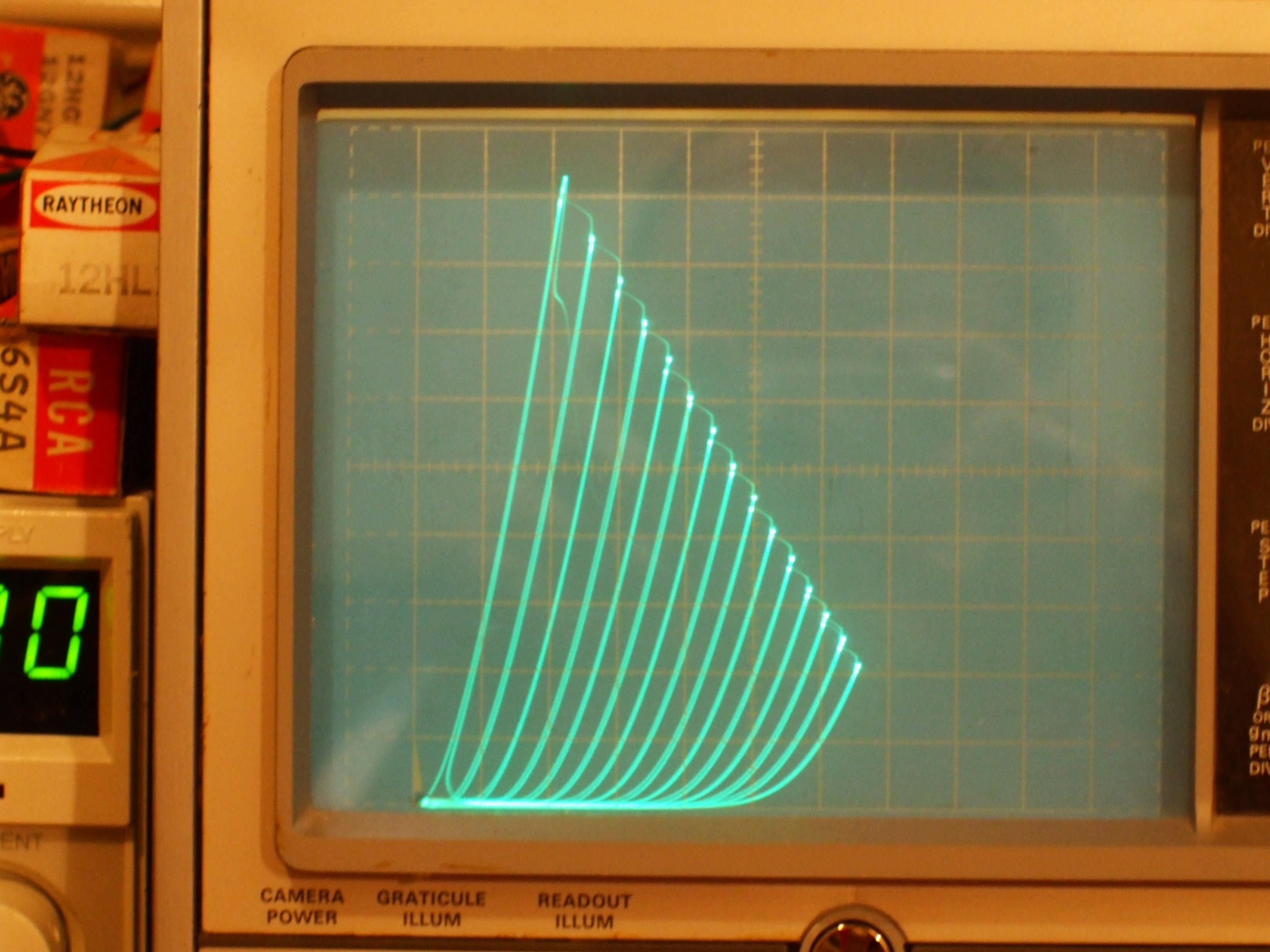

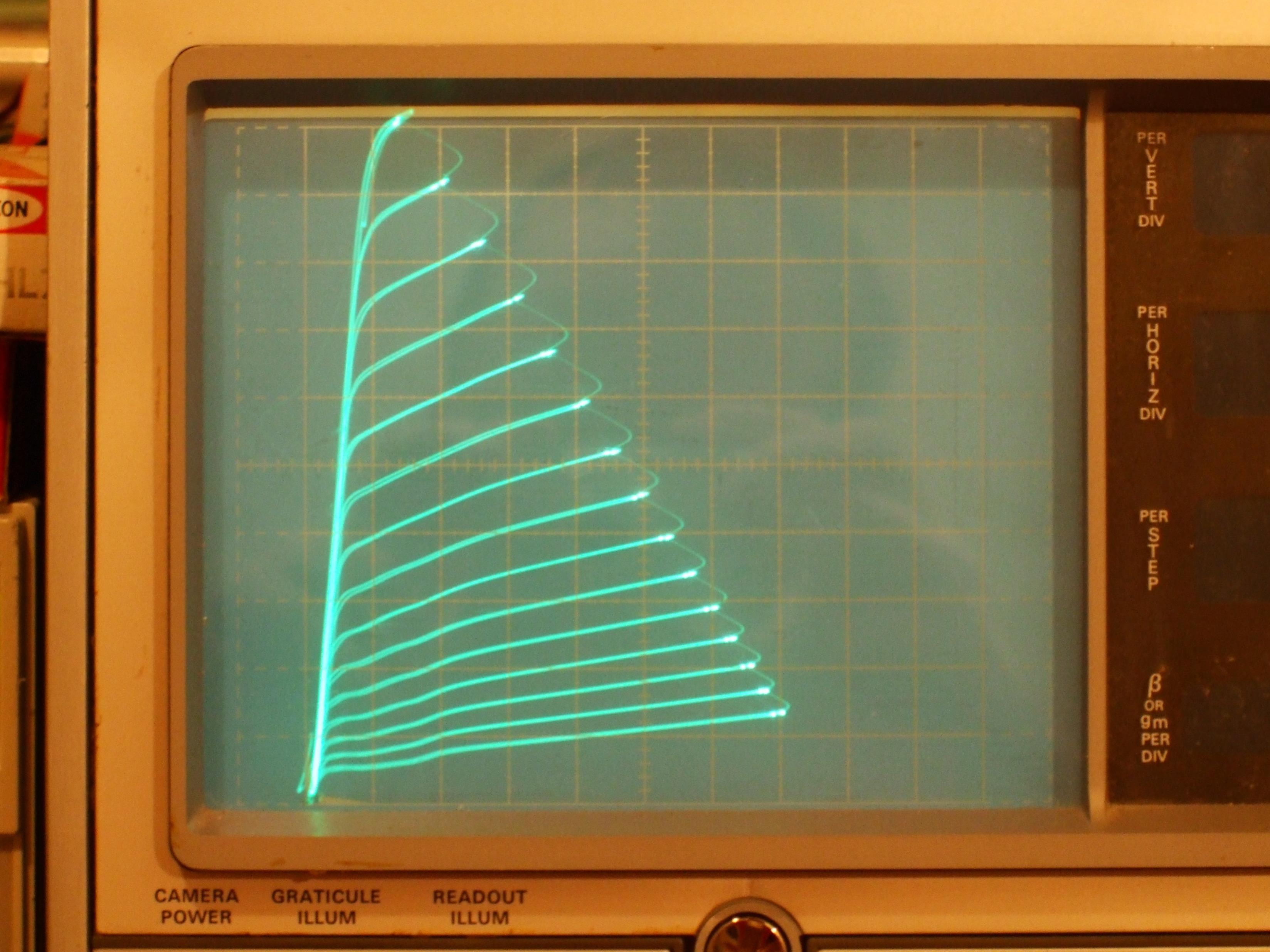

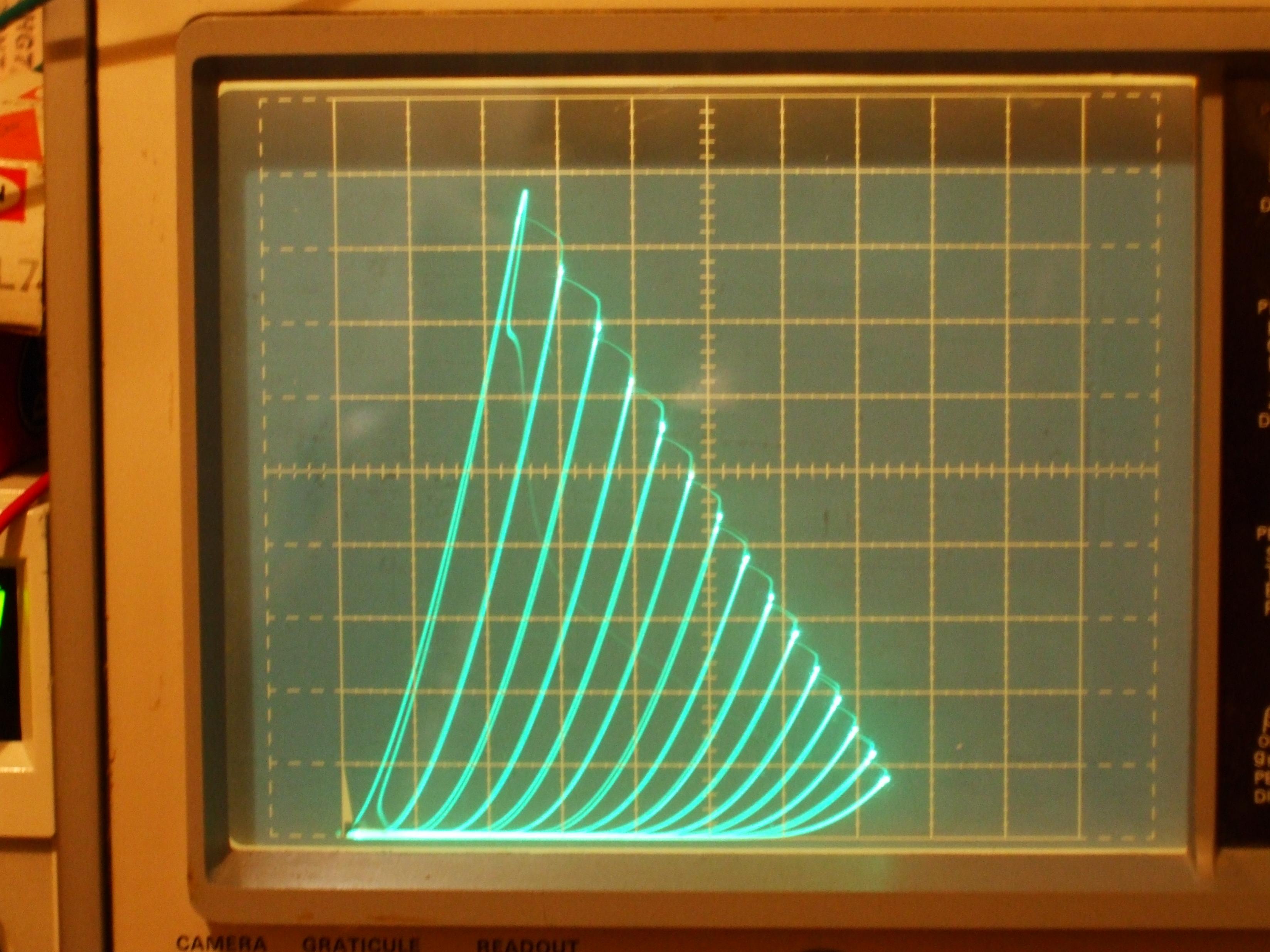

Here is a sleeper Sweep tube. The 17KV6A (Sylvania traced here)
It's rated at 28 Watts for HV regulator service (in TVs). The regulator description may have put some off to it for audio, but this is a very fine Sweep tube as well, most likely based on the 6KM6 Sweep tube. The data sheets for 6KM6 and 6KV6 (non -A) were identical.
Then the -A version came along with a higher plate Watt rating but lower Screen Watt rating. For regulator service, the screen current can be kept low and steady. The usual conversion factor for Sweeps is 4 plate Watts for every reduced Screen Watt.
So reverting that back to Sweep duty would put the 17KV6A at 22 Watts plate and 3.5 Watts screen. It has the same size plate as many 24 Watt Sweep tubes with a grid 1 cooler fin up top (similar to 6LG6A). It's a low screen current tube anyway, so maybe a 24 Watt rating makes OK sense for Sweep duty. 275 mA max DC, 950 mA peak (spec)
The main issue with this tube is the NOVAR socket. Hard to find good fitting real Novar sockets these days. Many Magnoval/Novar Chinese sockets are too loose on Novar pins, but a few do work. These tubes were sold years back on Antique Electronics Sales brochures for $2.30, but not so cheap lately. One thing I like about some versions of this tube (mainly Sylvania 17KV6 is the seal tip on top, looks Antique) Some other Novar tubes have a similar top seal, like 22JG6, 17JT6, 22JR6.
a) pentode 50V/div Horiz., 50mA/div Vert., -2V steps, 140V on grid 2
b) triode mode 50V/div Horiz., 50mA/div Vert., -6V steps (Mu 4 spec)

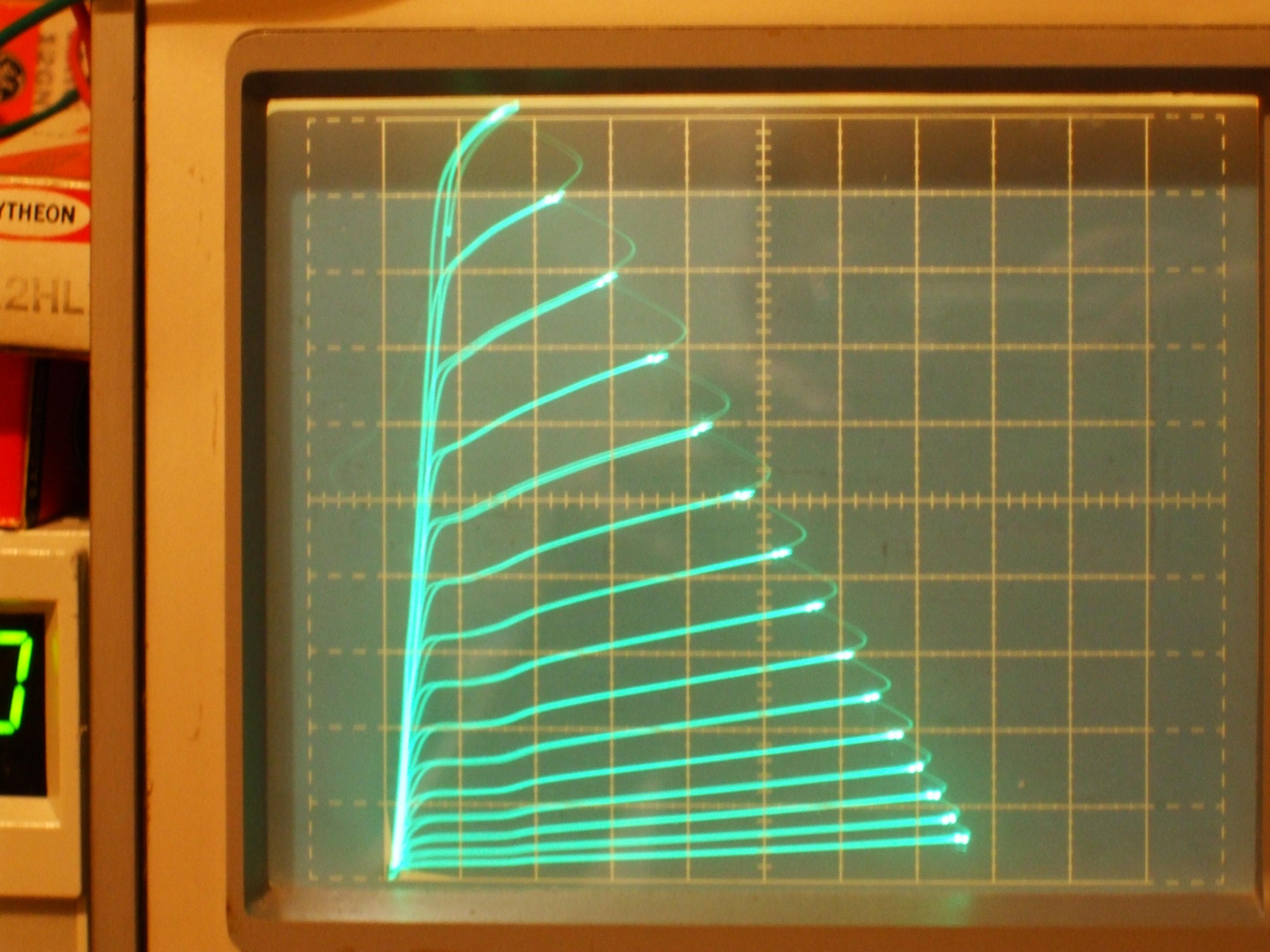

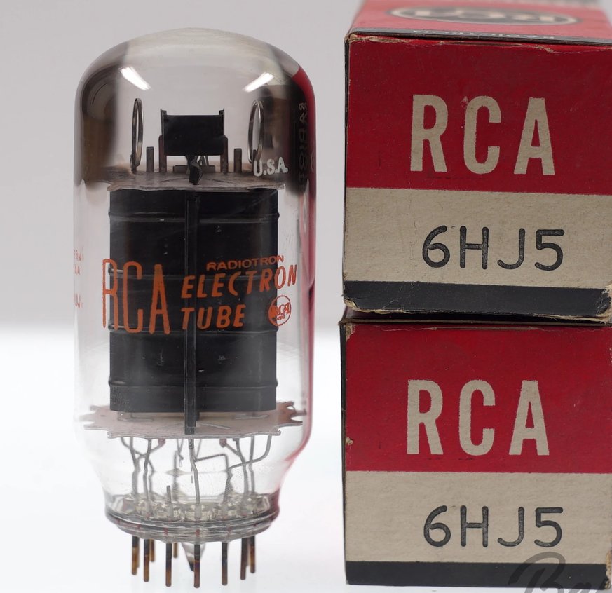

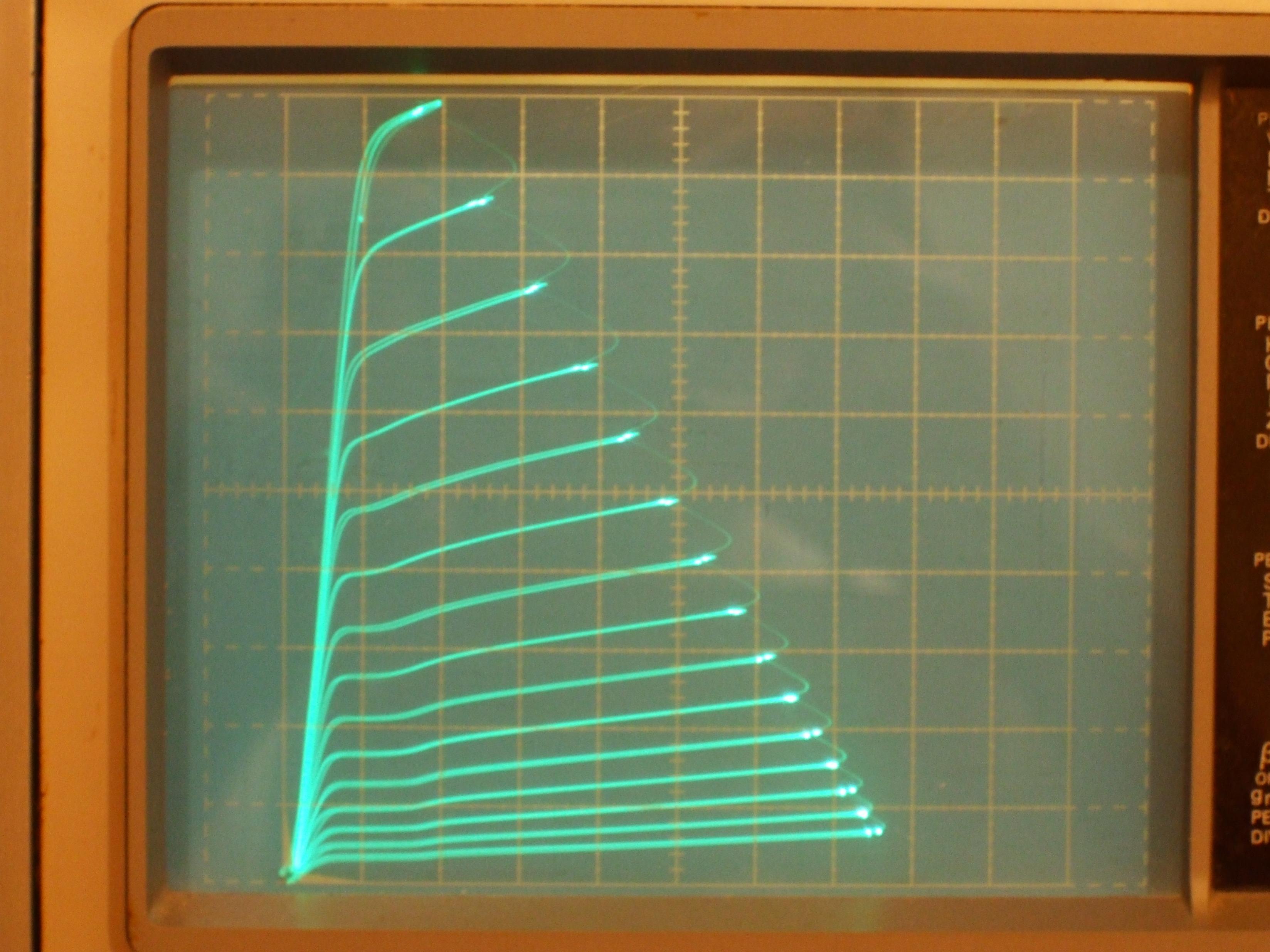

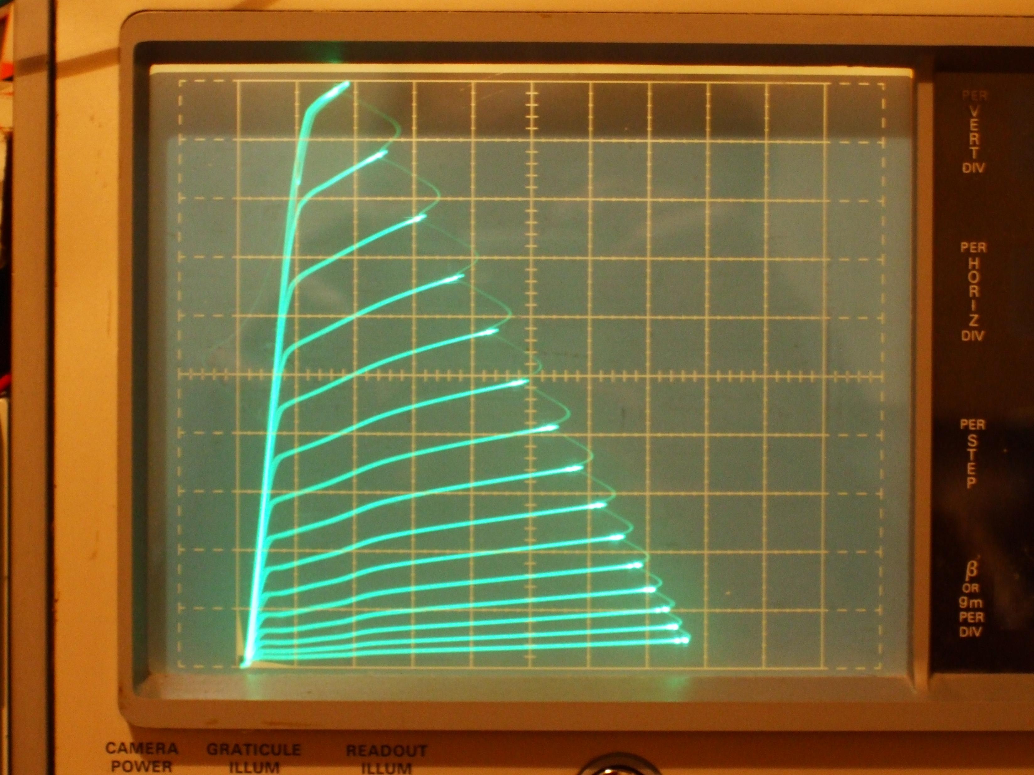

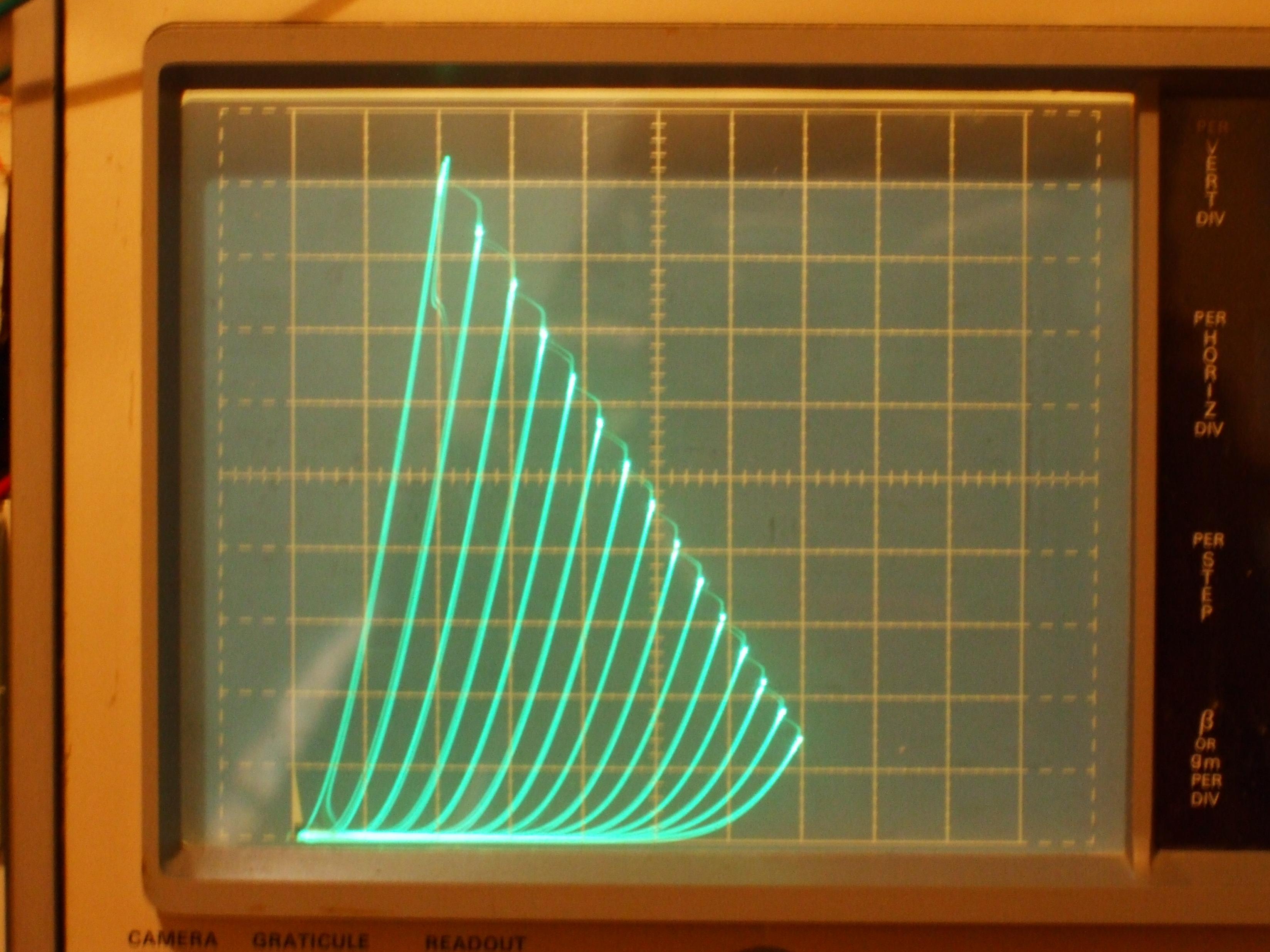

Here is a Raytheon 6HJ5 Sweep tube. These tubes mostly vanished after P. Millett's 50 Watt Monoblock came out, and are quite nice. I think George said he could get up to 125 Watts out of a pair of these. Seems to also be the biggest cap-less 24 Watt Sweep tube around. It's a Low screen current version of the 6DQ5. Similar to the 21/6LG6A too. I believe ALL the brands of 6HJ5 around (RCA, SYL, ...) were actually made by Raytheon. These tubes were selling for like $3 to $5 for a long while, until they mostly vanished. I suspect they were made for some Radar monitor deflection use.
a) pentode 50V/div Horiz., 50 mA/div Vert., -2V steps, 108V on grid 2
b) triode mode 50V/div Horiz., 50 mA/div Vert., -6V steps (Mu 4.2 spec)

The 6HJ5 has a twin, the 6HD5, 21HD5 and 28HD5. It's the same tube except for minor pinout differences. The cathode is connected directly to G3 and pin 2 is left open on the 6HD5. Connect pins 2,4, and 10 together in your design and you can use either tube. Back when I was playing with Pete's big red board I bought a box full of 6HD5's from Stan for cheap since he had no record of ever selling any.
I have seen Raytheon and a Japanese version of the 6HD5. I have never seen the 21 or 28 volt version. Most of the 6HD5's I have are Motorola branded. They could have used it in their crappy TV sets, but I don't think it was ever used in two way radio stuff.
I think I have a few 6HD5s. But i don't recall any of 6HJ5 or 6HD5 looking like it was Japanese. What brand name is on these Japanese versions boxes?

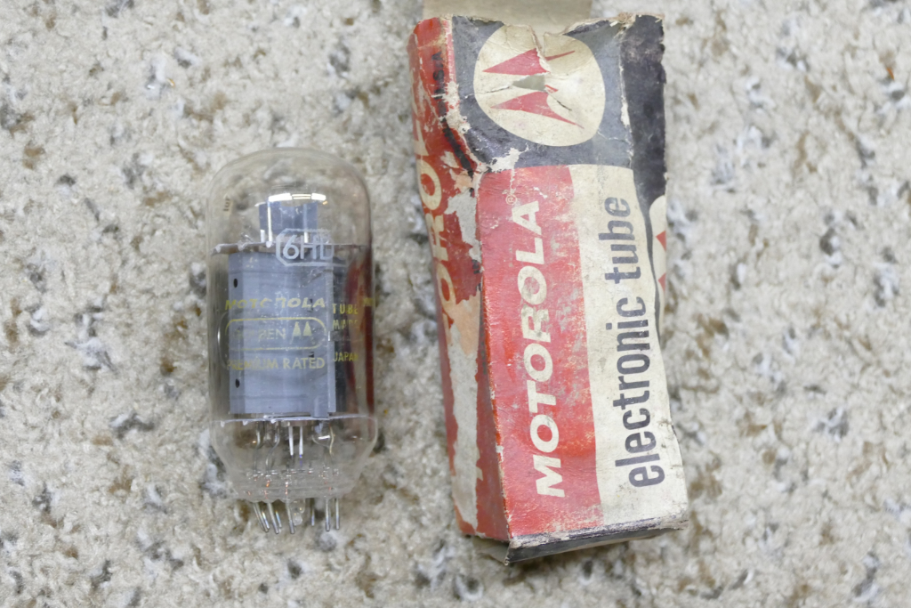

I just found a Setchell-Carlson box, but the tube still says LYFA on it, which is the Raytheon plant location apparently.
Late Edit:

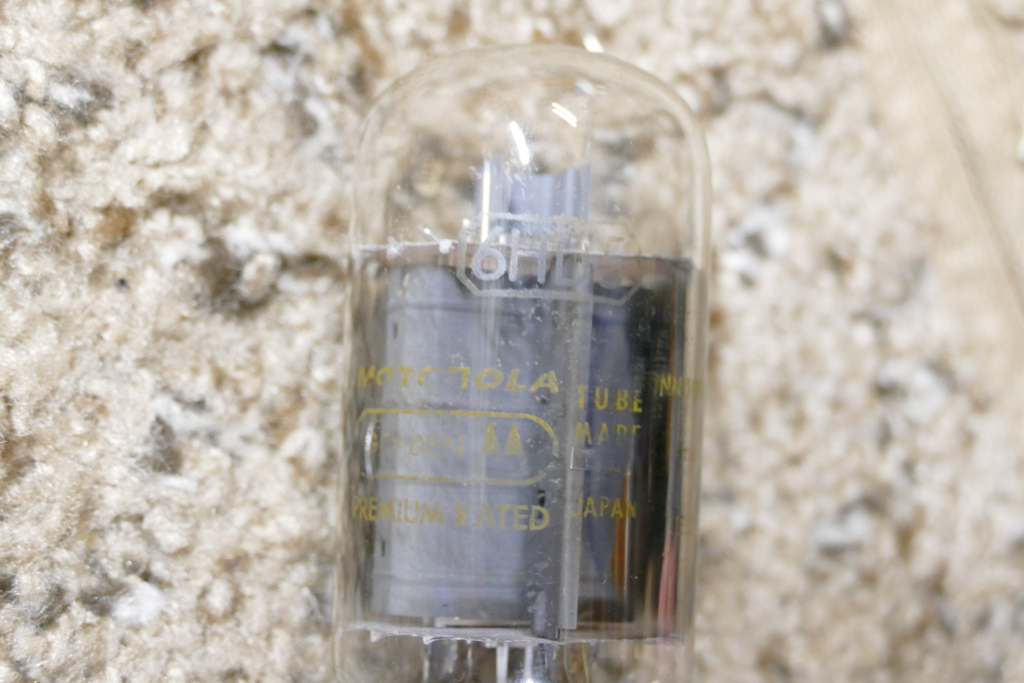

I just found a Motorola 6HD5 box and the tube IS different. Looks like it has JAPAN on it, although mostly rubbed off. The plate is gray instead of black. I'm going to curve trace it to see if there's any difference.
I just curve traced the Motorola (Japan) 6HD5 versus the Raytheon 6HJ5 tube and the only noticeable difference is the Motorola tube needs 122V on grid 2 to match the Raytheon tube with 108V on grid 2. Fairly close otherwise, just a small difference in the small screen current "dents".
Late Edit:
Mine are Motorola, and match your description. The word "GOLDEN" on the tube indicates that it was intended for TV use. Motorola's first TV set was called the Golden View. That name resurfaced a few times, always associated with TV's.
The grey plate does look like a clone of a GE plate, and the word compactron is on the box, which is a GE trademark.
Yep, looks exactly like the Motorola tube I have here. Getter rings on the sides of the plate instead of up top like the Raytheon. I probably got it from Stan too. It even says "Made in Japan" on one side only of the box, duh... I missed that before.
I assume Setchell-Carlson made TVs too. I've found like 4 of their boxes for 6HJ5. But they seem to be the usual Raytheon tube inside with barely visible Setchell-Carlson printing on it.

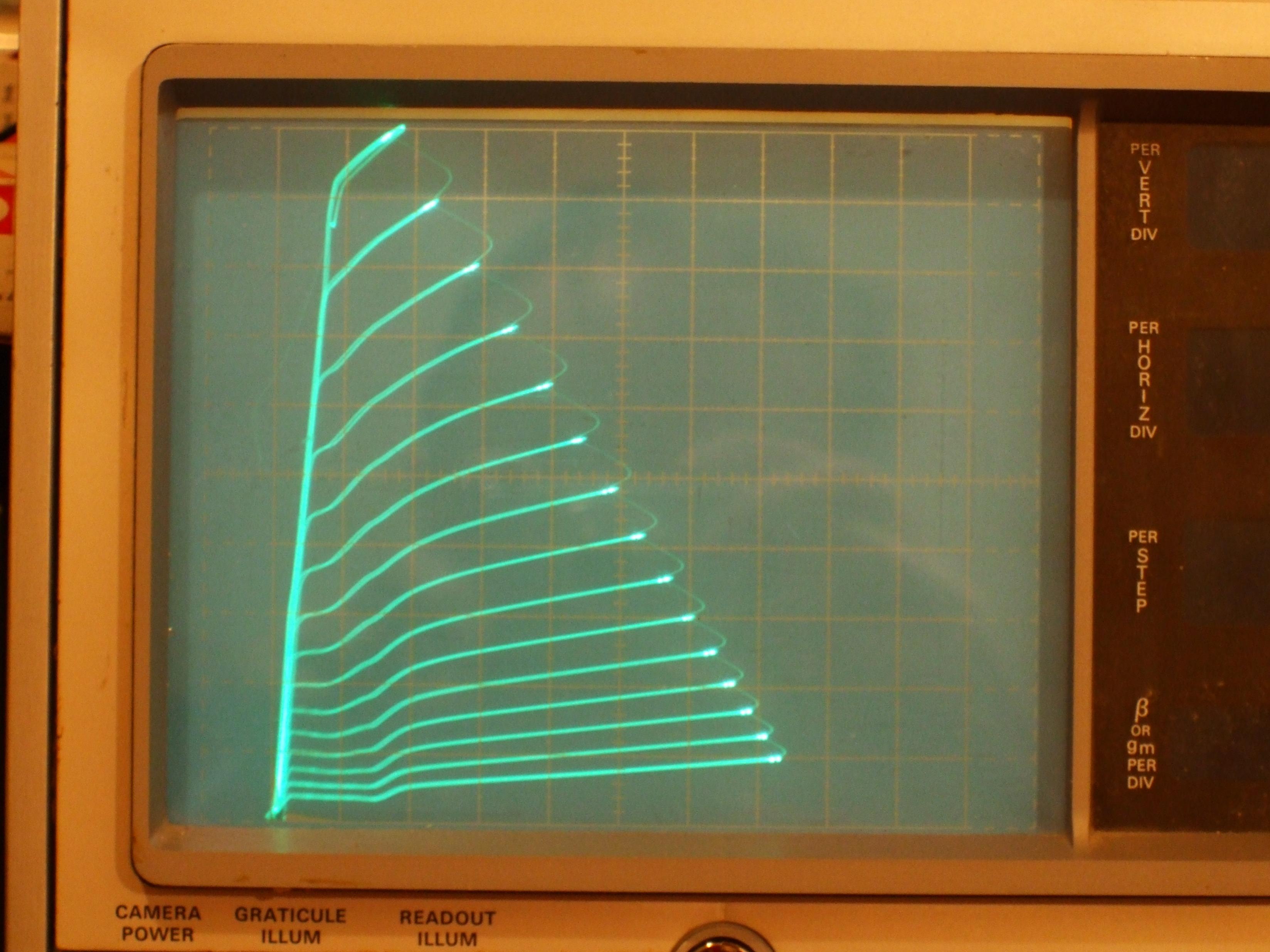

I did some more rummaging thru my bins of TV Sweep tubes and found some more 26/6DQ5 tubes. So I'm posting some plate curves for them to compare with Davorin's odd "winged" 6DQ5 when it arrives. The Raytheon 6DQ5 has surprisingly small screen current wrinkles for a tube without Barks or Boxlets in the plate. Maybe it just has really good grid 1 and grid 2 qalignment?
All curves are 50V/div Horiz., and 50mA/div Vert.
a) Raytheon 6DQ5 pentode -2V steps, 110V on grid 2
b) Raytheon 6DQ5 triode mode -6V steps
c) Westinghouse (Japan) 26DQ5 pentode -2V steps, 110V on grid 2
d) Westinghouse (Japan) 26DQ5 in triode mode, -6V steps
e) a second Sylvania 6DQ5 pentode -2V steps, 110V on grid 2
f) the earlier Sylvania 6DQ5 pentode -2V steps, 110V on grid 2
g) GE 21LG6 pentode -2V steps, 100V on grid 2
h) Raytheon 6HJ5 pentode -2V steps, 108V on grid 2

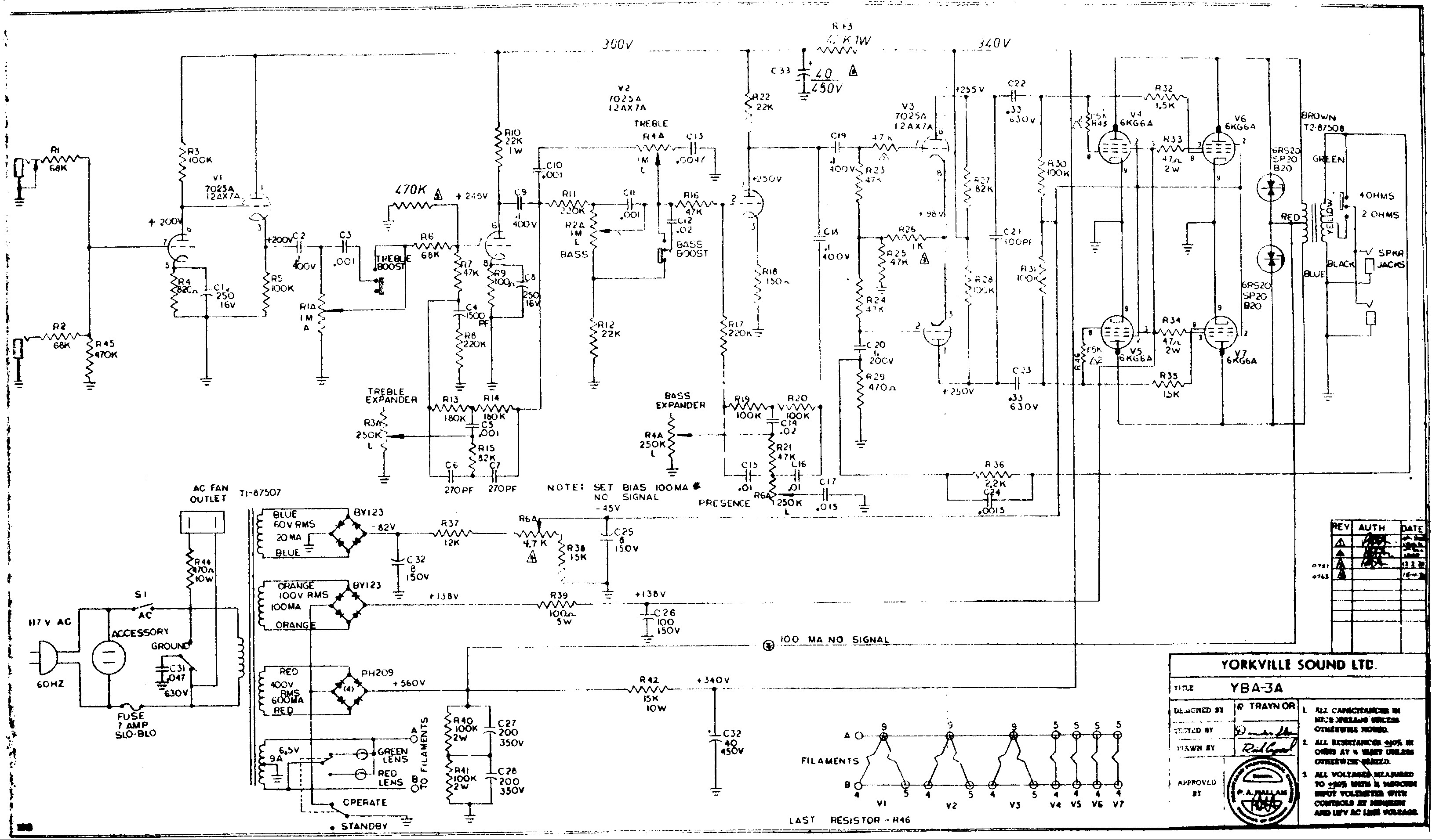

In the "Traynor YBA-3A" bass amp there are 4 pieces of 6KG6A in push-pull connection with Ua ~ 560V, Ug2 ~ 138V, Ug1-45V, and on Ug3-45 too! The excitation signal is fed normally to the G1, and I believe the amplifier certainly has more than 150W of output power.
Davorin thanks .....interesting.Now what influence does a negatively charged g3 have on the PL509 characteristic curves?

Is this what you mean.....
No, those are grid cooler fins up top.
In the picture below, in the right side column, the top two plates have winglets on the edges. These help cool the Barkhausen fins inside.
The full right column has the plate "boxlets" with Barkhausen fins inside of them. These are what reduce secondary emission by grazing electron incidence on the Barkhausen plates and then the secondary electrons bounce around inside the box and get absorbed in the plate. This helps reduce secondaries getting back to the screen grid. Giving squarer plate curve knees with reduced kinks.
For 6JE6A and later versions of it, all had the boxlets with Barkhausen fins.
6JE6C, 6ME6 and 6MJ6 got the winglets in addition for better Bark. cooling.
