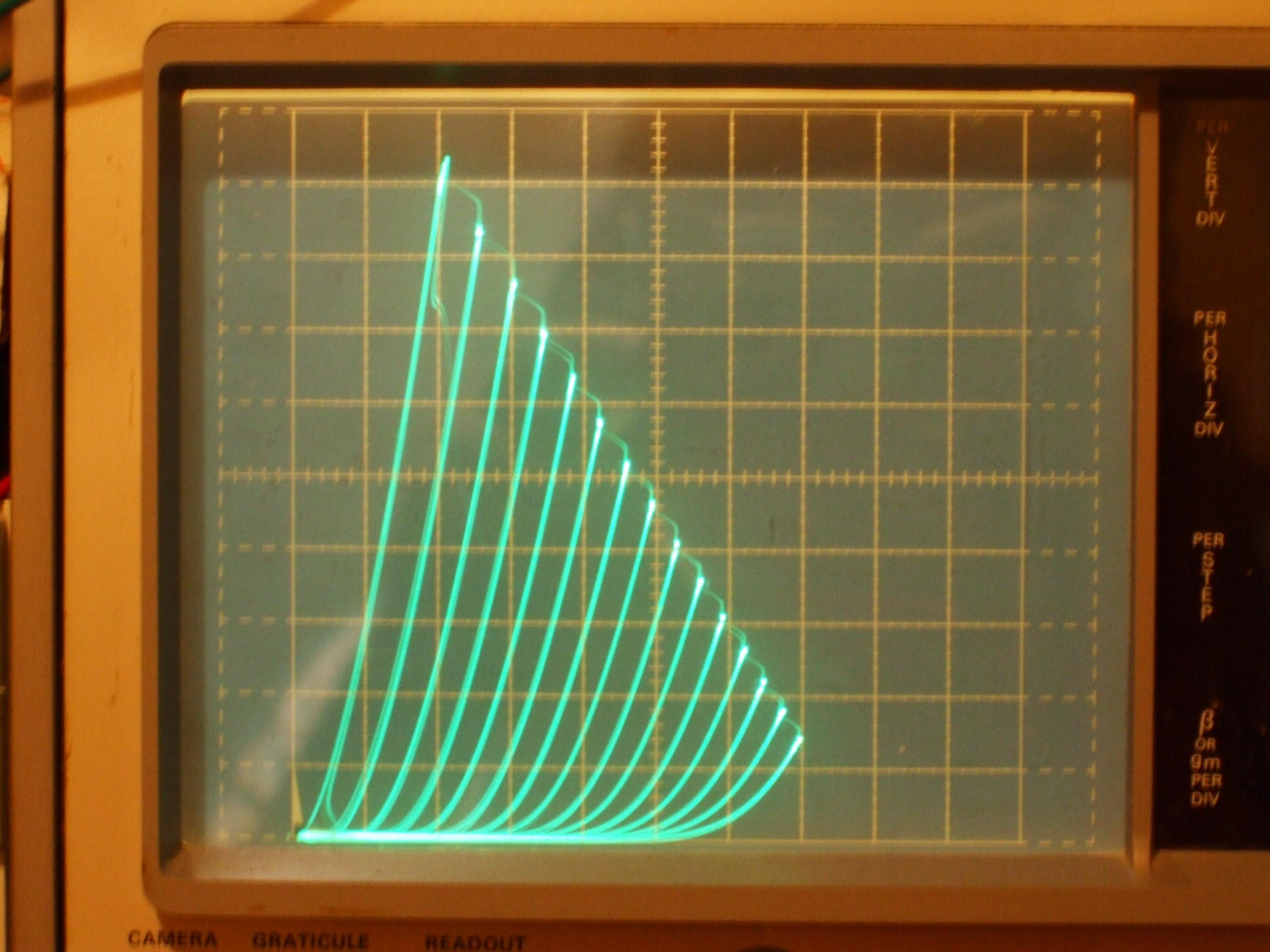

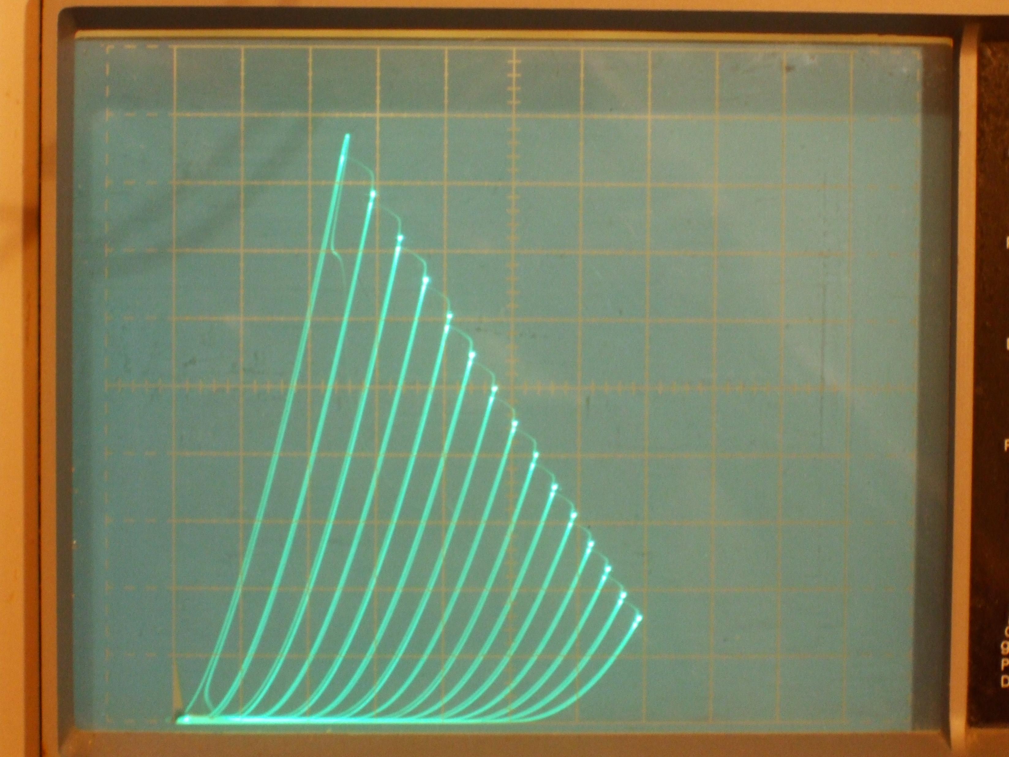

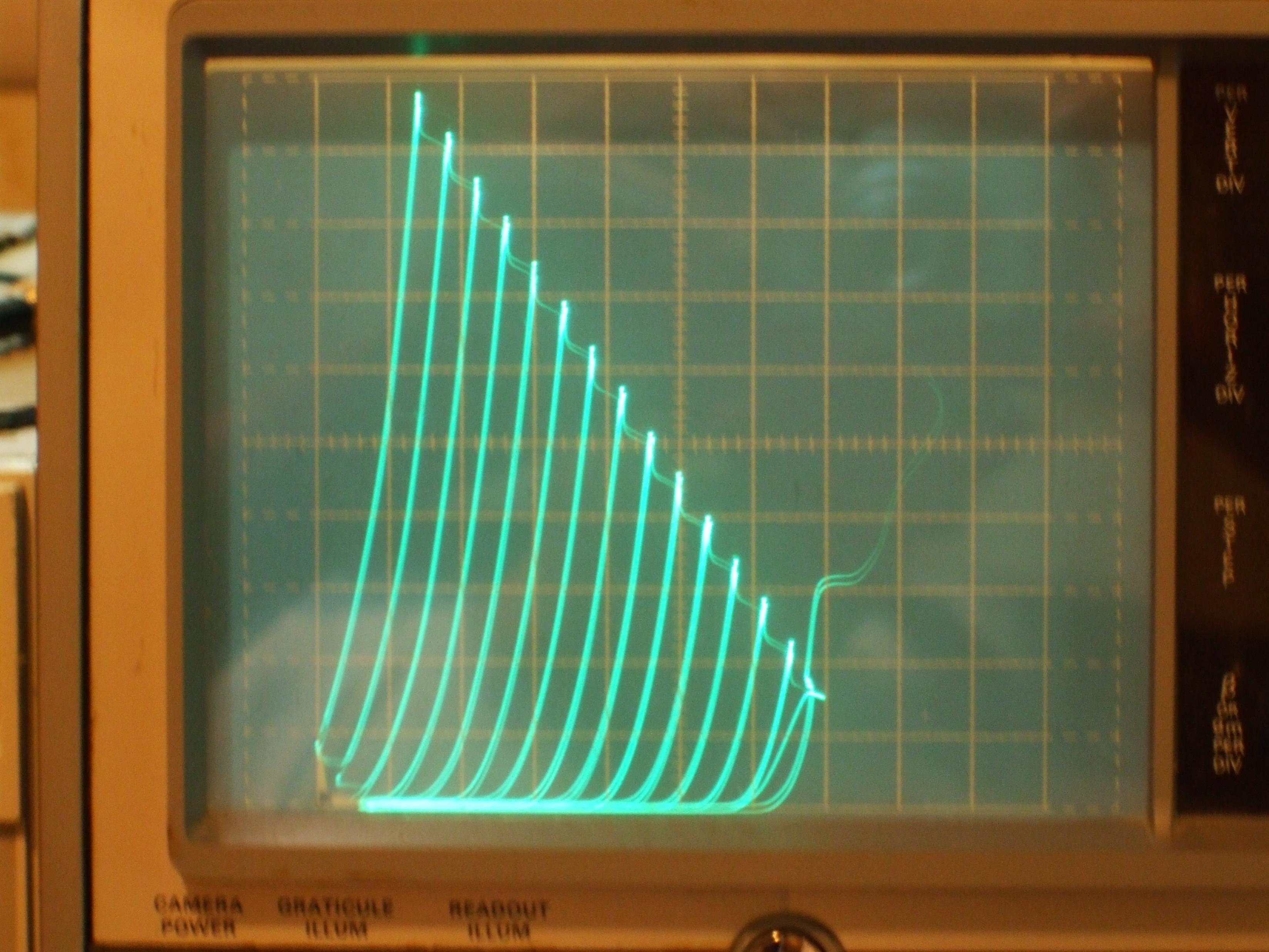

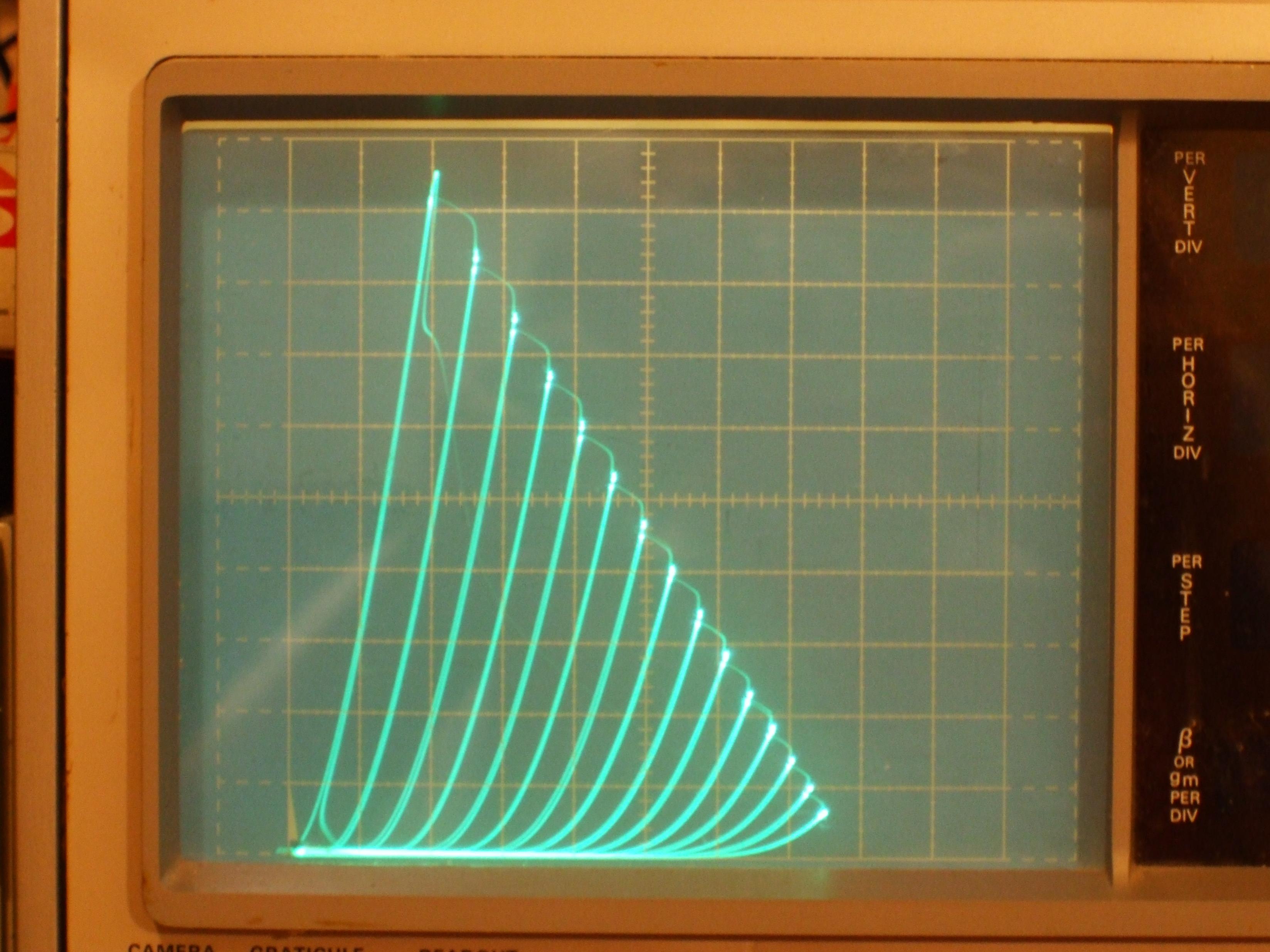

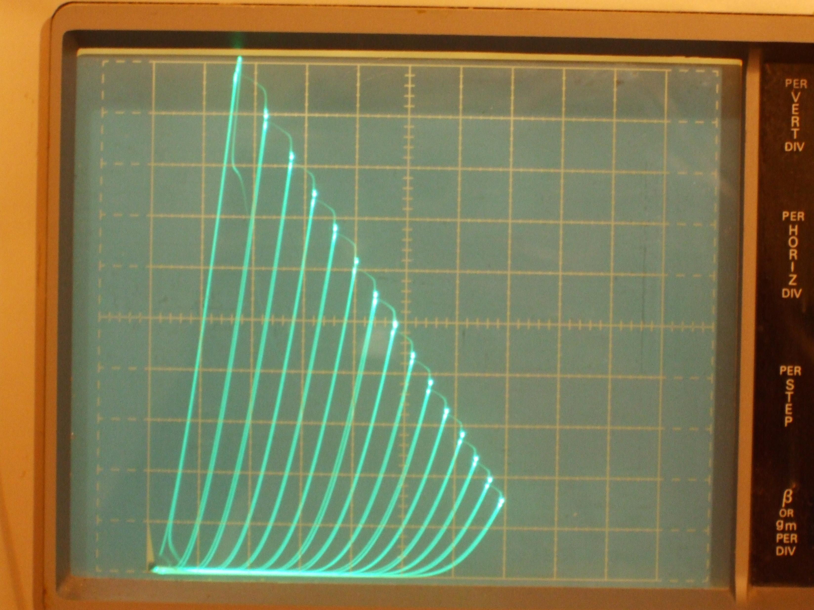

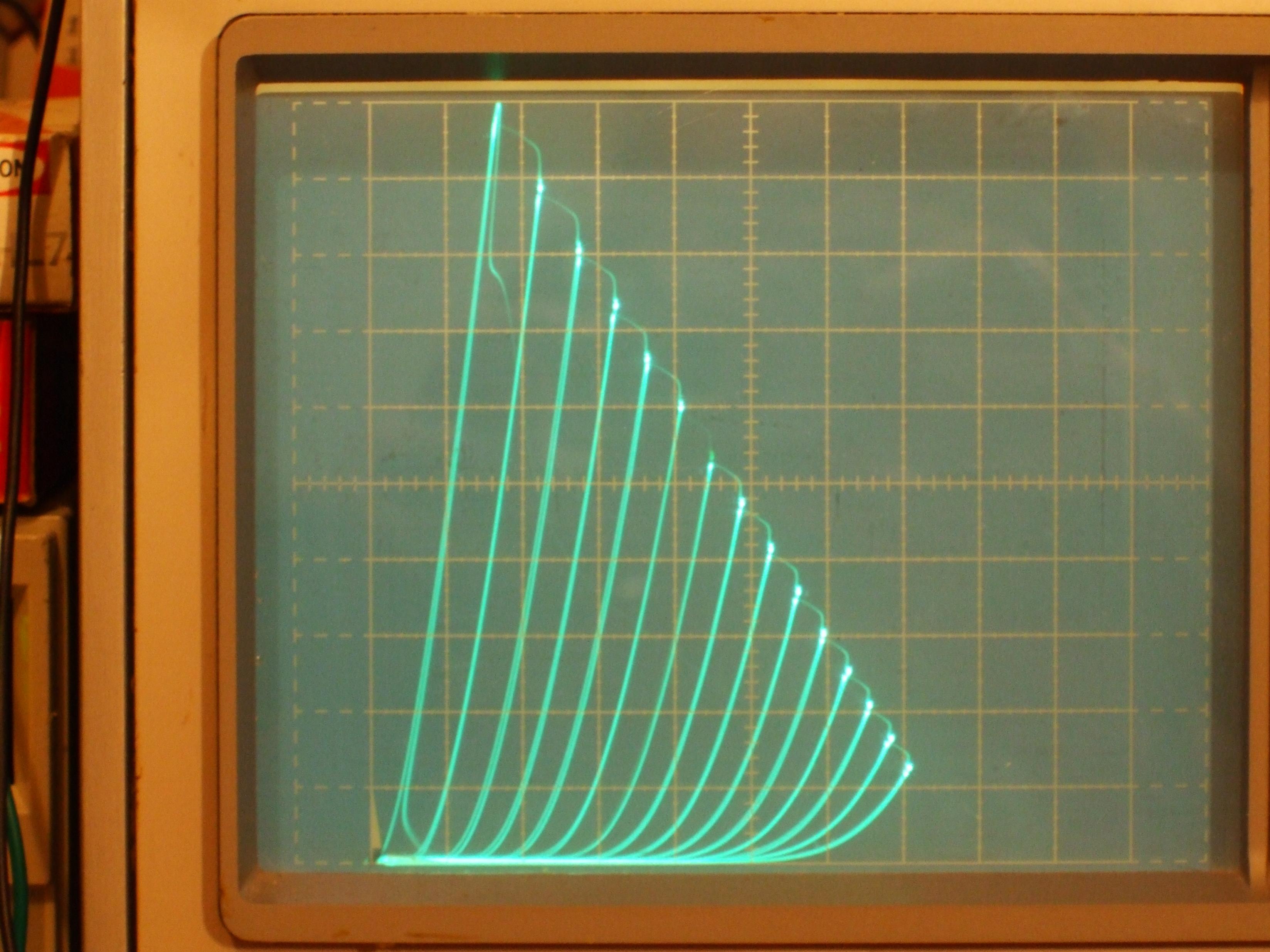

The TV Sweep tubes do have a low Rp in triode mode (like 313 Ohm for 21LG6A) but often not spectacularly good triode curves. The 21LG6A does have noticeable curve "rollover" in its triode curves (a common ailment for Sweeps), which would cause noticeable 2nd Harmonic dist. in SE mode.
The other bigger problem is the low voltage rating for grid 2. Some Sweeps can develop runaway current after operating above g2 spec for extended periods in triode configuration.

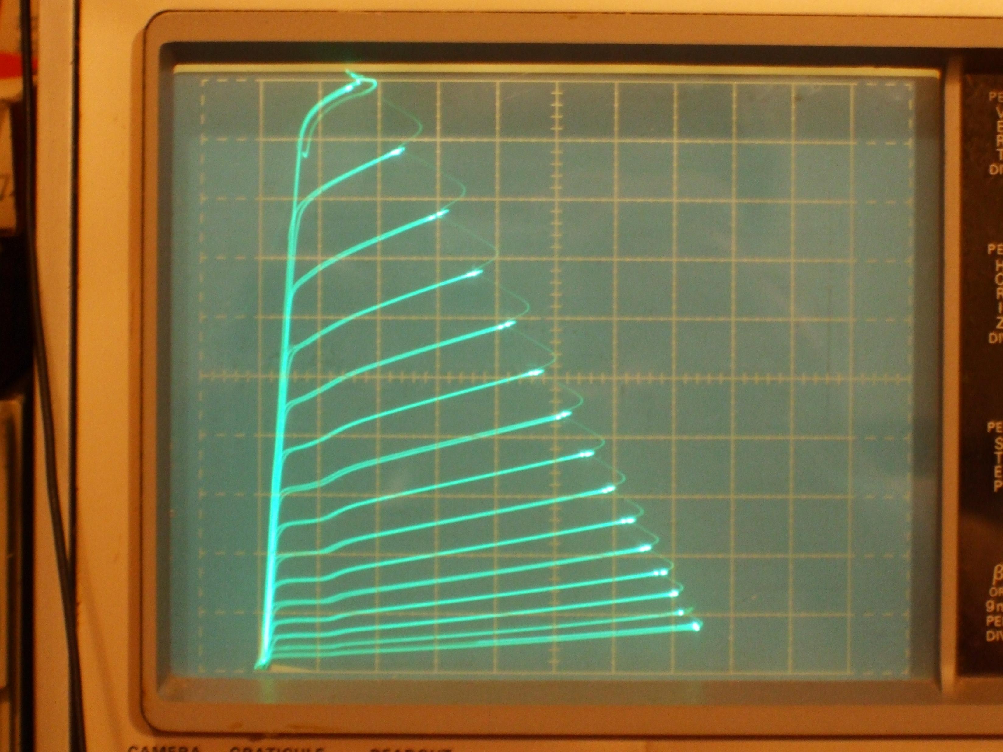

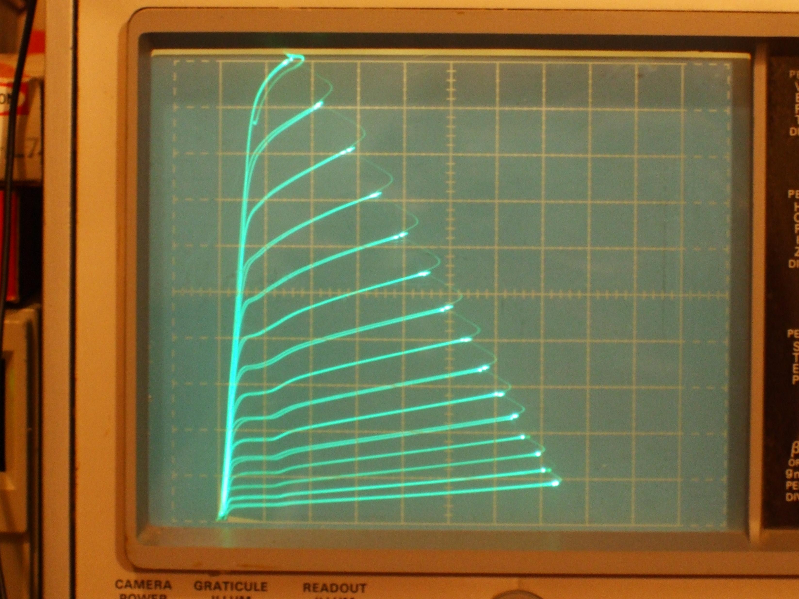

The latest cure for all this is to use the "new" series Schade (or UnSET, CED at Tubelab). This fixes the g2 V problem, and also the curve "rollover" problem. (and one can adjust how much 2nd H one wants left in by using some Schade on grid 2 as well) The output power can be increased another 20% or so too, since the cathode driver power adds to the tube's power output.

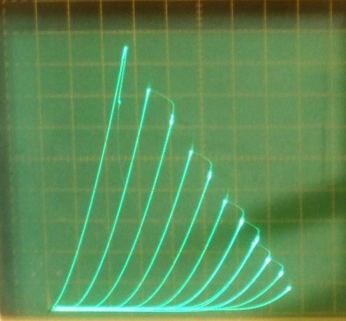

Pics below of 21LG6A in native triode mode, then a similar 6HJ5 in "new" series Schade mode. Then a 21HB5A in the "new" series Schade with the triode "rollover" really knocked out and also 21HB5A in ordinary triode mode.

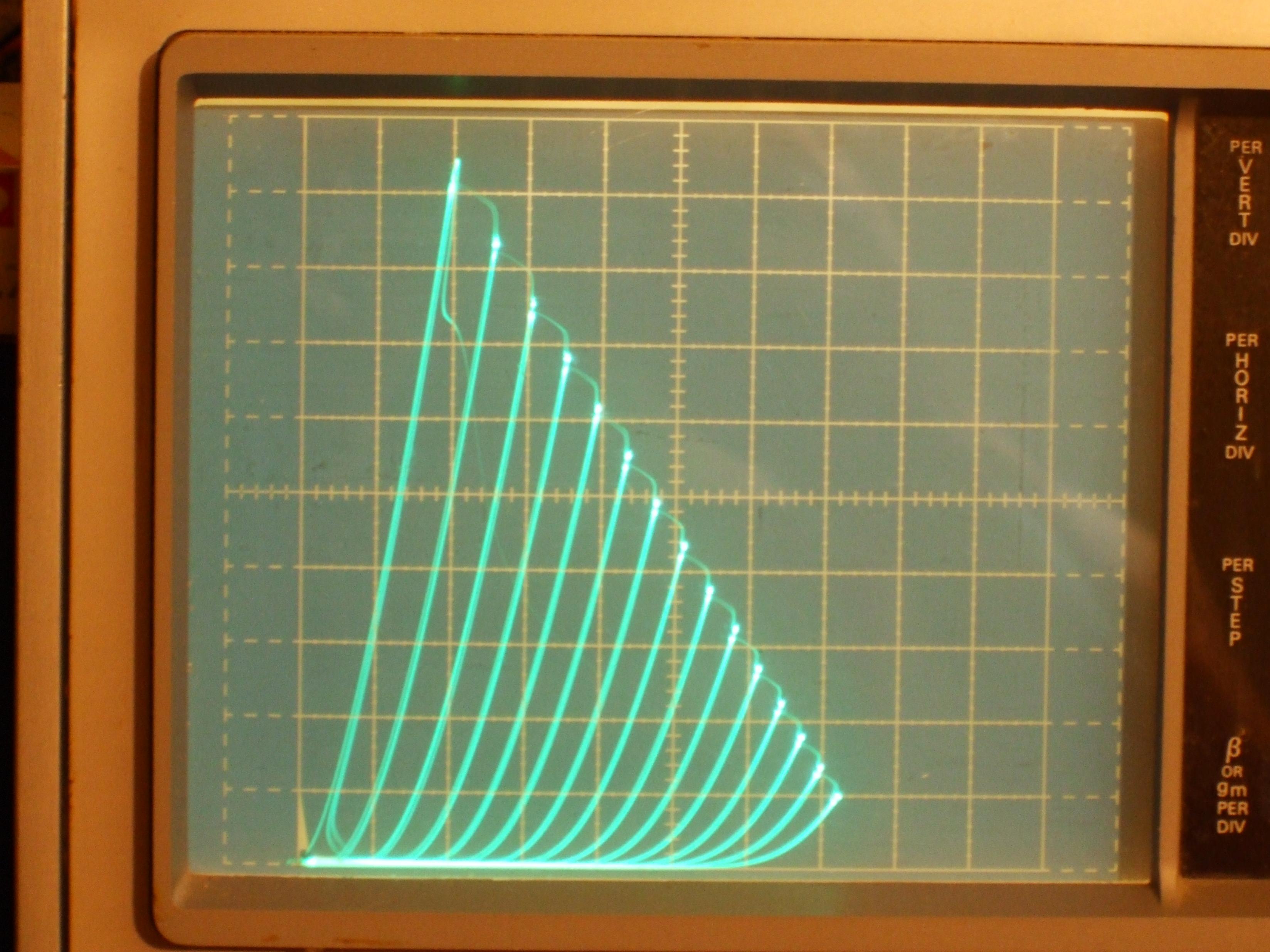

And finally 6HJ5 in standard triode mode (can see almost same as 21LG6A in triode).
Looking at that 6HJ5 in series Schade (21LG6A a very similar tube) I'm seeing a 211 that can do Amperes at reasonable B+ and OT Zpri.
50V/div Horiz., 50mA/div Vert.
a) GE 21LG6A in triode mode -8V steps
b) Syl 21LG6A in triode mode -8V steps
c) 6HJ5 in "new" series Schade (UnSET, CED)
d) 21HB5A in "new" series Schade (UnSET, CED)
e) 21HB5A in standard triode mode
f) 6HJ5 in standard triode mode

After seeing the spectacular results of "new" series Schade (UnSET, CED) I consider all of those to be obsolete now. (pic below)
