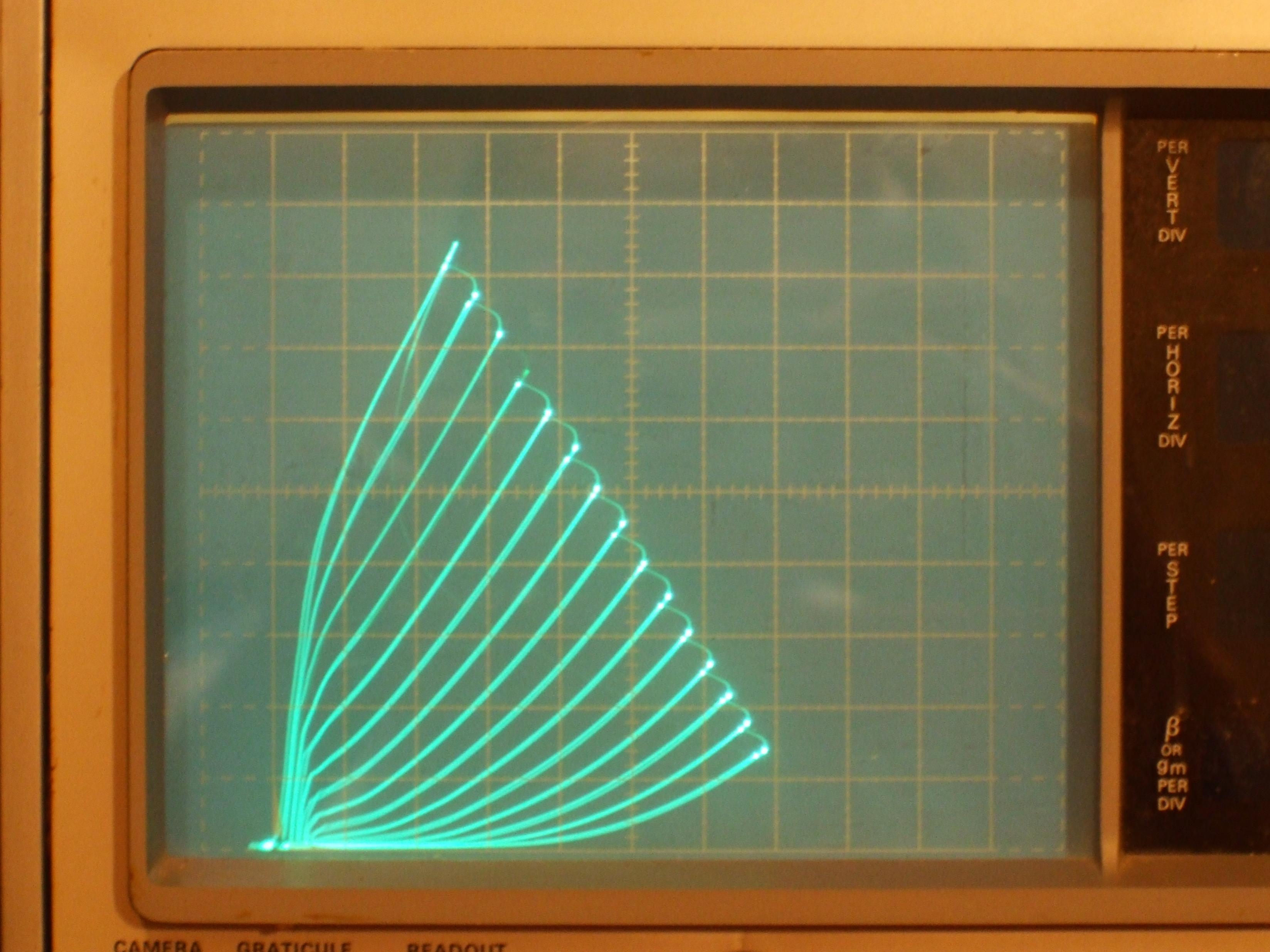

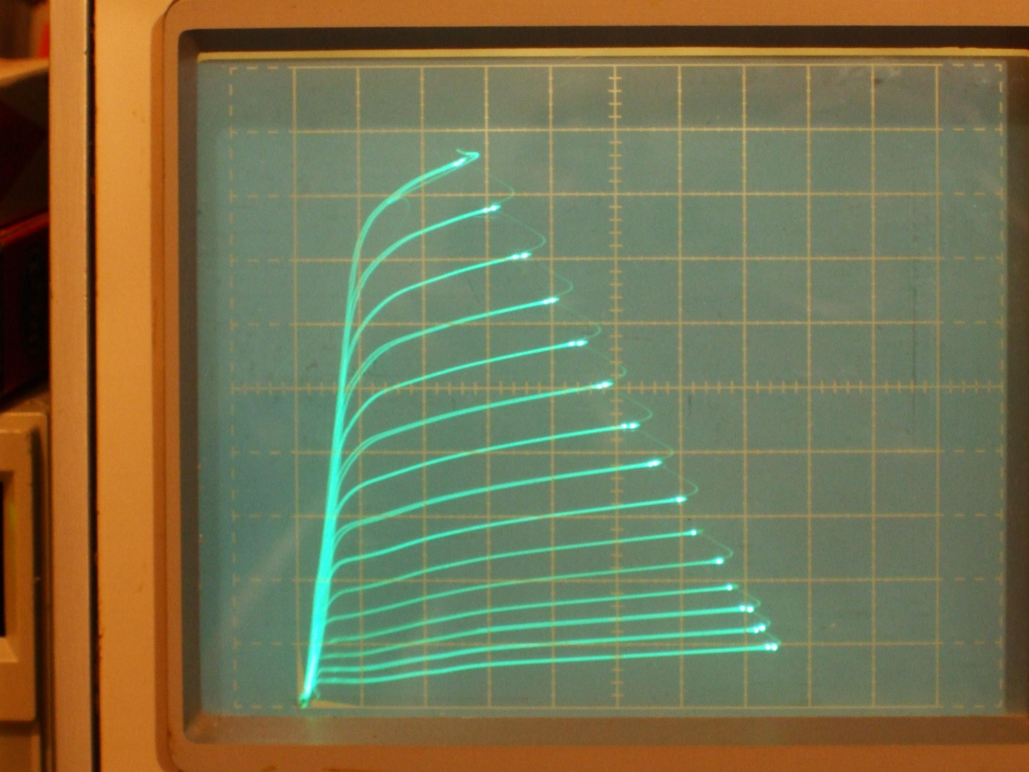

Getting back to Davorin's 6P41S tubes.
Here is the #67 6P41S tube in Crazy Drive with 0 to +170V drive, and then #67 in standard pentode mode with +170V on grid 2 and -2V steps on grid 1.
This was interesting, since the Ri are clearly different here. Other tubes have seemed more equal with the standard pentode Ri.
I'm also not seeing much boost (max current) with the Crazy drive here. Usually I see like 25% or so for the same max Vg2 due to +grid 1 assist.
I'll do the odd 6DQ5A soon, (essentially a 6JE6C I think) and see if this Ri difference holds up. Haven't traced Crazy drive in a while, but I think I set it up right. Would be interesting if I just found some new low output Ri variant, but probably not.
Both traces 50mA/div Vert. and 50V/div Horiz.
a) Crazy drive Rg2g1 19.6K Ohm, Rg1K 971 Ohm , +170/14 = +12.14V steps on g2
b) standard Pentode -2V steps on grid 1, +170V on grid 2

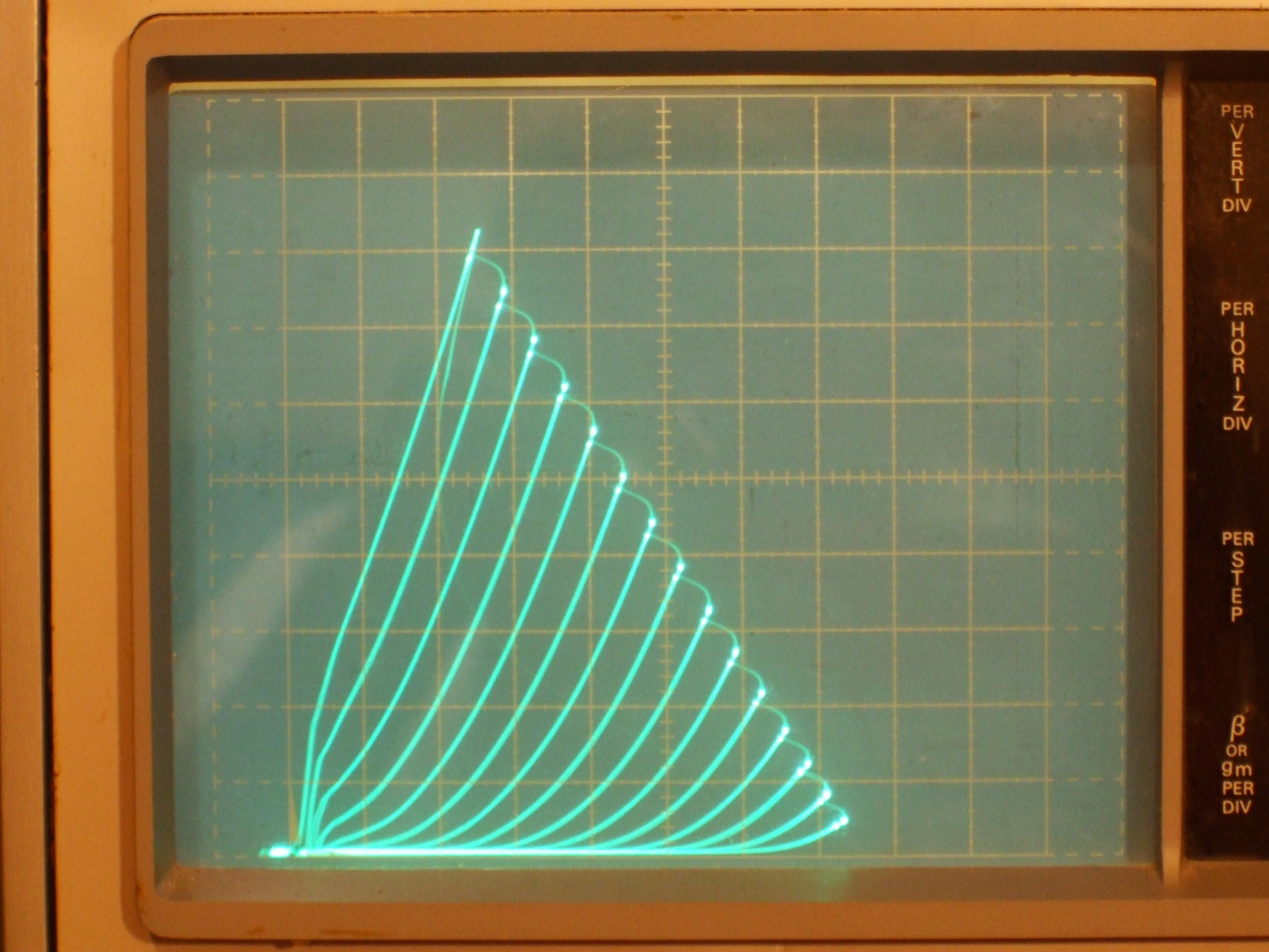

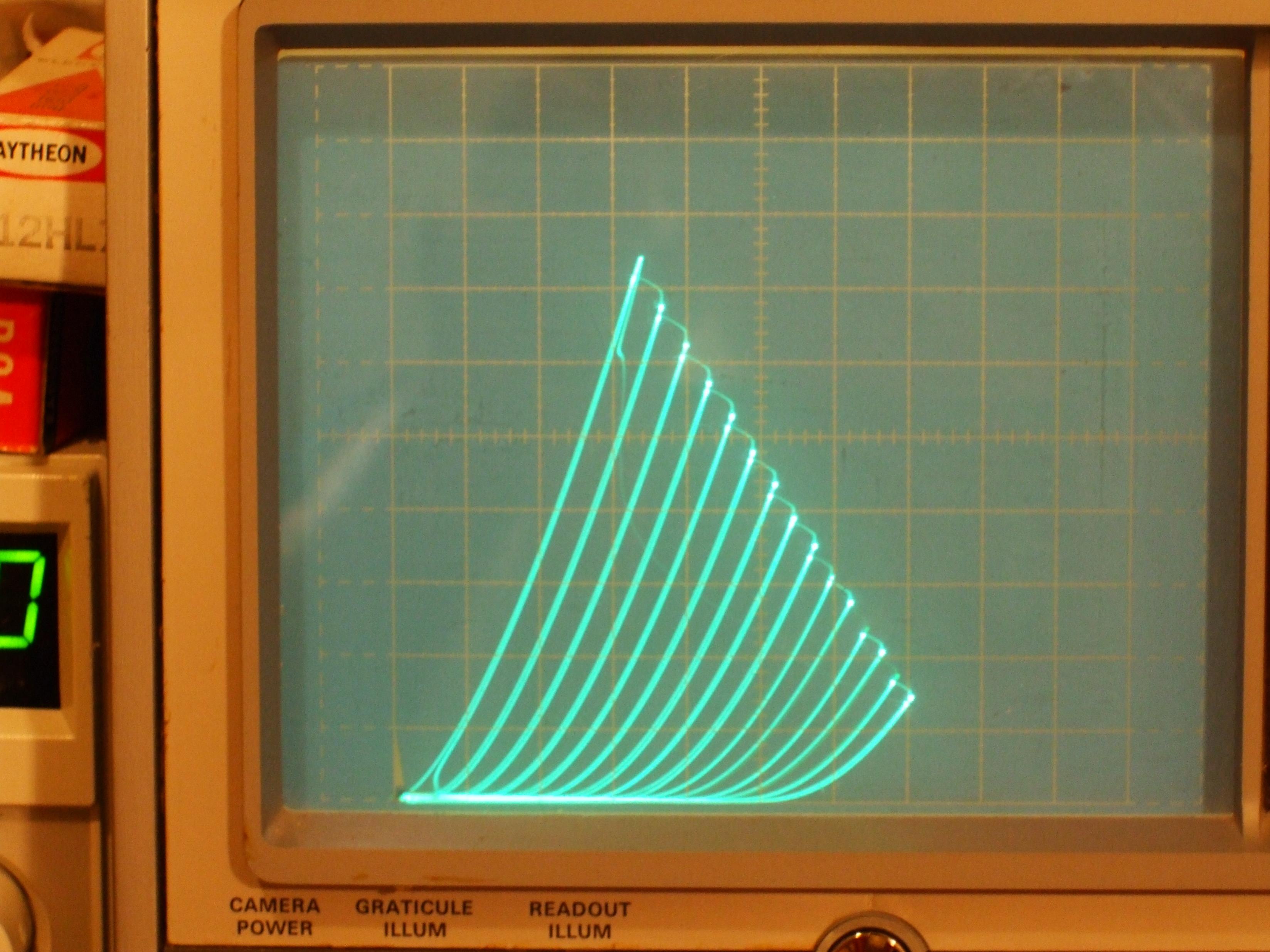

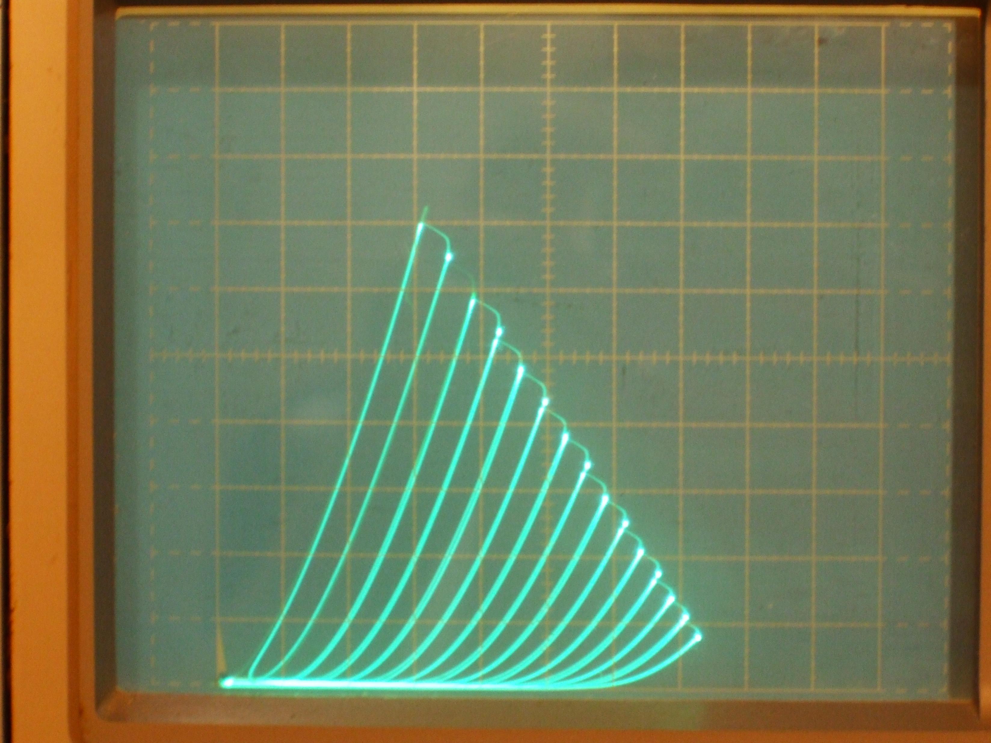

I did already. Here they are, 6P41S in triode:
50mA/div Vert., 50V/div Horiz.
a) tube #66 triode -5V steps
b) tube #67 triode -5V steps
c) a tube I had here earlier, triode -4V steps

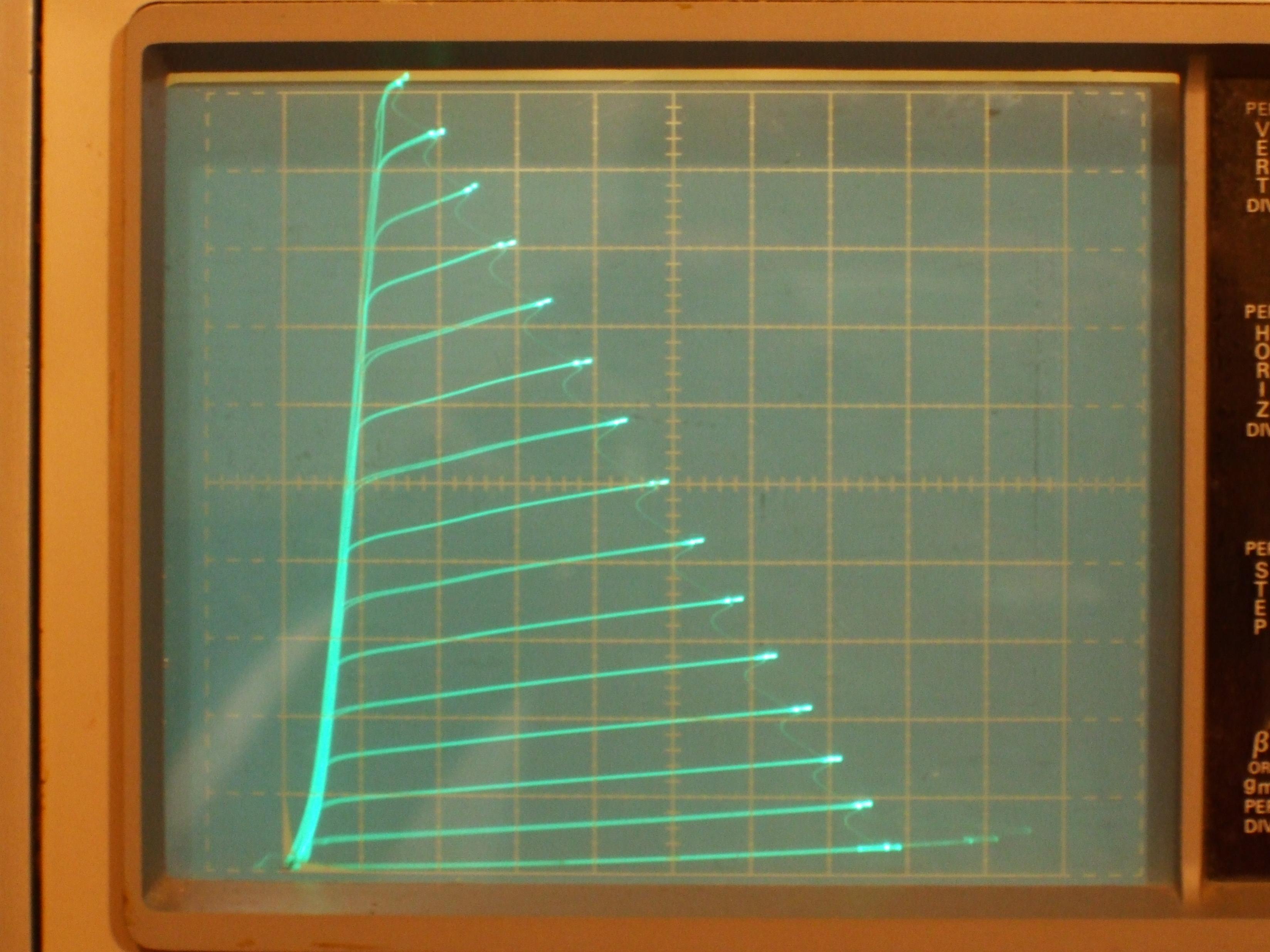

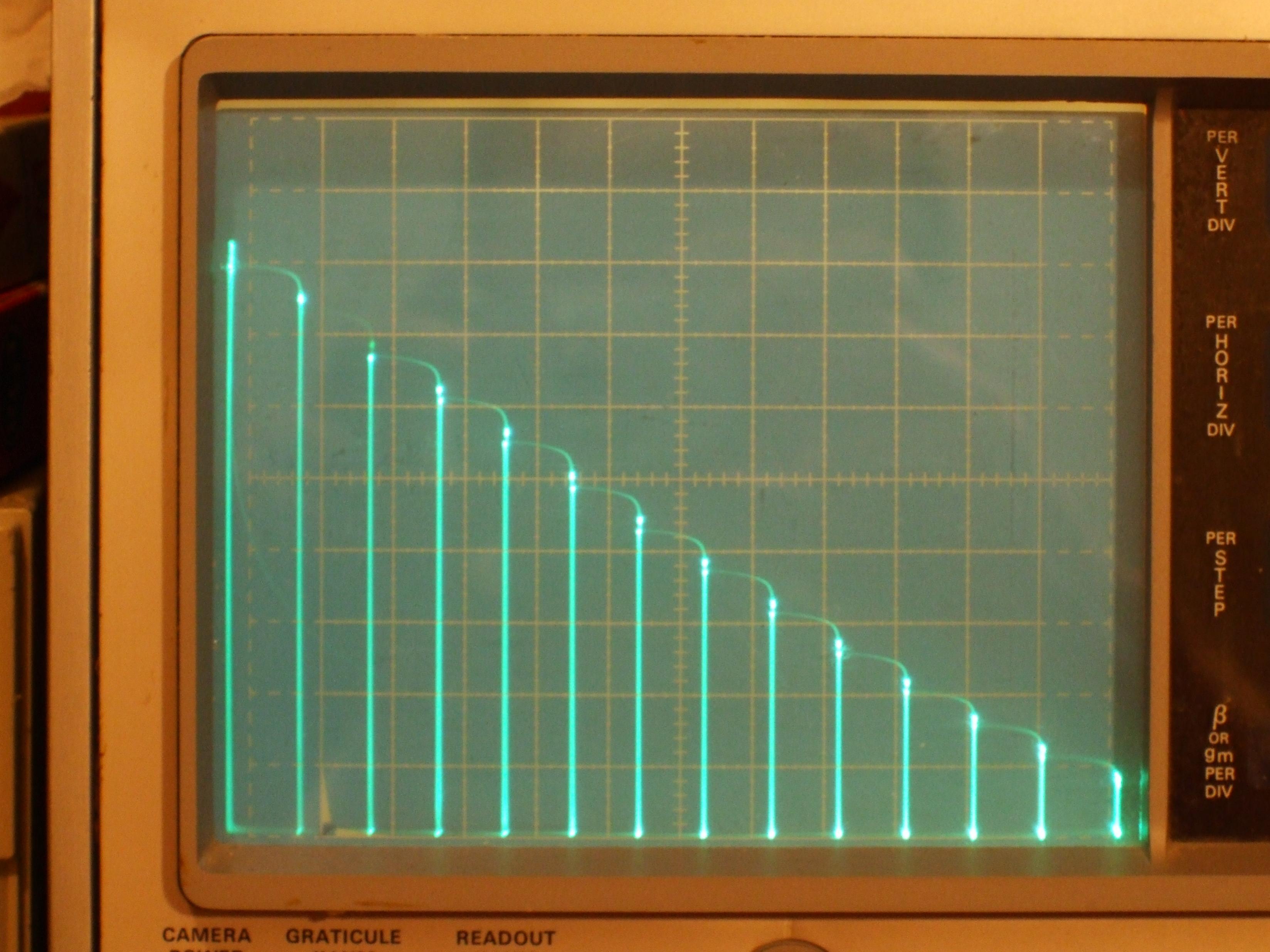

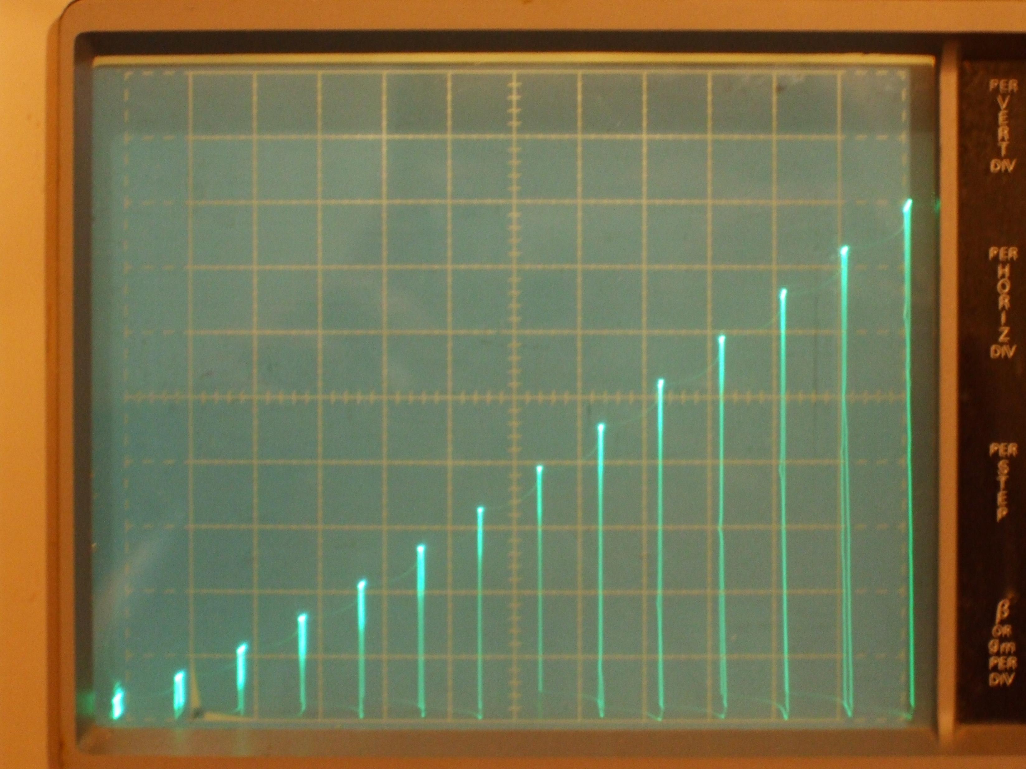

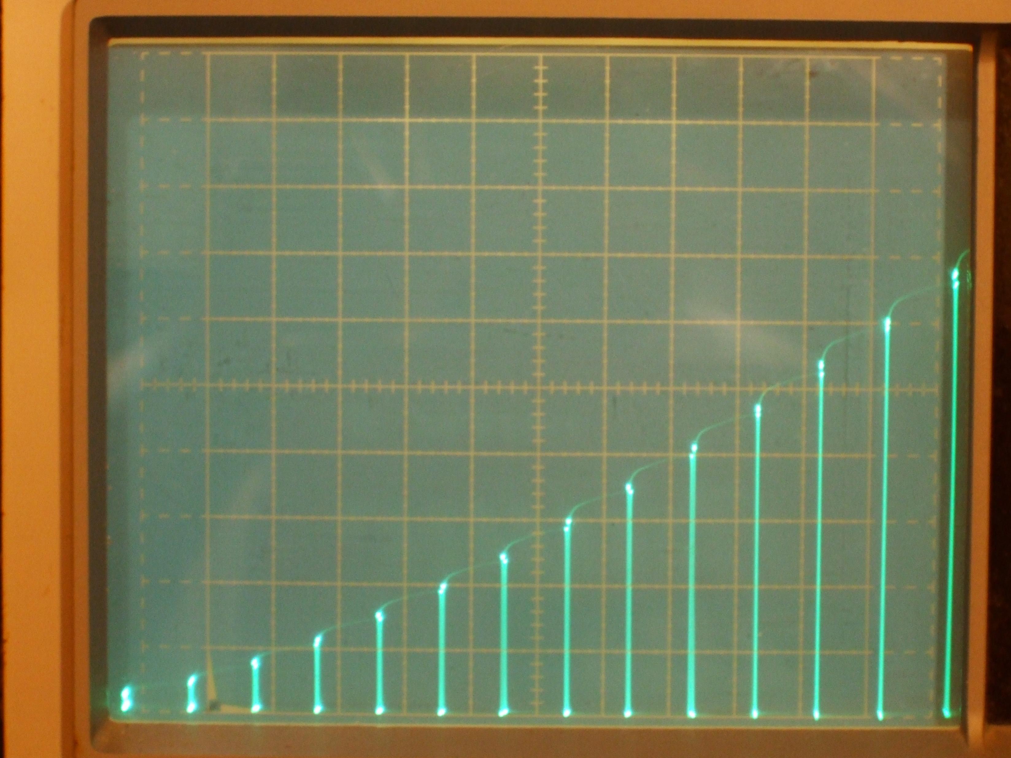

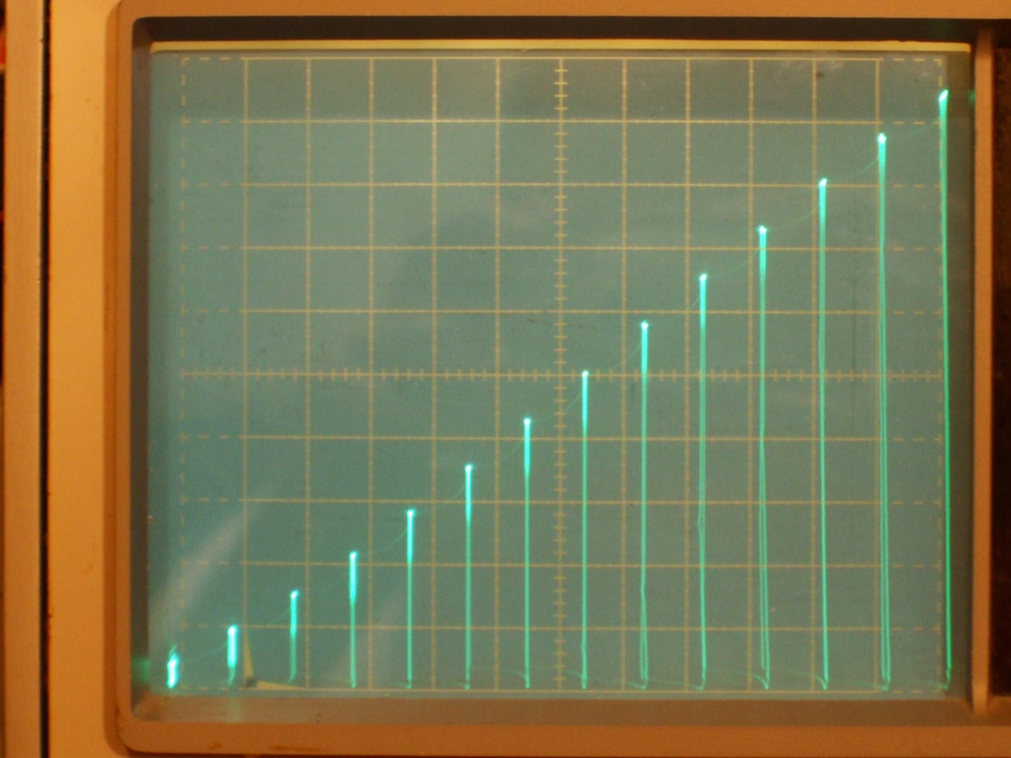

I went and re-checked the Crazy Drive setup and found that the 6P41S works best without Rg1k (or at least a high value like 25K). Rg2g1 was working well in the 7K to 10K Ohm range this way. The max current output was off the screen for 170V max drive, so I dropped that to 154V max drive for full screen seen below.
I did some linearity plots for Crazy Drive and also for g2 drive. Some improvement in linearity of Crazy versus g2 drive, but I couldn't get a straight ramping line using the usual 650 Ohm load in the tracer. I was able to get a straight line ramp with a higher load R, so 650 Ohm load is maybe too low for this tube.
Crazy drive is only needing 78% of the Vg2 drive to match the g2 only drive for max plate current. Safer for the grid 2 at least.
a) New Crazy Drive for 6P41S 50mA/div Vert, 50V/div Horiz. +11 V steps up to +154V
b) Linearity plot for Crazy Drive Ip versus Vg2 50mA/div Vert
c) Linearity plot for g2 drive Ip versus Vg2 50mA/div Vert.
d) regular grid 1 pentode curves, 50ma/div Vert., 50V/div Horiz., -2V grid 1 steps, +170V on grid 2
The plate curves Ri is looking more comparable between Crazy Drive and regular pentode now.
It is interesting that I can get lower Ri with the previous Crazy Drive R setup (using higher Rg2g1), but the drive sensitivity was about the same as just g2 drive that way.

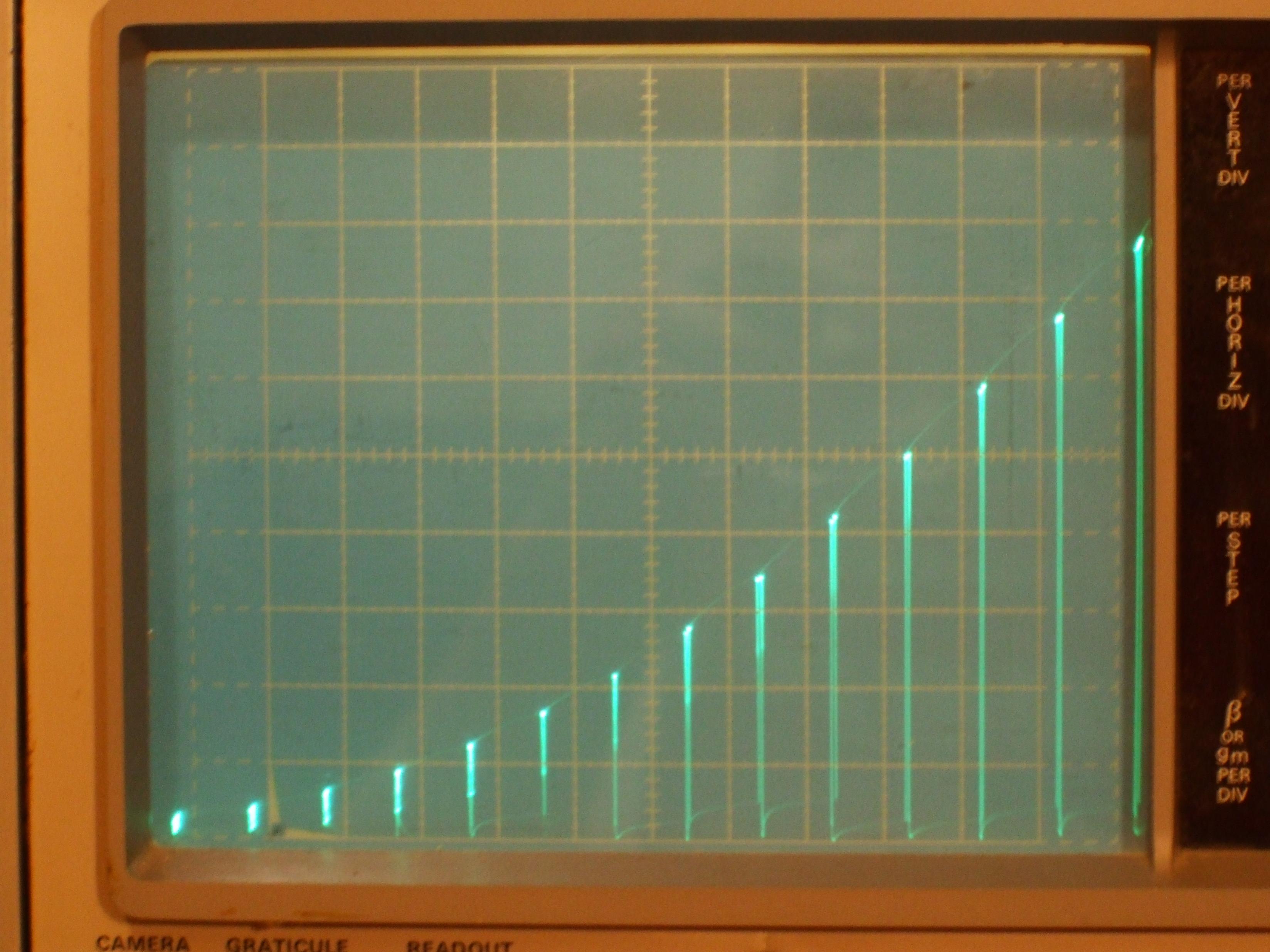

Here is a comparable linearity plot for the 6P41S in standard pentode, g1 drive, -2.7V steps, 170V on grid2
50 mA/div Vert.
( A Note on the previous Crazy drive curves above. To get the same max current as the conventional grid 1 drive with 170V on grid 2 (instead of full screen as plotted) only requires 133V max drive for grid 2 using Crazy Dive. So one can see the assist from +grid 1 in Crazy Drive lowers the max grid 2 V needed.)
50 mA/div Vert.

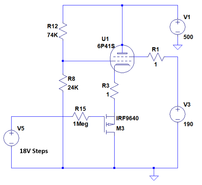

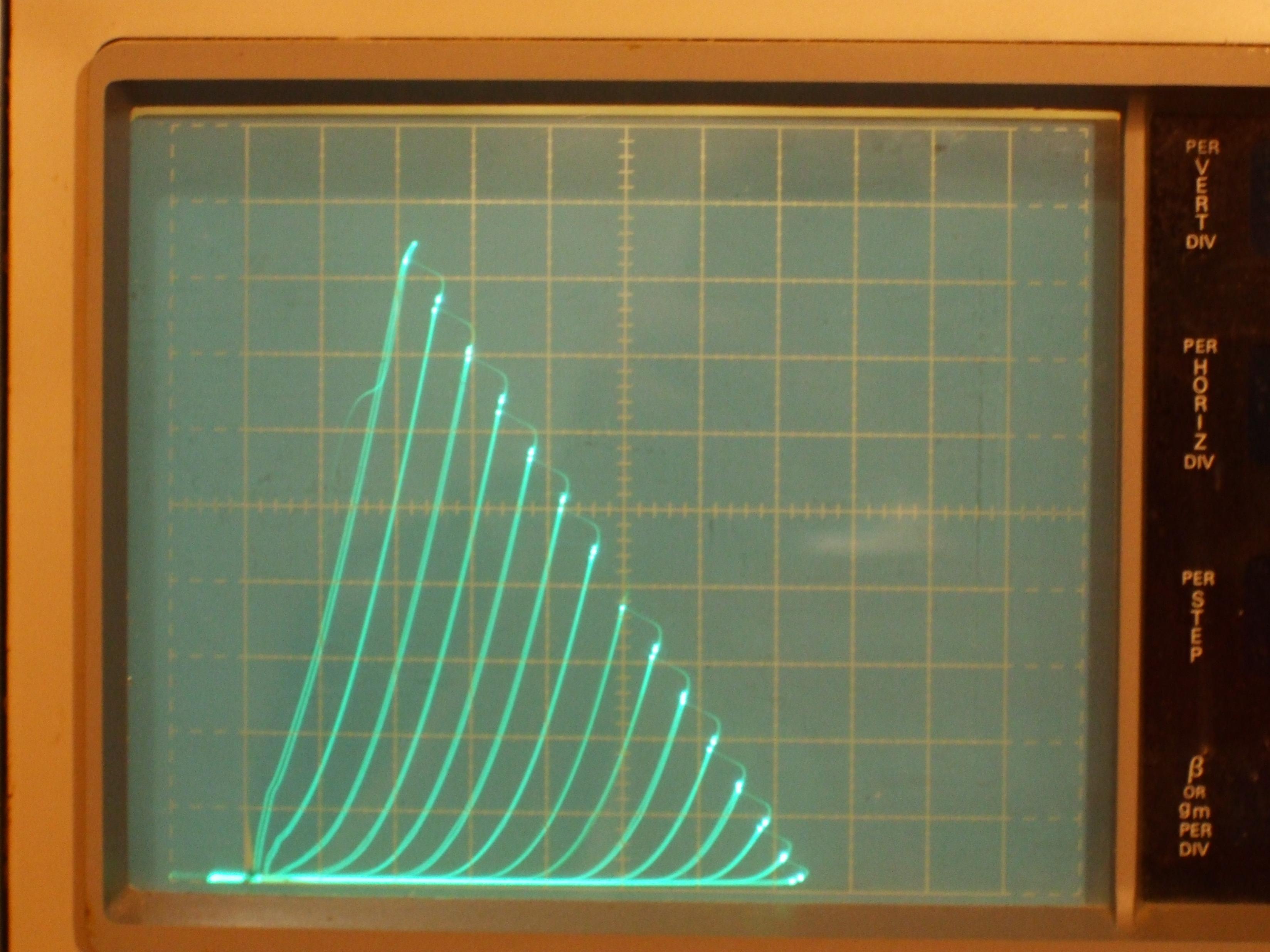

Now for some UnSET/CED triode mode on the 6P41S.
This was using 190V on grid 2, 18V steps on the cathode (input), 74K Ohm top R divider to grid 1, 24K Ohm bottom R divider to GND. (these R values are likely on the low side for practical use, but the ratio is what is important for setting the Mu.
50 mA/div Vert. 50V/div Horiz.
a) UnSet triode Curves, 18V steps

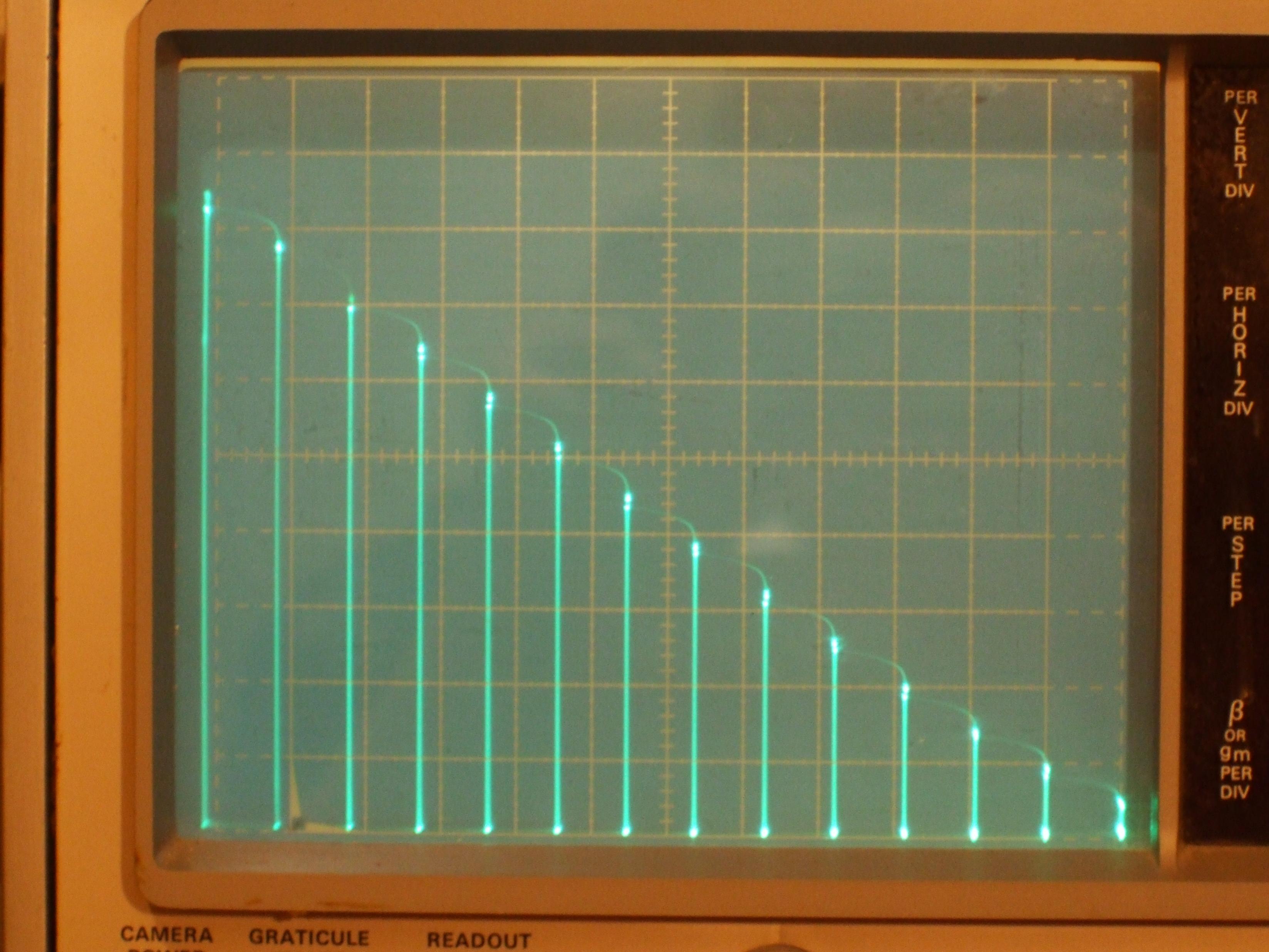

b) UnSET Linearity plot (Ip versus input V) 50 mA/div Vert., 18V steps (plot is flipped around from usual due to the NON inverting UnSET stage) 650 Ohm load line

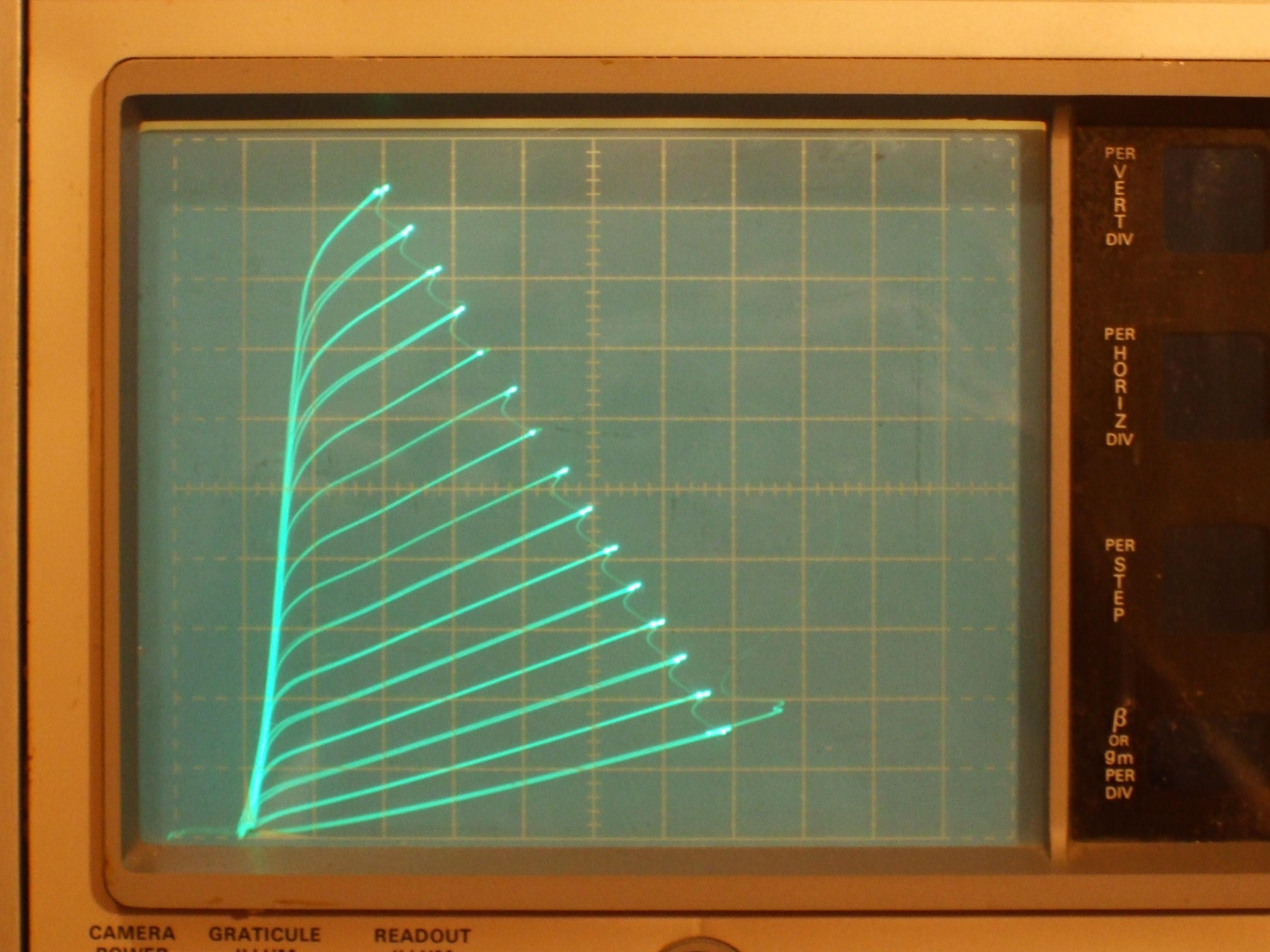

c) Native triode Linearity plot (Ip versus input V) for internal triode, 650 Ohm load line -5V steps
d) Native triode curves -5V steps
You can see the better linearity of the UnSET versus the Native triode. (at 650 Ohm loadline on each) The residual distortion in the UnSET case is due to the actual curves being non straight diode lines, while the Native case is that plus the curve roll-over dist.
A higher Z load line will of course lower the distortion for either version. 650 Ohm loading makes the distortion comparison more obvious.

So the test set-up you're using is like this?
Yes, essentially.

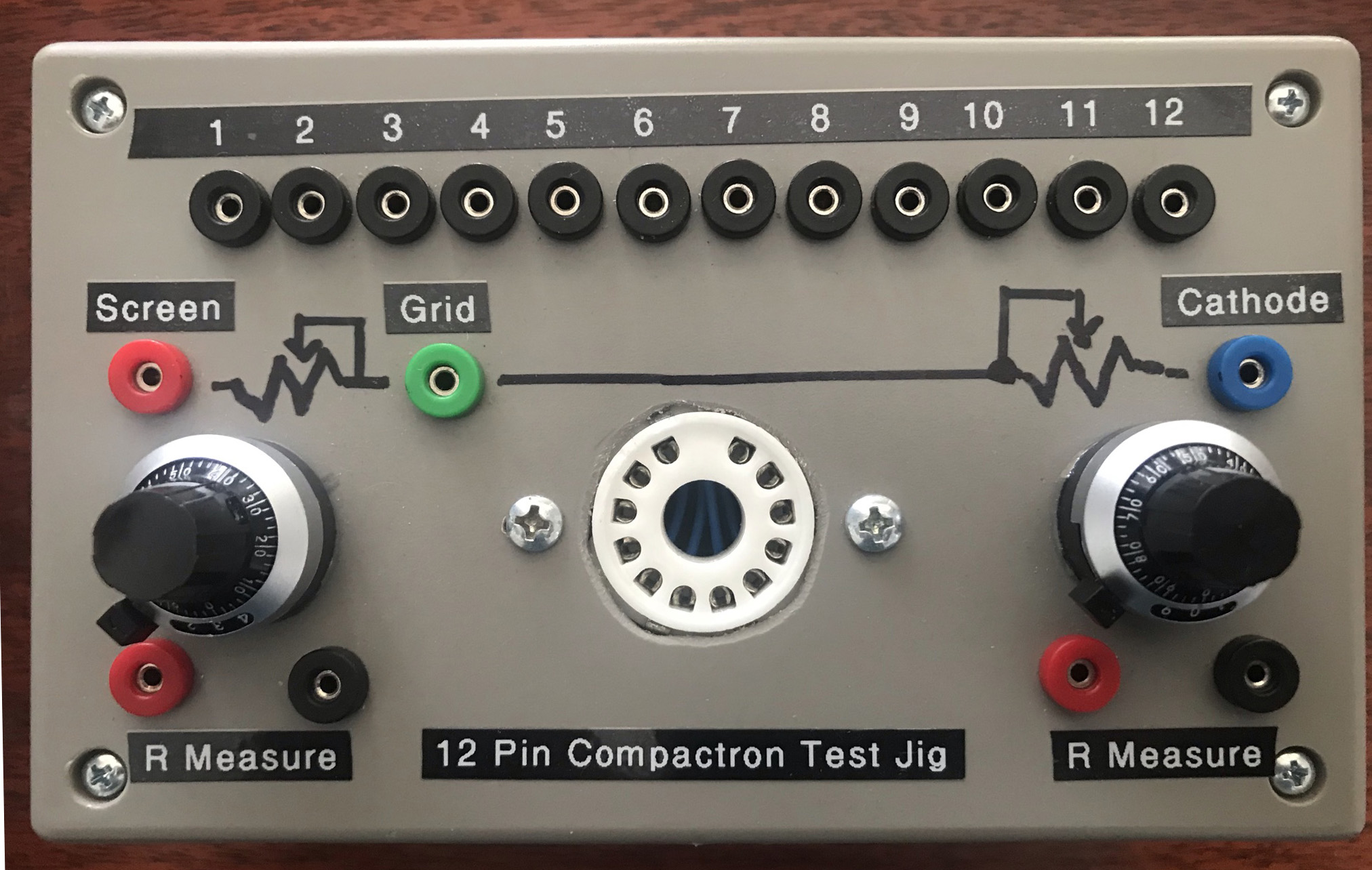

I built a set-up to do crazy-drive curve tracing. I could build another to do UNSET curve tracing. I'll add it to my project list.

OOPs, correction to the step V for the UnSET case in post 1491.
should be 9V steps for those
14 steps of 18V would be beyond the max 170V the step supply can do!
I left out a factor of 2 in scaling when I calc'd that earlier. That now fits with the UnSET tube Mu being approx. 3 then, fitting the Fdbk resistors ratio (74K/24K).

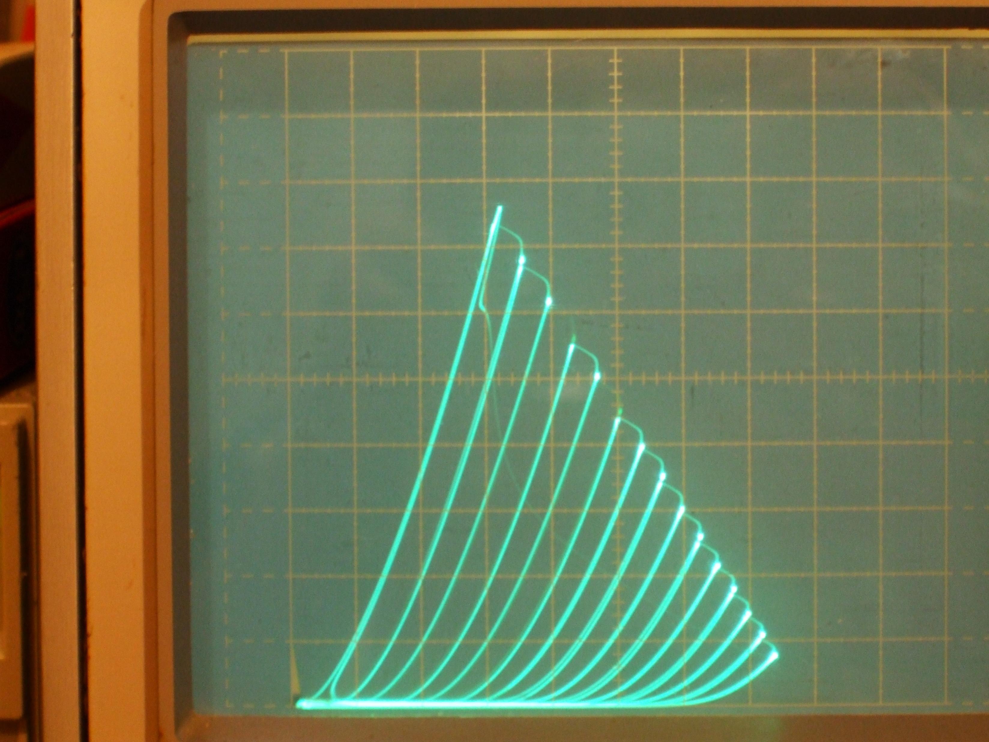

Some more 6P41S in UnSET mode at higher Mu programming.
1st set with 180K and 30K resistors, 4V steps, 190V on grid 2
approx. Mu 6 expected, looks like I got Mu 8.7
2nd set with 180K and 15K resistors, 2.5V steps, 190V on grid 2
approx. Mu 12 expected, looks like I got Mu 17.5
All 50 mA/div Vert., 50V/div Horiz. (for plate curves)
a) UnSET 6P41S Curves 180K, 30K, 4V steps, 190V grid 2
b) UnSet 6P41S Linearity 180K, 30K, 4V steps, 190V grid 2
c) UnSET 6P41S Curves 180K, 15K, 2.5V steps, 190V grid 2
d) UnSET 6P41S Linearity 180K, 15K, 2.5V steps, 190V grid 2
Looks like one can reduce grid 2 V at higher Mu factors. 170V works OK for the last set here.
The earlier Mu 3 UnSET curves, above, needed 190V on grid 2, or else it started to flat top.
Going above 200K for the plate to grid 1 resistor produced some instability of strange sort, was getting twinned up curve spacings vertically. No doubt related to sweeping the plate V in a different direction for every other curve. (0 to 350V versus 350V to 0 etc)
Hmm, the last set of curves here I should have adjusted the offset (bias) to lower the current more. The curves get a bit more closer together at the lower currents than the 1st case here. As one would expect, setting up for a higher Mu factor puts less N Fdbk into the triode operation, so linearity will get worse.
