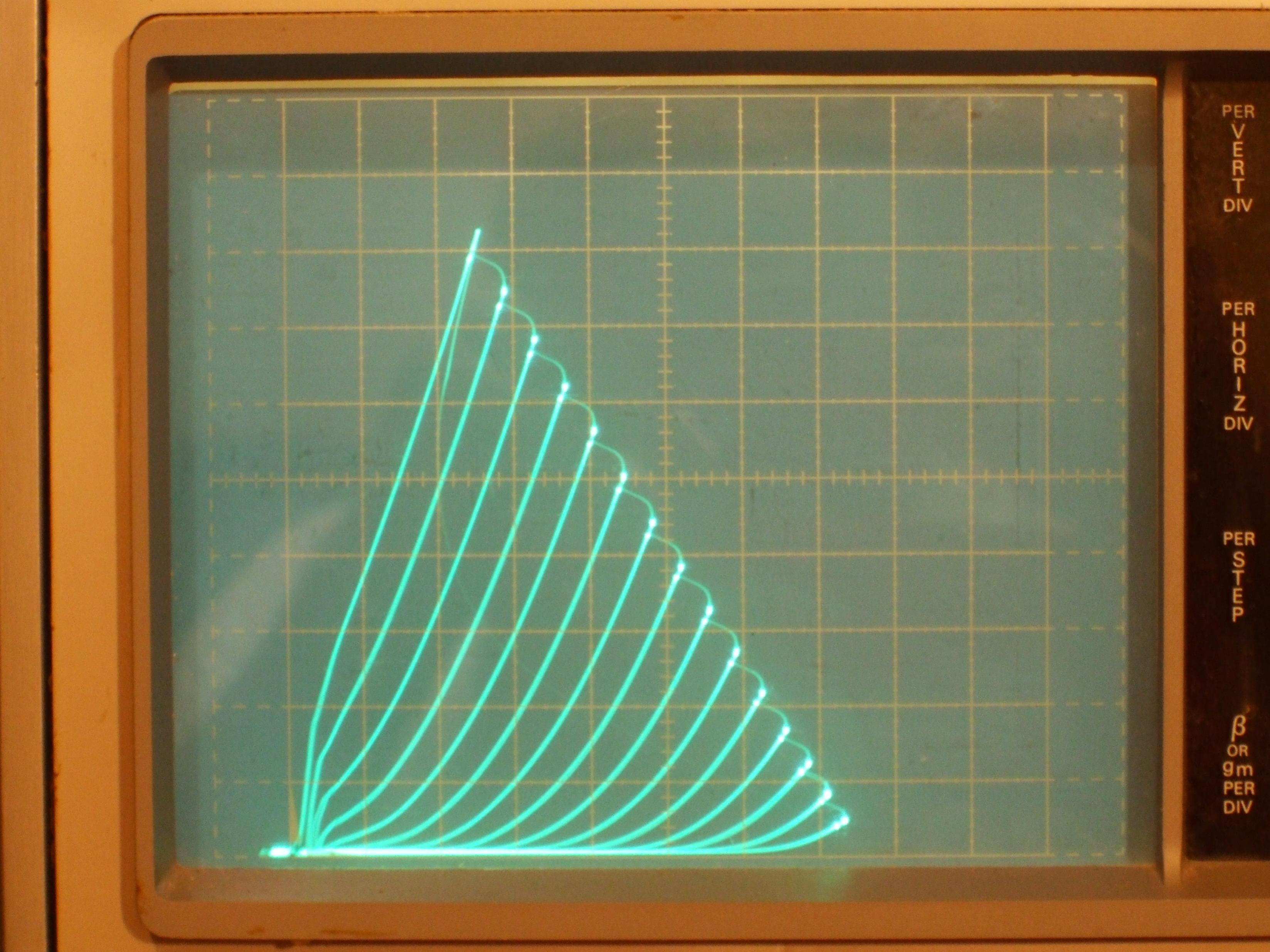

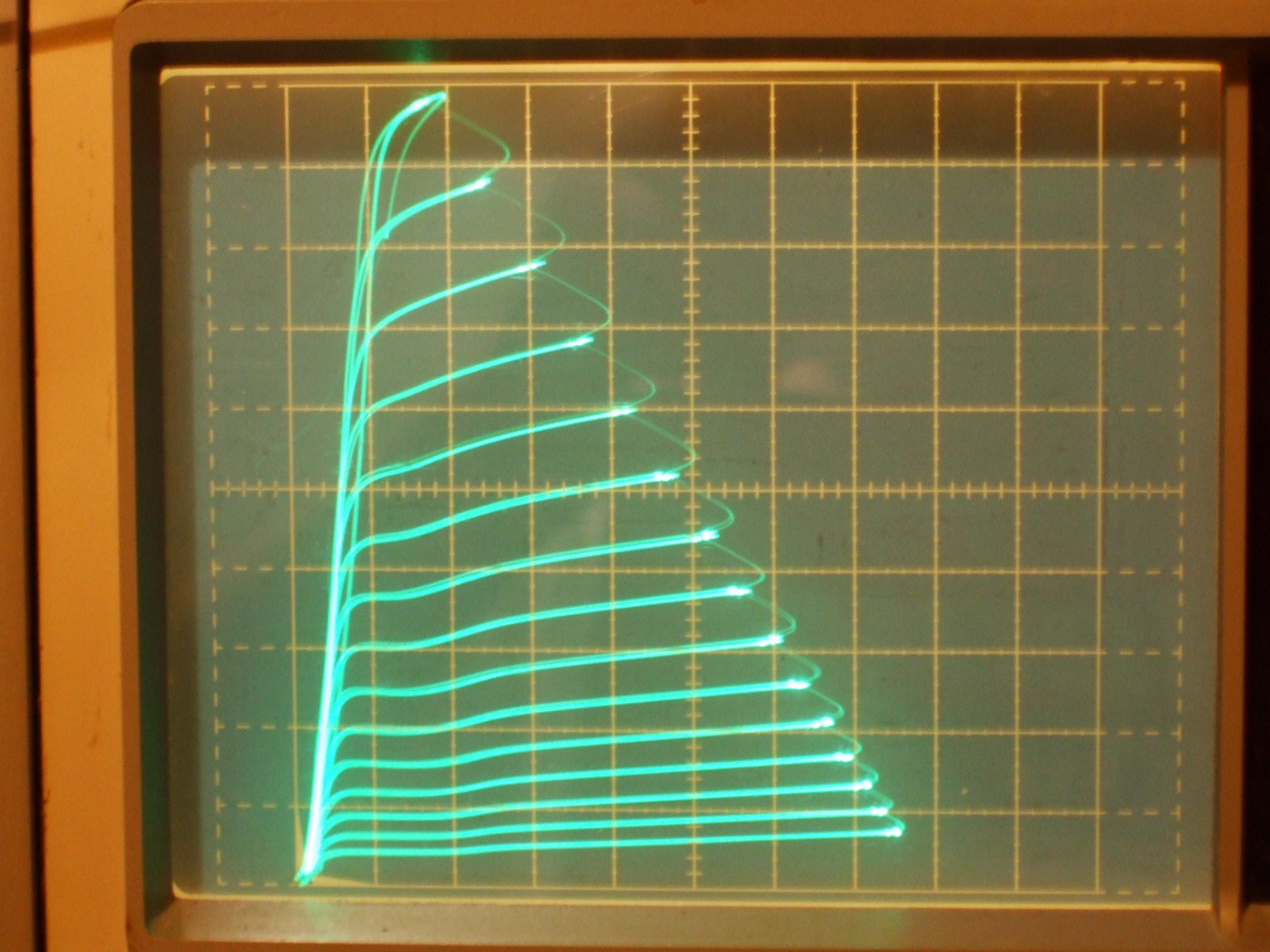

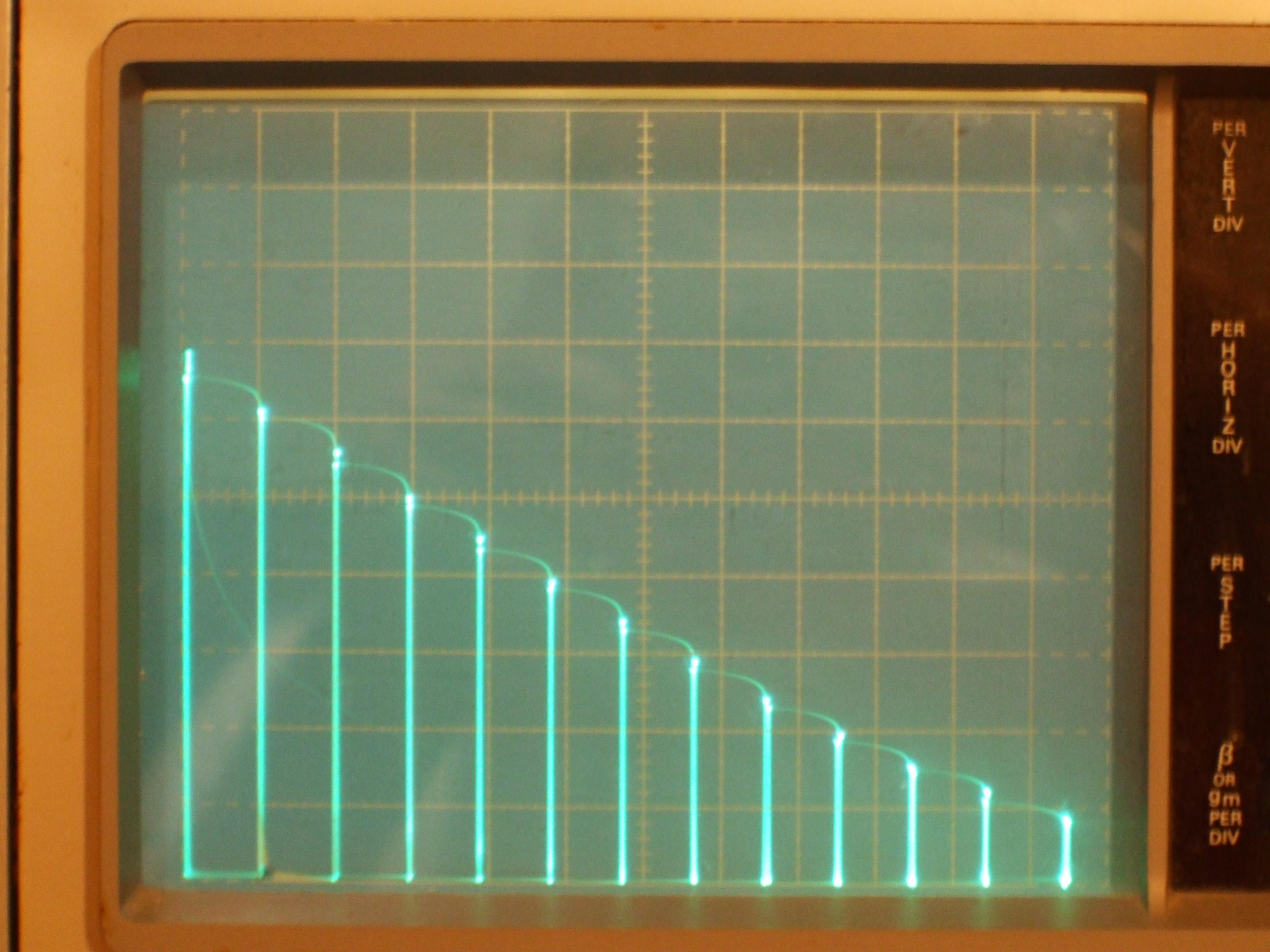

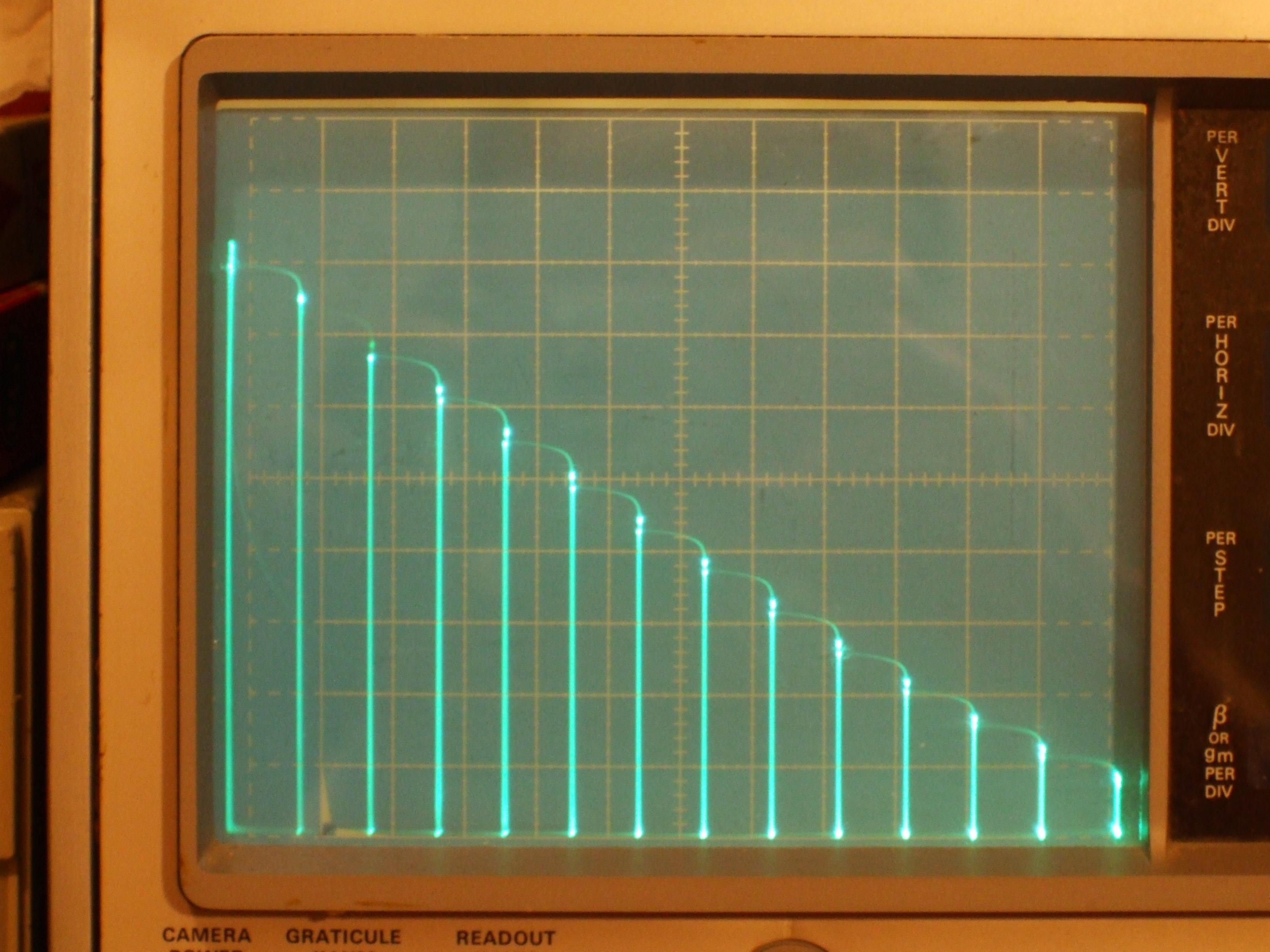

I fixed the offset on the last set of 6P41S curves above (180K, 15K, 2.5V steps) to give a better view of linearity change (less) with higher Mu.
a) UnSET 6P41S Curves 180K, 30K, 4V steps, 190V grid 2
b) UnSet 6P41S Linearity 180K, 30K, 4V steps, 190V grid 2
c) UnSET 6P41S Curves 180K, 15K, 2.5V steps, 190V grid 2
d) UnSET 6P41S Linearity 180K, 15K, 2.5V steps, 190V grid 2

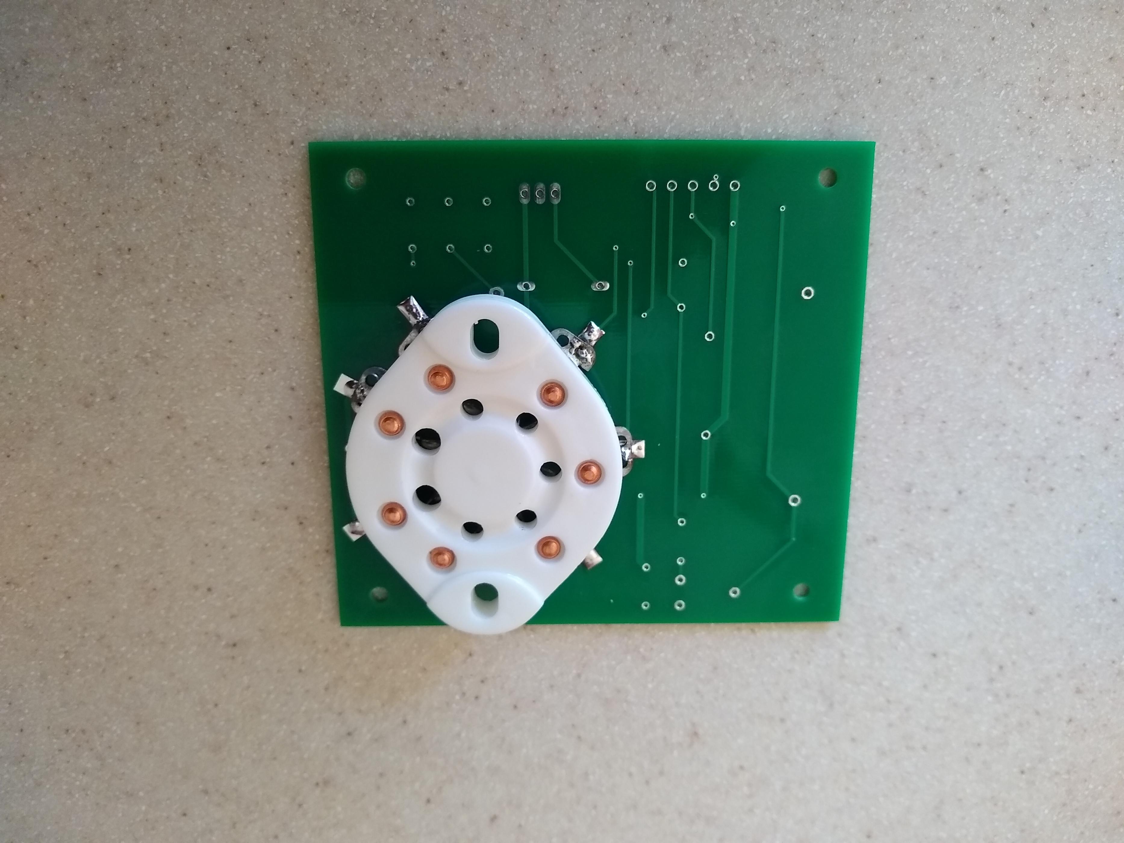

Here is my SED-Unset output test board inspired by you and George. This one is socketed for an 1625 tube, may not be the best application for Unset but I am currently fond of that tube.
I may be coming back to ask for R1 and R2 suggestions.

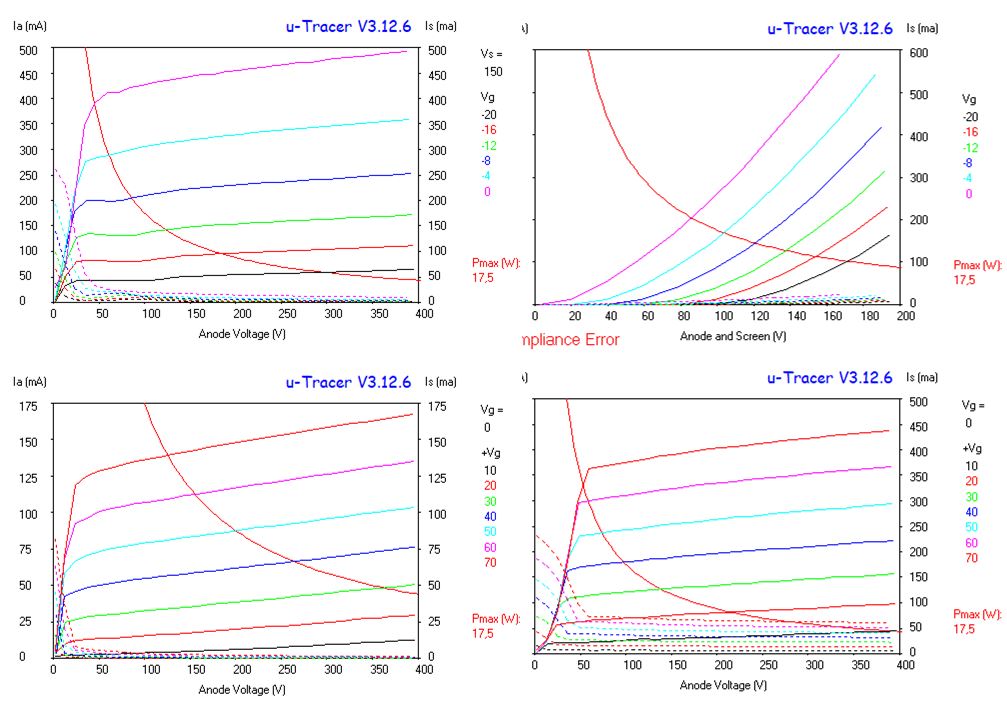

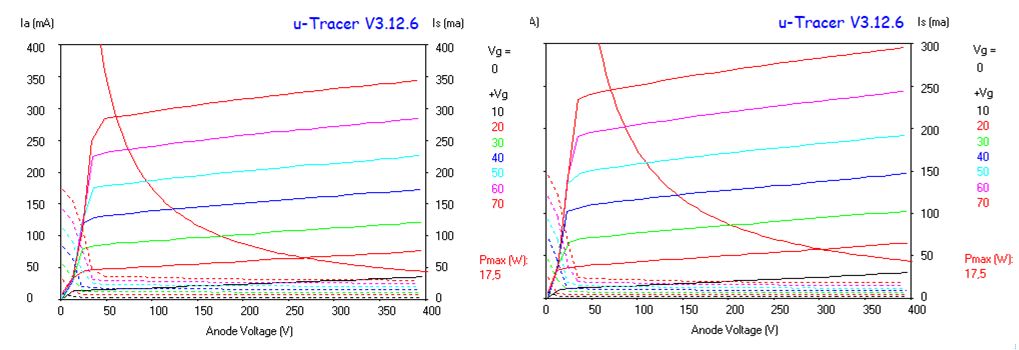

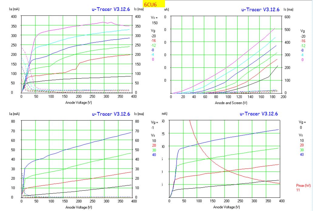

Dug up some sweep tubes this weekend and got busy with the uTracer.
I made traces with g2 fixed 150V, triode mode, g2 drive and 'crazy drive' (g1 tied with 1k to cathode and 2k2 to g2).
First is a 6CU6/6BQ6GTB, then an EL36. Both share the same pinout, dissipation rating and heater current. Even so the 6CU6 is physically quite bigger.
Another similarity are some funky curves at higher voltages and current. Must be oscillations. In g2 and crazy drive it's all stable.

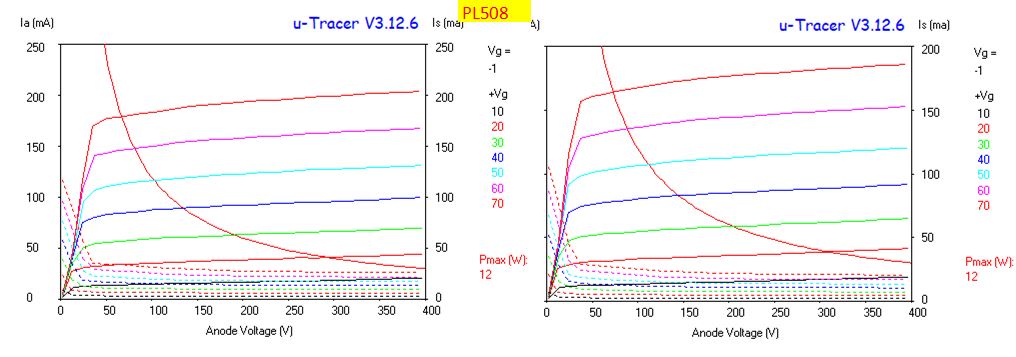

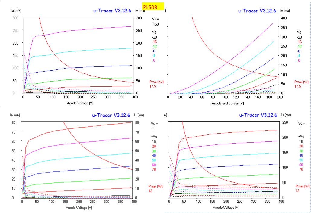

Next a PL508, a 12W vertical sweep and a bigger, unmarked tube. Both stable in g1 drive.

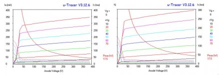

With these I also tried 1k and 3k9 between g2 and g1.
I'm trying to figure out how to optimize the crazy resistors.
What to aim for?
Later, I'll take a closer look at the required current for g2 vs crazy drive. The scaling makes a hard to see now, but it looks like even though the required voltage to get to a certain current is lower, the drive current is higher.
What to aim for?
I like the EL 36, they cost next to nothing, they give you 5 watt for 5 euro.
If they eat 20 watt there will be some red glow.
I used them to test OPT for 45 tubes.
Good to have some data on EL36!
E235L is electrically identical and has a much more comprehensive data sheet.
EL36 is actually really nice in triode.

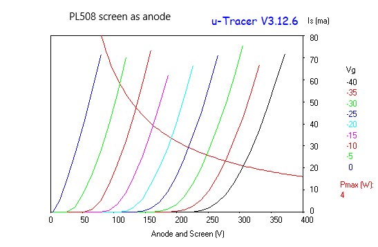

PL508 is interesting, I think you may be able to turn this tube into a triode driver if you use G2 as the anode and leave the anode unconnected.😀
Yes, the PL508 outline, especially the one with the evacuation tip inmidst the pins, somewhat resembles those short, but fat Compactrons 😉.

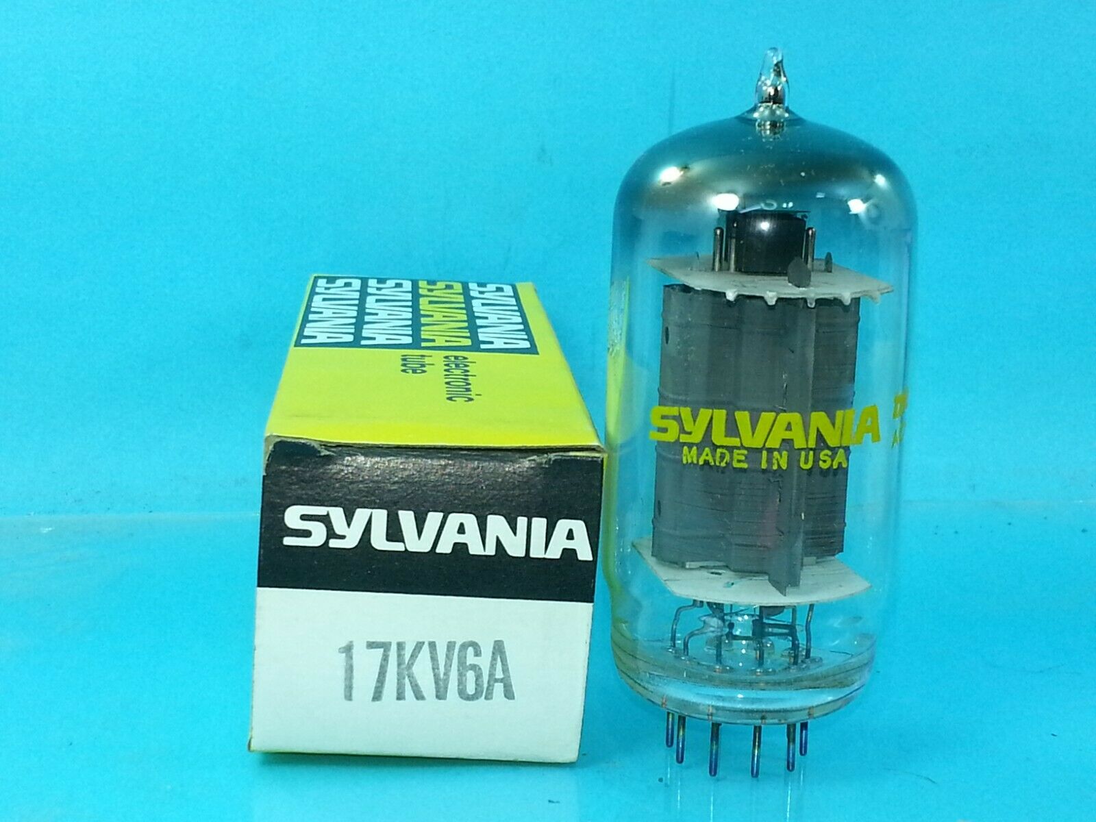

The PL508 is 30 mm diameter. For that fat look, the 17KV6A is 38 mm diameter (1.5 " ). A nice tip on top for that "original Edison" look. Good for a 24 W audio output tube. A Novar base. Very similar curves to 21HB5A.

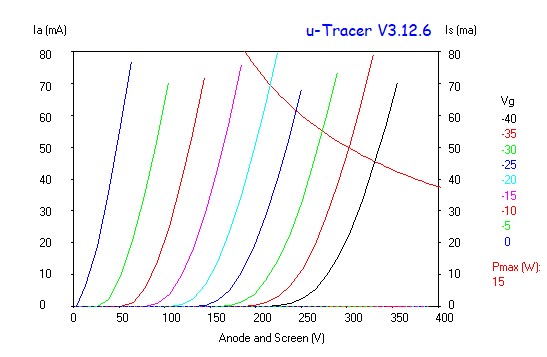

Indeed. See the trace with the anode disconnected.
However, compare it with regular triode on the same scale...

I once built a 4-65 SE amplifier, the plate was grounded . . .
Just for safety's sake, but it would have been extremely low plate current with it and the screen tied together, when there was only about 350V B+, (B+ limited by the power transformer that was re-purposed from a 45 amplifier).
The 4-65 screen is rated at 10 Watts, and so I used the screen as if it was a "plate".
The PL508 screen is only rated for 3 Watts, or 4 Watts absolute maximum.

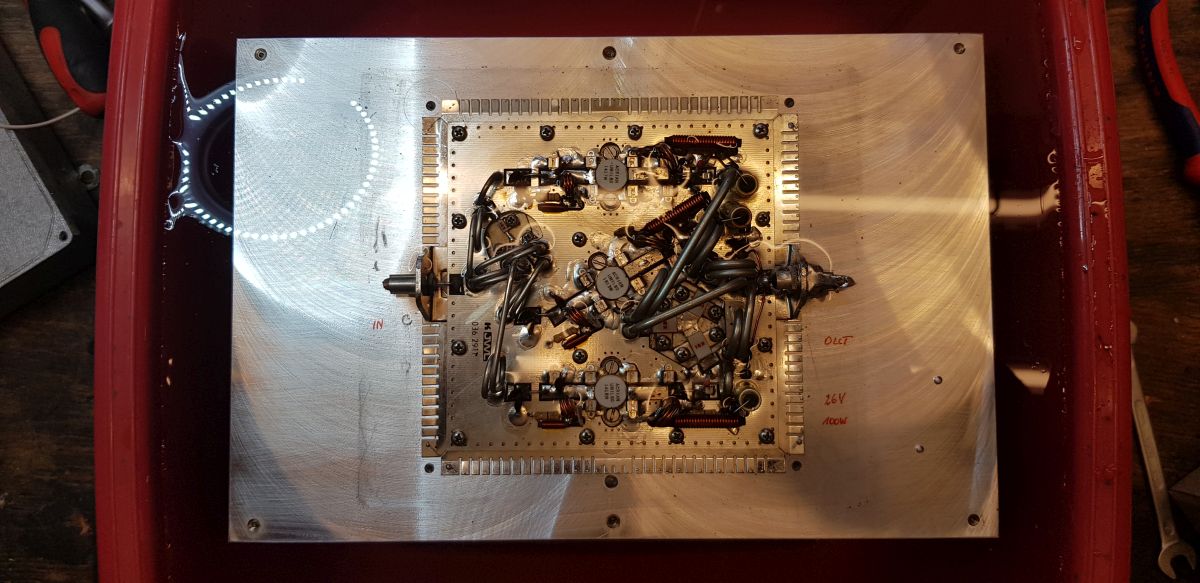

I'd keep away from beryllium oxide as far as possible 😱. It's carcinogenous.
Last year I've disassembled a scrapped RF transmitter (don't know exactly what it was) for it's massive heatsink. All power devices were attached to the sink via BeO insulators, so I submerged the unit under water during the disassembling procedure:
Best regards!
