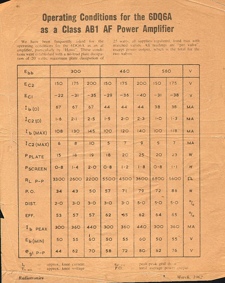

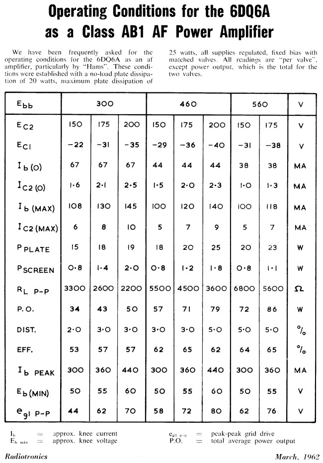

6dq6 AB1

A P-P am will dissipate the least power at idle, and the most power somewhere between 30% to 100% of its rated power output, depending on how it's biased. This is why you are squeezing a 6DQ6 for all it's got to get 10 watts of audio out of it in SE, but they will live long and prosper at 100 watts per pair in P-P when biased close to class B.

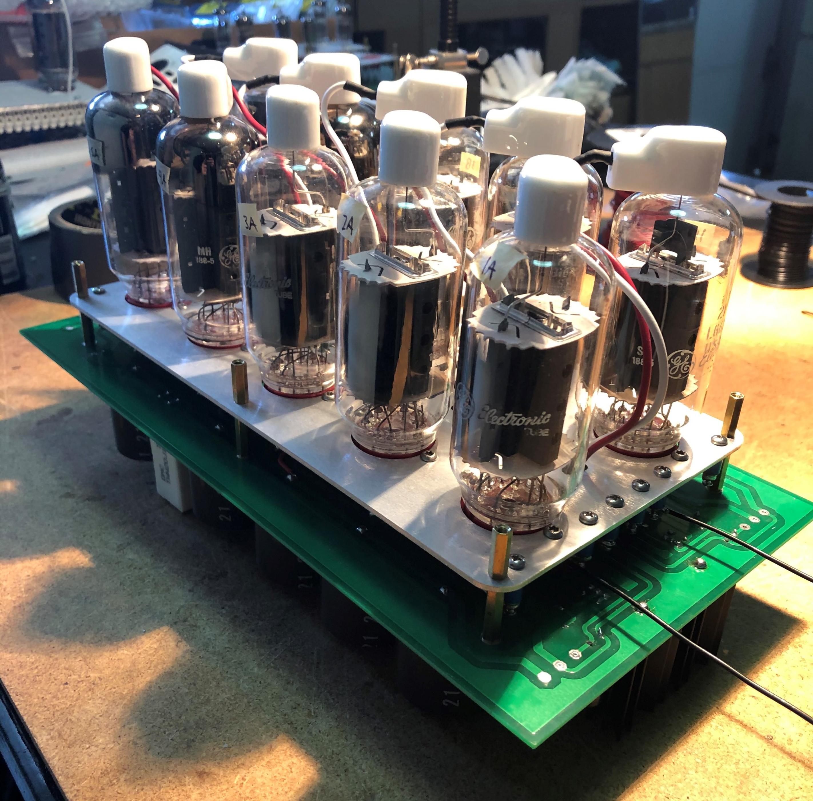

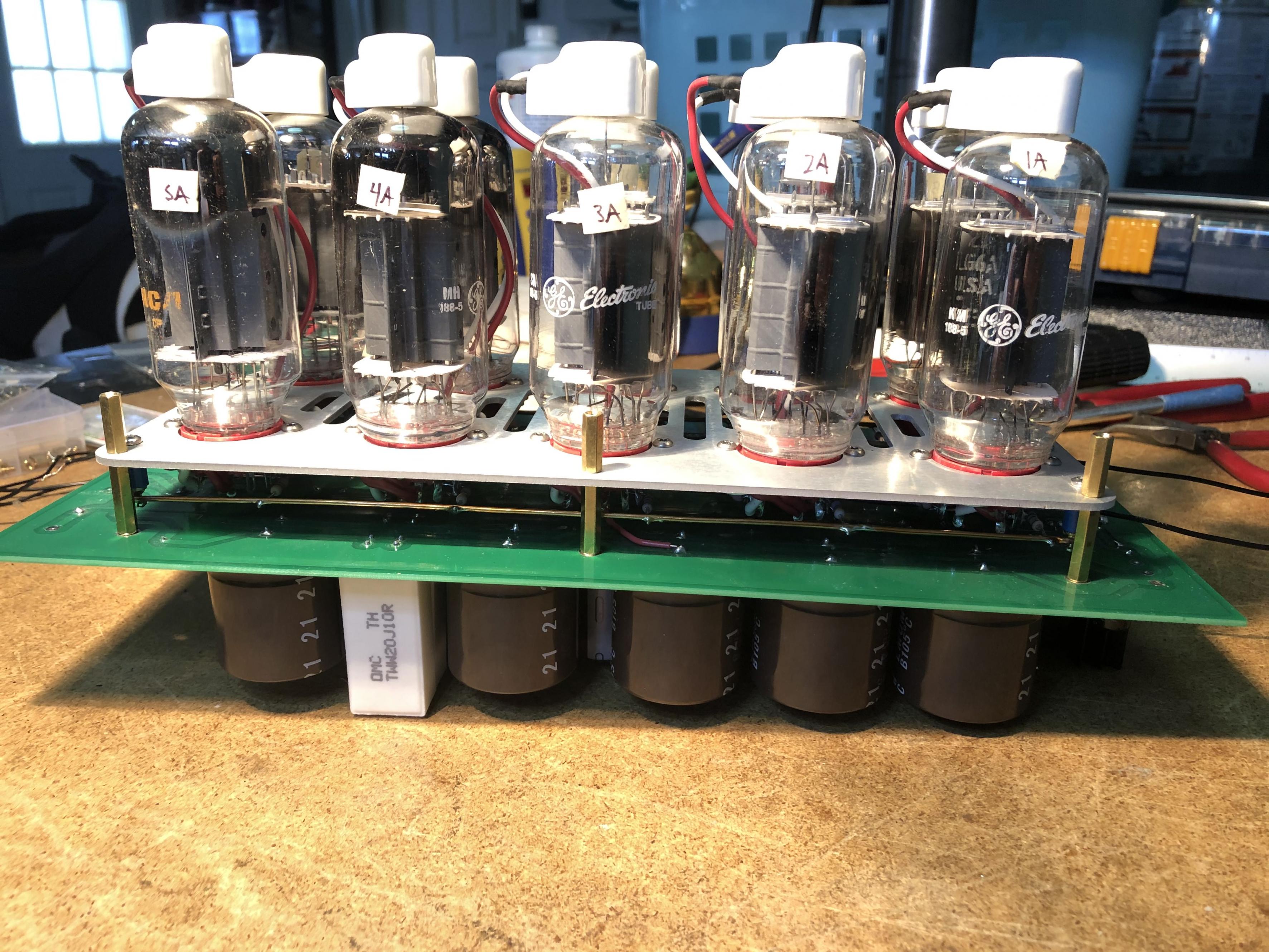

I am currently in the process of building a circlotron OTL using 21LG6A sweep tubes loosely based on Alan Kimmel's original schematic: 100 Watt sweep tube Circlotron OTL (WIP)
I had to do a bit of shopping to find a sweep tube that had the most current capability for the most reasonable price. Most of the best ones have become far too expensive (including the EL509 that Kimmel originally specified). I also briefly checked the feasibility of using 17GE5 tubes (6DQ6 equivalents) but it would have required too many tubes relative to realized output power.

Hope I didn’t clean you out too much on spares for your project - I just bought 16 for a one-off plus spares. I need to experiment with the topology and techniques that I’ll be using for the 26LW6 monster using something less expensive and valuable, but still give me a nice working 300+ watt amp if everything goes well.
