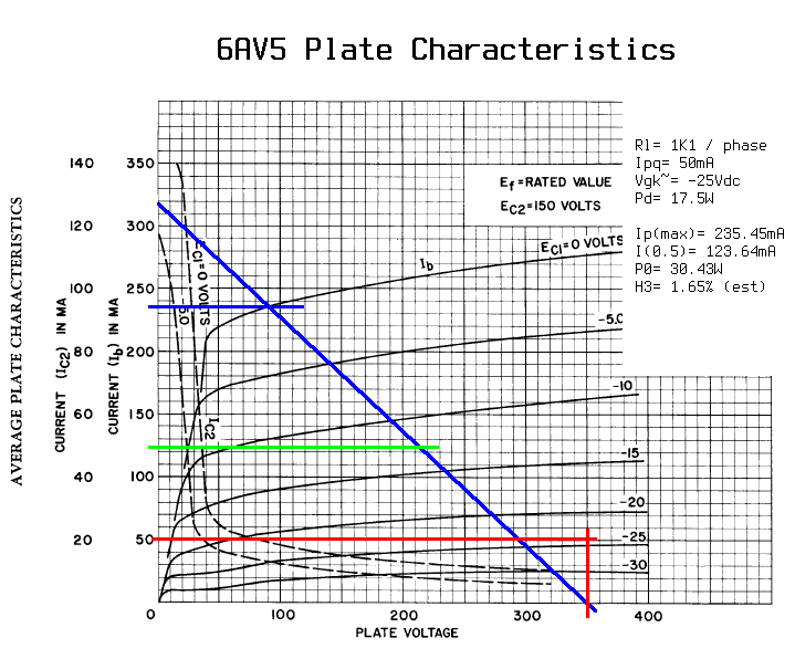

Finally building up a real push-pull amplifier using the stash of 12AV5GA I've been hoarding. I'm going for a simple G1 drive, using a set of iron from Antek.
Good for you. I also have a stash of 12AV5's here. Older, B&W type deflection final that also makes an excellent audio final. (Loafline attached). You might want to consider: Le Renard -- a project I did with 6BQ6GA's, which are very much like 6AV5's with top caps. Some folks don't like those plate caps as they bring the HV above the chassis. The audio performance was excellent, and the 6BQ6 worked like a more powerful 6V6, with mainly H3 with a trace of H5+ on the Twin-T test. Without gNFB, the sound was a bit "edgy" and overly "aggressive", but without any of that pentode nastiness unless you were near clipping. The only gNFB needed was enough to take off the "edge".
I was also quite pleased with how the cascoded LTP worked. Even though the 6BQ7A's don't have any suggested audio designs (an RF type with an undocumented variable-u characteristic?) good audio loadlines can be found. Cascoded, they work very well as an LTP and that eliminates the need for an extra gain stage. That was something I carried over from solid state practice, and it works just as well with hollow state.
420V may be a bit much, though the operating point looks quite good, and agrees with a loadline I did. I had an old Stancor power PTX in the junk box that gave the correct voltage with a 5U4GB instead of SS diodes that over volted by about 100V -- the forward drop of the 5U4, so that worked out just fine.I'm going to use a 150 volt dual secondary power transformer, with each winding stacked to give GND, +210, and +420 volts, that way the screen supply can go off of one supply and get regulated down to +150, and the output plates will get the 420 volt supply, with the driver stages being supplied from a further filtered ~400 or so off of the plate supply. plan is 50mA idle, -25V or so g1. My negative will probably be doubled off the lower winding, or use a backwards filament transformer.
40W is a bit much, though it doesn't really make all that much difference. 30W is more than enough to annoy the neighbors if you crank it.Math if I series connect the secondaries: I will get 4232 ohms off the 5(10) volt version, and 2938 ohms off of the 6(12) volt version. Quick/dirty calculations put a possible ~40 watts or so with the 4k load, and 30 or so with the 3k load, not counting losses.
I am thinking of sweep tube UNSET-SED next project. I sense ignore the Pd rating as that is too conservative for audio amplifier duty.
I hear others (George 🙂 ) suggest find the red plate Pd then back off a little. Really?
TV HD duty is the epitome of "brick on the key" operation, so the PD ratings are very conservative. For audio and most RF applications, you can bust that spec without compromising tube life.

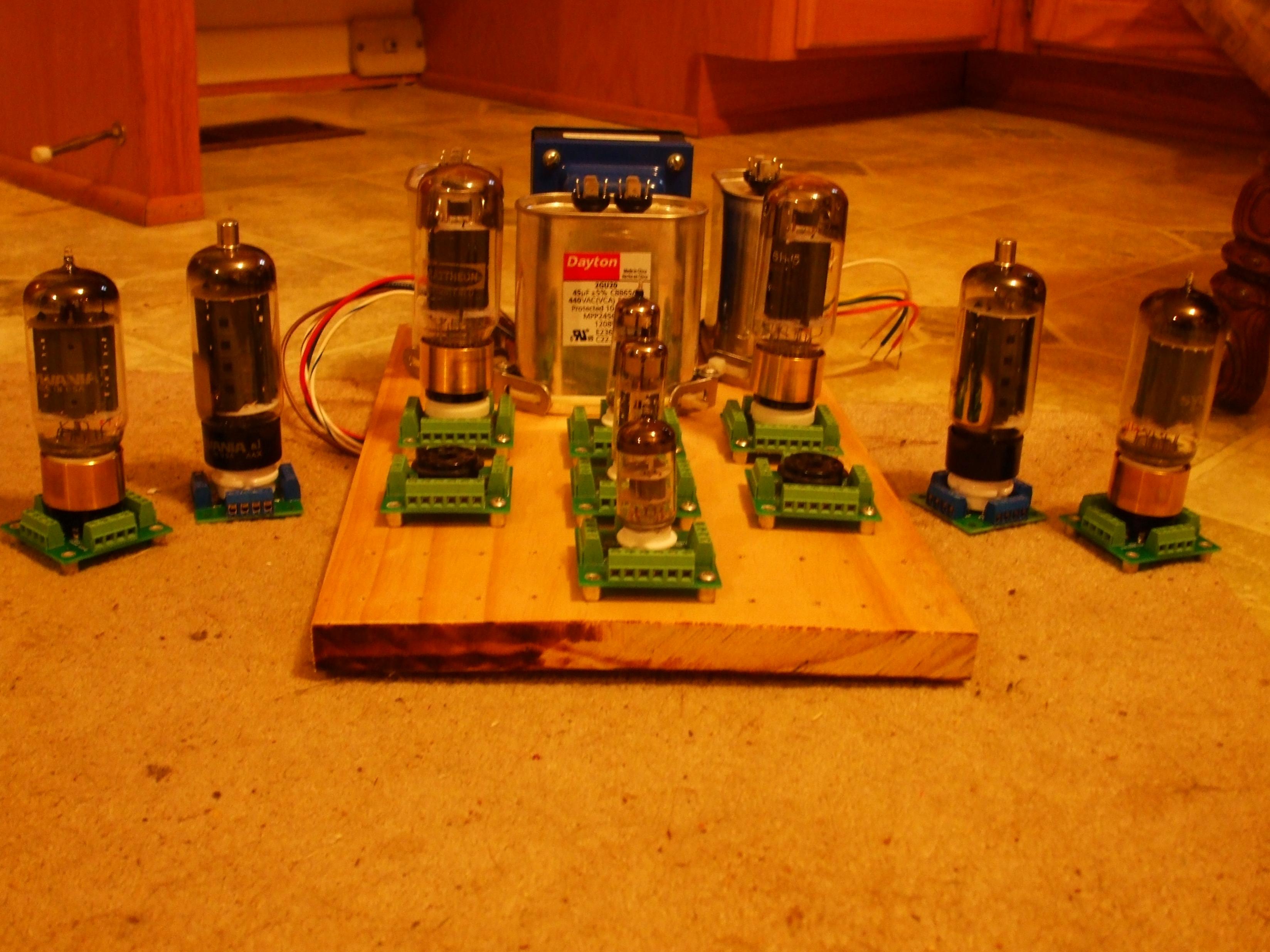

And now you CAN have your cake and eat it too. Adapters (below pic) to make Sweep tubes -LOOK- like conventional Octal Audio tubes. ( faux Octal 6HJ5 and 17KV6 shown, and real Octal 26HU5)
( I made some "gold" tube extenders using Ebay parts. )

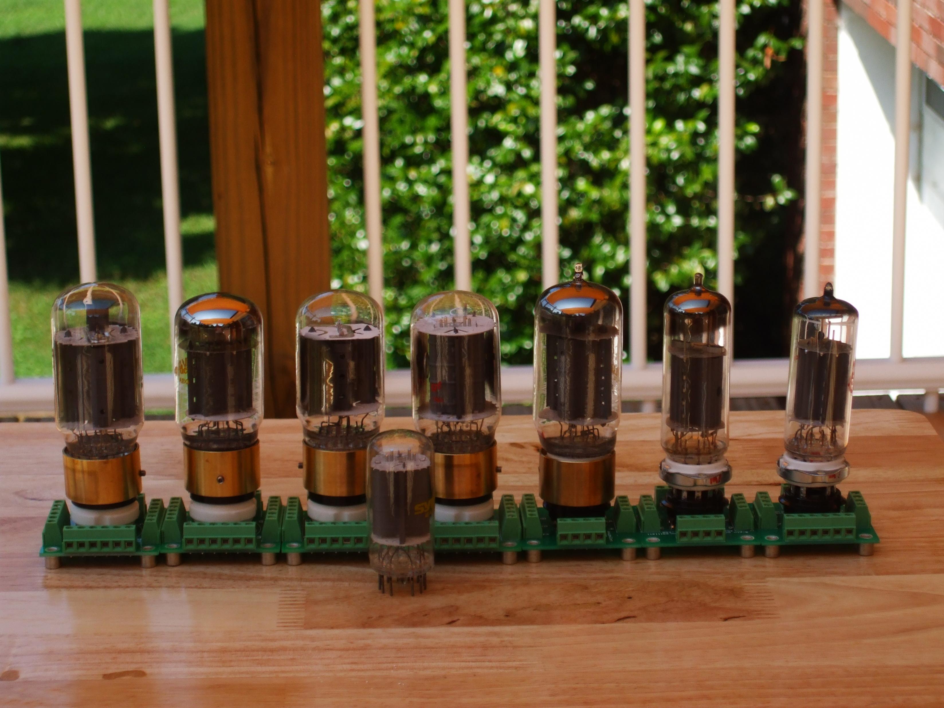

I missed a few plate cap-less TV Sweeps in post # 1568 above:
21HB5A, 6/12/38HE7, 10JA5, 6JC5, 6AU5, 6W6 (/ 12L6/ 6GC5/ 6DG6/ 6CU5/ 6DB5 )
6L6... and 6V6 were old time cap-less Horiz. and Vert. sweeps
Pic 1 has some of the less common cap-less Sweeps
L to R: 21HB5A, 6JC5, 10JA5, 38HE7, 17KV6, 6P41S, 25HX5, (and the little but still mighty 6GF5 in front)
6P41S and 25HX5 are Magnoval base, hence the Magnoval to Novar adapter under them here.
21HB5A was on the $1 list for years (as were 6GF5 and 12/38HE7).
38HE7 is a pentode/damper combo. Also on the $1 (and $0.35 in quant.) lists. About 3/4 of the 38V Htr versions I have seen have the pentode Htr available alone on pins 10 and 12. Becomes 21V Htr for the pentode alone. The pent. can be up-rated to 15 Watts then, without the damper heat.

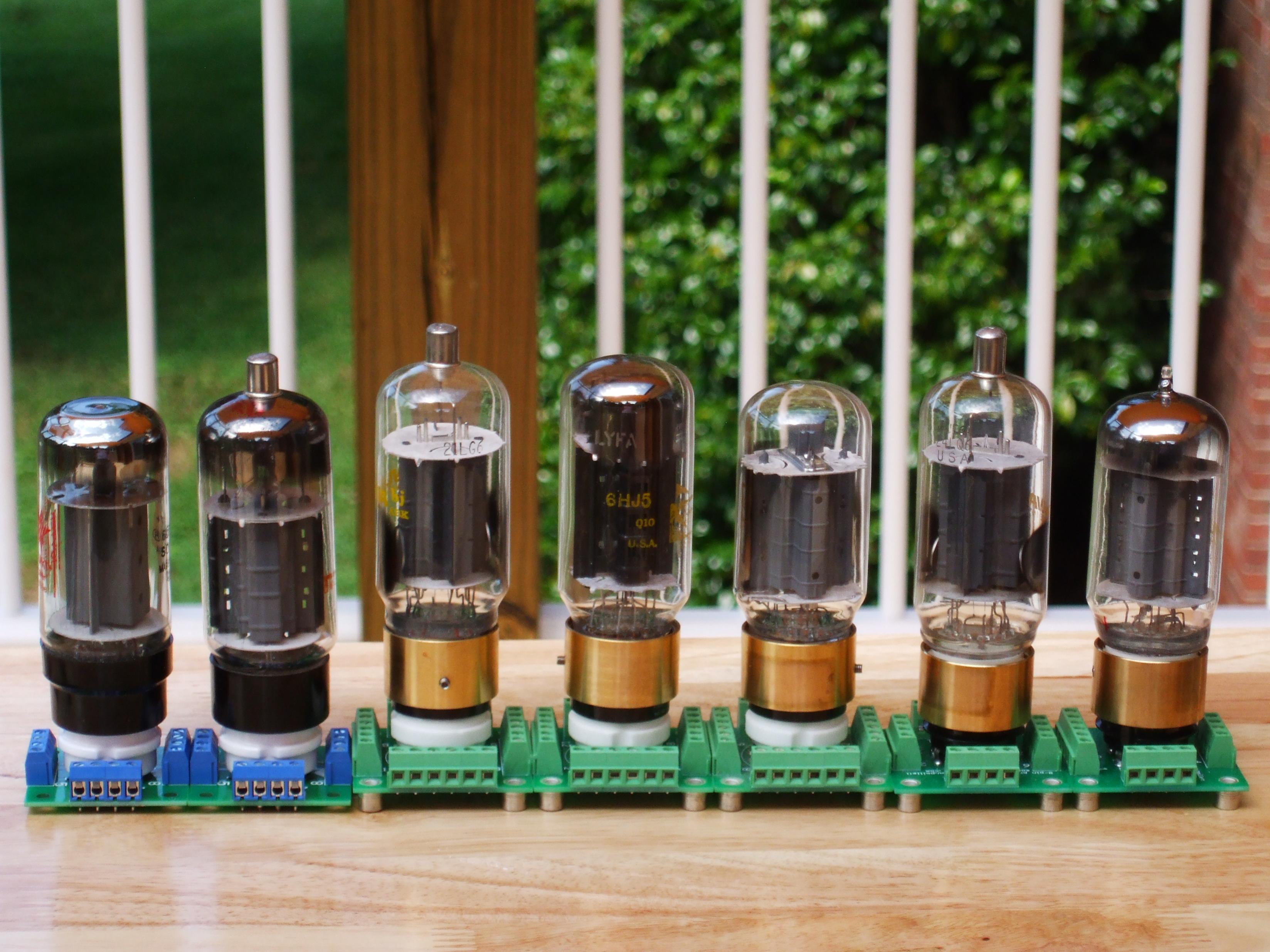

pic 2 are tubes belonging to the Sweep Tube "Conundrum" group!
All of these have a 35 mm long plate in a 1.5 inch diameter bottle. But they have wildly varying plate dissipation ratings. L to R:
6L6GC 35 Watt
6DQ5 24 Watt
21LG6A 28 Watt
6HJ5 24 Watt
21HB5A 18 Watt
24LQ6/24JE6A 30 Watt
17KV6A 28 Watt
some comments:
6L6GC 35W, this is an Audio rating, not a Sweep tube rating
6DQ5 24W, a reasonable Sweep tube rating. The pictured tube is one of the "odd" 6DQ5 tubes around, having guts with "winglets" just like 6LQ6, 6JE6C and 6LG6A. (and having curves just like them too! )
21LG6A 28W, a reasonable Sweep rating. This was a later tube, having an improved cathode with reduced heater power required, reduced screen current, and plate "winglets" for extra cooling, (RCA has a grid 1 cooler fin instead of "winglets") , 28 Watt is believable
6HJ5 24W, a reasonable Sweep rating, very similar to 6DQ5 except no plate cap.
21HB5A 18W, this is certainly a conservative Sweep rating, although most 21/6HB5 types do not have the grid1 cooler shown in this pic. The pic'd tube was a GE version made for reliable IBM computer monitors, I'll bet it can do 22 Watts reliably (sweep tube use) with the grid1 cooler. This was on the $1 list for some time, no one ever seemed to pick up on these for audio. Somewhat higher gm for its size. Nice curves.
24LQ6/24JE6A 30W, maybe not. RCA came out with this in 1967, and Sylvania said it wasn't really a 30 Watt tube. Then 6ME6, 6JE6C and later 6MJ6 all came out as equivalent tubes with -high- reliability prominently mentioned. The 6/21LG6A tube also has identical guts to 6LQ6 and 6JE6C, rated 28 Watt, and identical curves. (and 1/10 the price of 6LQ6 lately, not pin compatible)
6/17KV6A 28 Watt, maybe not. The first data sheet for 6KV6 was identical to the 20 Watt 6KM6, except now no plate cap and rated as a TV HV pulse regulator. Then the A version came out with reduced grid 2 Watts and increased plate Watts for regulator service. The similar 6JE6C tube allows trading -1 Watt of grid 2 for +4 Watts of plate. Looks like that is what they did here. The 3.5W 6KV6 grid2 got reduced to 2 Watts (for regulator service instead of Sweep service), allowing 6 more Watts of plate and the grid1 got a cooler fin, for another 2 Watts. For ordinary TV Sweep tube service, I would call it a 22 Watt tube.
(the "gold" bases in the pics are an add on extender made from parts off Ebay, almost look Octal)

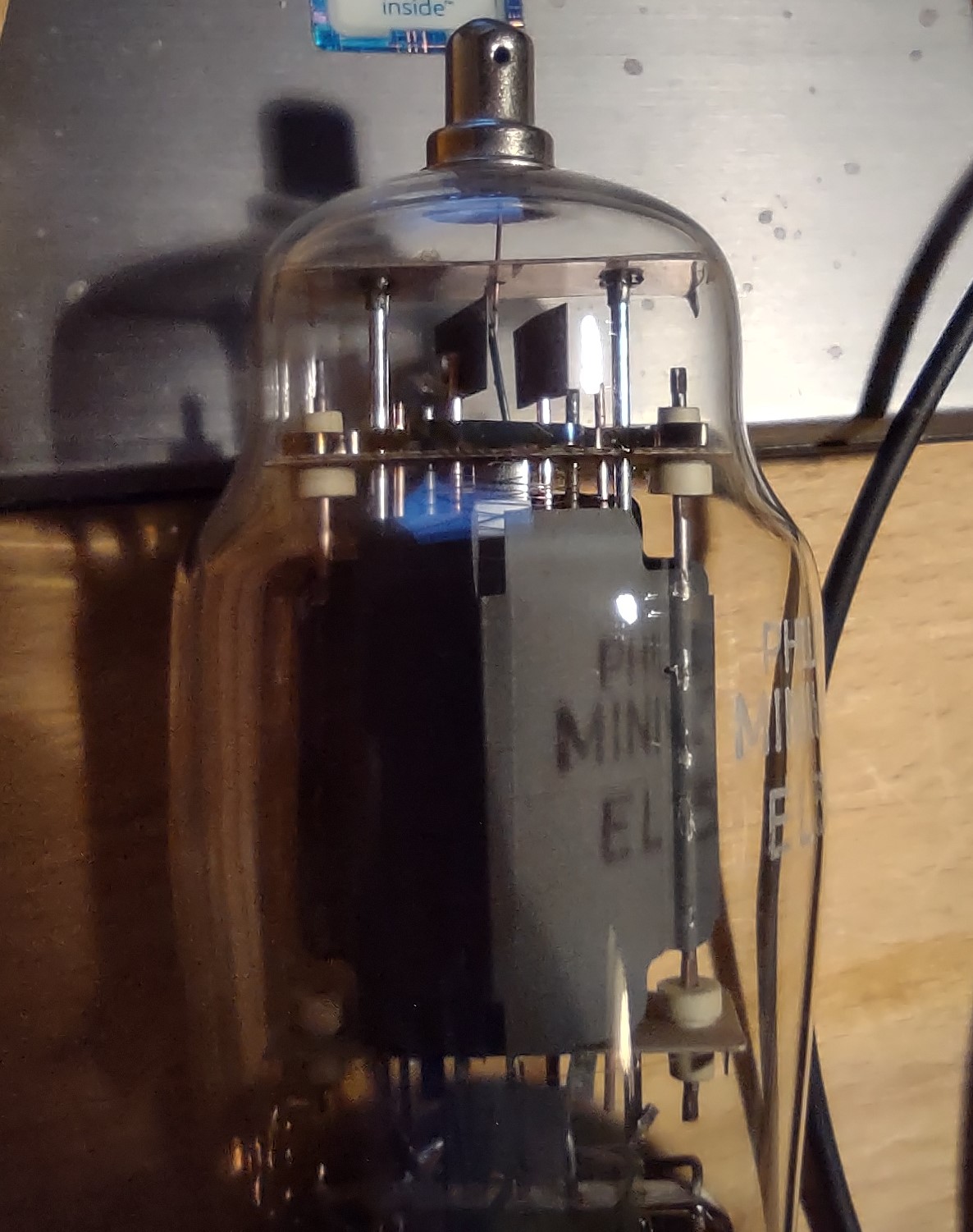

I did a search of this thread and did not see any posts on the el38. I assume it is because it was used in the UK. I stumbled onto them as a suitable tube to use in my 6l6/el34 cathode bias SE pentode amp. Gotta say, they are a remarkable sounding tube in this amp. Super clarity and bass control. I've heard rumors that they are related to the Mullard EL34 and even the KT77.
I've seen people talk about using them as triodes but not as single ended pentodes. With 290v regulated screen and an unknown, but safe for 6l6g, voltage on the plate they sound amazing. I assume at these voltages they should have a long life, right?

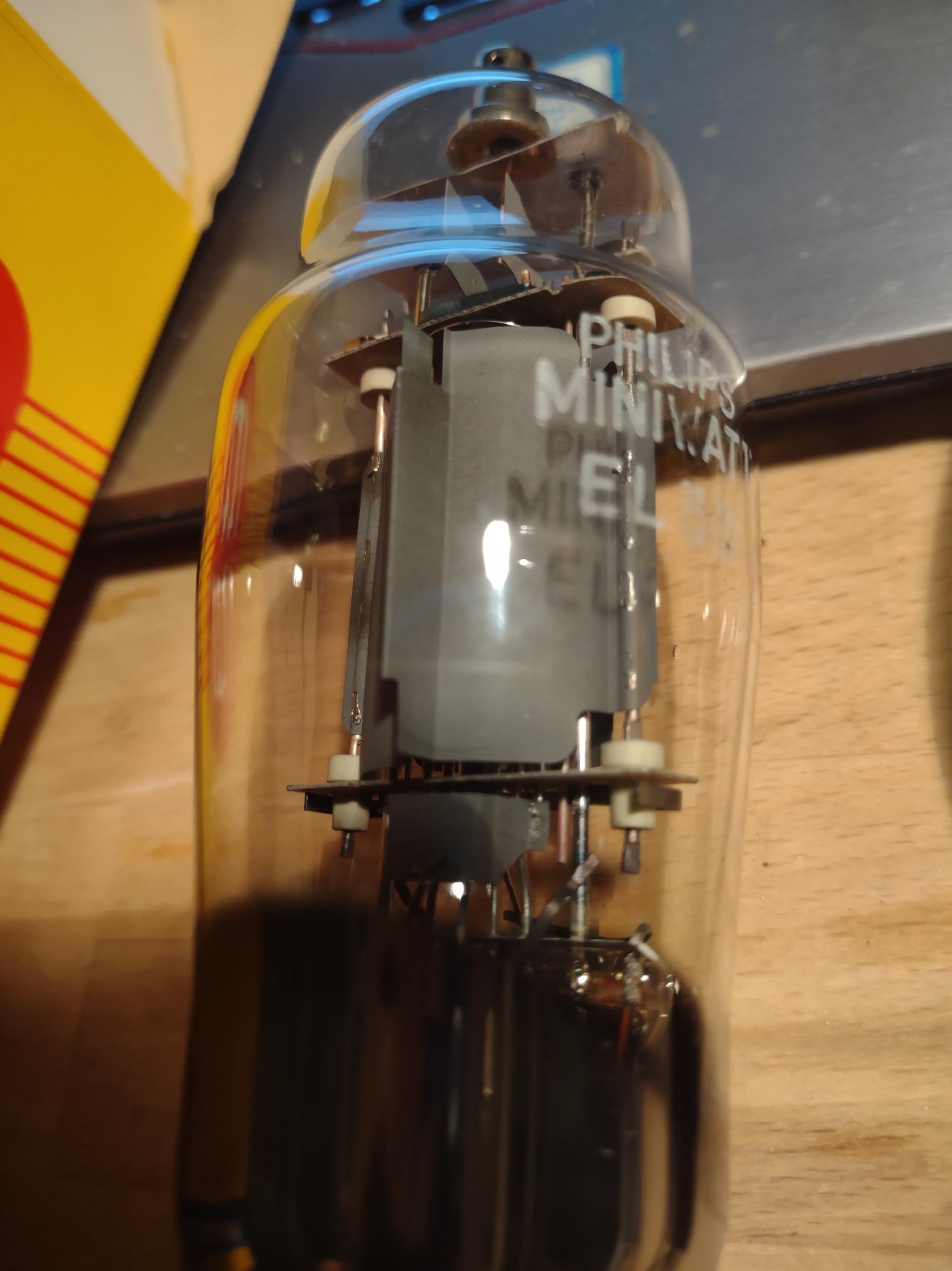

Does anyone have any views on the PCL200? I can pick up 30 or so, and the data looks interesting, but the decal base makes it a trickier call.
I acquire tubes thinking I will do something with them, but if you are planning a PP amp, then you really need 8 or 12 anyway, if they are not run of the mill, so that spares are not a concern, and balanced pairs are possible.
They certainly look robust enough! They must have been a pain to produce, with those ceramic spacers.
They are handsome tubes and I've never seen so much blue glow before. Also wondering if biasing them like a 6l6g would do them any harm. My amp is cathode bias.
According to the tube data sheet, they have a max rating of 800V / 400V for anode/screen, so would look to be tougher than a 6L6G which is rated 360V/270V resp.
I have acquired a few and am looking forward to having the time to try them in my Tubelab SSE instead of EL34s. I've also heard that they have a sound (one reviewer said it was 'dark').
I’ve heard them in two different amps. They are both cathode bias and so were unable to be optimized for the EL38. But in both systems the sound was not what I would call dark. Instead they were open and had a remarkable sense of clarity. My amp is running single ended pentode and the bass is noticeably tighter than my 6ar6 and 807.
My amp changes the voltage going to the output tubes plates by changing the rectifier. I’ve been using a 5u4g like I do with my 807 tubes. Sounds like I could move up to the 5ar4 like I do with the KT88.
The EL38 has climbed in value so maybe it is no longer as attractive as some of the other tubes in this thread. I will say that having honest to God Millard tubes (with the big and beautiful blue and orange boxes) makes this audiophool quite happy. The sound lives up to the label’s reputation.
