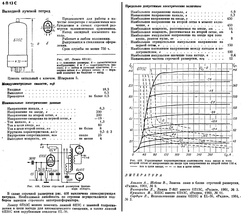

The Russian 6P13S works well with a voltage of ~420V on G2 with a slightly higher negative voltage on G1 without any traces of overheating and instability. Physically, it looks very similar to 6P31S (EL36), but it differs from it in terms of characteristics.

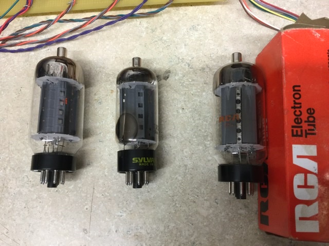

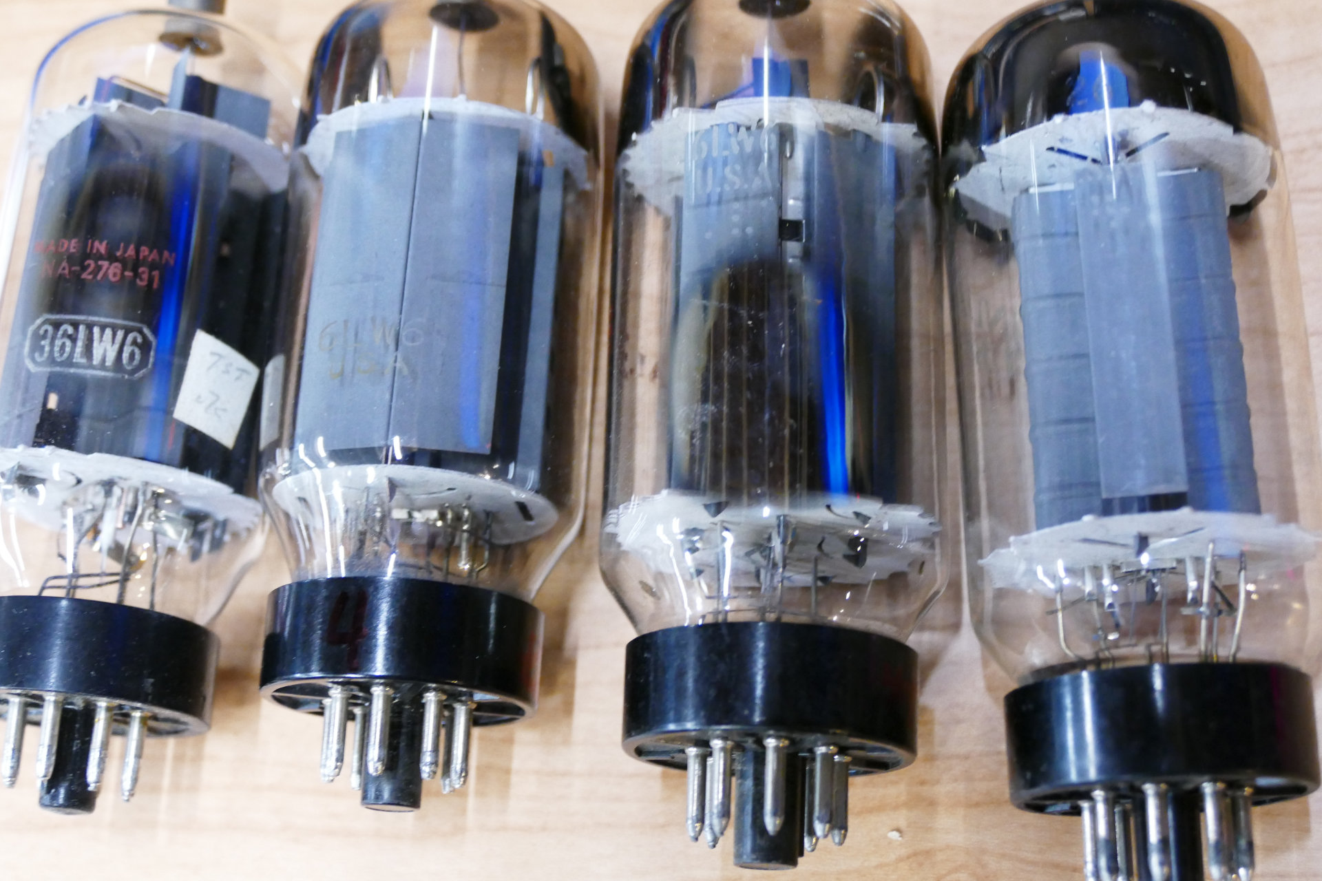

Back to sweep tubes, I have one that’s a mystery to me anyway. Most of my 26/36LW6’s are the large bottle variety (left) . A handful in the small bottle (center). Both look similar inside. GE and RCA exactly the same, and Sylvania a bit different but obviously intended to be the same. But I also have exactly ONE 26LW6 on the right. It looks like it has two complete separate plates (tied together at the pins). And altogether much more internal mass than the others. Were these common at all - IOW, will I likely ever find a mate?

I have one that’s a mystery to me anyway.....I also have exactly ONE 26LW6 on the right.
The 6LW6/26LW6/36LW6 tubes are all made by one of three vendors regardless of whose name is on the tube. All of them went through several iterations to improve quality, or reduce cost during their production run.
The tube on the left is made in Japan. Some say Hitachi, some say Toshiba. I don't know for sure, I have two, both well used, and they are not exactly identical inside, but both wear the elongated octagon around the type number. It has the beefiest guts and weighs the most. I have not tested them for power handling capability.
Next to it is a Sylvania made tube that wears no brand name. Sylvania tubes usually have the type number in thin letters with the letters USA underneath the numbers. Note no periods between the "USA" letters. This one has rather wide fins attached to the plates to help radiate heat. I have only seen large fins on Sylvania 6LW6's. The Sylvania 26 and 36LW6's have small fins and usually come in the skinny bottle like yours.
The fat 6LW6 further to the right is like your twin plate version. It is made by GE. GE tubes have the type number etched into the glass in a thicker font than Sylvania uses. The U.S.A. label is etched into the glass below the type number with the periods between the letters. GE tubes usually have the "dot code" below the U.S.A. Some say this is a date code, others say it is a lot or batch code.
The twin plate 6WL6 is rather rare, and eats by far the most power of any of the xLW6's. Red plate doesn't occur until 80 to 90 watts of continuous dissipation. I have two or three of these and all are 6LW6's. I have never seen a 26LW6 version, but I have only a few 26LW6's. Most of my tubes are 36LW6's since I was able to get these for under $10 each until recently.
The fat tube on the right is a GE 26LW6 with the small plate fins. These are quite common. I have seen the same guts in the small bottle GE xLW6 tubes.
Most of the xLW6's with large fins attached to the plate were rather early vintage. I have seen several different fin structures attached to the plates in fat bottled GE tubes. GE apparently revised the fin structure several times in the first few years. I'm guessing that there were alignment issues with putting all of this together, since a portion of the fin extends inside the plate. Some of these tubes seem to suffer from hot spotting with localized red spots appearing around 40 to 50 watts, while other finned tubes will eat 70 to 90 watts.
Latter tubes got smaller fins attached to the typical two piece plate, and eventually all the bottles went on a diet. The fat small fin GE's seem to turn red in the 60 to 70 watt range with a little less for the similar Sylvanias. The skinny tubes also tend to give up a watt or three in the max power test, but any well made xLW6 can eat 50 to 60 watts for hours.
Some tubes do have alignment issues, and may red plate on one side, and not the other. These should not be pushed beyond 40 watts, or less if red plate shows.

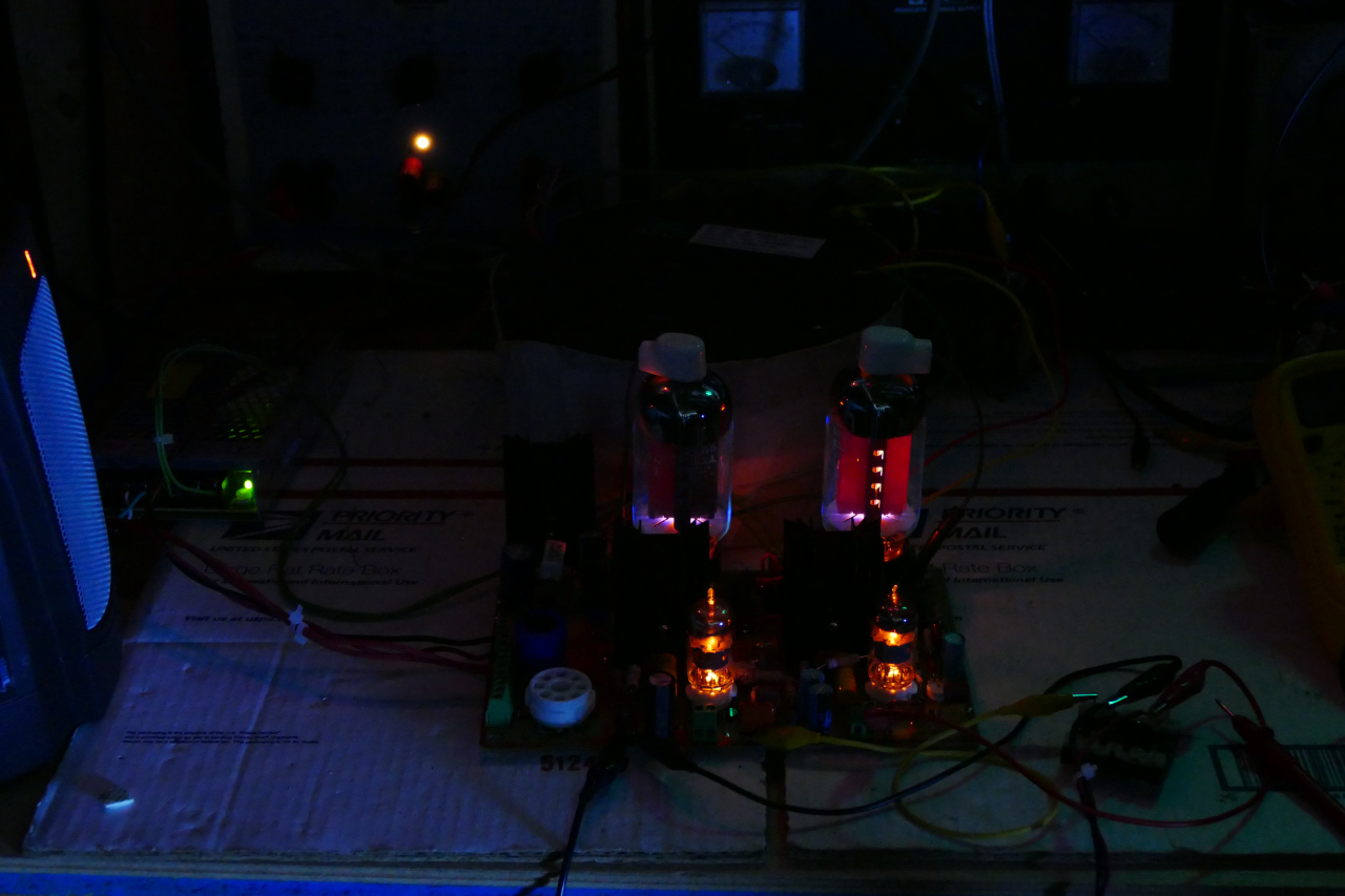

The second picture shows a pair of "Lindal" branded 36LW6's cranking out 250 watts of continuous sine wave at 3% THD in a push pull amp. The Lindal 36LW6 is a relabeled "rejected" GE small fin fat bottle tube. These both red plate evenly, but one is hotter due to unequal GM and drive levels. The idle currents are matched. The hot tube is dissipating about 75 watts, and had been running at that level for about 5 minutes when I took the picture.
