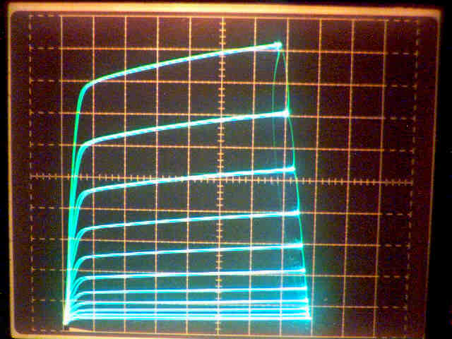

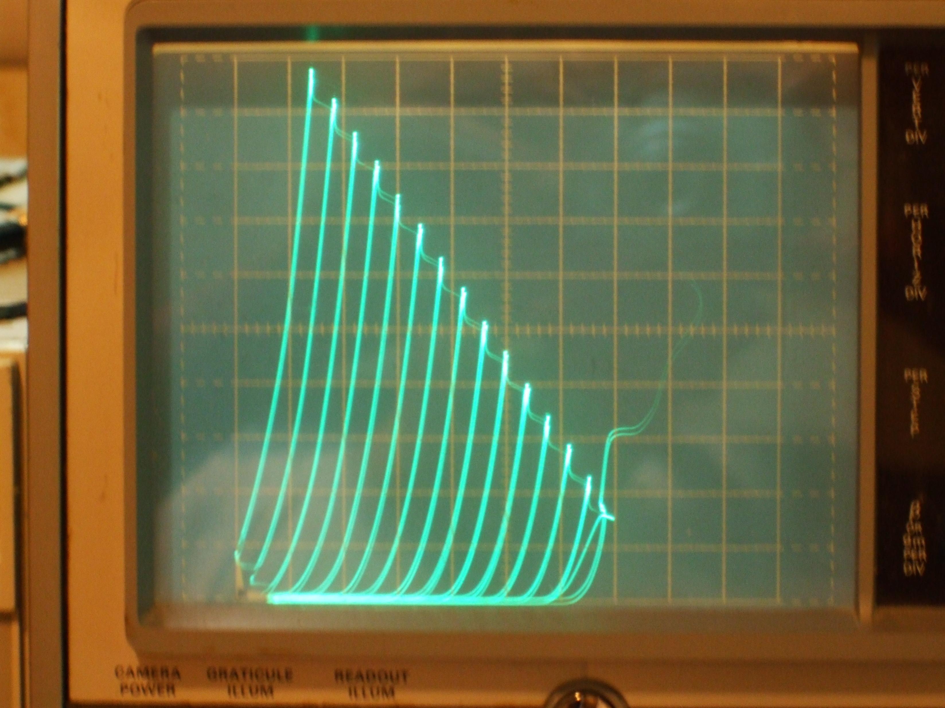

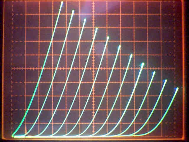

12HL7 appears to be one of the rare (frame grid) tubes that has relaxed grid 1 to cathode spacing. Usually most of these frame grid tube designs were pushed to the limit (just like most other tubes) to get the max gm by minimal spacing. Notice 12GN7/12HG7 which are identical in construction to the 12HL7, but have almost twice the gm of the 12HL7. Similarly the 9KC6 at 40000 gm.
Selecting thru 12HL7 tubes on the curve tracer, one can find a fair percentage that have triode curves that are near DHT quality. (triode curves, in above post and below)
Another oddity I've seen is the 6JC6 frame grid tube. The US made ones tend to have typical mediocre triode mode curves. But some Japan made ones have remarkable triode curves. (Got them cheap via a tube sale. I almost threw them out since they had poor looking pentode curves, but I found they could be fixed up with the g3 voltage trick. Then I noticed the triode curves were real nice too. )
The 9DX base frame grid tubes also have a high success rate for great triode curves (the high gm pent. in triode mode).

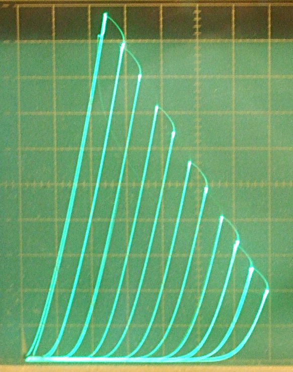

For power tubes, we have the "new" series Schade scheme (UnSet, CED at Tubelab) which can turn the meanest TV "Sweep" tube into a 211 like clone, except still working at practical B+ and output Z. This "new" series Schade scheme is quite amenable to paralleling tubes for more power too, since it gives them all perfectly matched "triode" curves.

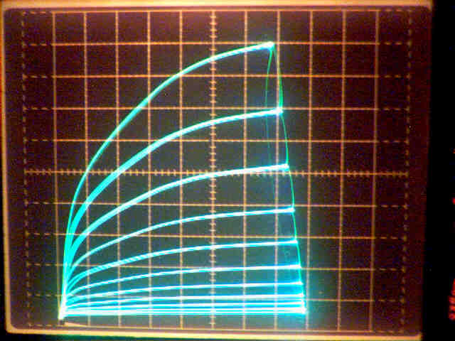

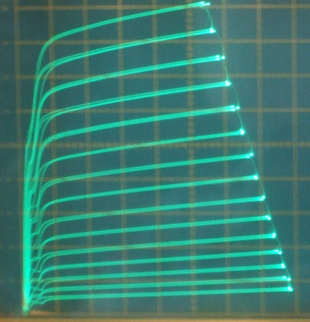

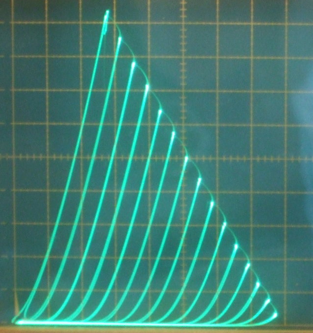

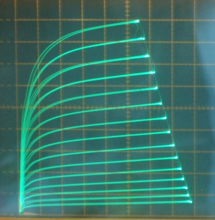

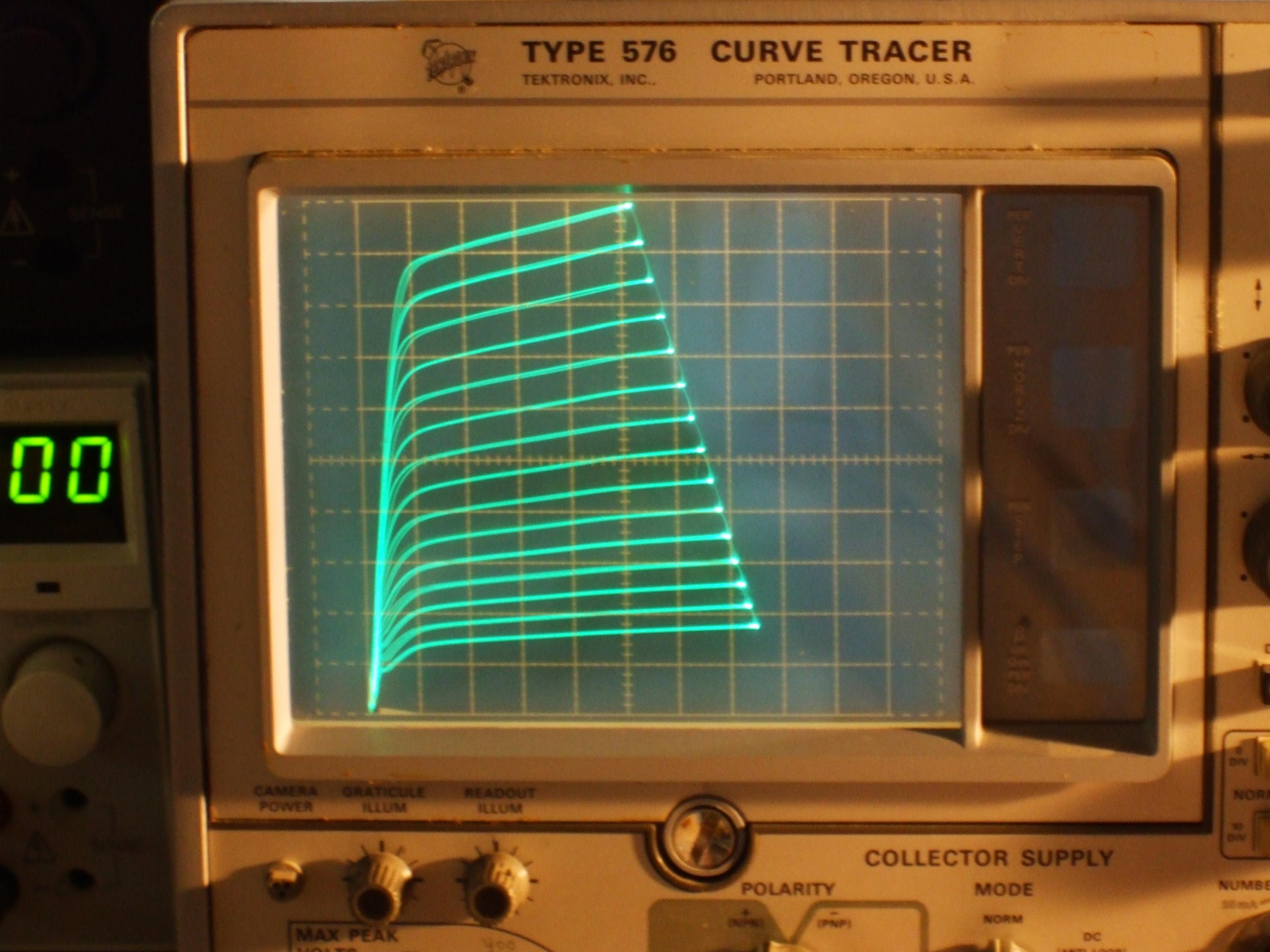

pics:
a) 12HL7 in triode mode
b) 21HB5A TV Sweep with "new" series Schade (UnSet, CED)
c) a cheap dual DHP in triode mode
d) 4P1L DHP in normal pentode mode
e) 4P1L with +15V on g3 fix
f) 4P1L in triode mode
g) 211 DHT curves

All of these tubes look different when plugged into a conventional curve tracer. Once wired into a CED circuit they will behave in a similar manner due to the plate to grid feedback. Rolling through about 20 random tubes in the input stage of an UNSET board running at 10 watts of power output shows only 0.1 to 0.2% THD difference. The 6EH7 remote cutoff tube is the worse case (expected).
It works on small tubes too. The tubes discussed here were my first test subjects since they were real cheap at one time. The UNSET board uses any of these for the driver, and any of several TV sweep tubes for the output. Both are wired in CED configuration.
You can run them at 211 voltages too since the screen stays at a mild mannered 150 to 175 volts. I have only been to 650 volts, the limit of my power supply.
Amazing
Thanks smoking-amp....
The 4P1L looks more promising now....BJT like curves from a valve.Lovely 🙂

😉 now we can determinate the Early voltage from the... anode curvesAmazing

Is 4P1L really a television tube?
Probably not. I see it described as related to RL4/2P6, which are described as "End-un senderstufen", which seems to translate to output and signal driver.
I just mentioned it since it responds to the positive V on g3 fix well.
