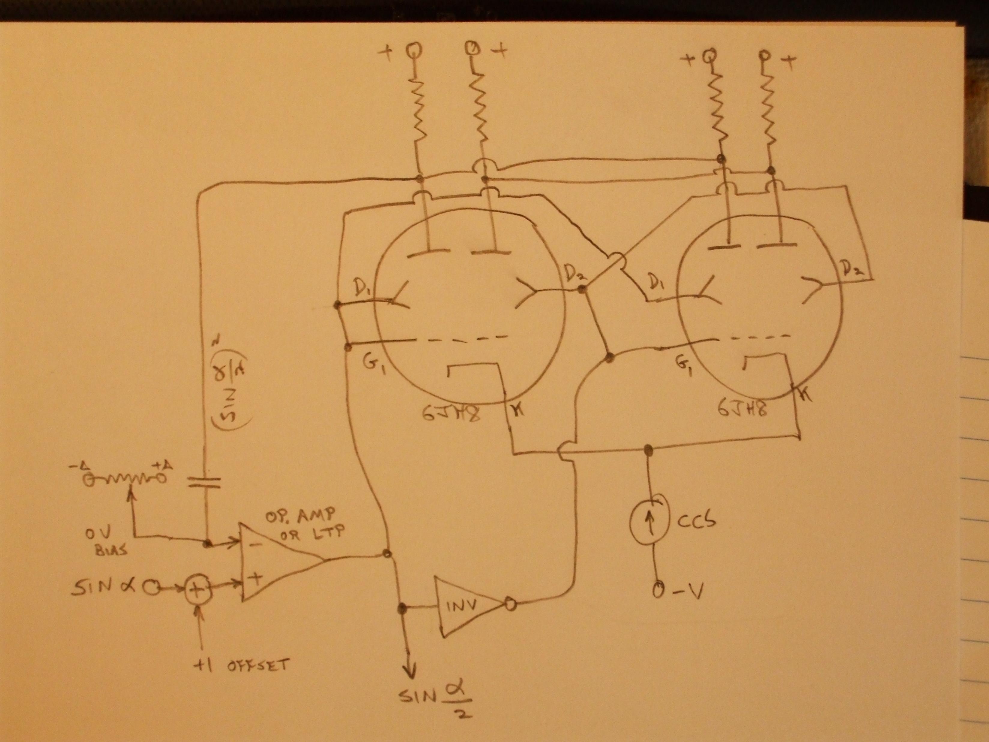

Somewhere in a dark corner of my brain resides this idea of making a vacuum tube music synthesizer, along the lines of a MiniMoog, but using vacuum tubes for the signal path, and more modern electronics for the control and supporting roles......kinda hard to do a MIDI interface in tubes. I have most of the major building blocks working individually on breadboards, including a "digitally assisted" vacuum tube VCO, with a sub-output.
I got the dumm blonde idea of running my guitar signal through its frequency divider, hence the squarer circuit with a 6BN6, which performs the limiting (squaring) and discriminating function (ditch the quad coil and integrating cap to kill it) in an FM radio or NTSC TV (FM sound). The circuit requires a clean SINGLE FREQUENCY signal to work correctly. Feed it two guitar notes at once, or even some string noise and all sorts of ugly comes out.
Sin Q/2 = +/- 0.707 x SQRT(1+SIN Q )
However there are some issues with this formula. The "1" is the max amplitude of the signal coming in. The SQRT needs to change sign to keep continuity around zero output. It only works for one frequency at a time.
A 6JH8 beam deflection tube set, with a N FDBK circuit, can do the SQRT function. But some kind of derivative detector would be required to flip signs appropriately. There could be a more complex math function that would eliminate the sign flips, I just can't find it yet.
There is a more sophisticated approach that will work for combinations of frequencies simultaneously to halve the freq. The most obvious is the FFT, then shift the coefficients down to half freq., then do the inverse transform. This would only be practical with a digital signal processor with A/D and D/A functions.
However, there is a clever version called the FIFO Fourier Transform. It works by just computing the difference in the FFT after each new sample comes in. This will work for either digital or analog implementation. It just requires an analog FIFO memory (minimum N samples for N/2 bandwidth) and it updates the FIFO data with each signal sample time slot, using a multiply and two additions for each memory location. The 6JH8 BDT and a summer can do this readily.
Analog memory would be provided by N sample and hold functions. An analog FET gate multiplexer would cycle around the N locations to update them for each clock cycle. An inverse FIFO transform then translates the stored data back to a signal using the analog multixer to select data to average FIFO locations to halve the frequency. Still complicated, but this appears to be as simple as it gets for a complex signal, and is within the realm of a serious effort.

Ah-ha! If the sine wave notes are separate, then the 1st equation will work well.
And after thinking about the circuit operation, I don't think any sign flipper is needed, just a tiny bit of overshoot in the Op Amp gets the correct path started on zero crossings. A circuit using 6JH8 beam deflection tubes is attached below. Some DC bias adjusts are likely needed, but grid 1 and deflectors nominally operate around 0 V. An AC only passing cap needed for the - input of the Op Amp along with a 0V bias adjust there. Also a gain adjust for the Op Amp (not shown). 0 V adjusts on the grids and deflectors. { Woops, minor error in the schematic, the dual plate connections need to be dropped I think. Supposed to get X*X + (-X)*(-X ) but that only works with neg. numbers. For this circuit, just use the leftmost X*X plate alone for Fdbk }
If I were going to experiment with analog computing circuits, I would also suggest getting some 6197 tubes (GE ones available cheap in bulk) besides some 6JH8 BDT tubes. The JAN GE 6197 tubes I got a couple of years ago are remarkably consistent and have nice curves. I got them for less than $0.50 each then, when they were on sale. I notice the Ebay ads for qty 50 or 200 of them still have the "make an offer" option.
Oh,
I guess if all the plate outputs are individually AC coupled, then X*X + (-X)*(-X) cross coupling will work. But just using the X*X output alone should be fine here.
(the two BDT tubes over the CCS are used to get the grid 1 functions linearized, otherwise one would get X*(X^3/2) due to non-linearity of grid 1. Some cathode degeneration resistors could also be included for even better linearization here. Or, for extreme linearity, a third BDT could be used in place of the CCS in a split cascode like arrangement, so not using grid 1 control at all then. )
