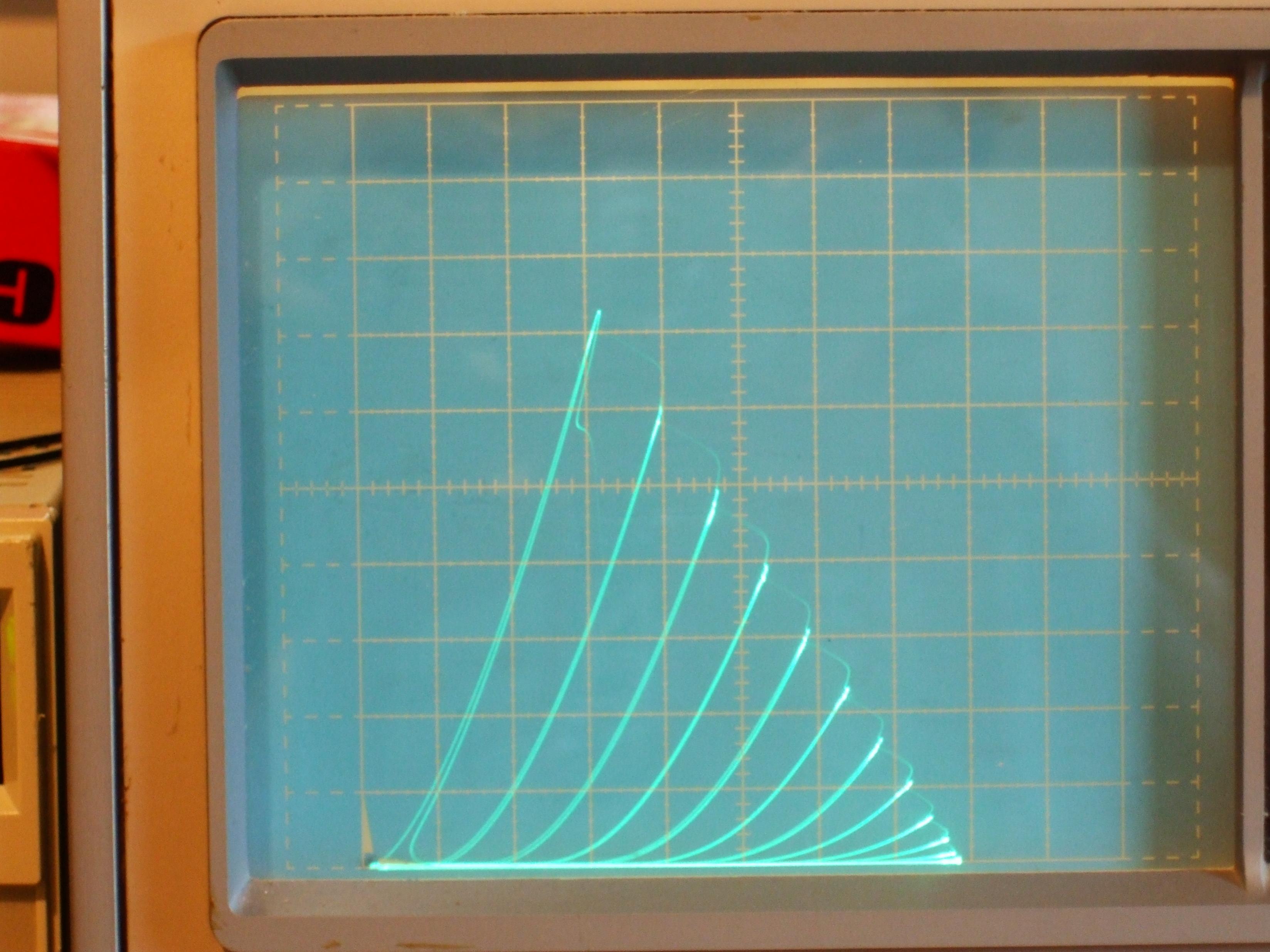

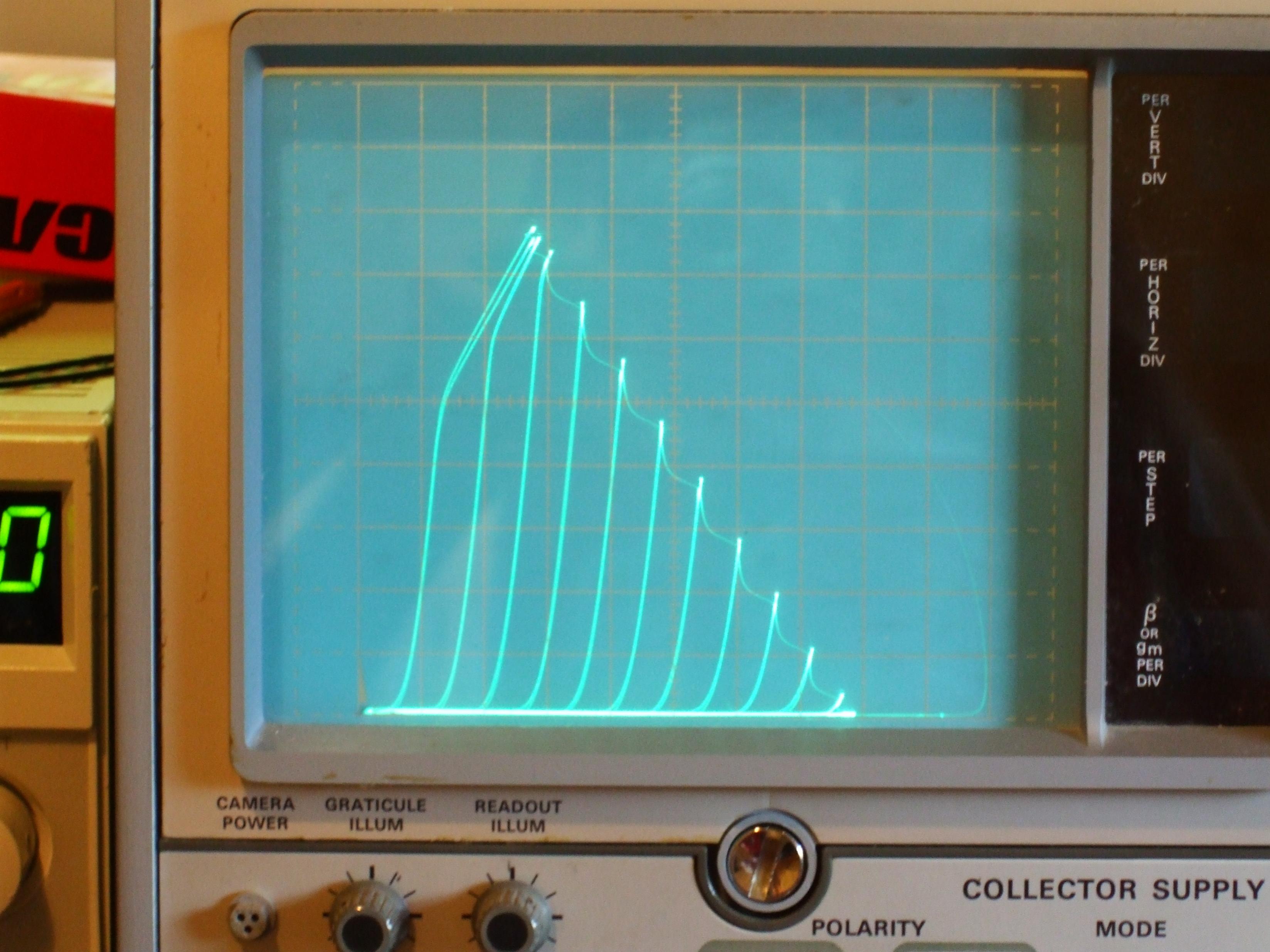

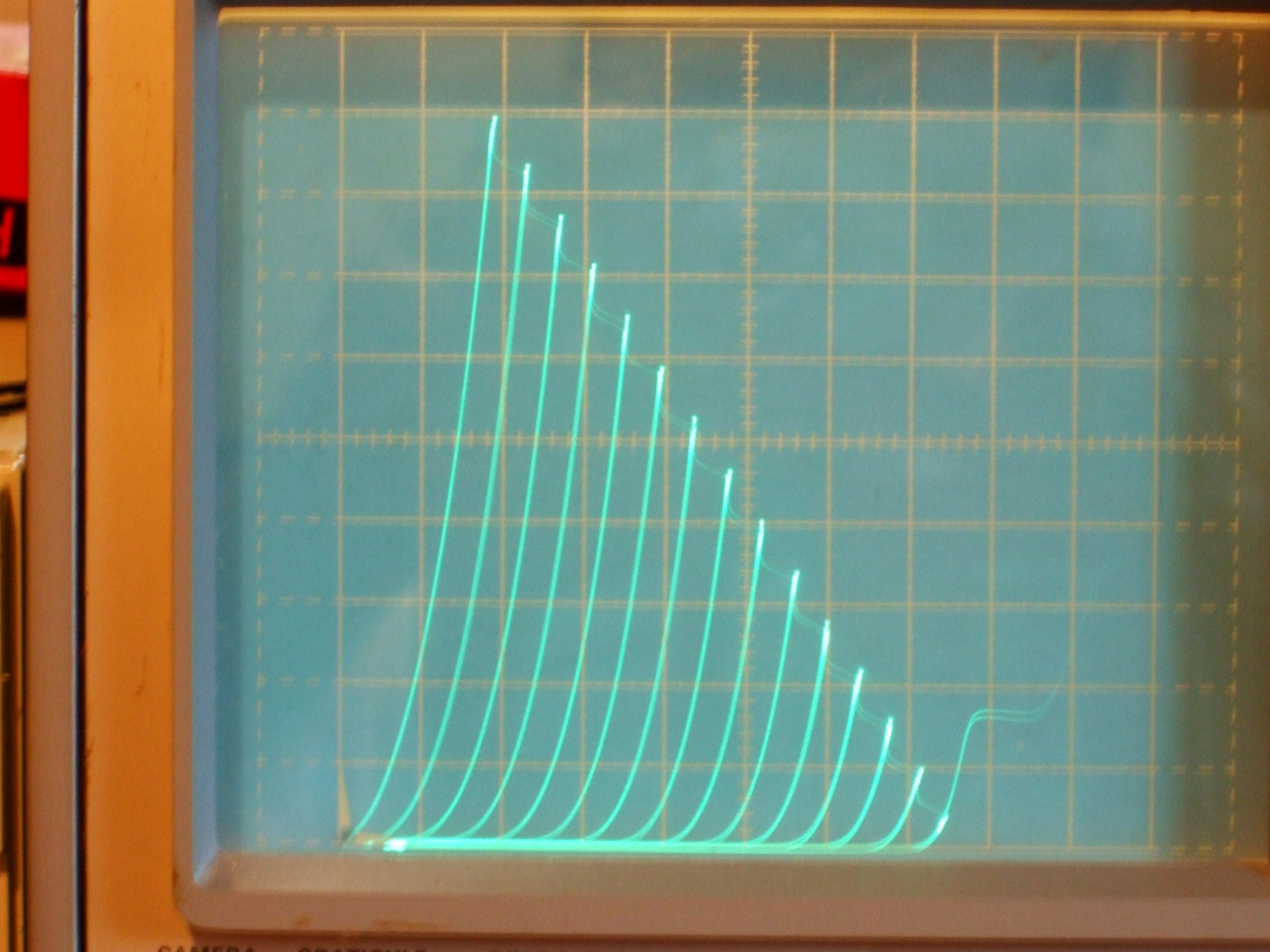

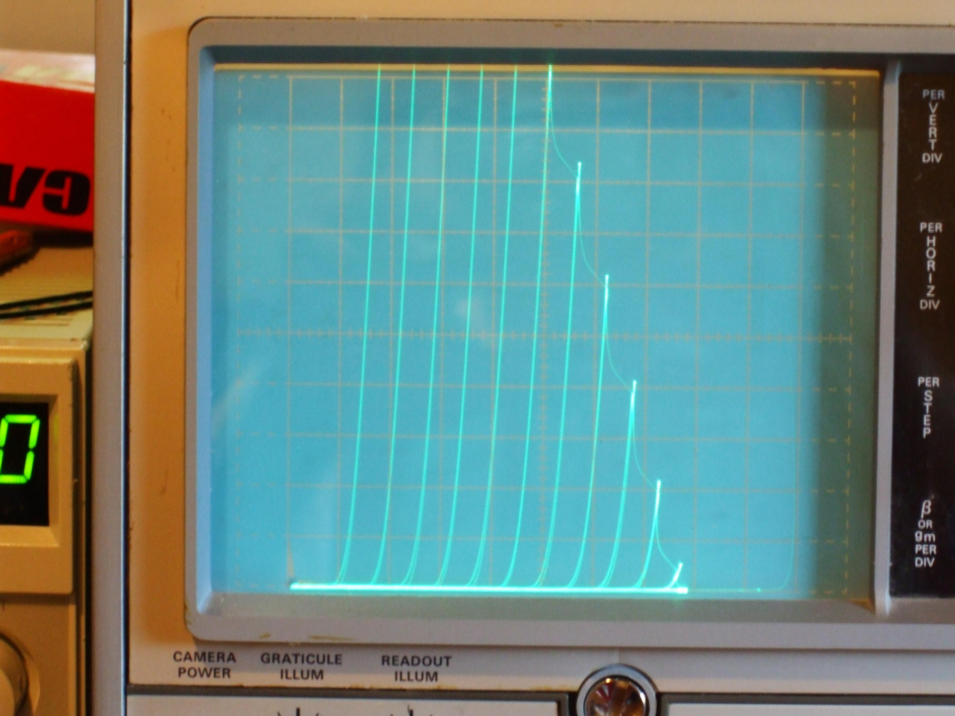

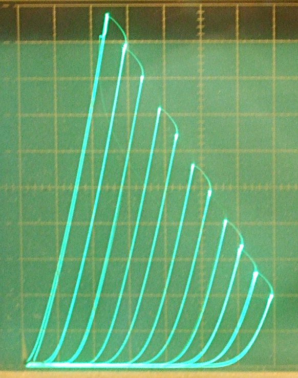

Here are some curves for another Vertical Sweep triode, the 6FJ7. (the 10 Watt section) This triode has a higher Mu (15.4) than the previous Vertical Sweep 13GF7 (Mu 5.4) (equiv. to 6EM7), so has more gain to use in the new Series Schade Fdbk scheme (CED, UnSet).
50V/div Horiz for all.
a) 6FJ7 native mode, 20 mA/div Vert.
b) 6FJ7 series Schade, 20 mA/div Vert.
c) 6FJ7 series Schade, 50 mA/div Vert.
The bent over curve sections at the top of the series Schade pic c) are from grid current I think. Notice the lack of curve roll-over for the Series Schade pics. And obviously lower Rp.
So the "oddball" Vertical Sweep 6FJ7 (with higher Mu) can perform quite well after all. I always thought it was sorta on the useless side. Fixed!
6BL7 is similar to 6FJ7.

. . . . . I always thought it was sorta on the useless side. Fixed! . . . . . . . ..
I always thought that the 'ideal triode' would have straight evenly spaced grid bias lines running at 45º from bottom left to top right. What's the best way to deal with near vertical curves? Low resistive load to maximize current swing or CCS for voltage? (Hmmm, I think I just answered my own question - I'll post it though 'cause you most certainly have more to say than I know.)
The vertical line type triode curves (or just plain lower Rp) are capable of driving lower impedance loads. Well, just plot a load line on them.
Two factors (for triodes) affecting distortion along the load line are the diode shape of each curve itself, leading to 2nd harmonic mainly, at too low a load Z.
And the other factor is the roll-over in the triode curves toward the HV end. This is caused by the grid 1 wires being too close to the cathode (relative to wire spacing) done in order to get higher gm. This proximity effect, or "island effect" makes the transfer function of grid 1 closer to square law (V to I) over the usual operating range, while the plate (or grid 2 for pentodes etc) is far enough away from the cathode and has a near 3/2 power law. The mis-match, 2 versus 3/2, causes the plate curve roll-over typically seen. The Schade type local N Fdbk removes much of this since the N Fdbk is across the offending g1 to cathode.
Your "ideal triode" with sloping equal spaced straight lines IS possible if the Schade N Fdbk is sent back via a Crazy Drive type grid setup. (Rg2g1 and Rg1k resistors) with a Mosfet follower (generally required) for grid 2 current. And using the "new" P-Mosfet cathode drive for signal input relative to g1 and g2.

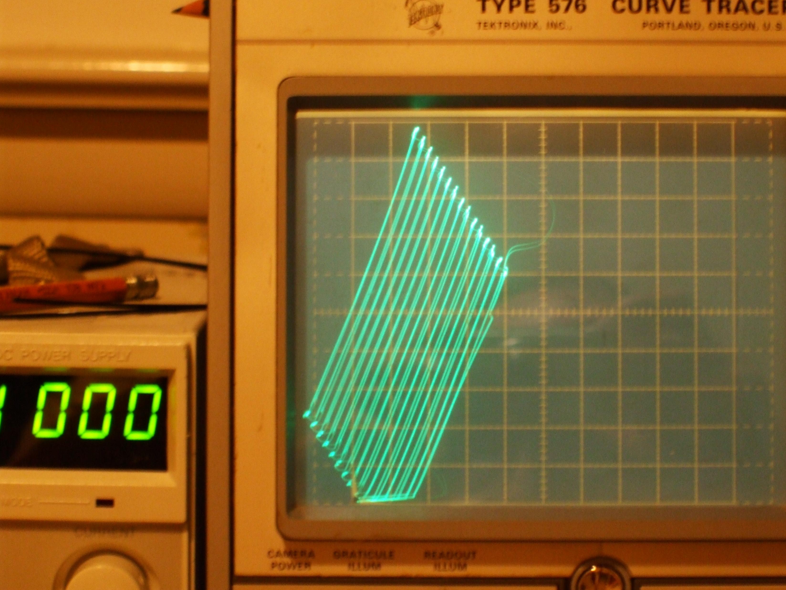

Here is a pic of such a Crazy Fdbk triode setup, except not using the g2 Mosfet follower yet (hence very low V gain, since the low value Schade resistor has to carry g2 current here), hence the closely spaced curves in the pic. (I'll get around to a properly isolated g2 curve set soon, this was just a quick and dirty short-cut to demonstrate the "straight" curves proof of concept.)

Would you say how you set up the 6FJ7 for that sweep?
My understanding of the UNSET is limited but as I've been working on a grounded grid power amp for the past few months I can't help seeing it as a sort of quasi grounded grid amplifier with only the feedback necessitating a resistor from grid to ground.
George gave a general schematic here:
https://www.diyaudio.com/forums/tub...sing-mosfet-ultralinear-feed.html#post6267790
In this case, for the 6FJ7 triode, the g2 supply is gone, and the two resistors around the grid were done by a single 600K pot so it would provide adjustable tube gain. I have the grounded end of the pot connected to an adjustable -V power supply, since the tracer can drive the cathode negative (see below). But same modus operandi as George's schematic.
With the TEK 576 curve tracer here, the step output (usually for base or gate/grid control) can do up to an amp (the 576 tracer is originally for SS small and power devices, 220 Watt max). So I don't need to put the P Mosfet in at the cathode for tracing, I just connect the step output directly to the cathode. (it has an internal N Fdbk control loop to ensure the step output agrees with the requested setting, with 20 Amp 350V output transistors to ensure that! With adjustable current limiting of course.) The Tek 576 provides DC offset (bias) and gain/step size controls for the step output. (I modified it years ago for tube tracing, so it can do up to +/- 170V total step range) The TEK 576 is just amazing, needless to say.

Don't forget that the improved linearity with this scheme comes at the cost of less output gain from the triode. Some gain has to be used up for the N Fdbk. I used up about half the gain for the 6FJ7 curve plot.
I'll curve trace a 6LU8 next, a 14 Watt beam pentode and a 2.5 W Mu 58 triode on the same 12 pin base. The pentode provides plenty of gain for the N Fdbk and can still have good output gain. Needs a screen supply however.

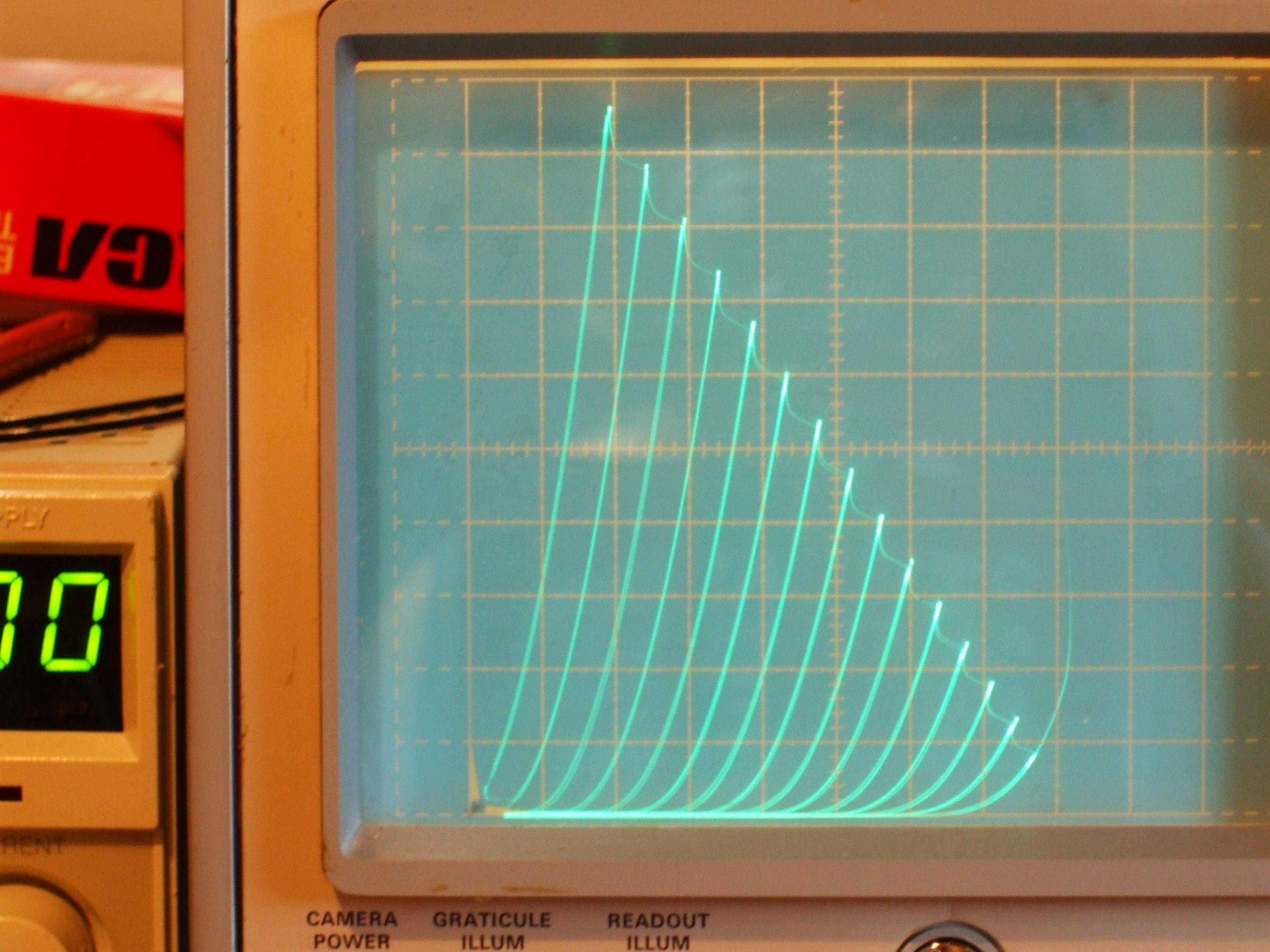

By the way, a 12HL7 (curve tracer selected, triode connected) can provide a very linear Mu 24 triode. (pic)
Hmm..., I should trace the 12HL7 with series Schade (CED, UnSet) N Fdbk. Linearity should be from outer space.

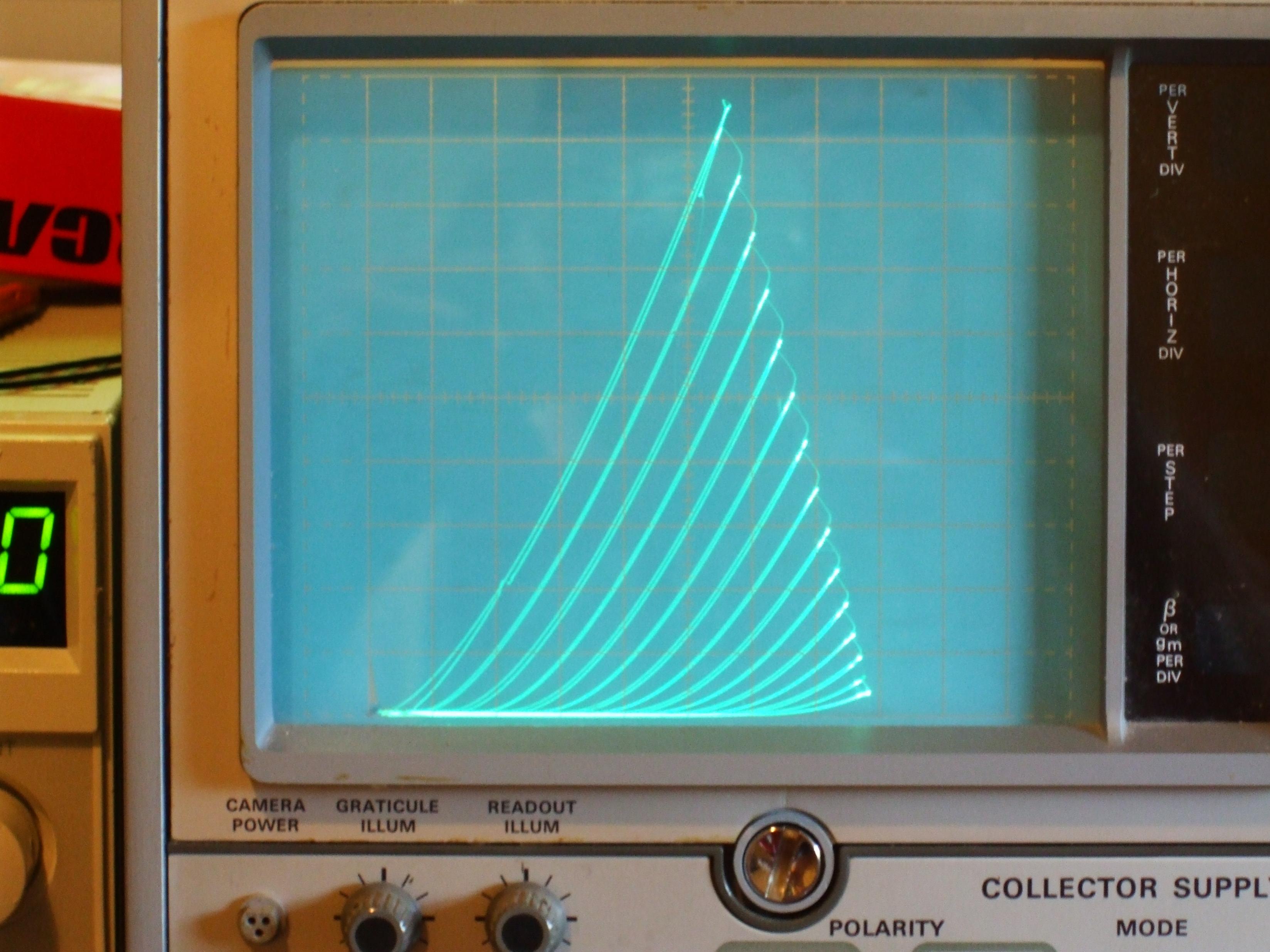

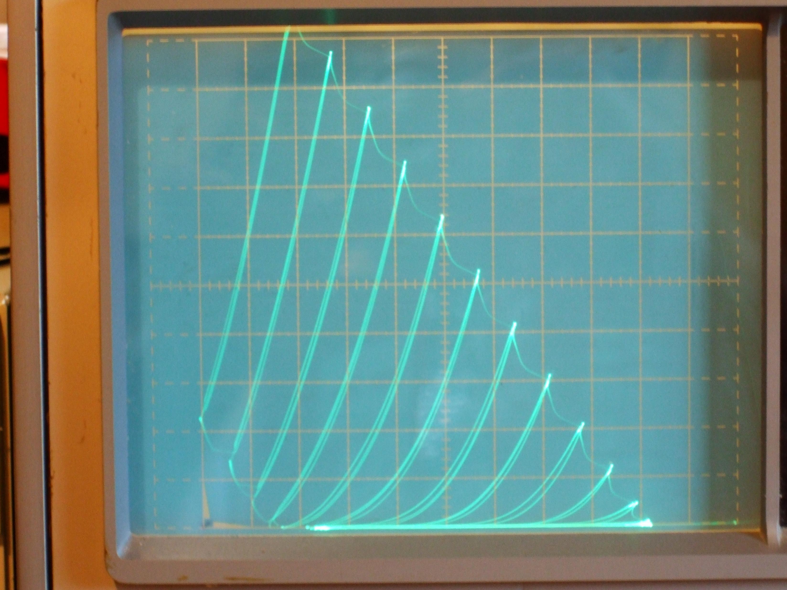

Here are some curves for the 21LU8 pentode.
All are 50 mA/div Vert., 50V/div Horiz., and 8 V steps
a) native triode mode
b) series Schade mode on pentode
c) reduced gain series Schade mode on pentode
d) native triode mode with series Schade mode added
Looks like the series Schade (CED, UnSet) on pentode mode have less of the "roll-over" issue
