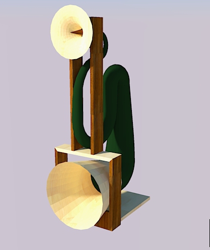

This little driver seems to outperform everything else!

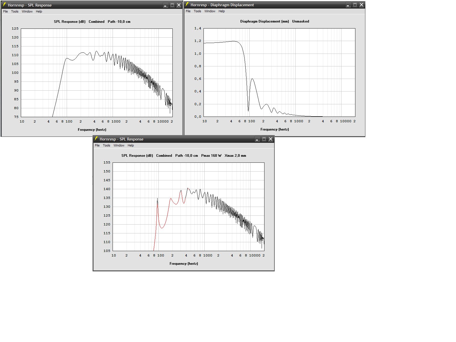

Actually if you look at the Maximum SPL graph where the line is red is the point where it is reaching it's xmax. Now you'll probly notice I have this set at 3mm insted of the listed 1.95 (it will round to 2 anyway) because this is closer to what I believe the mechanical limit to be ergo the point where it will really start to sound bad. I will post the figure at 2mm instead (it doesn't reduce maximum as much as you would imagine) and yes below the usable frequency it moves a lot but I would always you a good high pass filter with these anyway (like the one built into most AV receivers and processors.)
Okay here are the graphs for the Sax cabs including the cone movement at 2.83 Volts. It is well within Xmax at all freq. at this level and is playing quite loudly as you can see by the response graph. (remeber this design has 4 drivers) and I redid the max spl graph at 2mm instead of 3.
Wondering if that bottom graph might smooth a bit if pmax was closer to rms for the 4 drivers, not max input. The 18db valley @ 130ish is of concern.
Edit: ok, i see now.....the bottom graph is just the extremes of operation

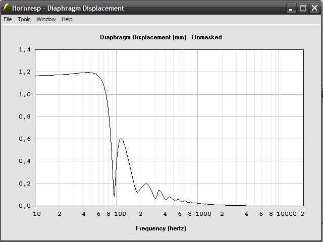

the bottom graph is interesting, as i believe another poster commented. i cannot quite read the y axis increments on the posted graph, but the red 'max excursion' line starts at about 80 hz.
this is fine for single tones....any intermodulation products in the signal, such as a chord(lol) a 5th/7th/3rd whatever will introduce IMD products with a beat frequency of greater amplitude than this.
in simple terms xmax will run out alot quicker than expected, with anything but the most spectrally sparse material. and this is with 4 drivers! i think i read that correctly.
still think its a great idea/experiment. just not for low frequencies.

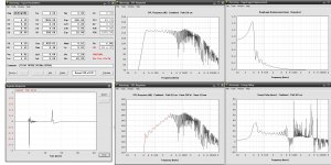

Here are the graphs for my most abitious design the 50hz spiral design with 8 drivers. If you look at the first two graphs this is the one watt response. It is reaching 112db all the way down to 45 hz, and is not appoaching Xmax at any frequency. The graph you were refering to was the maximum SPL graph and the fact that the line is red simply means that it runs out of excursion before it over heats. The saxaphone desingn is meant to extend to 100hz and it does so upto 115db before hitting Xmax at any frequency, if crossed over at 100hz it will hit 120db. The last pic I attatched is the cone excersion at 1 watt (110db 90hz+) as you can see Xmax is not a factor even unfiltered. So basically if you want to crank them up loud you need a crossover but this 200hz limit is silly.
Looking at the graph I just posted the group delay seems to be about the same from about 55hz up to 600hz where it suddenly shifts because that is where response switches to the front horn. The only area that might be a problem is between 45-55hz (below that is outside the passband of the response) But this speaker will also play to 115db full band unfilterd before aproaching Xmax and if crossed over at 60hz 127db is possible. So while deep bass is not practical for these drivers due only to group delay good bass response down to 50hz is not only possible but can be exceptional as the impulse response is still the finest I have ever seen from any design. I know, I know somebody is going to come back with well then just build it, keep it to yourself you've already said it.
