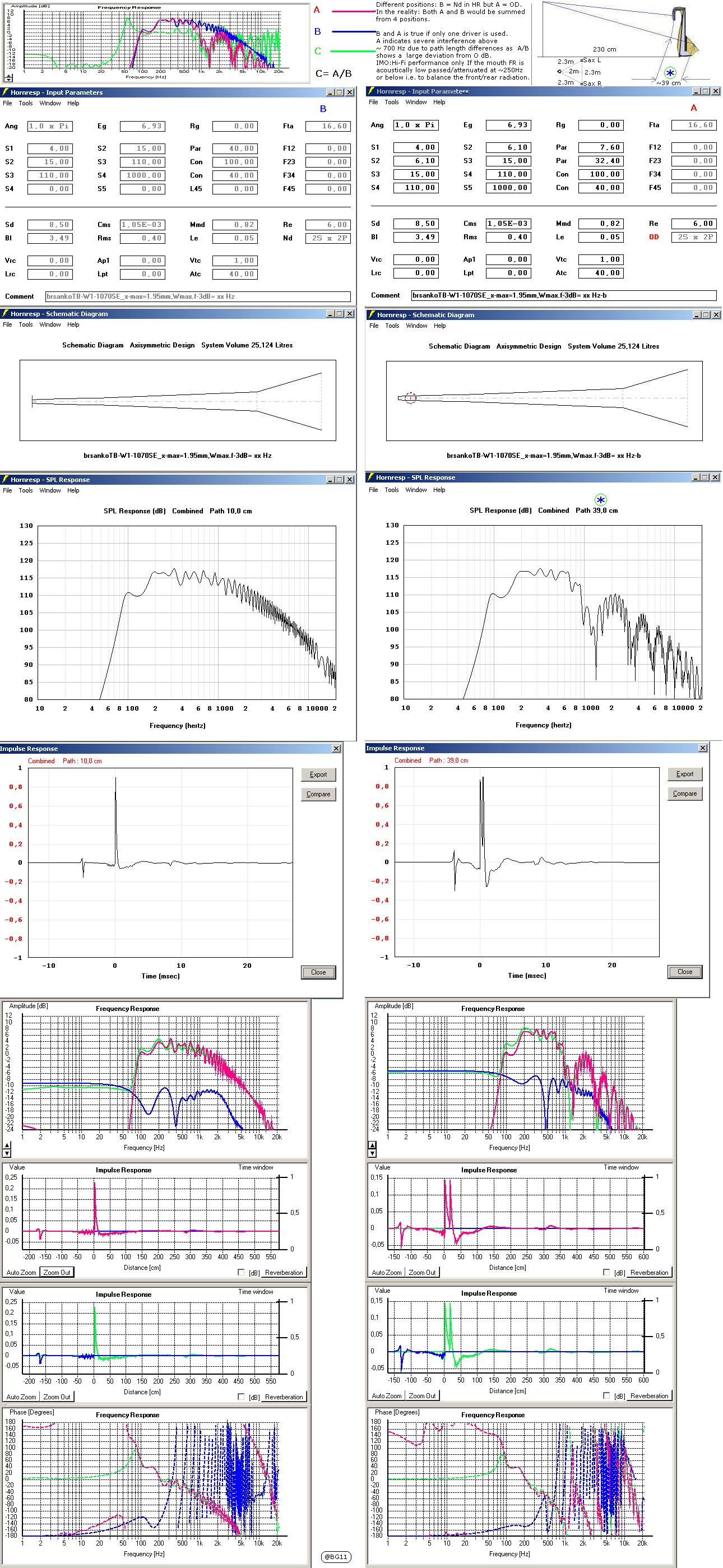

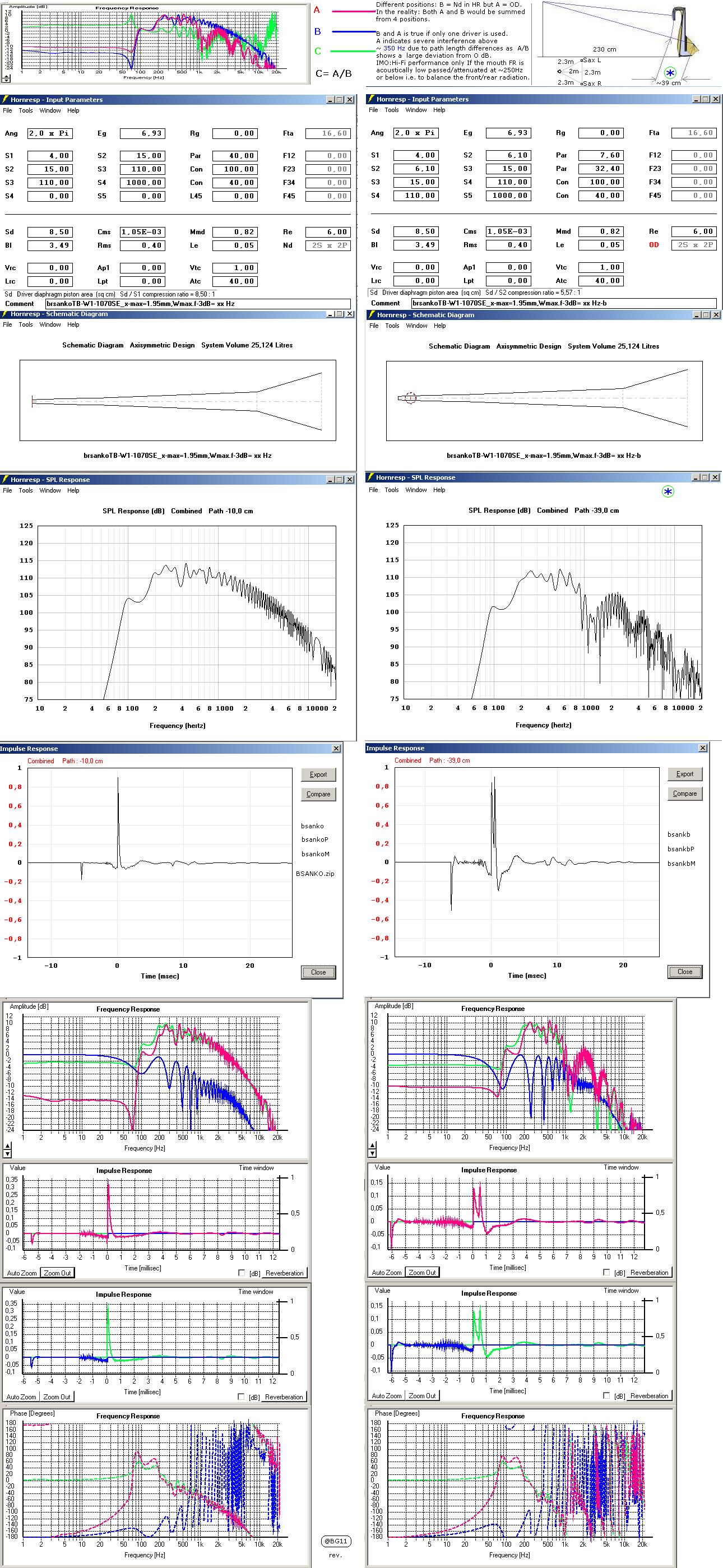

Late 2 cents of observations:
:magnify:
b:)

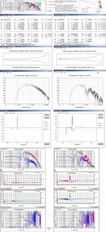

Two questions.
1. It looks like you used a positive path length difference. Should this be negative based on the text in program, the driver is closer to the listener then the horn's mouth.
2. Why is 1 x pi space used? Should it be 2 x pi? The floor is the only boundary touching the horn mouth.
Martin
Hi Martin,
Thank you for posting important observations/questions.
1.You are right, I forgot to enter a minus sign when entering the path length difference.
2.I changed the OP:s original (=Input screen in post# xx) 0.5 x pi Space Angle to1.0 x pi only to eliminate the HR message: = Cir> 1 for S5 but didn't reflect further on the consequences of the implied boundary load: If to perform well, these speakers should not be pushed to close to any reflecting wall (1.0 x pi) but stay away using distances similar to a good OB speaker system setup(2.0 x pi).
I will update and try tomorrow post a new corrected picture in accordance with your remarks.
b :)
